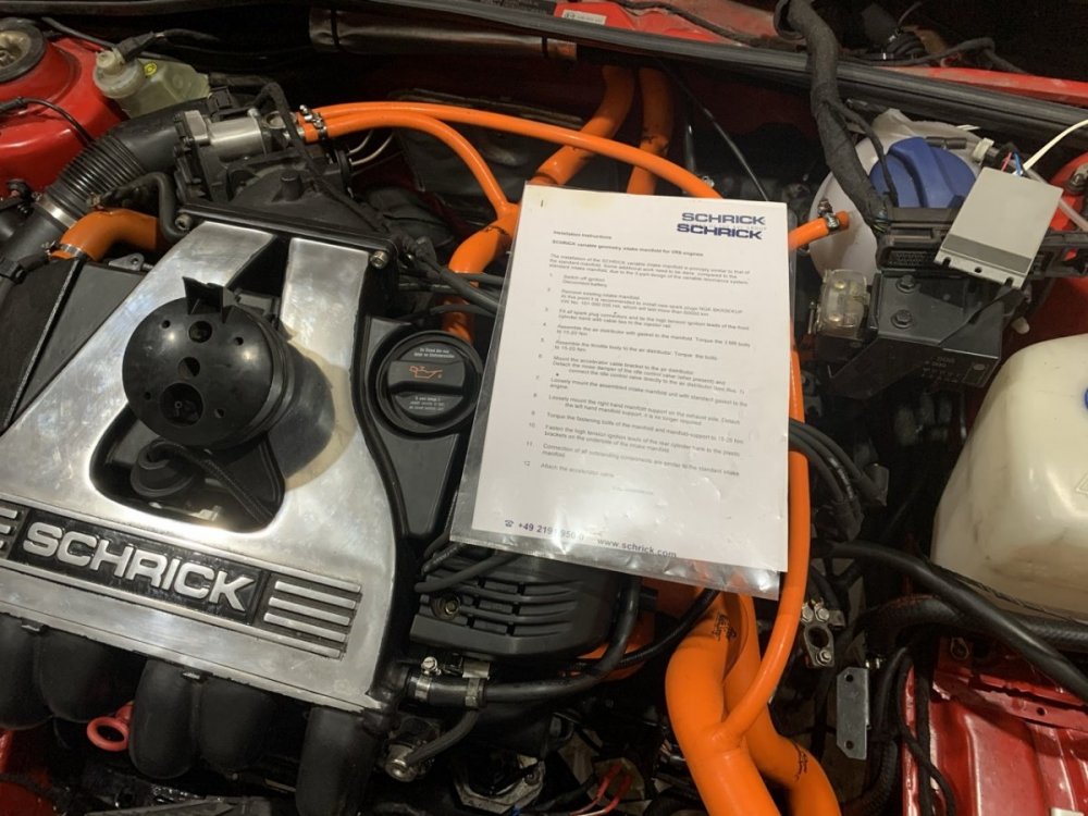

easypops 8 Posted June 9, 2020 Not running yet, the oil pressure isn’t attached at the engine side, I just attached the battery to see if things might work 😁👍 Quote Share this post Link to post Share on other sites
1xshaunx1 27 Posted June 9, 2020 On 6/9/2020 at 1:56 PM, easypops said: Not running yet, the oil pressure isn’t attached at the engine side, I just attached the battery to see if things might work 😁👍 If I’d have tried that it would have fried it and never worked again. 😂 Quote Share this post Link to post Share on other sites
Keyo 49 Posted June 9, 2020 On 6/9/2020 at 1:56 PM, easypops said: Not running yet, the oil pressure isn’t attached at the engine side, I just attached the battery to see if things might work 😁👍 Worth sitting at the car at night with the gauge pod illuminated, that will put a smile on any corrado owners face ha. Quote Share this post Link to post Share on other sites

easypops 8 Posted September 18, 2020 Long time no updates although I have been crazy busy with getting back to work, but some progress has been made. All brake lines have been made and fitted, goodridge hoses all round. As it’s Teves20, no bias valve. Fuel tank and pipes installed. Coolant hoses installed, but had a few leaks when filled up, crack pipe at block(pinched seal),thermostat housing (my error in assembly) and radiator switch (not quite tight enough). Swapped the metal crack pipe for a vw original one, sorted the thermostat housing and tightened the red switch and no more leaks(yet). Oil filled up. Gearbox filled up with MT-90. Power steering fluid added but needs the pump turning for circulation. All heat shields installed. Exhaust fitted except the back box, need to do a bit of a repair on the rear bracket area. Still to do Finish the install of the Schrick pipes/electrical box.......almost done though Add brake fluid Adjust the gear linkage as it’s not quite right at the moment (at least I don’t think it is) Loads of smaller jobs needing done but it might well get fired up soon 😁 Quote Share this post Link to post Share on other sites
