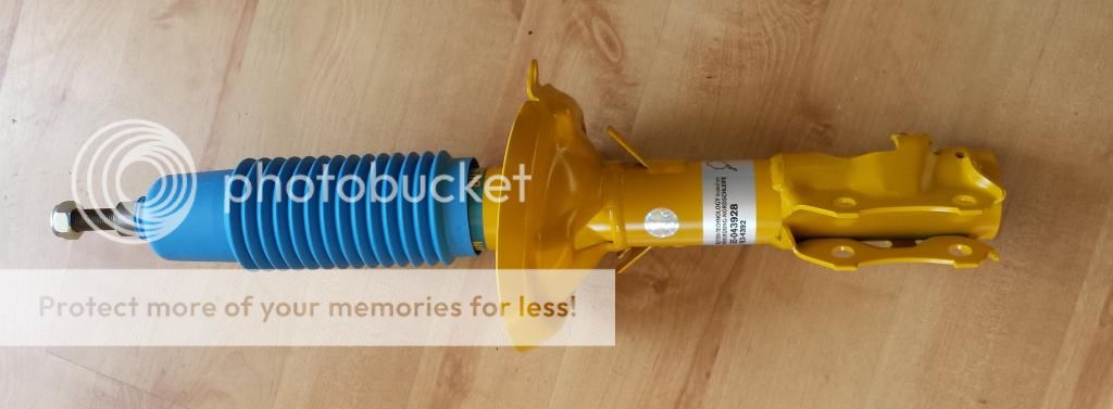

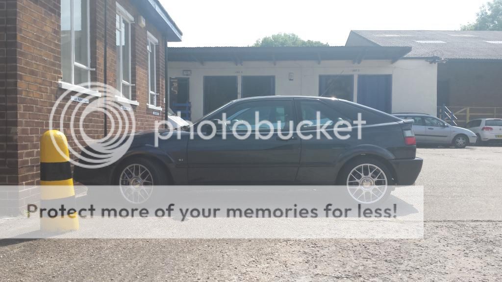

daves16v 1 Posted July 12, 2014 After purchasing the Bilstein B12 kit a few weeks back I've finally managed to get them on, well to the point where I was happy and the alignment done. I say this as I wasn't happy at all with the rear ride height so off with the rears and 25mm cut off the bump stops. This itself improved the ride some more. Good thing the rears are an easy job. Took the car down to the 4 wheel alignment centre this morning and bonus they didn't have to touch the camber as I'd somehow set it up spot on or there abouts, £20 quid saved there. The Toe did need adjustment. Apologies for the poor phone pic, I was shooting into the Sun. Anyway I'm happy with the ride height now. So I guess you want to know how it rides? I haven't given it a good run through the twisties yet, just town driving but I have to say the ride quality is excellent, not crashy or bone crushingly hard at all. So far I'm really pleased with them, my main concern before buying these was the ride height as I'd been burnt before with fixed height suspension. Quote Share this post Link to post Share on other sites
Jim 2 Posted July 12, 2014 Looks good, Dave! Be interested to hear how you get on with them over the coming months. Quote Share this post Link to post Share on other sites
Goldie 2 Posted July 13, 2014 Don't think you've been burnt there Dave, looks good and looks very drivable.. Quote Share this post Link to post Share on other sites
sexybourbon 0 Posted July 13, 2014 Looks very good mate id like to know how it feels on thw twistys Quote Share this post Link to post Share on other sites
Ferosferio 10 Posted July 13, 2014 (edited) I'm hoping to get the B12 kit to replace the horrible Pro Sport coilovers on my Raddo and, although ride quality and handling are the absolute priorities, I'd be lying if I said I wasn't bothered about how the car is going to sit. Chuffed to see this as that ride height looks spot on :thumbleft: Edited July 13, 2014 by Ferosferio Quote Share this post Link to post Share on other sites

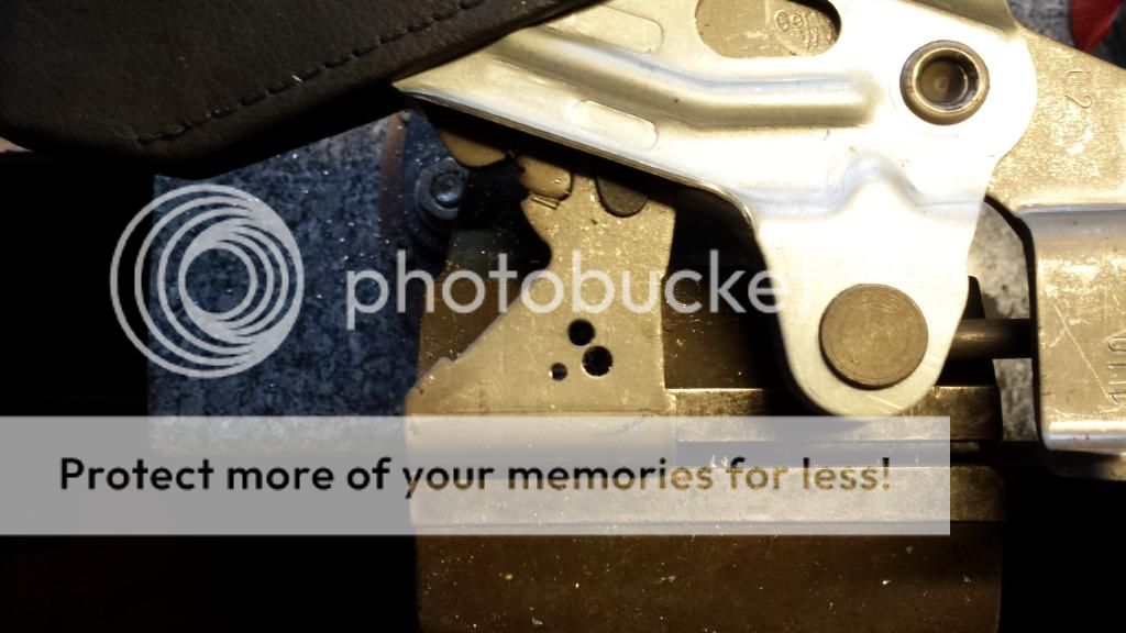

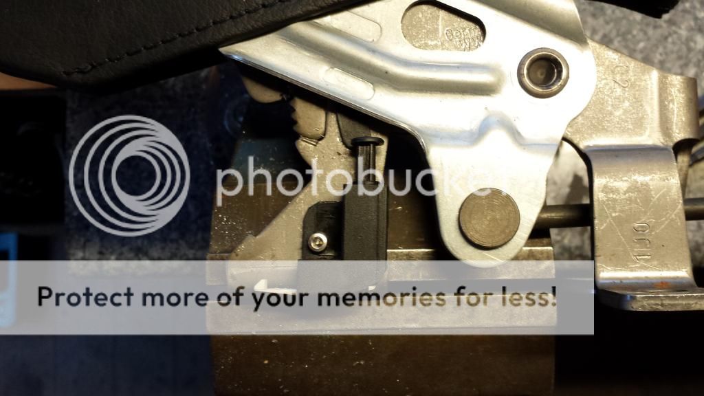

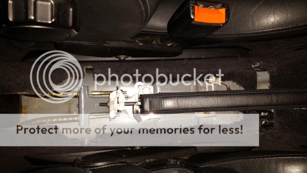

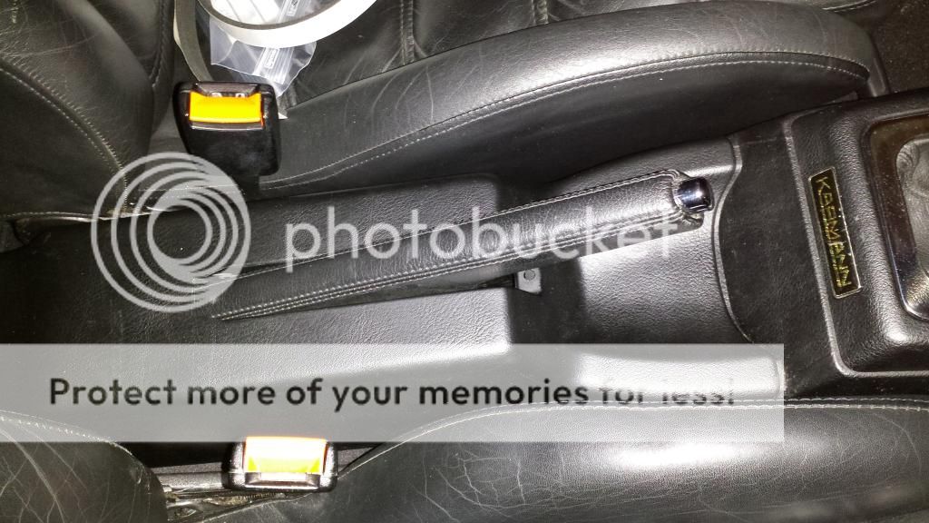

daves16v 1 Posted December 24, 2014 After seeing the Golf Mk4 handbrake conversion done on the Corrado I decided it would be one of my next upgrades so here it is. Modifications required to fit are - 1) Slot the front bracket mounting to allow central fitment. 2) Bend the rear bracket to align with the stud. Trim steel away from this bracket to allow the plastic trim to sit over. 3) Add a third mounting point for the extra bracket. I drilled and tapped the floor to accept an M8 bolt, seems to hold fairly well even though the floor isn't particularly thick. 4) The dash light switch is different on the mk4 handbrake and the connector is different too so I redrilled the mounting point for the Corrado switch and removed a small section of steel for the clip to fit to. This on its own wasn't quite enough to keep the switch from twisting slightly when the handbrake was lowered so I add an M3 bolt to keep it from twisting. 5) There is quite a bit of trimming needed to re-fit the 2 plastic trims. 6) The handbrake handle doesn't quite sit fully down due to interference with the plastic trim but it's not much short. I may try to improve this later but would need more cutting of the plastic trim so I may modify the lower stop position on the handbrake mech. Quote Share this post Link to post Share on other sites
Sean_Jaymo 0 Posted December 24, 2014 Much better eh! I like the leather cover too. Quote Share this post Link to post Share on other sites
