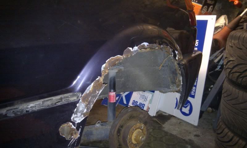

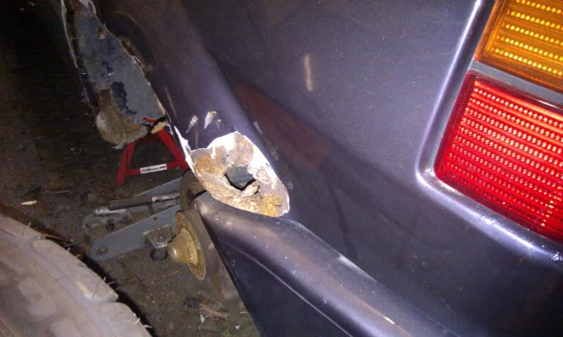

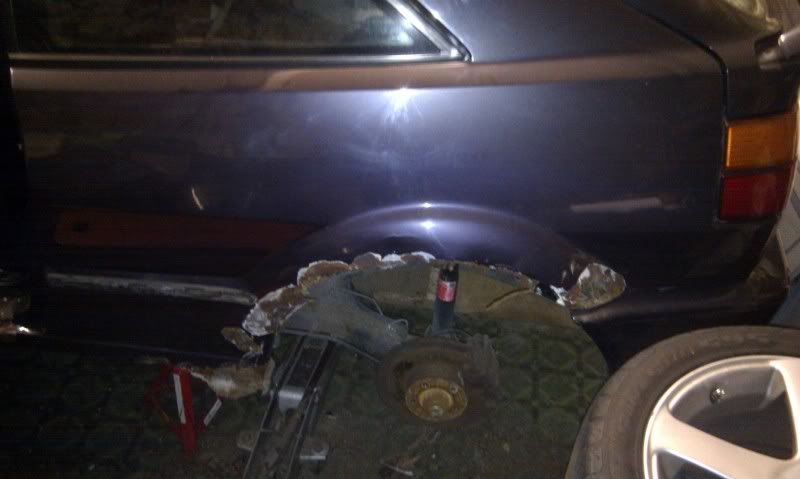

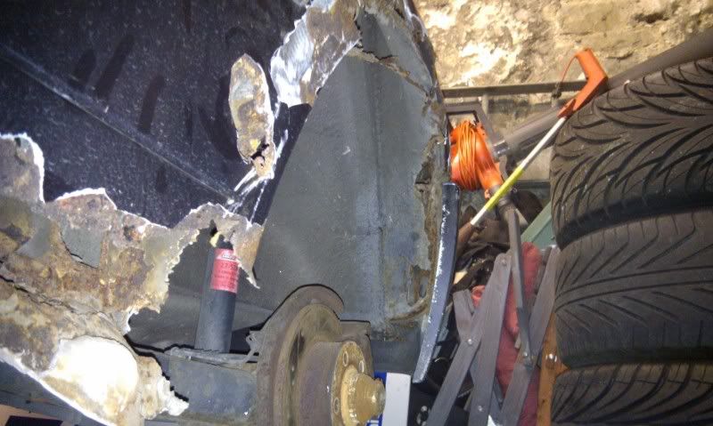

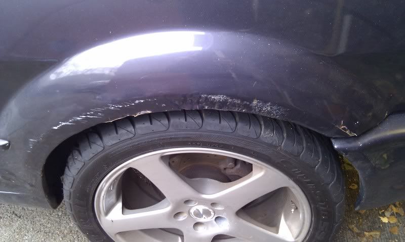

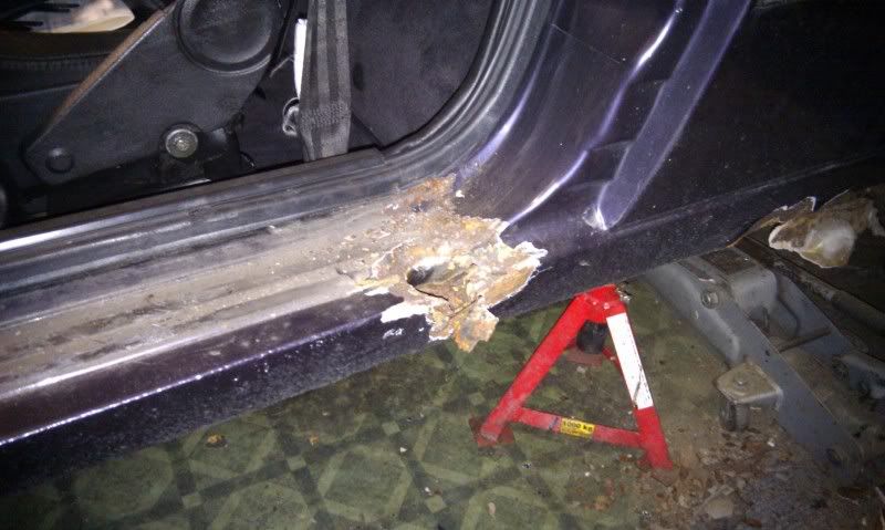

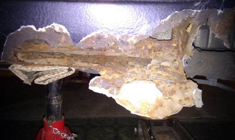

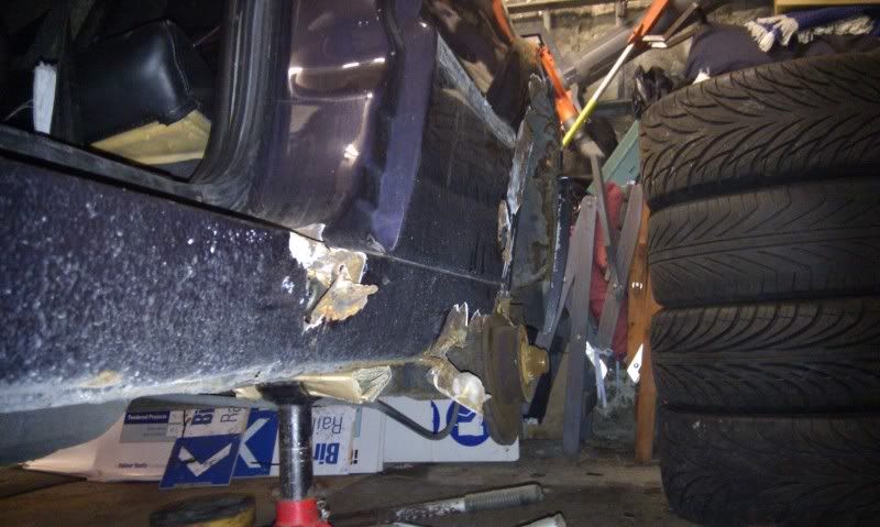

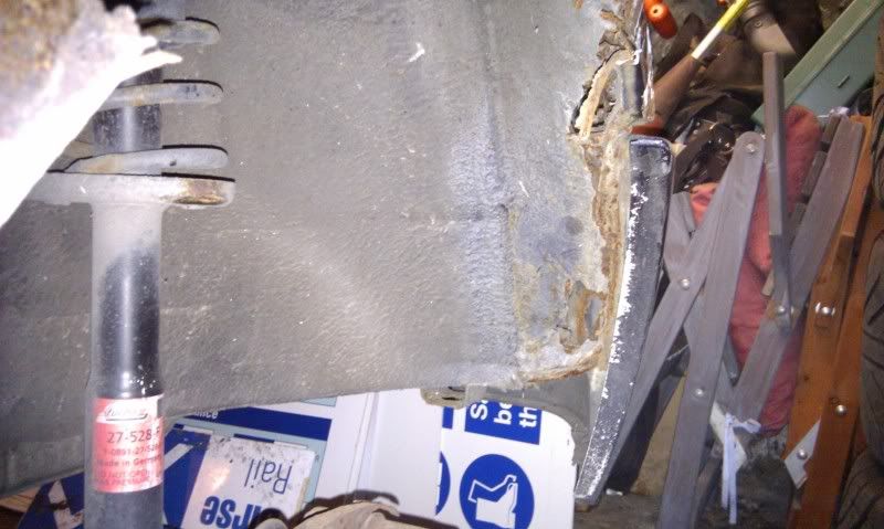

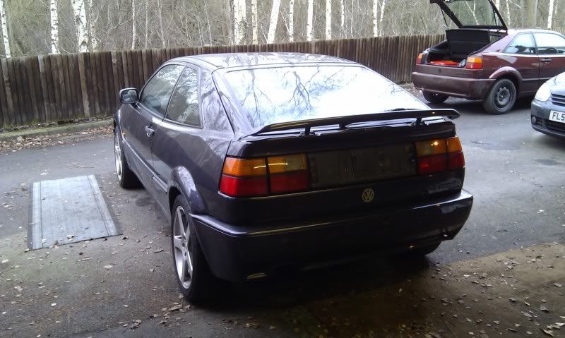

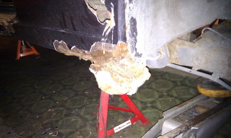

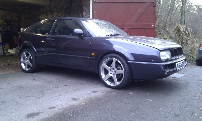

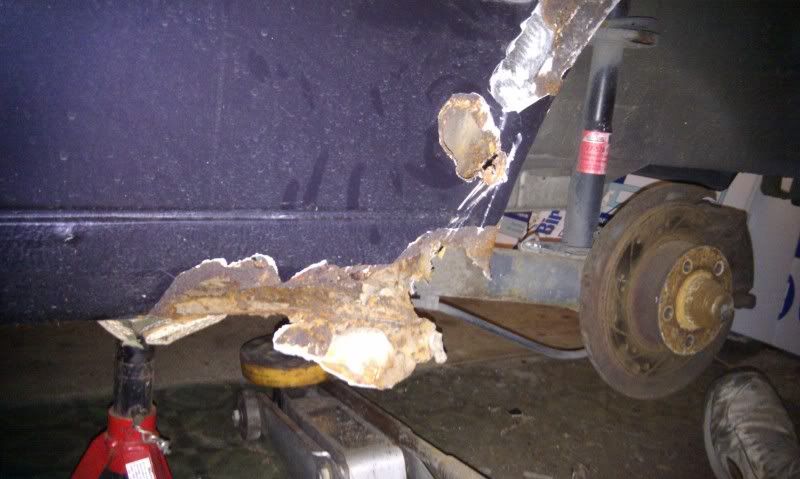

Purple Tom 0 Posted January 29, 2011 Hi everyone, Bit of a sad one this really, it signals the end of another Corrado unfortunately. At the start of September I bought a 1996 'N' Corrado VR6 from a lad local to me on this forum. I didn't pay a lot for it, considering its spec (twilight violet, 117k, full black heated leather, decent wheels, stainless exhaust, uprated discs etc), but it had quite a few dents and knocks, scratches, and a fair amount of rust around the N/S/R wheelarch. I bought it with the intention of putting it on the road, but I pretty soon came to the realisation that it needed a LOT of bodywork, probably too much to make it a viable project, so I decided that breaking it might be a better alternative. Here's a couple of pictures of how it looked until about 3 hours ago: Here's the rust around the N/S/R arch: It doesn't look that bad really. A bit of bubbling and a couple of scrapes but nothing particularly major you wouldn't have thought. This afternoon Ian (B4ILEY on here) came round and helped me do a few bits and bobs, including figuring out how to remove the door window exterior rubber trim. It was while doing that job that I noticed a small hole right on the underside of the N/S sill towards the rear of the car. Closer investigation with a screwdriver and then a small knockometer produced this: There's plenty of rust around the top of the windscreen too, not to mention the rear hatch which is pretty manky. As you can probably see, the rear sill was pretty much full of filler, as was the rear arch, all the way round to the rear bumper and rear panel. There's also a fairly sizable hole on the N/S doorstep which was also filled and painted. It's obviously had a quick 'bodge it and scarper' repair within the last 2 or 3 years, funny that there's nothing in the history. I just can't believe that someone would do such a bodgey repair and then spend a fair amount having the entire side resprayed, its good paint too! Such a shame because mechanically the car is 100% perfect! The interior is pretty good and if it wasn't for its tinworm issues it'd make a great project. I think its safe to say I am justified in breaking this car, as coupled with its numerous dents and scrapes on other panels it's just not worth putting back on the road! What I do have however is a great donor for the widetrack conversion on my 8V, along with lots of bits and pieces to keep many other C's alive and kicking. I'll start a for sale thread soon. Has anyone else seen one quite that bad? It seems to be the late Corrado's that suffer with corrosion more - something to do with the quality of paint/steelwork? Tom Quote Share this post Link to post Share on other sites

V-Dubstar 0 Posted January 29, 2011 :shock: That is shocking!! Purple Tom said: I just can't believe that someone would do such a bodgey repair and then spend a fair amount having the entire side resprayed, its good paint too! Completely agree, wtf?! That's all killa AND filla!! Quote Share this post Link to post Share on other sites
dukest 0 Posted January 29, 2011 Not sure I'd want to buy anything metal from that! Good job you'd already made the decision to break it. Quote Share this post Link to post Share on other sites
Pat_McCrotch 0 Posted January 29, 2011 Just goes to show what happens when you skimp on bodywork repairs. Think twice before you go to Fred in a Shed to save £150 on bodywork... Quote Share this post Link to post Share on other sites
MarkFoster 0 Posted January 30, 2011 Are you absolutely sure it won't polish out though? Quote Share this post Link to post Share on other sites

Yandards 0 Posted January 30, 2011 Nasty, good demonstration of what can be lurking under some benign looking corrosion though. Get the damn wax oil spray down behind the rear quarter door cards, that should help prevent that sort of spread in the rear sill area. Quote Share this post Link to post Share on other sites

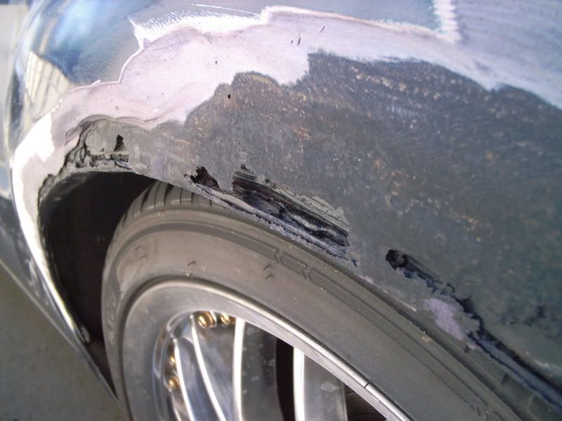

quicky1980 0 Posted January 30, 2011 I had something on mine, not as severe but still a nasty surprise Same wheel arch as yours. Someone had tried fixing the damage, but didnt do a very good job Quote Share this post Link to post Share on other sites
Purple Tom 0 Posted January 30, 2011 Ouch, the corrosion looks to be of a similar severity! I still can't understand the logic of putting filler over rust as a long-term solution. I think its OK if you only expect the car to live another year or two but for something like a Corrado I think the only option is to replace the steelwork with new steel. How long did the repair take? Tom Quote Share this post Link to post Share on other sites

tony_ack 0 Posted January 31, 2011 Salvageable - maybe with a new arch and sill (providing there is no more damage which it sounds like there is), viable - no, not when you have a decent shell lying around. Is this the one advertised on here last summer? I enquired about it, so looks like I dodged a bullet... Going to get mine checked over and repaired if needed in the summer as there is a tiny rust spot in the same area on the opposite side.. Quote Share this post Link to post Share on other sites

quicky1980 0 Posted January 31, 2011 Tbh mine was down to a poor repair job. The rust was completely cut and a replaced by new panels. Not sure how long it took as it was part of a full respray Quote Share this post Link to post Share on other sites

jimpy66 0 Posted January 31, 2011 This would scare the crap out of anyone. I've got a bubble on same arch and when I checked it out few weeks ago, discovered it a bit nasty behind. Found a big wodge of sealer behind rim coming loose so cleaned it out and left open meantime. It'll get fixed in the spring- it'll be cut out and a section welded back in, shaped and painted. Also do all the little bits here and there- number plate light recess has a fleck or two, seam at drivers doorcheck. As these photos show, you just can't mess around with these bits- cover them up and the next thing you know it's a wreck! Sorry to see this on a late car though. Probably been poorly repaired or maintained in the past. As Corrados all approach the twenty year mark, only those with owners giving serious maintenance will last to the 25-year mark. They'll rapidly deplete in numbers unless most find a seriously good home. I'll be welling up in a minute. What we need is a third world country (UK shortly :grin: ) to buy the dies and start making Corrados again. They could make an electric one for shopping, a hybrid one for the grass-huggers and a W8 for the rest of us. Just as long as they don't limit the supply of window rollers, heater controls, headlamp switches and dash cover caps :dance: Quote Share this post Link to post Share on other sites
