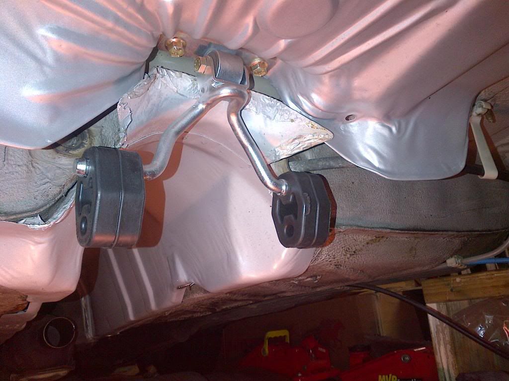

ChrisL 20 Posted March 22, 2013 Cheers Guys, really pleased with how the coilovers came out, better then i thought and a real sense of satisfaction. Got the heat shields on and fitted the restored exhaust hanger and bolts. Quote Share this post Link to post Share on other sites

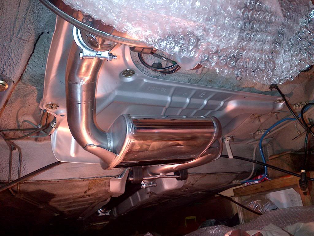

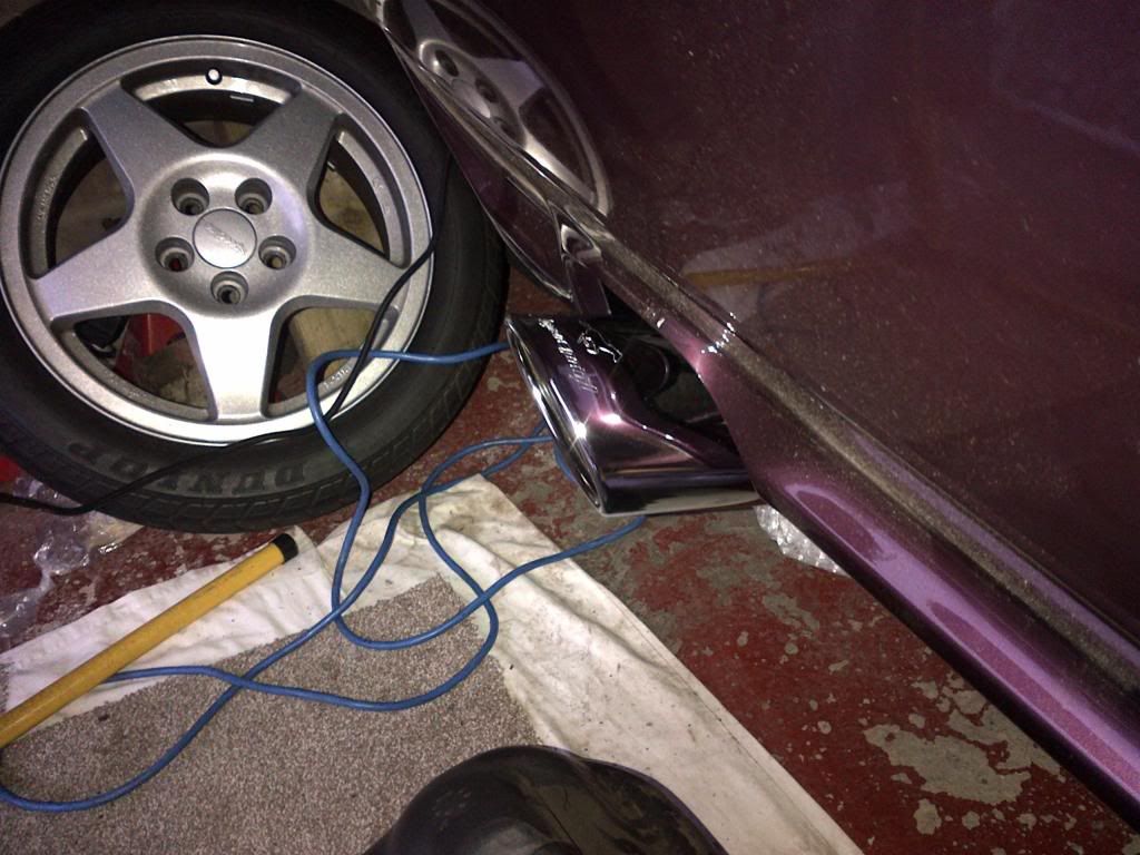

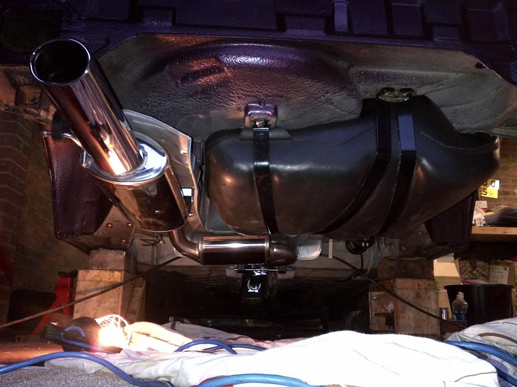

ChrisL 20 Posted March 27, 2013 Braving the extremes of winter today I ventured out and got the Exhaust mounted, seems to fit pretty well and tail pipe fits bang in the middle of the bumper cutout. Quote Share this post Link to post Share on other sites

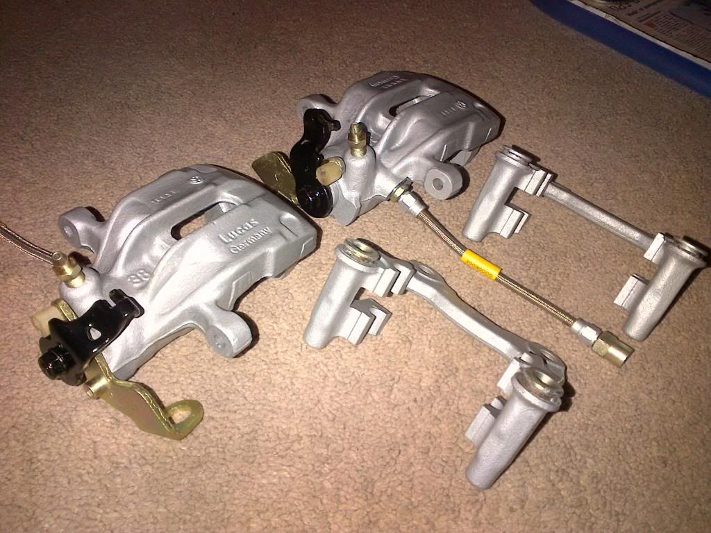

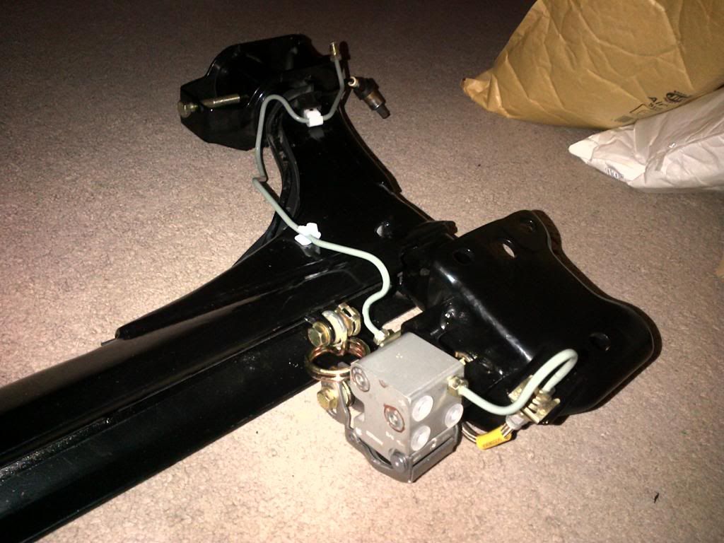

ChrisL 20 Posted March 29, 2013 Brake calipers assembled and ready: Assembled the rear beam parts in front of the telly tonight, bit crappy pictures but you get the idea. Quote Share this post Link to post Share on other sites

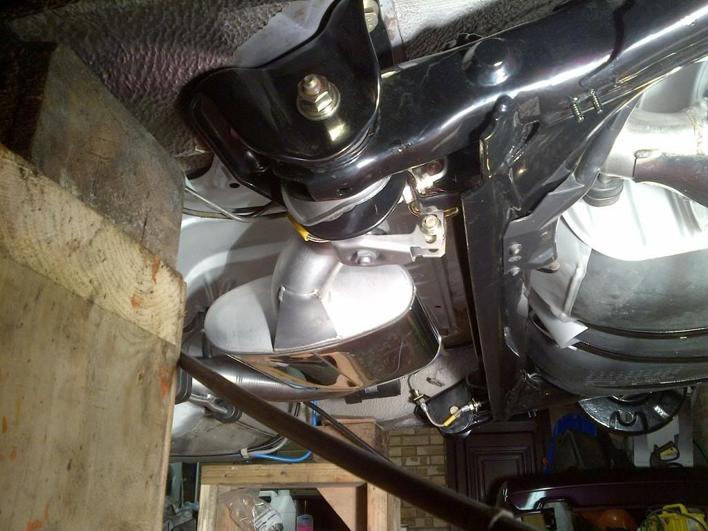

ChrisL 20 Posted April 5, 2013 Last lot of bits picked up from powder coaters so got the Petrol Tank fitted tonight. Should hopefully have the beam on this weekend. Question though, should I remove the powder coat from the surface of the beam where the stub shafts for the rear wheels bolt on? I'm concerned that if I clean it back, water will get under the powder and start to rust. Quote Share this post Link to post Share on other sites
KIPVW 0 Posted April 6, 2013 Chris, yes definitely remove any paint where the stub axle sits as once everything is back on and settled down you would probably need to re-check the 4 stub bolts after they have compressed the paint if you leave it on. Where as if you remove the paint you wont have to do that & a smear of copper slip on the 2 mating surfaces will help keep rust at bay too ;) Quote Share this post Link to post Share on other sites

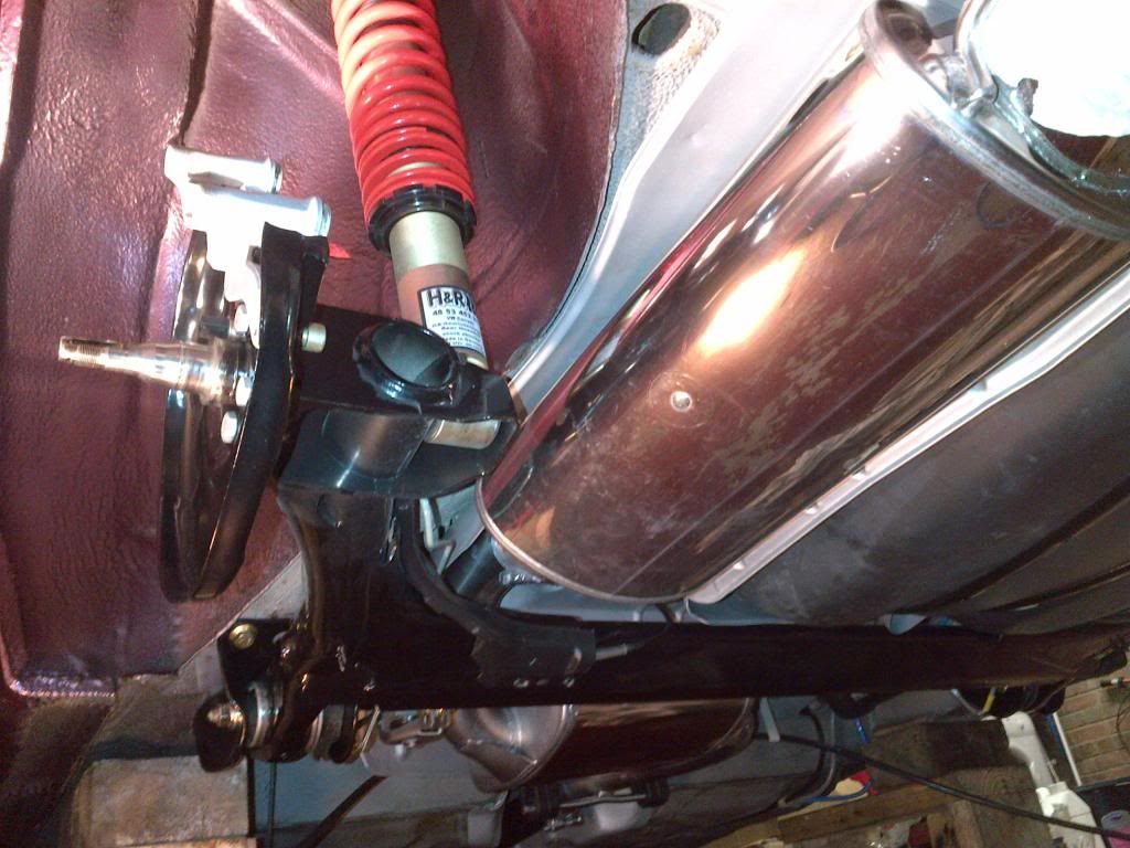

ChrisL 20 Posted April 8, 2013 (edited) Planned to get the beam fitted over the weekend but spent saturday and sunday from 7:30am to 6pm stood by a swimming pool again (well worth it though). So set about fitting it tonight. It was a bit tricky balancing it on 2 trolley jacks and lifting it into place but got there without any major hick-ups. Quite productive though as I got the coilovers, stub shafts and backplates on. Really tricky to get a good picture but you get the idea So need to assemble the brake calipers, fit the discs, new front to rear brake line and bleed the brakes. Then re-fit the bumper and I'm good to go. Roll on Stanford...... Edited April 8, 2013 by ChrisL Quote Share this post Link to post Share on other sites
