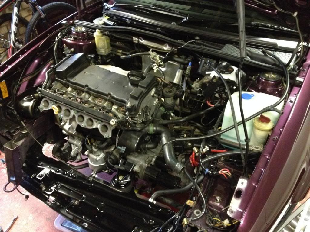

ChrisL 20 Posted January 26, 2014 Had a couple of hours on the car this afternoon and this is how it stands currently I've taken nearly 40 pictures while stripping it down and still worried in the back of my head whether I'll be able to re-fit it correctly. Any advise on stripping the injectors out and loom from the injector rail please? Quote Share this post Link to post Share on other sites

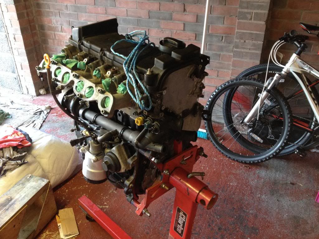

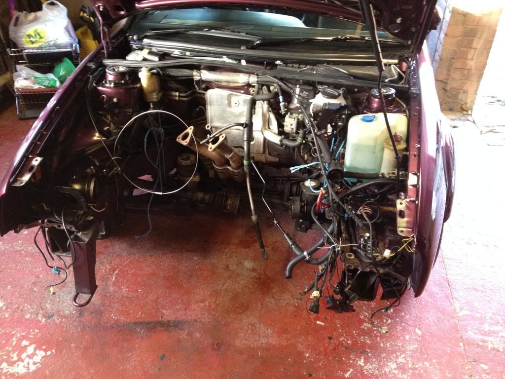

ChrisL 20 Posted February 2, 2014 (edited) Good day on the car today, a mate from work came round to help me get the engine out. Suprised how easy the engines come out and we only had 1 snapped bolt which was the passenger side engine mount bolt. The local 'busy body' popped in the garage and asked what we were doing and I told him we were taking the engine out to clean it. I may be old but I'm not stupid he replied........... so much to learn! So left with this now: Engine on its stand ready for cleaning: Tomorrow nights job is to start removing the subframe and suspension. Edited February 2, 2014 by ChrisL Quote Share this post Link to post Share on other sites
