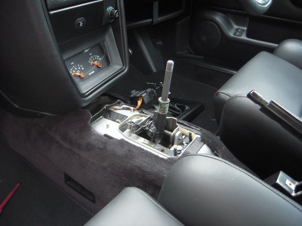

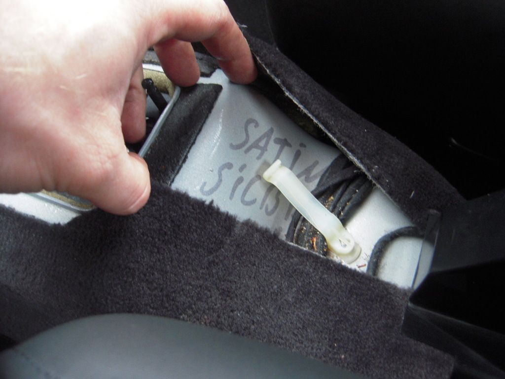

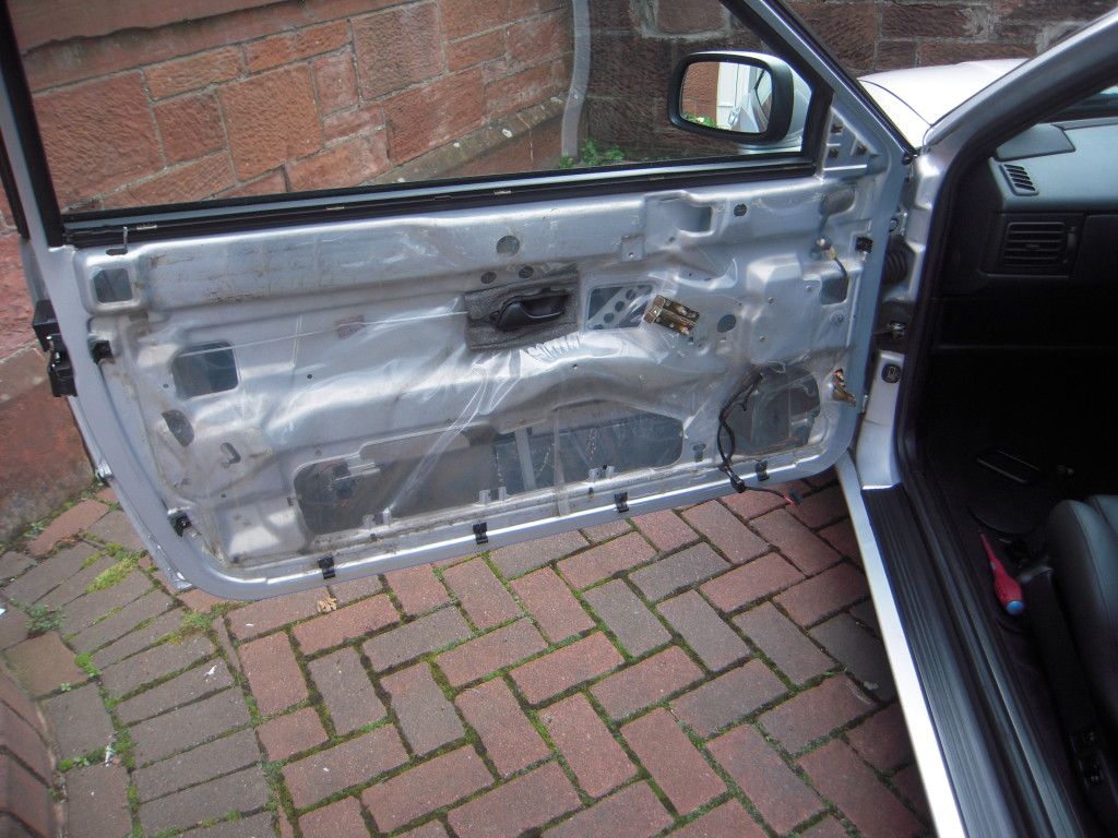

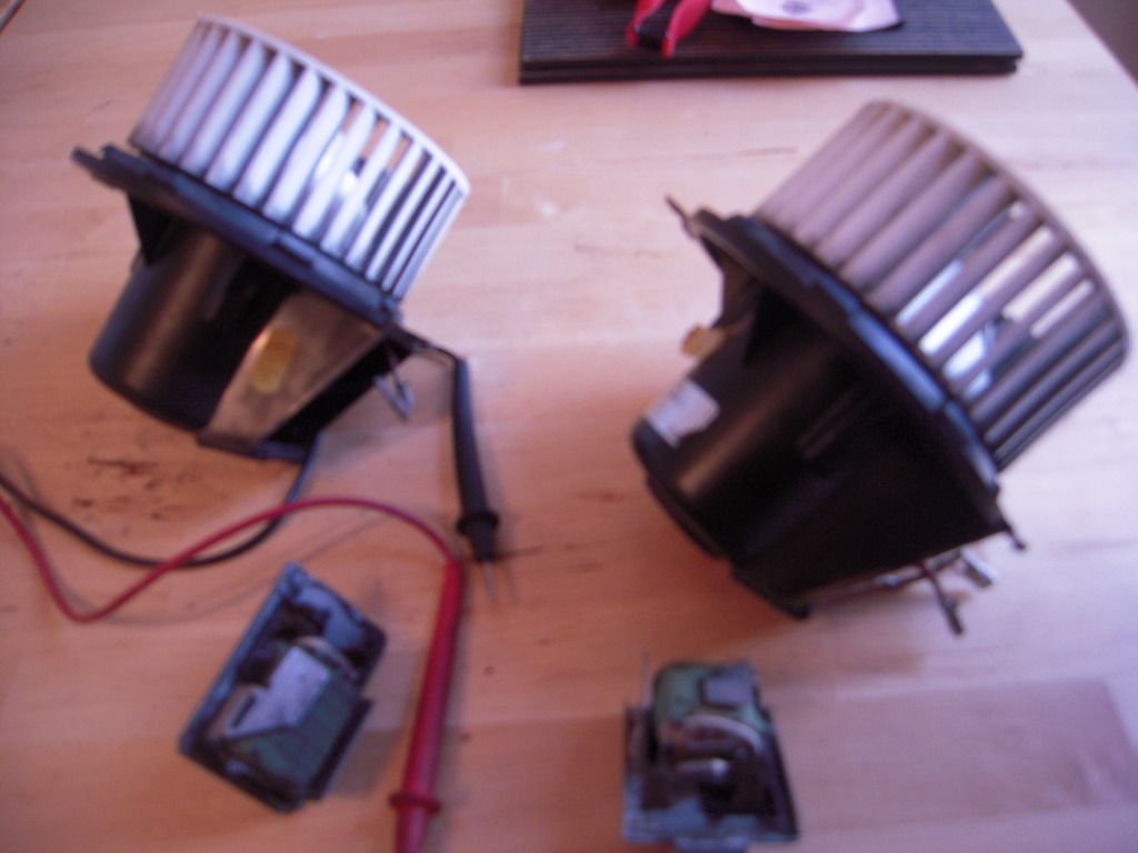

Goldie 2 Posted August 28, 2012 Well due to a change in plan i have a bit more time at home so a bit more car play continues.. Today i got a few jobs done on the interior.. I reminded myself how much i don't like refitting door cards, the passenger side top plastic trim was split so it had to go.. I also needed to have a look at the heater blower after the it only works on speed 4, the old motor came out ok and no wonder it didn't work, the cabling was badly charred, still with continuity across the motor though and the thermal resistor was shot. I had managed to get another from a scrappy that was 2 years younger so a one for one swap and all speeds back on, result.. Lastly, the lower console trim had screw holes in it.. All looking very tidy underneath and for some reason the paint colour is written there, strange.. Its only partially put back together as I'm waiting for a delivery from MJ interiors.. Other than that I'm on a big parts collecting mission, i am quite shocked how many things have become obsolete in my few years away so I'm hoarding.. Quote Share this post Link to post Share on other sites
bristolbaron 11 Posted August 28, 2012 i like seeing the updates - showing even a flawless car has a couple of things that need working on :lol: paint colour in middle is a factory thing. i guess as soon as they stamped the chassis they put the code in the part of the car that wasn't going to be sprayed.. Quote Share this post Link to post Share on other sites

daves16v 1 Posted August 28, 2012 Looks like you need a short shifter :wave: Quote Share this post Link to post Share on other sites
Goldie 2 Posted August 29, 2012 Looks like you need a short shifter :wave: I have thought about it and had a look at the thread.. Quote Share this post Link to post Share on other sites
