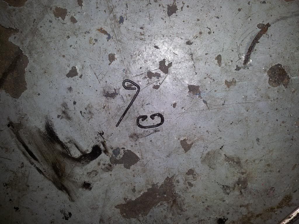

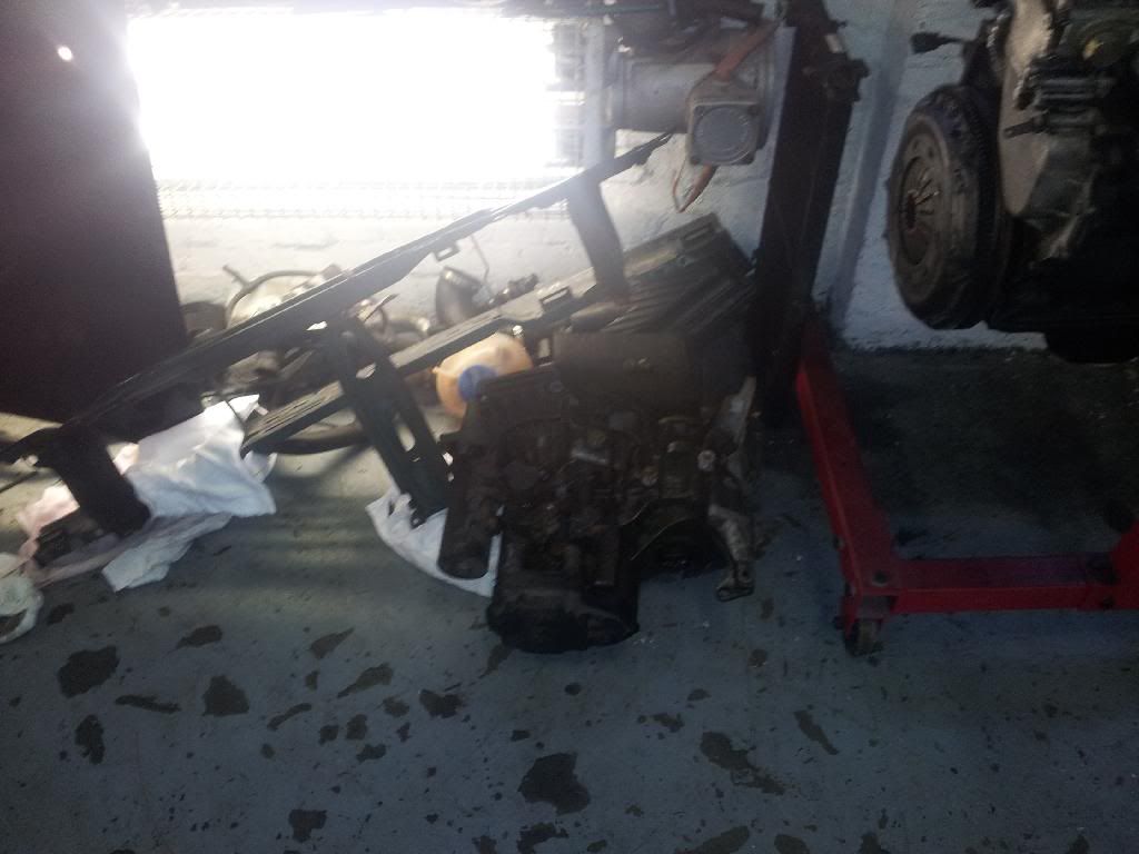

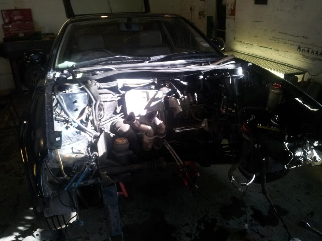

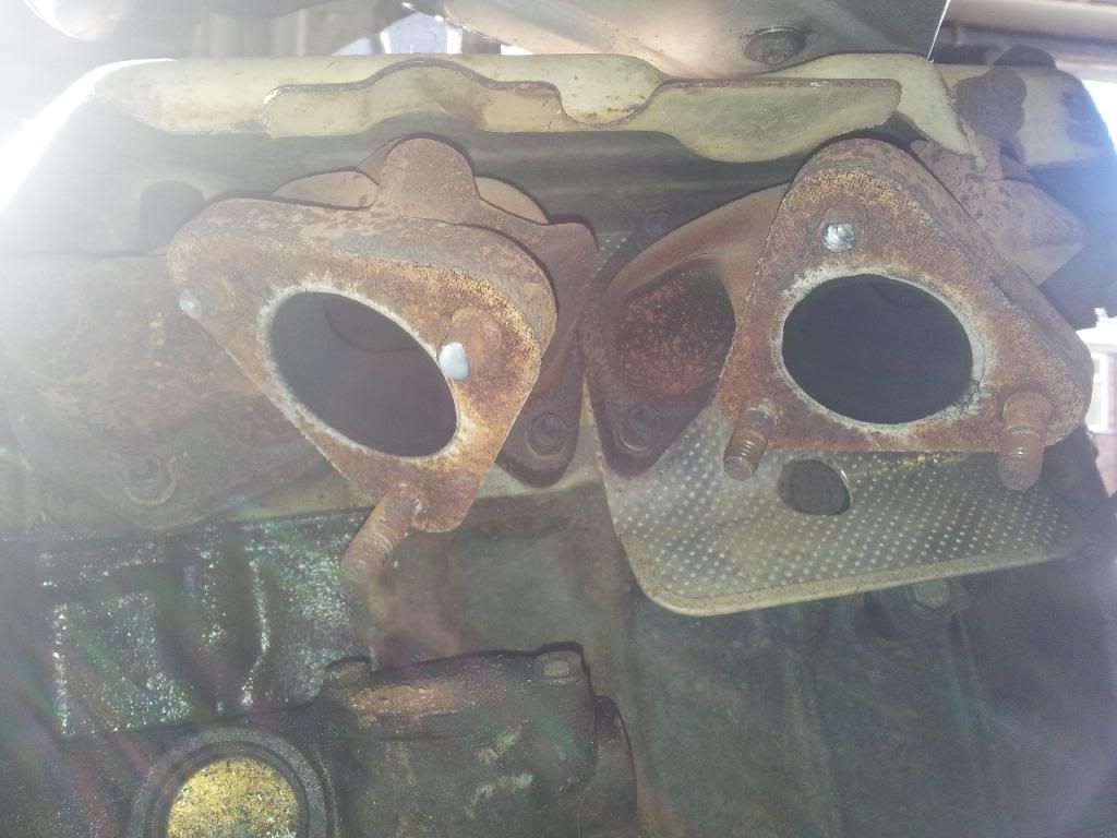

seanl82 23 Posted February 22, 2014 Didn't quite go as planned today. The engine is out, but I unfortunately sheared a few studs from the headers to the downpipe. :( Everything else came out relatively simply. The hardest and longest part of the entire operation was mounting the engine on the bloody stand! Now you see me. Now you don't! A few others One other thing, it doesn't look good, but can anyone identify these parts that were bouncing about at the bottom of my gearbox bellhousing please. Need a new front and rear engine mount I think, so may as well go the whole hog and get the lot. This is starting to get expensive..................:eek: Quote Share this post Link to post Share on other sites
robrado974 1 Posted February 22, 2014 Good idea to replace all mounts while your at it Sean . Nice to see things are coming along ok . Rob Quote Share this post Link to post Share on other sites
ChrisL 20 Posted February 22, 2014 Good work, buy looks all to familiar! and the costs just get worse..... Quote Share this post Link to post Share on other sites
clumpy1 11 Posted February 22, 2014 MMMM unfortunately I think chris is right Sean I am so glad I bought one with most of the big costing bit's already done. Don't let us put you off but mate you are doing a great job :thumbleft: Quote Share this post Link to post Share on other sites
seanl82 23 Posted February 22, 2014 Cheers guys. I can imagine Chris. Just need to keep the final bill away from the missus! It's ok James, I won't be put off and I'll be back for National Day. I've done it before (albeit to a mk3 Golf GTI 8v) so I'm not overly phased by it. Need to start stripping the lump down a bit more and ordering a few more parts, then its a good clean of the bay and powdercoating a few parts before re-assembly. Job done! Quote Share this post Link to post Share on other sites
Dox 23 Posted February 22, 2014 Bellhousing debris look like bits of the clip that holds the thrust bearing release arm to the ball joint in the bellhousing Quote Share this post Link to post Share on other sites

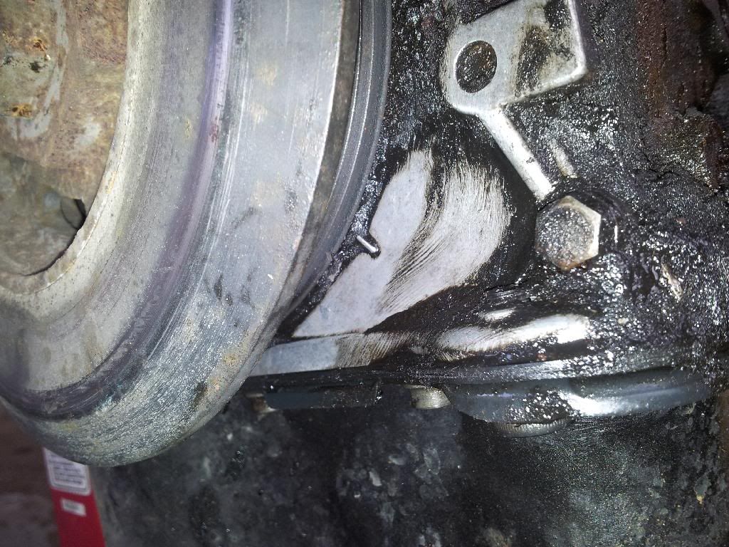

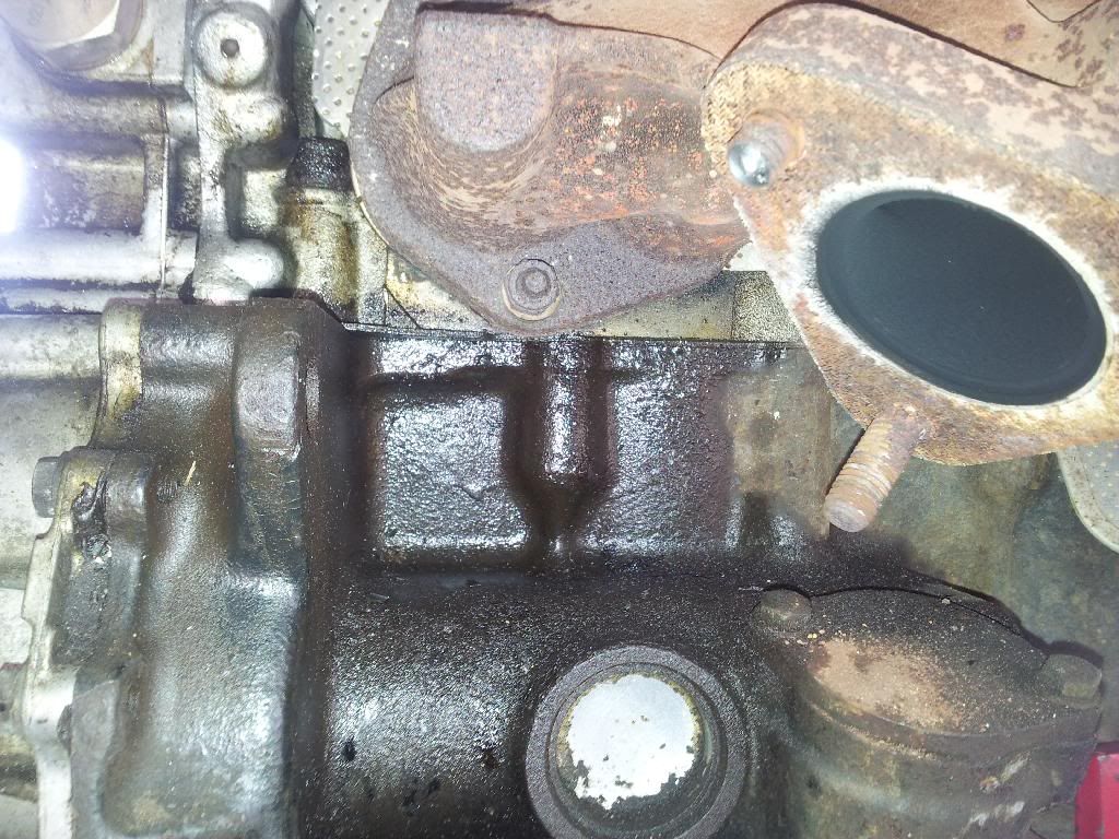

seanl82 23 Posted February 25, 2014 Ok had a quick look around the lump whilst on the stand today, and it looks like the HG has gone, but the other way. Not sure if I'm right, but looks like oil is seeping out between the head and block at the back. This will obviously set me back in time some, as if I replace the HG, the head will need a skim, and I may as well do stem seals, valve guides, tappets etc etc which will cost more and more. This has ****ed me off a bit, as I had the chance to buy a re-con VEGE head in December for £150 to my door like Ian did, but the missus vetoed it as it was so close to Xmas, and I didn't "really need it" :mad2: I'll have another look tomorrow and get some pics up, but a word of warning to others thinking of pulling their engine, when you think of how much money its going in to cost you, whatever number you pick off the top of your head, double it, then double that! This also means it will probably take much longer than previously thought, and I'm unlikely to make National Day. :sad: Oh, I also need a front knock sensor too as that broken, and a crack pipe. On the plus side, my radiator, oil cooler, water pump, drive belt and some seals have arrived, and I got an email from Furniture Clinic to say the colour kit, repair kit, and care kit I ordered have been dispatched. Quote Share this post Link to post Share on other sites

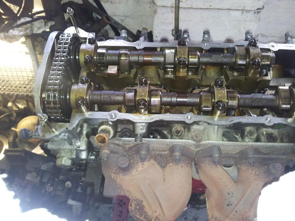

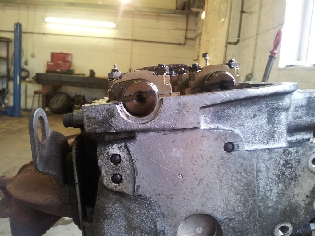

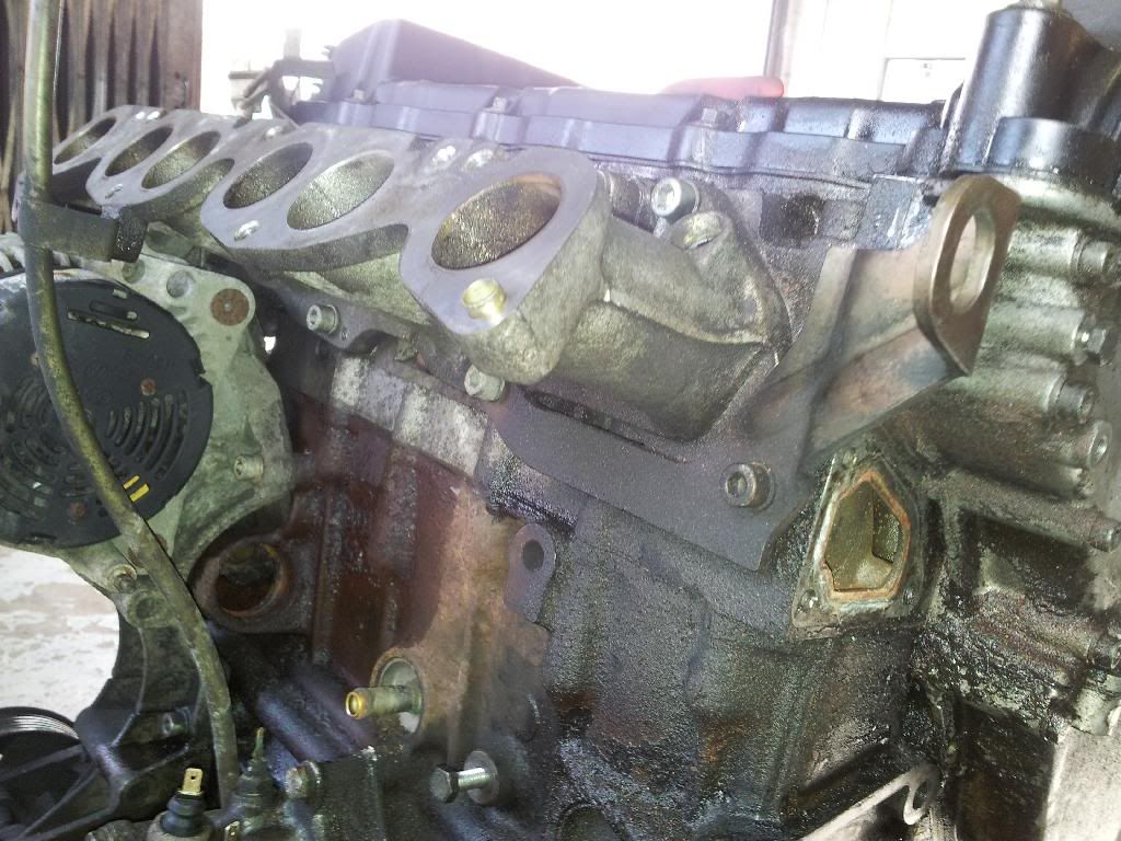

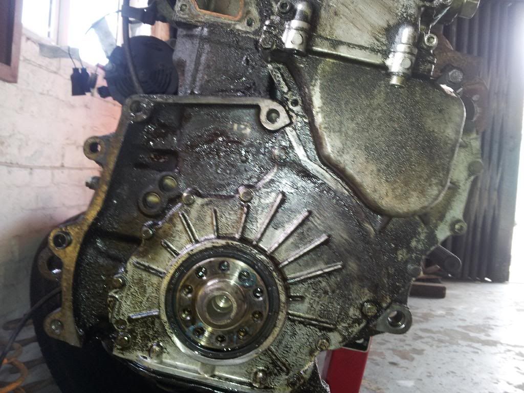

seanl82 23 Posted February 27, 2014 I kind of feel like I jinxed it! You can blame me if it makes you feel any better! I can't blame you mate. Although, I'll put you forward to the missus to blame, it may deflect some of her whining!!! lol Well here are a few pics. Looking very grubby indeed! What I have noticed though, is that I think it had been timed half a tooth out? Crank pulley and flywheel line up at the timing marks correct, but......... With crank aligned. With cams aligned. Here is where the oil appears to be seeping from the HG. Other phots. On the plus side, although the guy that wrote the invoice for the chains and tensioners etc replacement was illiterate as they come (and couldn't time it properly), at least genuine parts have been used and 8k later they still look like new! Quote Share this post Link to post Share on other sites
