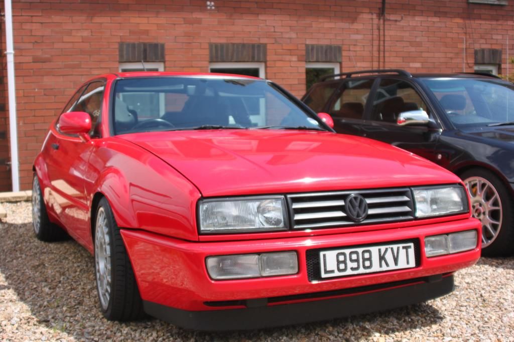

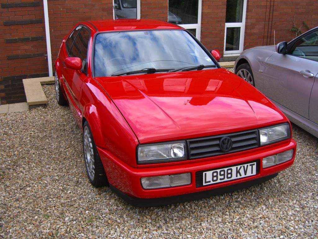

VR6 Gar 10 Posted May 26, 2013 (edited) Most of you already know the car as it is the one James built then sold to Graeme. Well now its mine :cheers: Flew up to Aberdeen yesterday morning then after a bit more haggling on the price a deal was done. Drove 330 miles to Lancs to my folks where I spent the night then got up early today and carried on to Exeter. Didn't miss a beat all the way back. Only thing is it is running really rich, don't know if this was a problem for you Graeme? On the first leg of the journey I managed 27.45mpg. This was mostly Duel c's and M-way with the odd foot to the floor, so I think 30mpg might be possible if driving live a granny. Turns out that my parents live only 4.5miles from the original owner of 8 years. Would have popped round to see if he still lived there but it was after a few drinks I discovered this going through the history. Few small plans for it, mostly remedial. The Track rod ends need doing as do the wiper blades, then its onto things like more sound deadening refurb the wheels and other small bits and pieces. Here it is after a quick wash. On the way back a new M3 convertible came roaring up behind me whilst stopped at some lights for the Duel C out to Exeter airport. Floored it from the lights as did he. Obviously thought I would be easy pickings as he pulled straight out into lane 2. Having to short shift 1st and 2nd he nearly managed to get along side, but by the time I was into third it was bye bye Mr £30k M3. Started to streak away once into 4th and by the time we got upto 130-140 I was a good few car lengths ahead and I was very close to my junction so backed right off. He was still in the outside lane at this point and continued to floor it passed despite being well and truly spanked.:smug: This made my journey as I had the GF in the passenger seat and he was on his own. Edited September 2, 2014 by VR6 Gar Quote Share this post Link to post Share on other sites

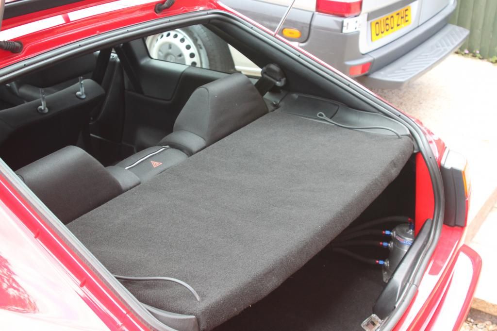

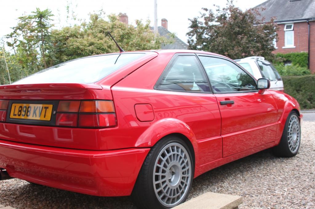

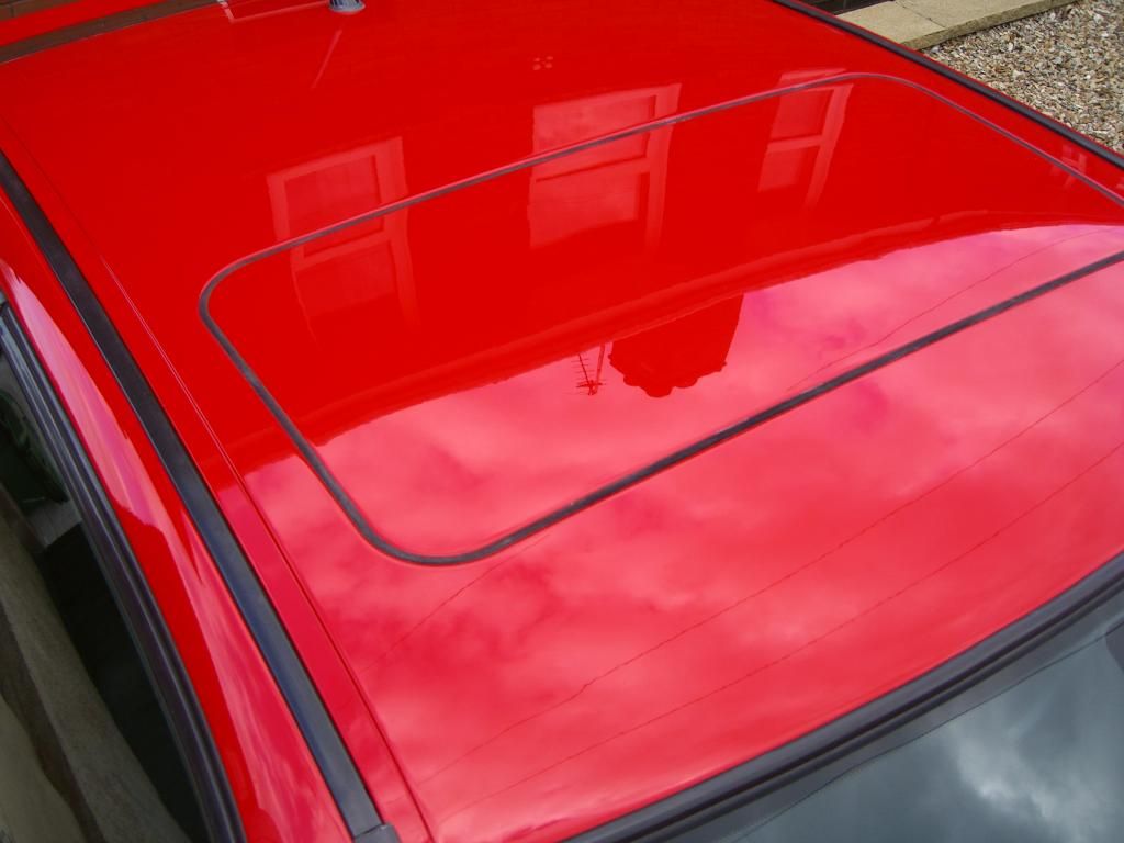

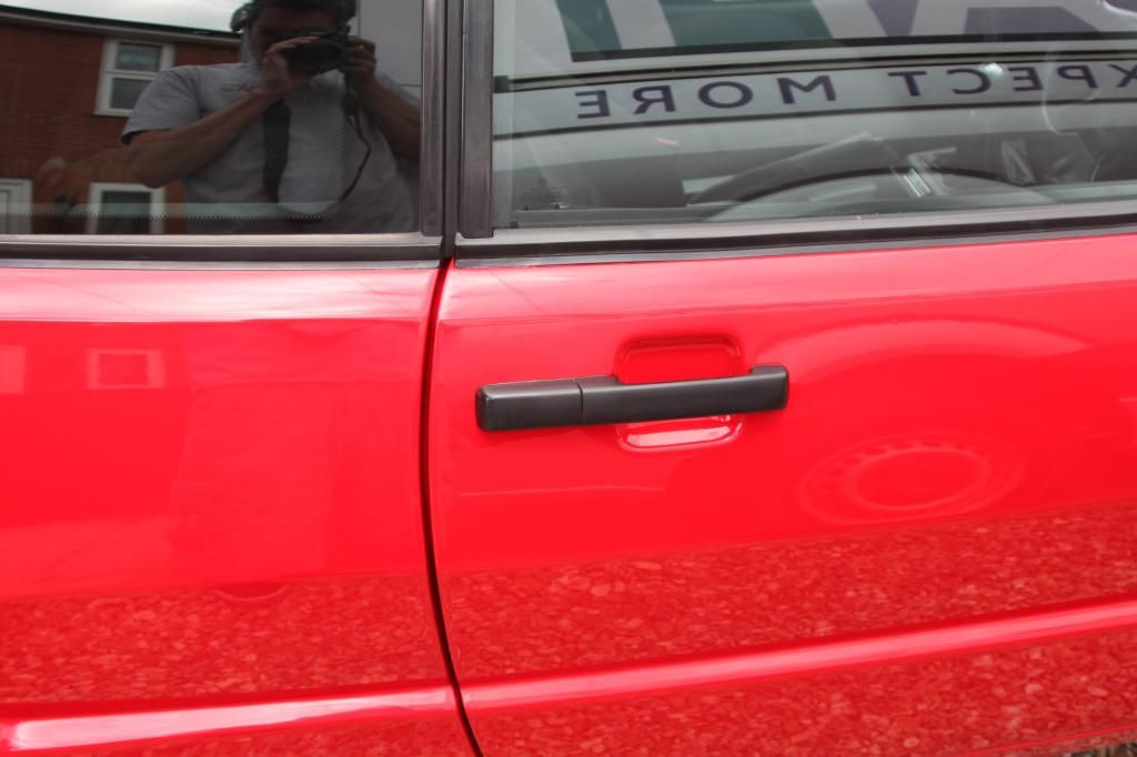

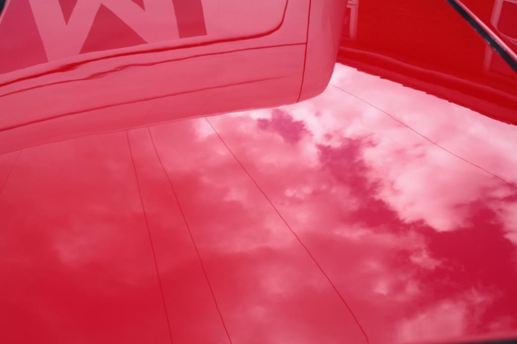

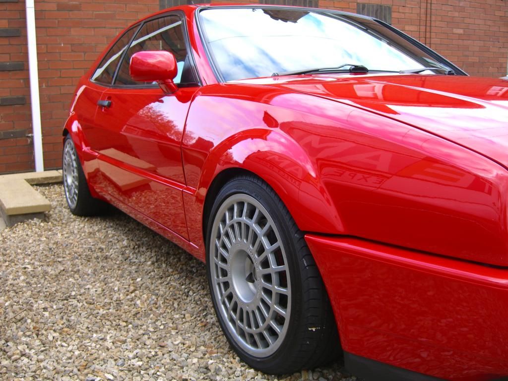

VR6 Gar 10 Posted June 2, 2013 Found that the wastegate to exhaust bolts have gone walkies so got some new ones on order. As such the car has been off the road all week. In that time I have, Replaced the front speakers that were shagged with some cheap Alpine components. Replaced the single middle washer jet that did an appalling job of spraying the screen with 2 mist type jets found on Citreons and Peugoets etc. Also fitted new Bosch Aero blades and bent the arms a bit so have a fully effective wiper system. Been on a cleaning mission. The roof and bonnet were covered in what looked like water marks, but ingrained into the paint. :? About 7 hours of T-cutting later, a few layer of paint removed and some sore arms and fingers the car was looking much better. Gave the rest of the car a quick T-cut as well to remove any hazing that had built up since its respray, then Poorboys Black Hole and Meguires Deep Crystal Carnuba Waxed it. The parcel shelf has 6*9s fitted so covered it with some black cloth I had left over from a few years ago when I did the same to my last Corrado. Also blacked up the handles that were looking faded. Looking forward to getting the bolts on so I can start enjoying it again. Got got a new Kenwood headunit on its way to replace the old Alpine one that has no connectivity other than cd changer. Quote Share this post Link to post Share on other sites
seanl82 23 Posted June 2, 2013 What sort of Fabric was it that you used on the parcel shelf Gar? I've got to cover mine due to an holes from 6x9s, only I need beige stuff. Quote Share this post Link to post Share on other sites

VR6 Gar 10 Posted June 2, 2013 What sort of Fabric was it that you used on the parcel shelf Gar? I've got to cover mine due to an holes from 6x9s, only I need beige stuff. Some stuff I got off ebay. Acoustic cloth or something like that. Beige may be a problem though as it seems to be black or dark grey. Quote Share this post Link to post Share on other sites
Jon_vr6 1 Posted June 2, 2013 Looking ace fella, paint work is immaculate Quote Share this post Link to post Share on other sites
JEZR 10 Posted June 2, 2013 That's looking a real treat. Very tasty! Quote Share this post Link to post Share on other sites

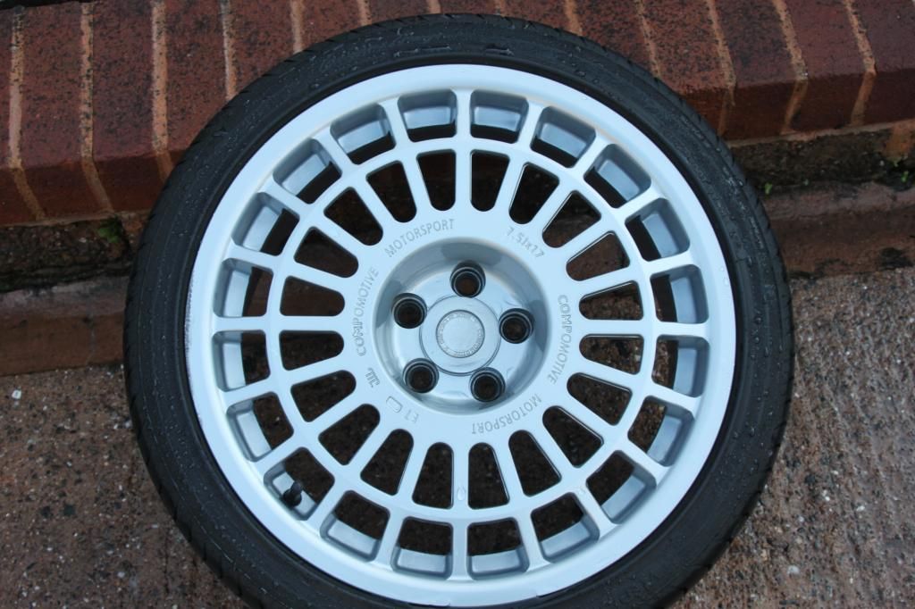

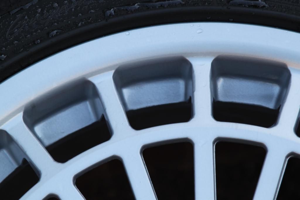

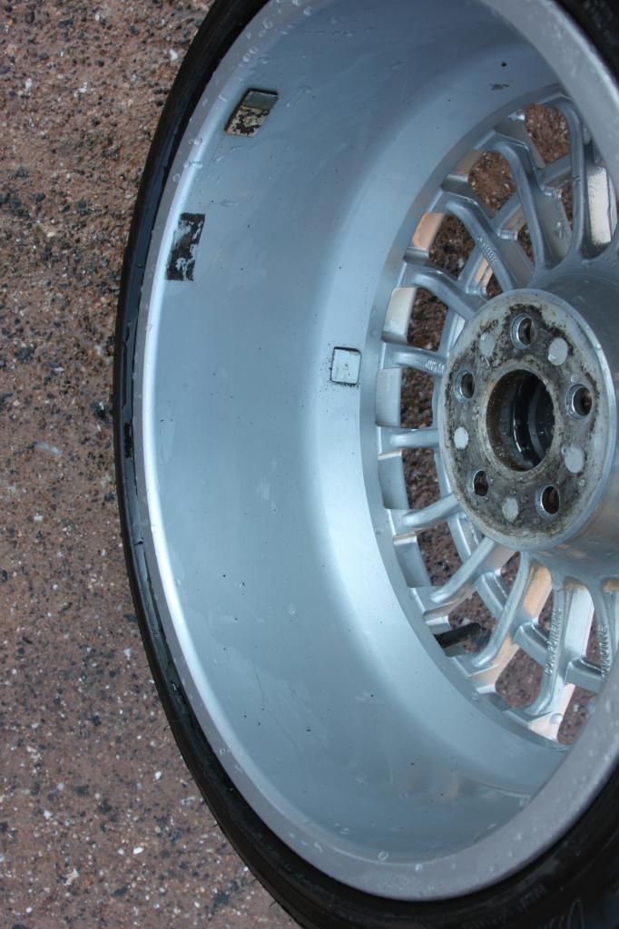

VR6 Gar 10 Posted June 3, 2013 Still waiting on the bolts so had a front wheel off for a quick clean to see how it would come up. An hour later and it's almost like new. (apart from the kerbing) Quote Share this post Link to post Share on other sites
coullstar 0 Posted June 4, 2013 Good work, I kept it clean but never really polished / detailed it. Its amazing how it shines when clean though. Quote Share this post Link to post Share on other sites
C5 OEM 0 Posted June 4, 2013 wow, thought t-cut was outlawed .....lol Quote Share this post Link to post Share on other sites
VR6 Gar 10 Posted June 4, 2013 wow, thought t-cut was outlawed .....lol Ha, had a go with AG super resin polish and it did nowt to remove the marks, so out came the T-cut, and what a brilliant job it did. Quote Share this post Link to post Share on other sites
seanl82 23 Posted June 4, 2013 T-cut does what it says. Cuts the paint back by removal. It doesn't have much refinement though as its quite harsh and is a non diminishing abrasive. SRP only has very very light cut though. Its centred around fillers so doesn't remove the scratches/swirls, it only masks them. SRP won't offer the depth that the T-cut will by its very nature. SRP after vthe T-cut would make a good combo though, then a wax on top to protect it and make the shine last. People become product snobs that have been around detailing for a while, thats why T-cut gets written off tbh. It does what it says, but there are better products on the market now as its essentially the same formula that your granddad used to rave about when he put it on his Ford Anglia all those years ago! :lol: Quote Share this post Link to post Share on other sites
