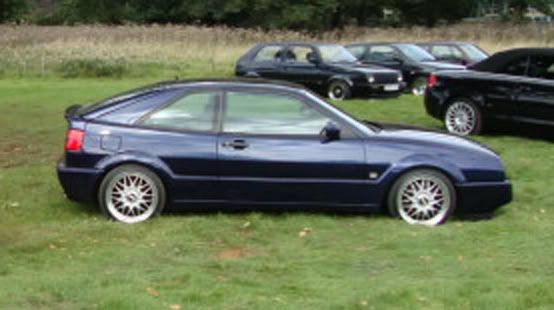

so this is the only pic i have as i bought it (well other than the grill) the only things that had been done were
1 - had been lowered using jemex lowering springs
2 - had been sat on those 17" five spoke wheels
3 - they had removed the air filter box for a cone filter
other than that it was standard and in mint condition took me ages to find one in good condition they either smoked or had a different shade of paint on every panel argh, so ended up looking back paying over the odds to get this one but i was the happiest 24 year old in the world and didn't care one bit just wanted to drive everywhere and petrol was less than a pound so i could haha

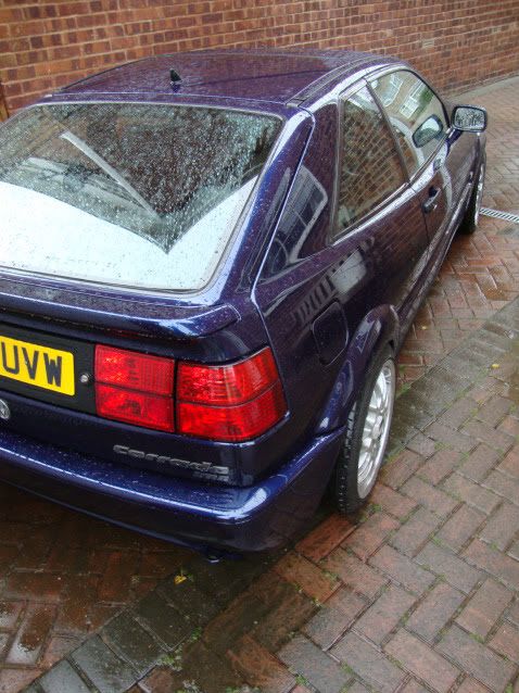

So my mod was the debadged grill which you see in the pic above took all of about ten mins to fit that

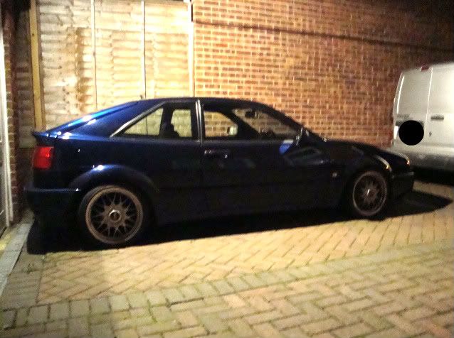

so next was i wanted it lower and the wheels are not really my taste should have also said that i got the original wheels, springs and airbox incase i wanted to make in standard again as i had no intention of going to far just wanted a nice run around
well back to the thread

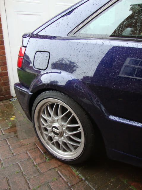

first i got some fk coilover and broke my mechanical cherry never done anything like before was rather easy when you actually start messing and get the seized bolts off (i always like messing with things tho but i had no idea what this car had in store for me )
next were the wheels

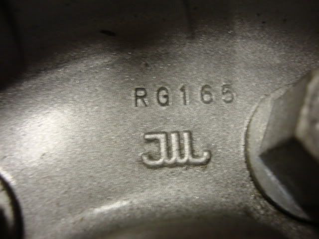

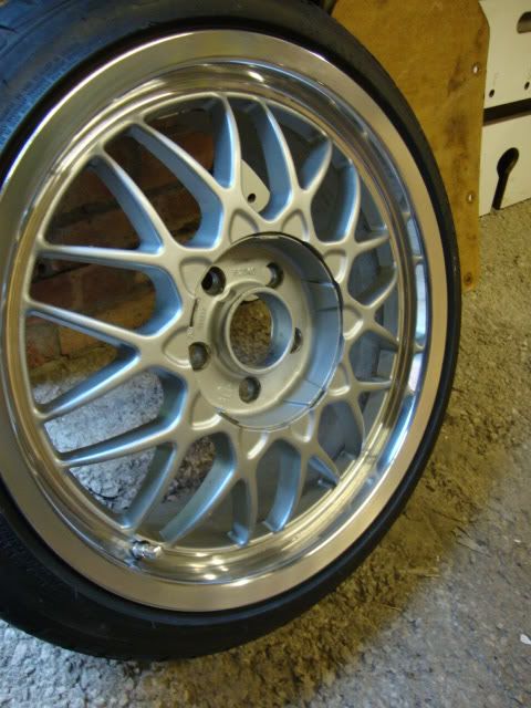

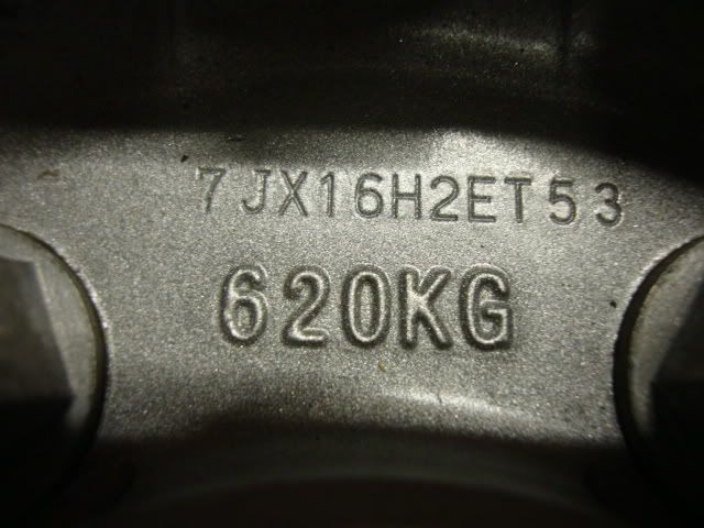

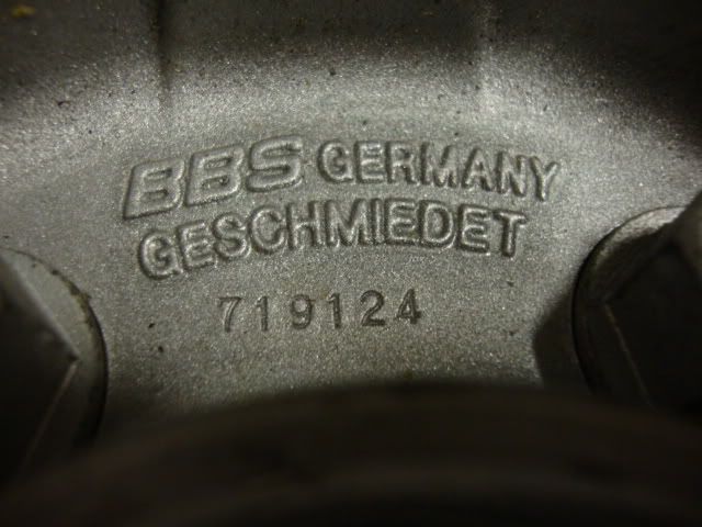

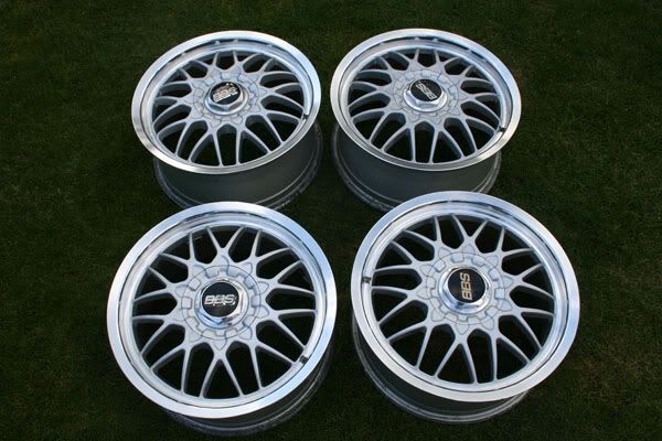

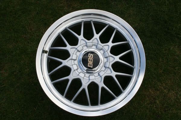

found some guy selling some bbs RG in 5x100 believe there off a Subaru not ever seen them before or since and they just caught my eye the only problem was they didnt have the correct centre bore was smaller than vw and really high ETs
well these are the wheels
so thats the wheels as they were advertised and nobody seemed interested they were on edition tho so i guess back then if they weren't BBs RS nobody even looked
so first job with the wheels was to increase the centre bore being a joiner i had a router sat in my garage and a crazy idea that if i was slow enough id be able to free hand the centre bores to the right size so did and it worked fine so job done
then had to increase the ETs so bolted the wheels on and measured them up to where i wanted the wheels to end up so the back got 45mm spacers and the front 35mm, bolted them on slammed the coilovers down and it ended up looking like this
(which i thought looked pretty good even if i do say so myself haha)

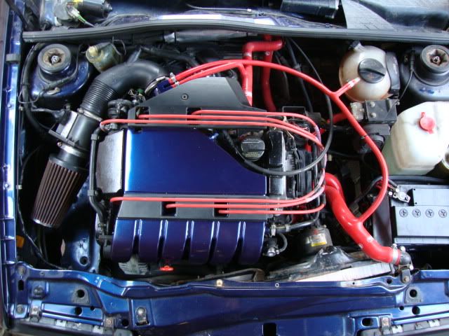

next was the engine bay
i have thing for engine bays haha
so like i said above the bay was untouched and as standard as they come with all the bits other than the cone filter but after 12 years it had seen cleaner days and the some of the bits were getting past there sell by date, the first to break was the water pipes and i had a spark issue so decided new magnecor leads and samco hoses were in order and might as well have a little spruce up at the same time so with not that much work it ended up looking like this

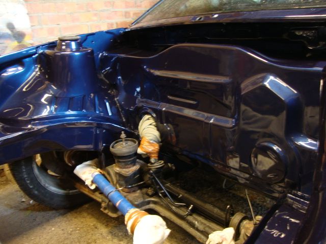

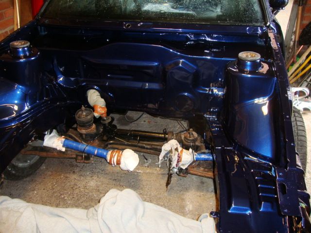

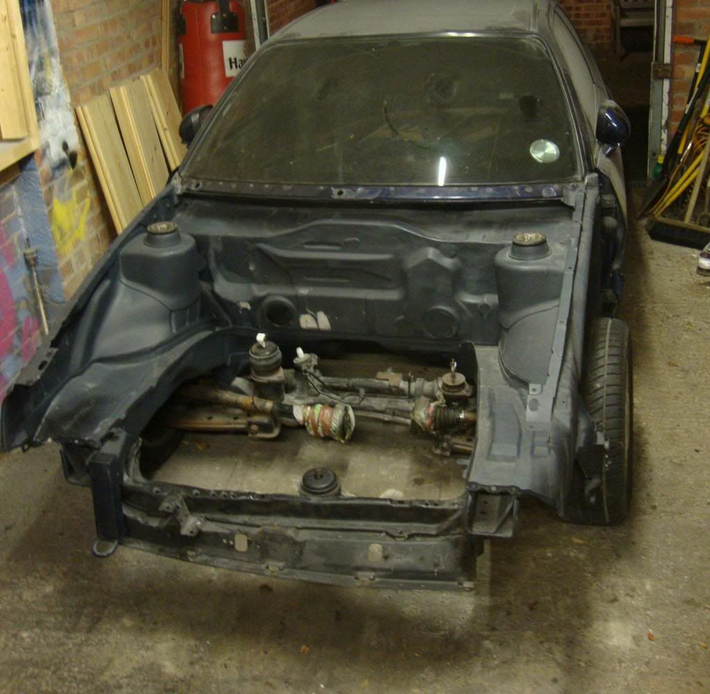

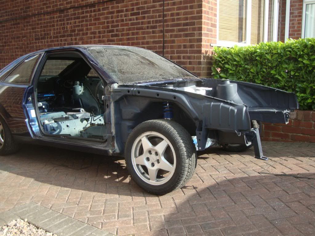

next part engine bay

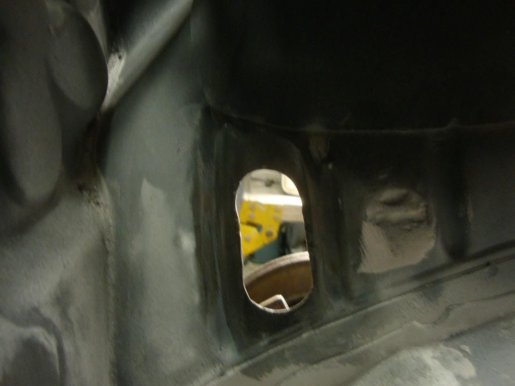

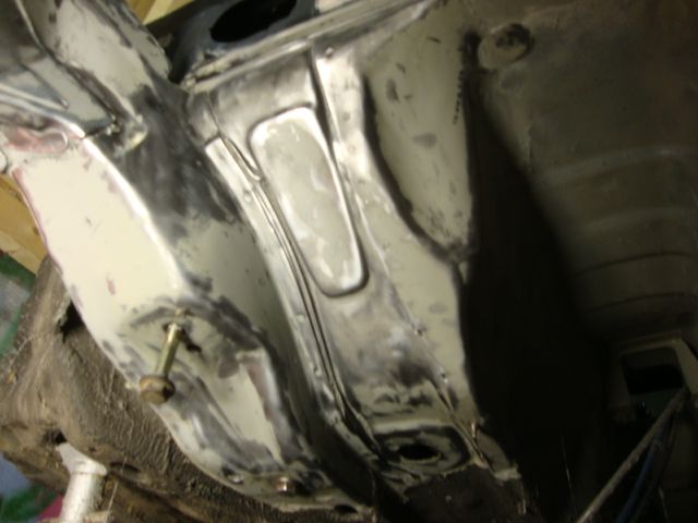

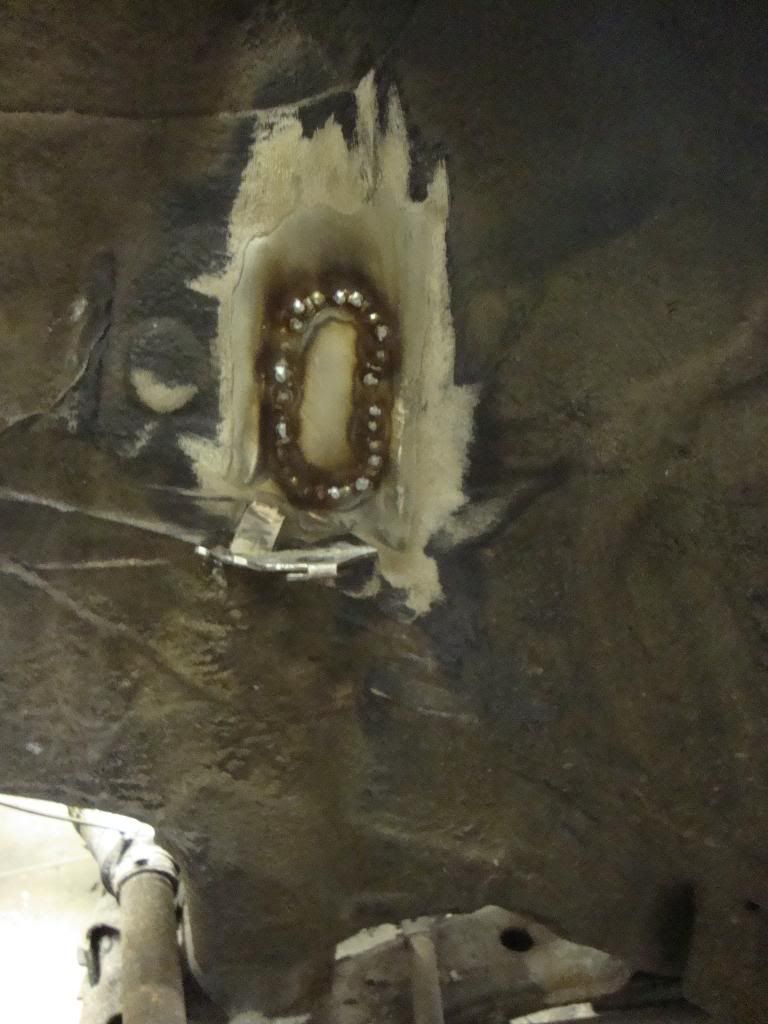

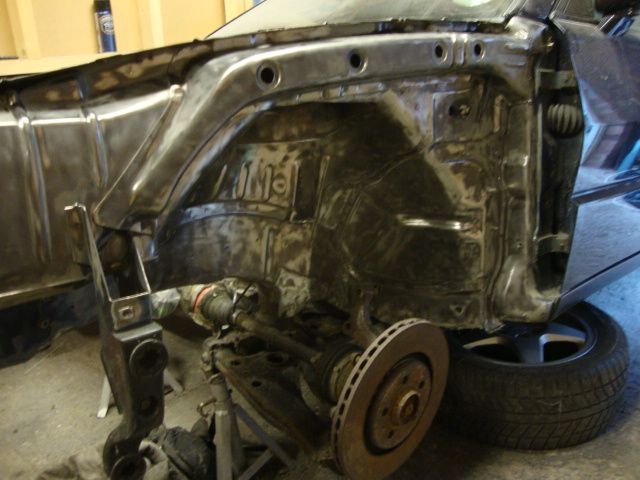

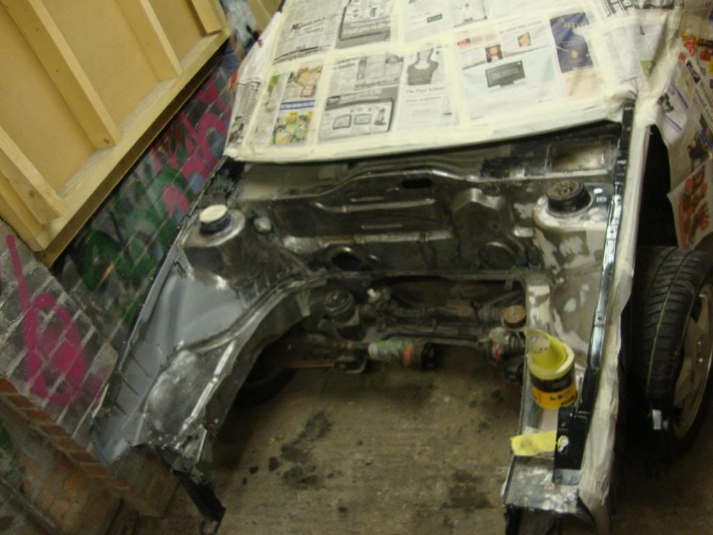

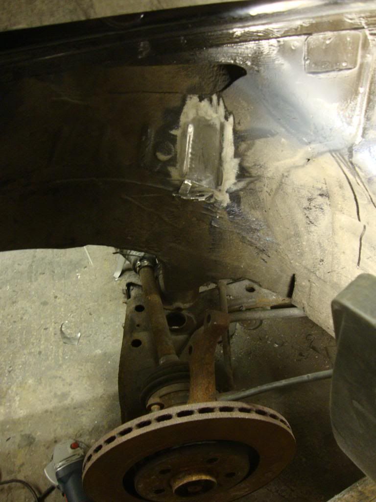

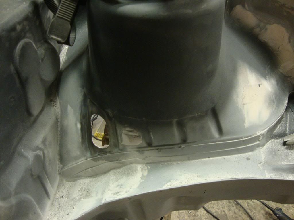

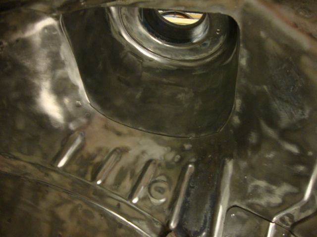

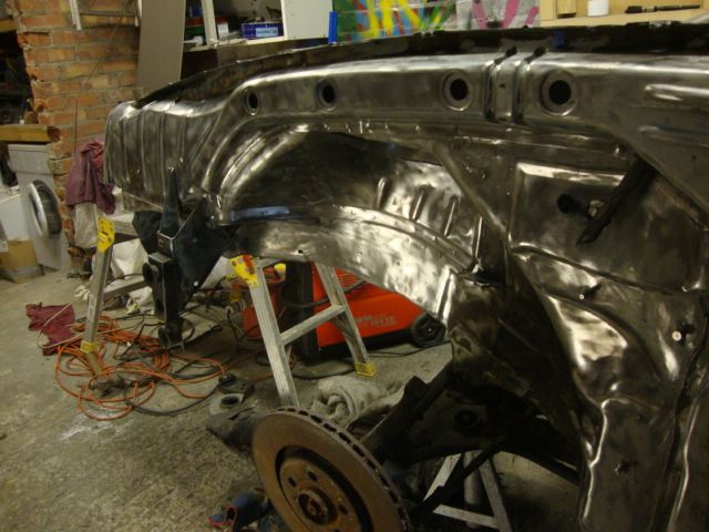

well this sort off happened by accident like i said before i have proper love for engine bays and with a little to much time on my hands a grinder welder and ear plugs this happened (i did have over 500 pics of every detail but my hard drive died and i lost them so only have few left but im sure you will the idea
so what got removed (everything)
abs binned
servo binned
water pipes for heaters deleted and re routed or will be
brake lines re routed out of engine bay
every hole welded up
every bracket cut of
rain tray removed and chassis number relocated

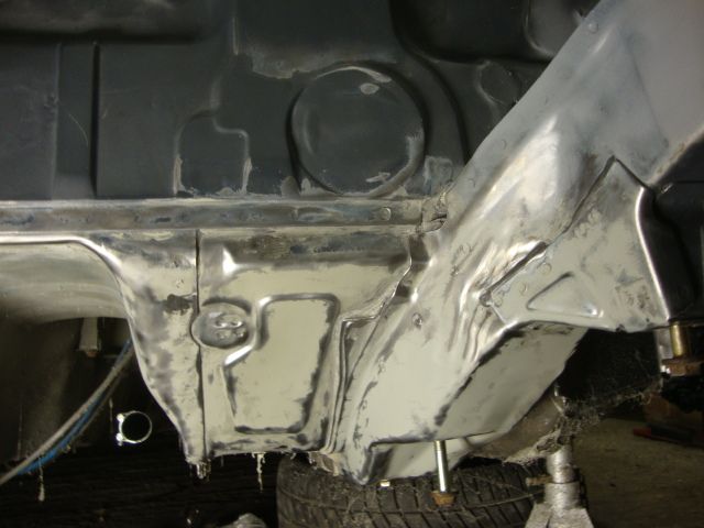

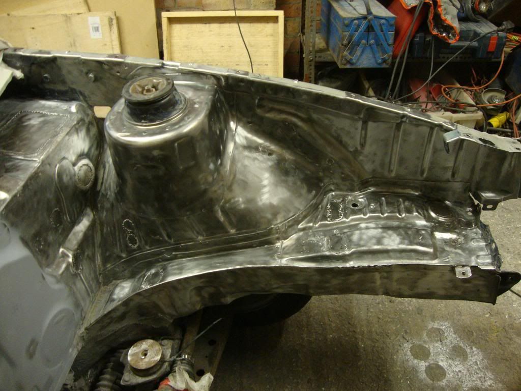

this was a labour of love the time spent with a grinder in hand with a wire wheel on must be a solid week (never going to do it again) to take the bay and inner wheel arches back to bare metal to see what i was working with there was hardly any rust if any so had a great base to start from
any way i'll let the pics do the talking

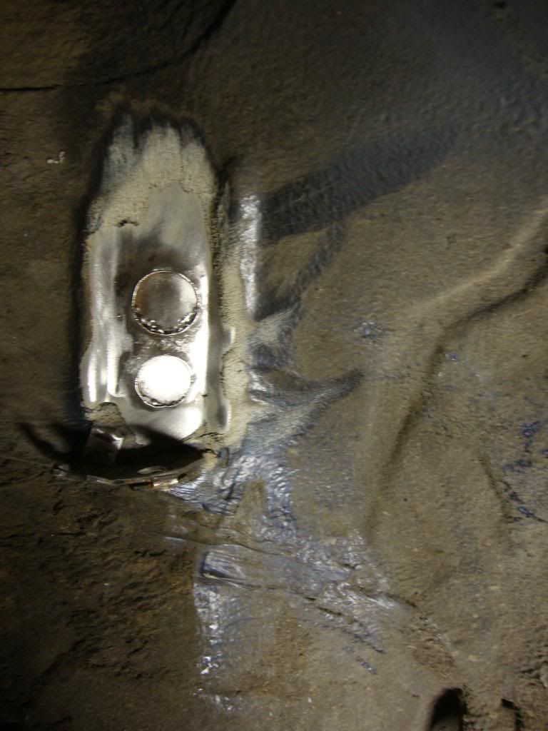

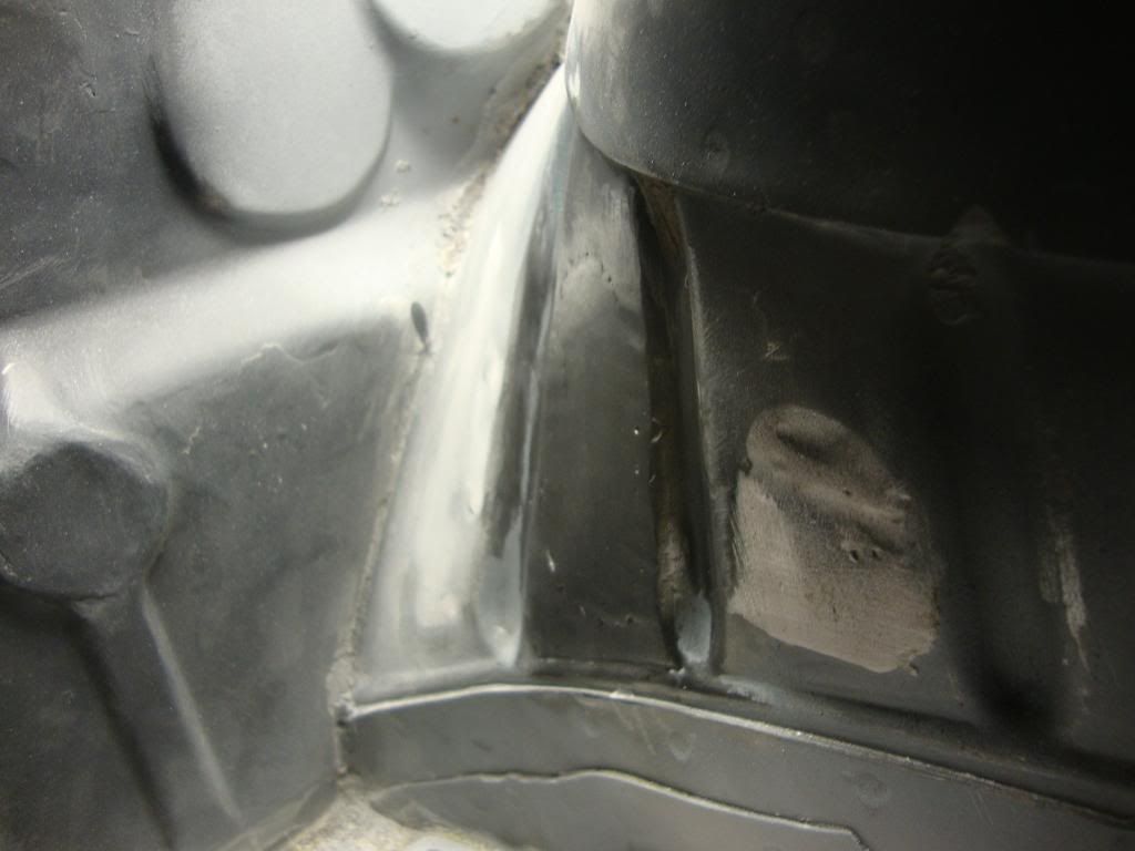

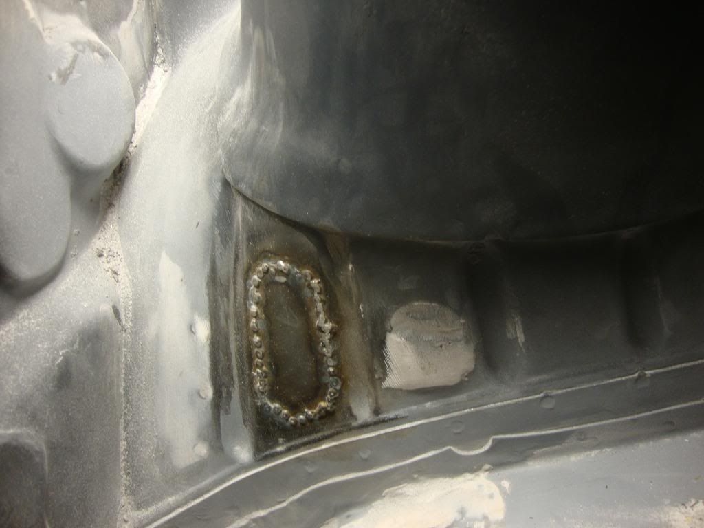

these are the only pics of the welding that was done by me (took a little time to learn how to weld blew a few good holes in the begging but practise means you have to improve i think haha)

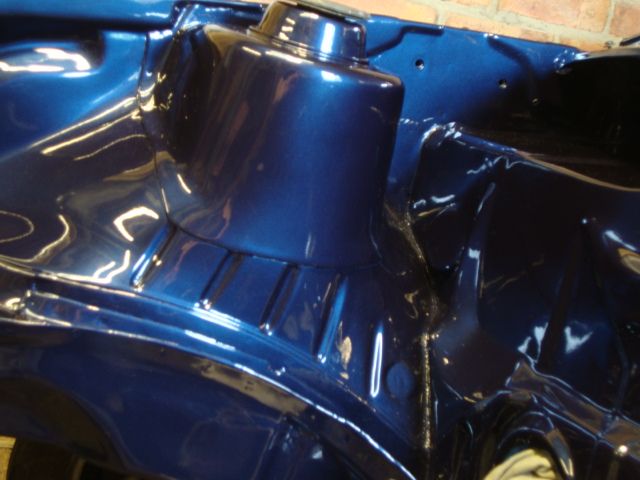

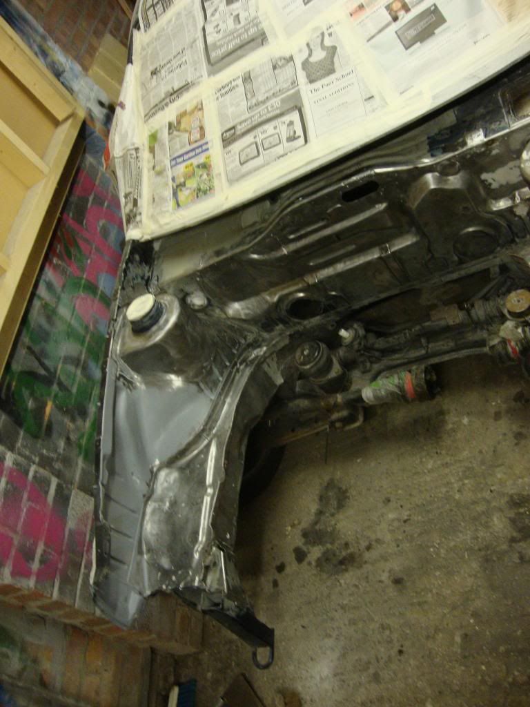

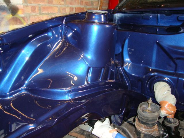

then i etch primed it while i sent it for paint

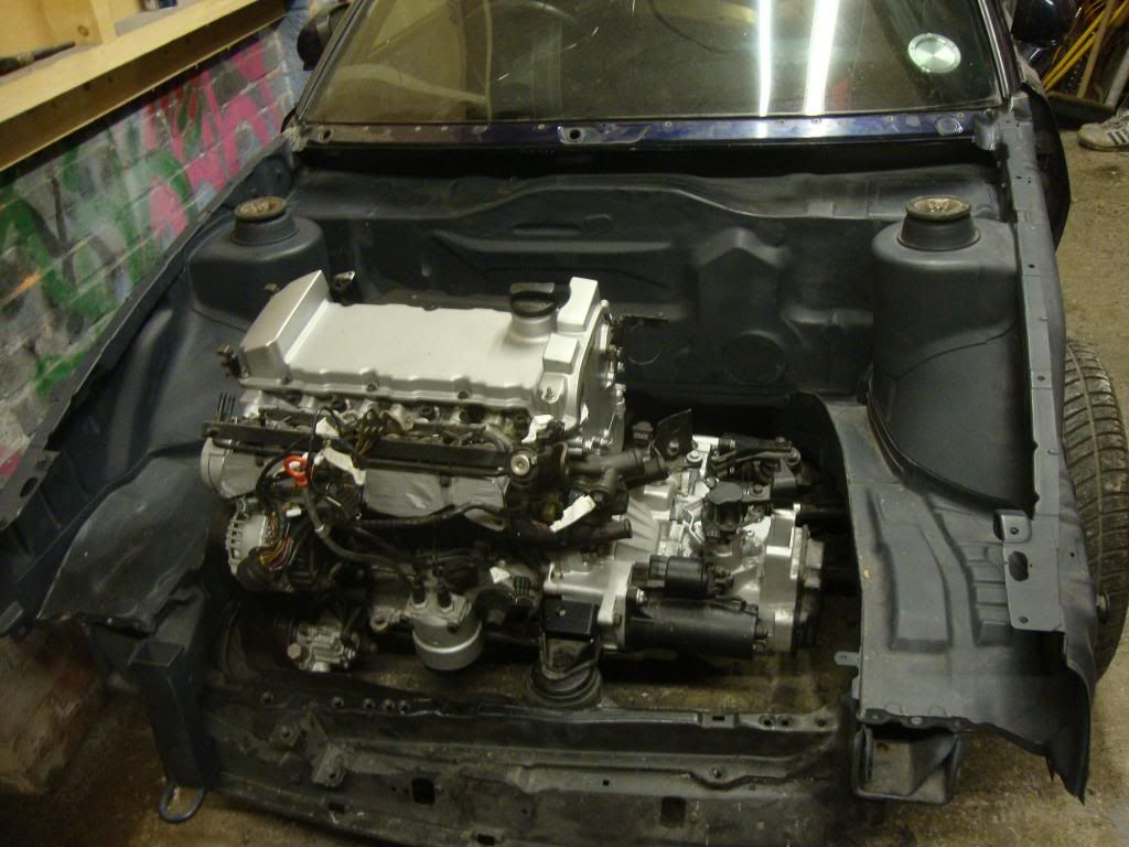

trail fit the engine to get an idea what its gunna look like
and then finally painted
well that will do for tonight
nice work lad. i've got that clarke welder too, good unit :)
Looks excellent! May as well get the subframe off and and painted up/powdercoated whilst your at it!
I do like a nice clean and fresh bay, I will get onto mine at some point..........
CHEERS GUYS AND GALS for all the nice comments hope you enjoy the rest of the build :cool:

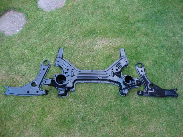

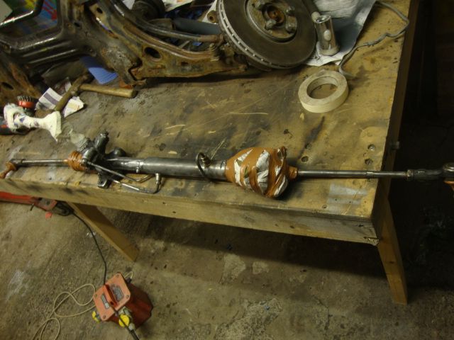

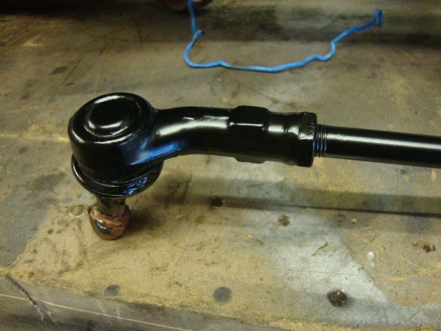

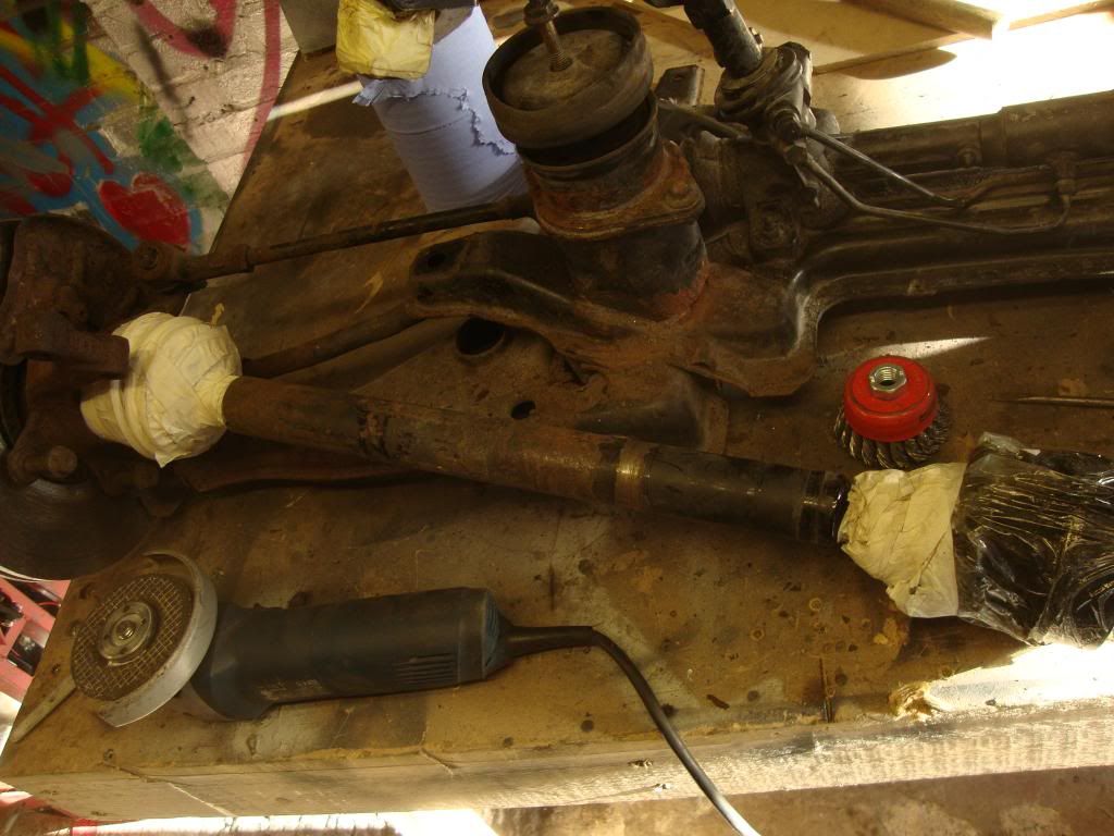

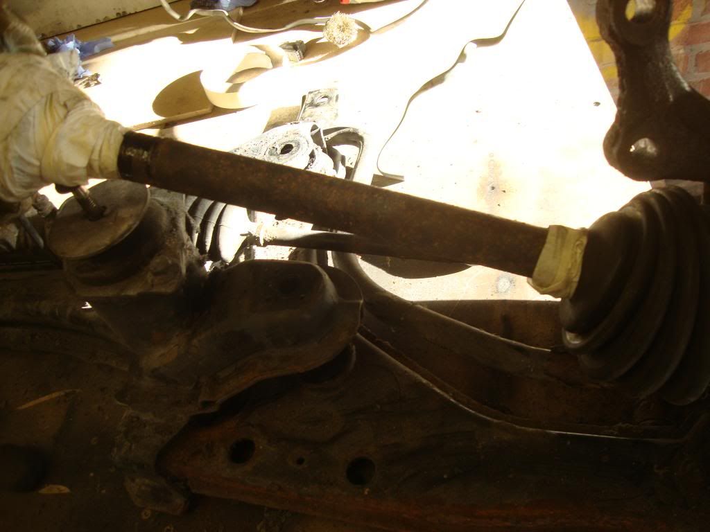

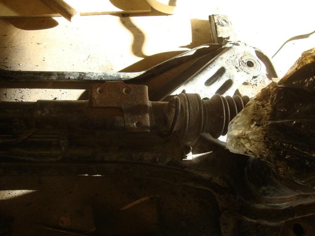

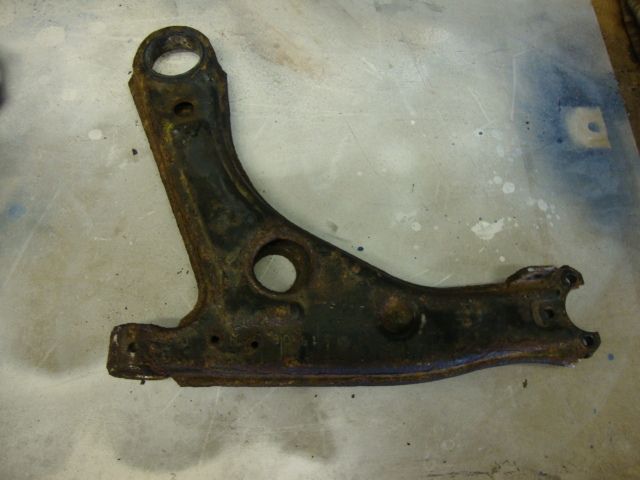

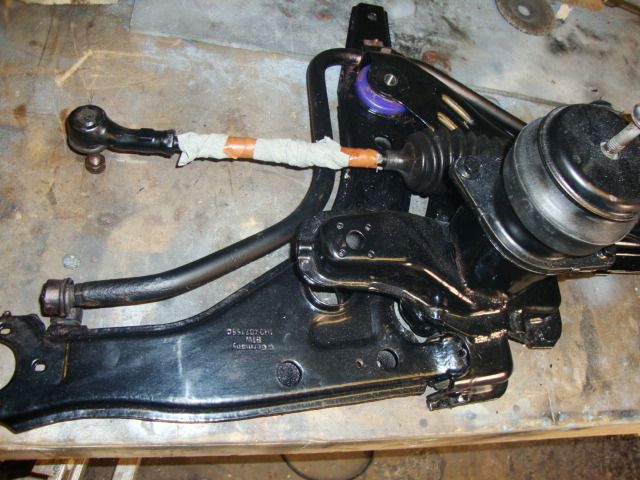

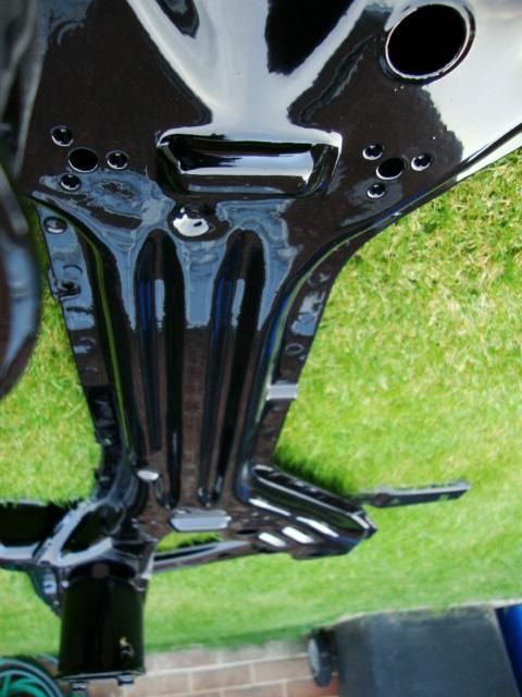

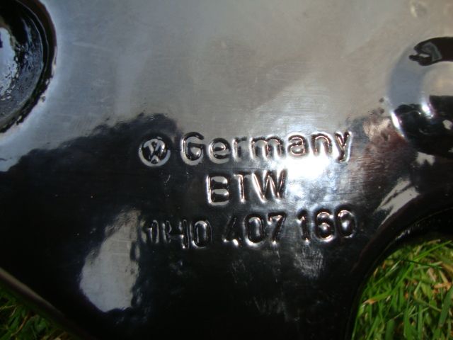

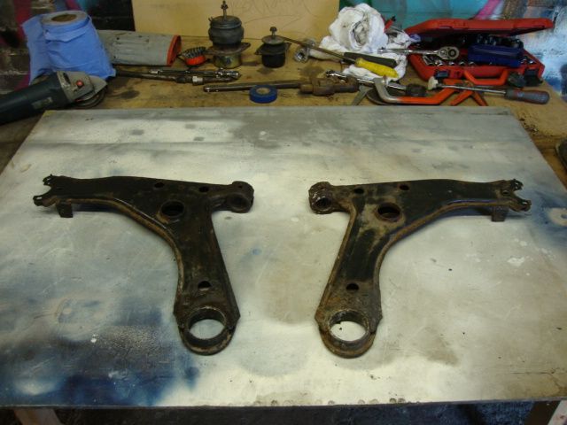

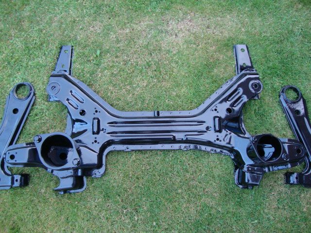

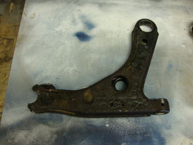

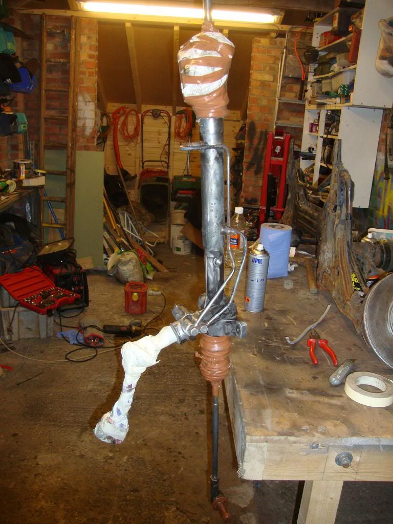

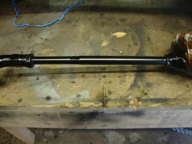

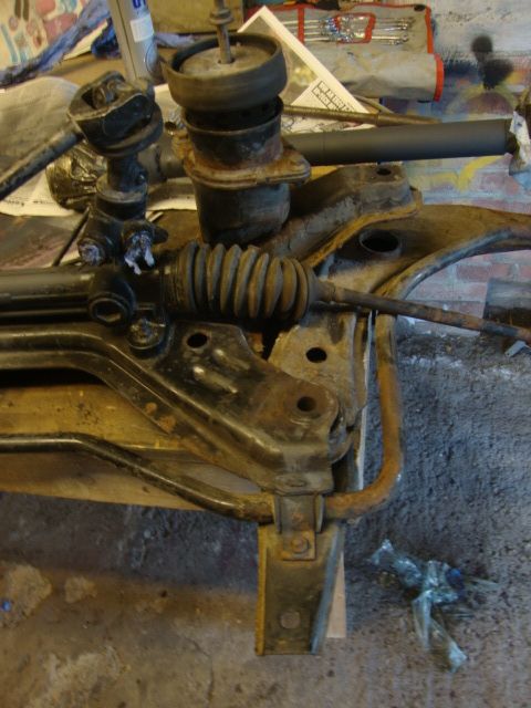

SUBFRAME REVAMP
So as the engine was out and the subframe was of it would of been sacrilege to bolt the sub frame back up in the rusty state it was in and at the same time i put some power flex bushes in
so i'll just put the pics up

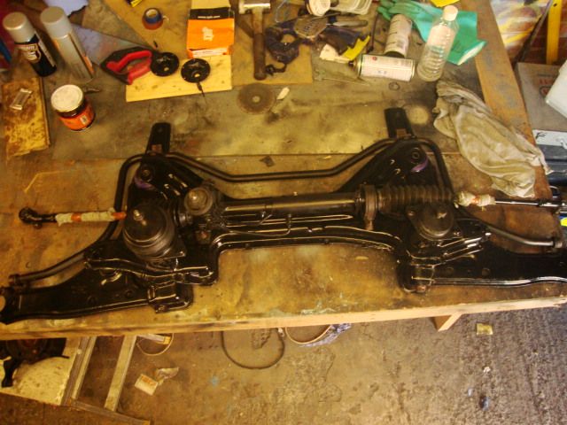

so that's how it was and then this is how they look now

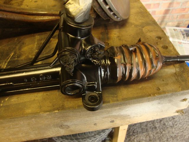

and then the power steering rack got a new lick of paint by me
and that's that sorted for another 15 years

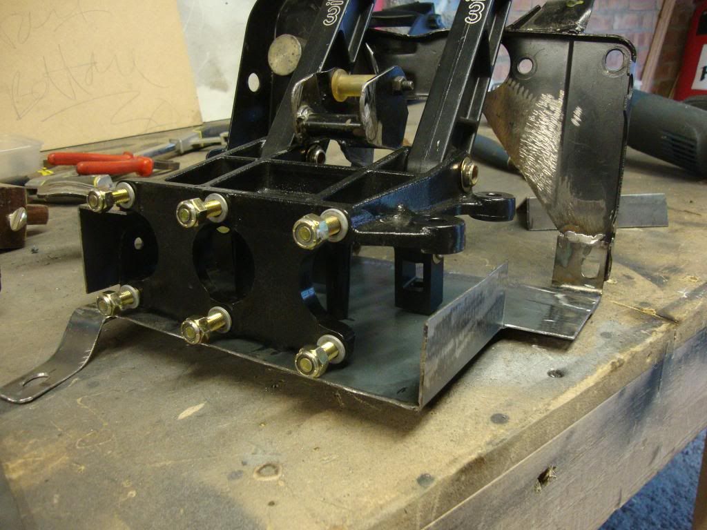

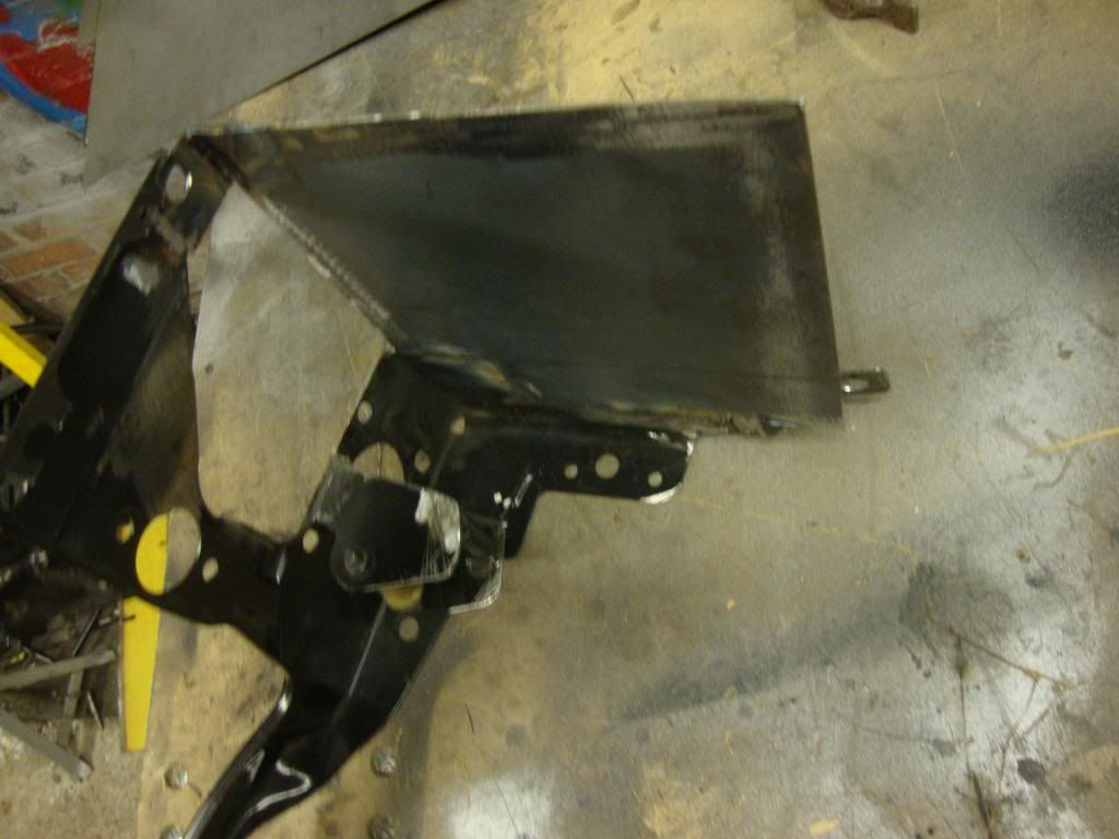

so for my fav part of the car

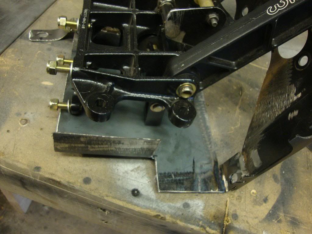

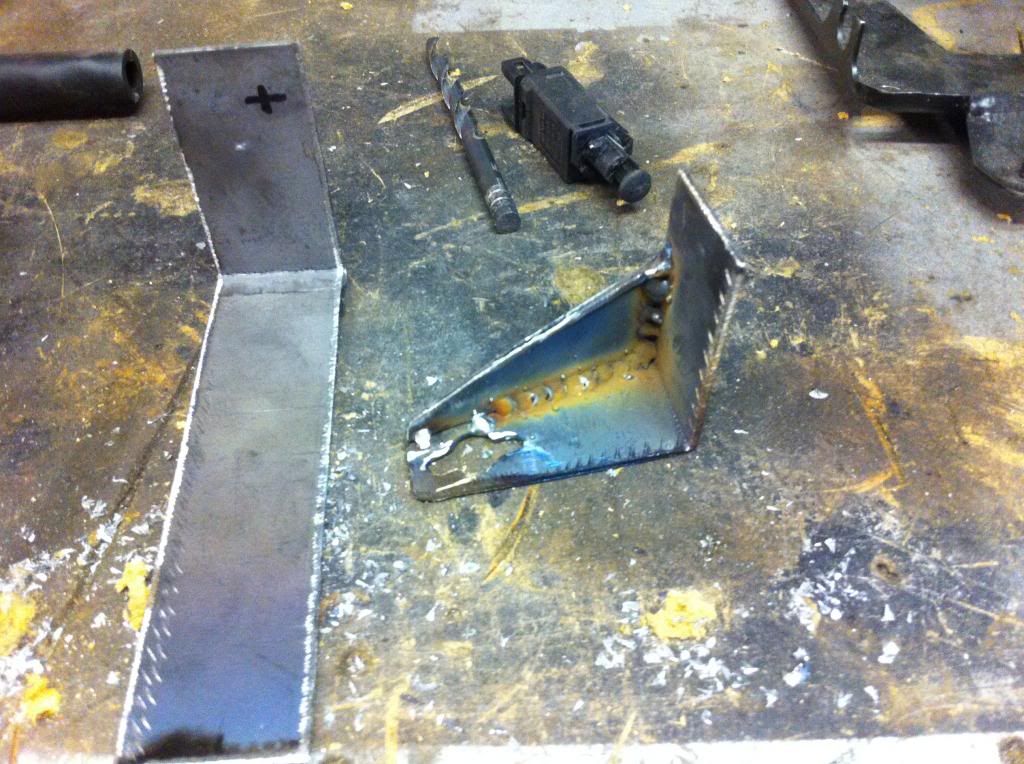

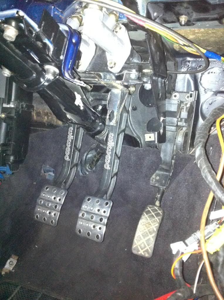

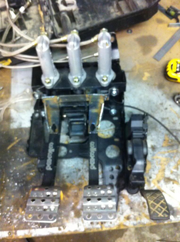

wilwood pedal box

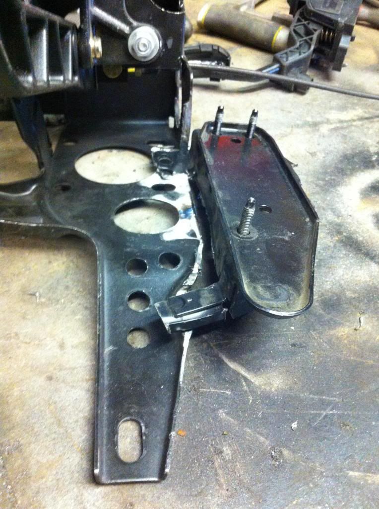

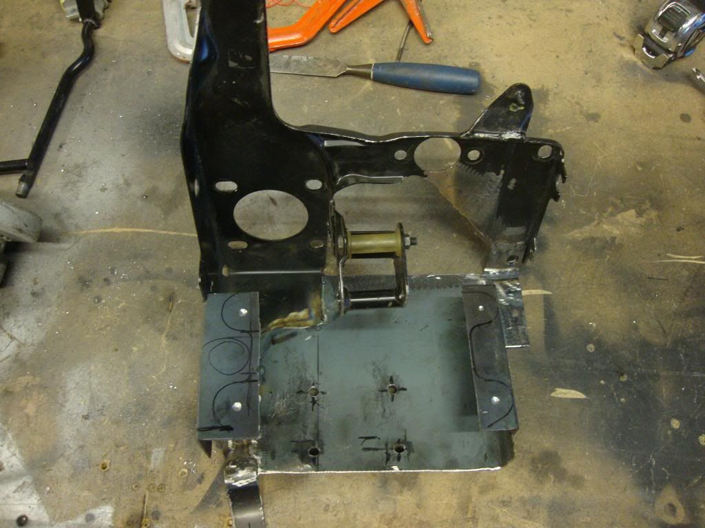

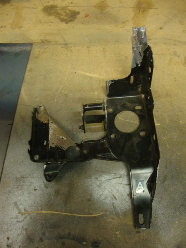

well as most people know the vr brakes feel like **** so decided that id get rid of the ABS servo everything and fit a wilwood pedal box for some reason i just love how they look there just sick as sorry getting over excited hahaha well ill let the pics do the talking
so one thing i wanted to do with my car was to make sure what ever i did it made things as original as posssible (i know i know haha wilwood pedal box plus weld every hole in the bay and get rid of the ABS haha)

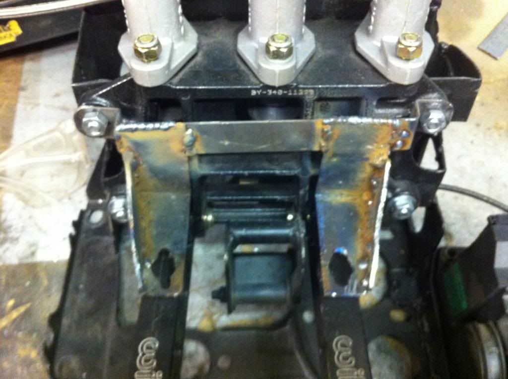

but really as i had no idea where to start with this part i just thought right i wanna mount it on the original pedal box and go from there, it had to mount to the original mounting points as well. so all i did was cut the vr6 pedal box of everything i wasnt going to use and then just make it as big as posible.
then make if fit and hold up the pedals to see where they had to be (i mean they had to go either side of the steering colum) and go from there not to sound like a dick but got it pretty good first time
i used the accelerator pedal to judge how far forward the pedals needed to be then used them to set the DBW ( for the next stage haha)
well im not gunna bore you so thats it hope you like or hate haha
Like,
You will notice the difference without a servo !
What m/c size(s) are you using?
Are you going with the remote adjuster for the bias box ?
Good luck

is that good luck because i'll need it :thumbleft: sweet haha
well the pedal box has a 6.25 to 1 ratio on it
the 2 brake master cylinders are 0.625 x2 (was gunna go a size up for the front brakes but a friend who has run one said dont bother unless you want a massive leg haha)
and the clutch is 0.7 i think tbh it was over two years since i got them was told that i might need to go bigger on the clutch but for now we will see
yeah got a wilwood flexi dash mounted adjuster not decided where to mount it yet dont want it sticking out like a piece of ****
all the pots will be on braided hoses and hidden in the dash thats my second biggest hate seeing nice bays then brake fluid pots sat in the the bay, i mean you go to all that trouble to tidy the bay then stick pots in the rain tray, damn, right behind polished intercoolers hanging out of the front bumper (at least paint it black) haha
at the end of the day if it doesnt work better than the vr i'll just source a bigger servo and refit that as i dont want sh!t brakes

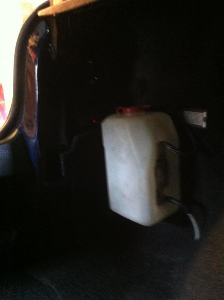

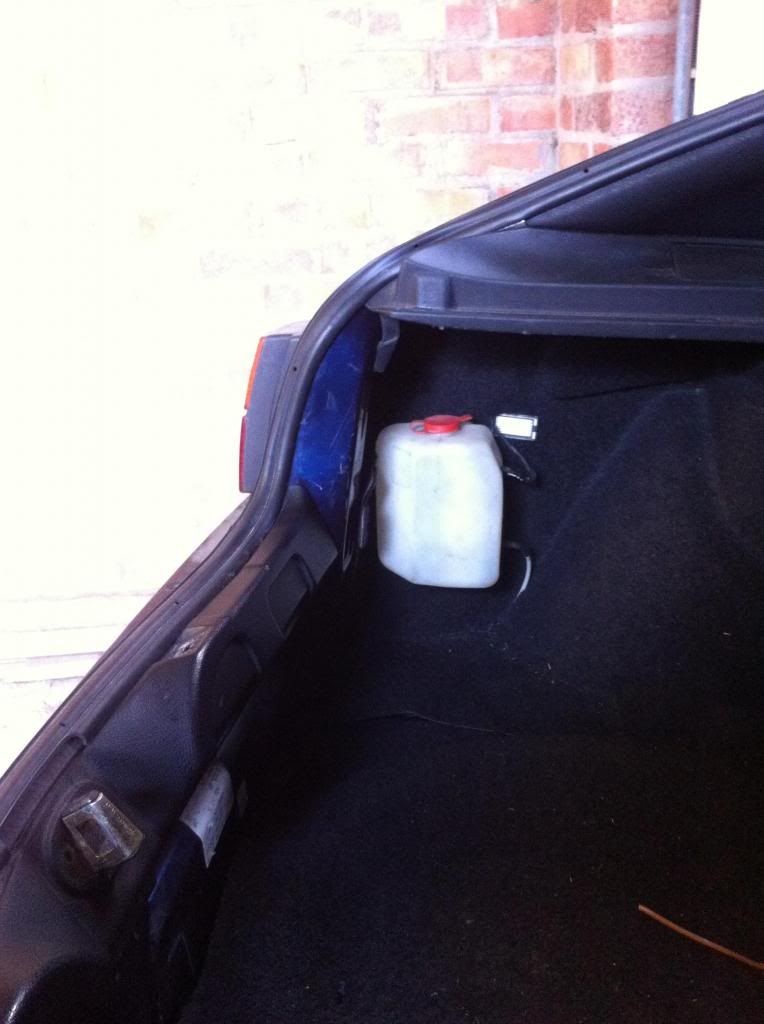

little update

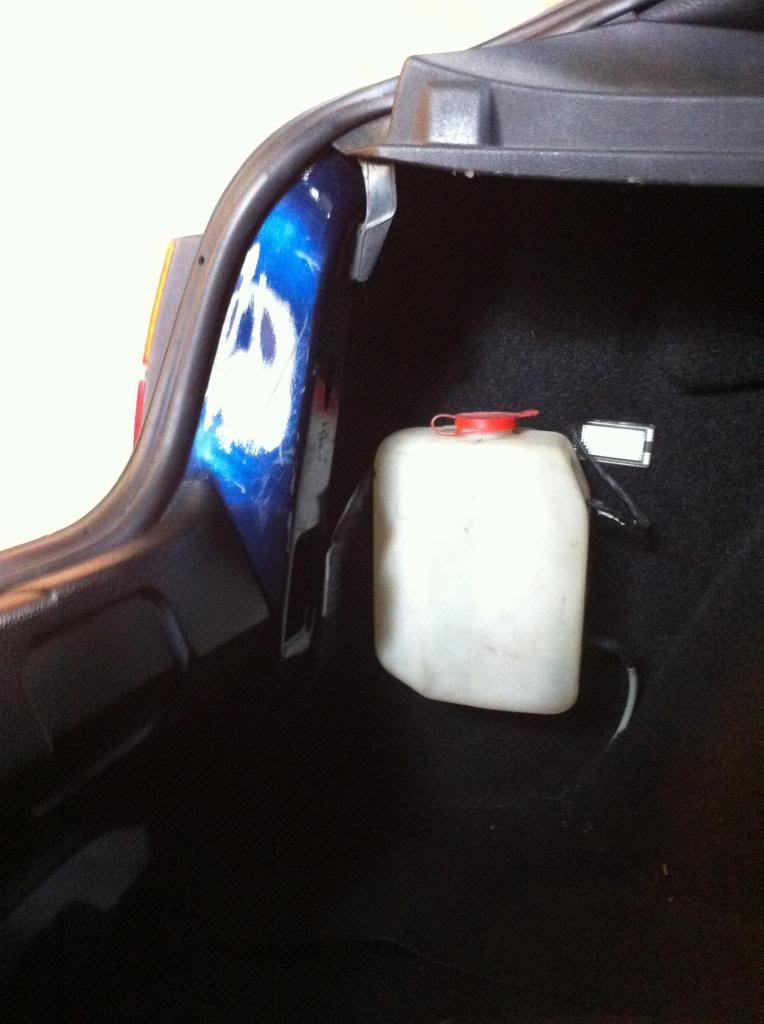

washer bottle moved to the boot
so this was one was pretty straight forward just connected the washer bottle to the the pipe that is used for the rear washer connected the front to the front washer jet pipe job done
for anyone that cares its not a corrado washer bottle its a mk1 one nice and small just bent a bit of ali to make a bracket and screwed it in extened the wiring job done well i hope so not tested it and the pump is a mk1 one so who knows that might have give up the ghost haha o well cross that bridge if i get there.
