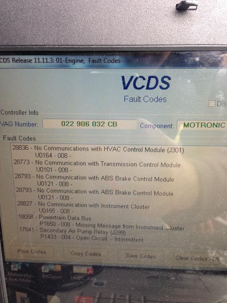

VW_OwneR_85 1 Posted January 26, 2014 what was the reason that the engine wouldnt start ? Quote Share this post Link to post Share on other sites

borachris 0 Posted May 12, 2014 (edited) Awesome work! Can't beat the sound of a R32 It sounds a little better now than it did before lol what was the reason that the engine wouldnt start ? A couple of reasons, Mark at SWICT made a mess of the ECU, he left a checksum error that stopped the ECU from starting the engine, the ECU went back to SWICT and he failed to rectify the problem even after having the ECU back for over 2 weeks. When I got it back with the same issue I took it to John from BFT, he fixed the checksum error, only for the engine to start but cut out after only a second. Love the blower . You do realise thats off a 12 litre engine ( i thnik ) used to work for scania in leeds . TBH I wasn't sure what size engine it was off, and I realise its probably a bit big for what I want lol. Will just see how things pan out haha So going back in time to the video in post #77. I bought a spare ECU from Ebay, Mark from SWICT wasn't interested in helping any further after ignoring several voicemails, I will call in when i'm passing one day to discuss this with him! Andy Outhwaite from ACR in Croft de immo'd the new ECU and also had a look at the old one, needless to say he couldn't solve the corrupt immo file! With the new ECU she was running like a bag of spanners on the standard map(vid in post 77), but thanks to Mr BFT, now with the rear lambdas deleted and a few other bits it actually sounds like it should, still without an exhaust though! Ran for 5 minutes then I turned it off because I've not wired the fans up yet and surprise surprise it wouldn't start again! Cheeky video Whilst poking around the bay making sure everything was tight the battery negative cable decided to fall apart then I snapped the chassis earth off while try to remove it! So I need to sort that out and see if that solves the starting issue. Few fault codes but nothing to worry about and John reckons he can hide them so they won't show up Picked up my TA koni's from Rays, had these for the mk2 and they've been hiding in his garage for the past few years, will be going to SP suspension for a full rebuild and then replacing the adjustable FK's New oil cooler, thanks to Hofmiester :) and new braided lines instead of the ones that came with it as they were a bit short for where i decided to put it I've mounted it vertically on the passenger side in front of the radiator, not ideal but it should be ok! 42 draft designs crack pipe which was a nightmare to fit after the engine had been stood without one for so long, had to get the dremel out and the KY jelly! Also my new supersize DV arrived, shown next to a 007p for comparison Will update again when I've sorted the wiring issue but I'm happy enough for now, it's the furthest I've got out of the last 3 projects lol Edited May 12, 2014 by borachris Quote Share this post Link to post Share on other sites

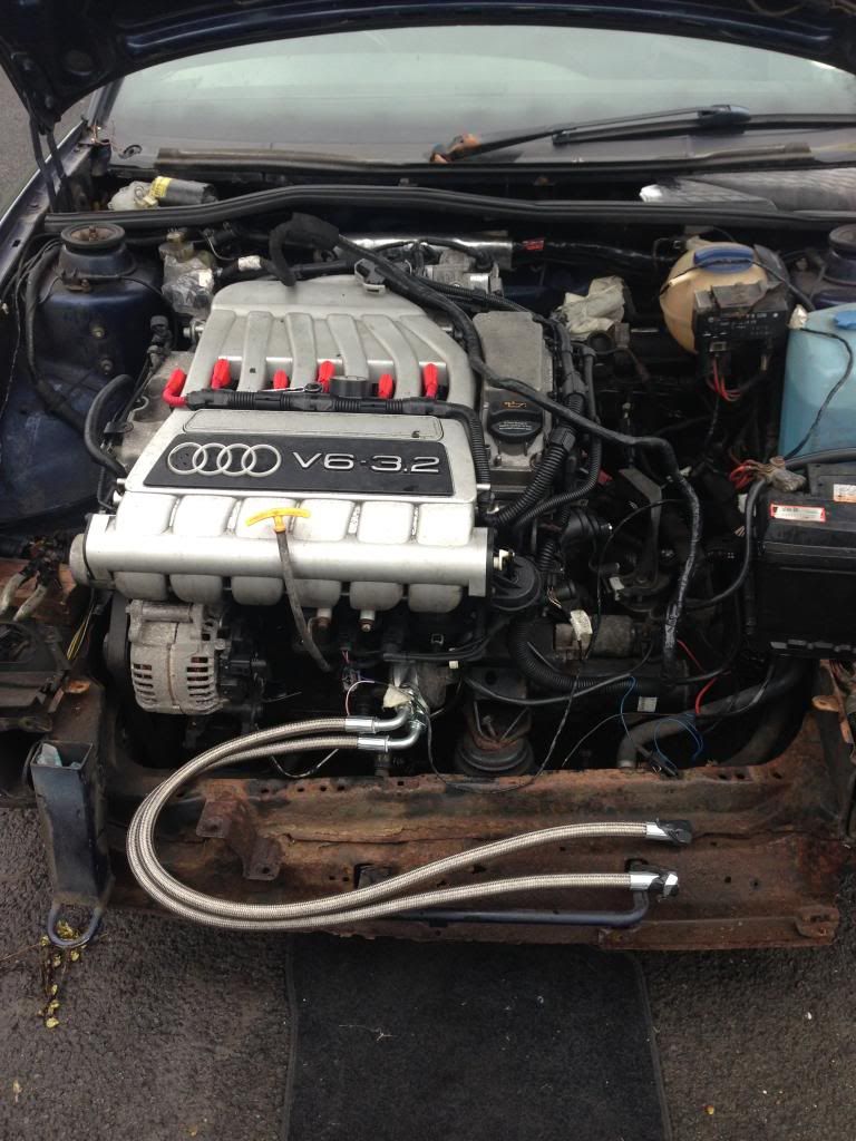

borachris 0 Posted May 13, 2014 That rad support skirt look like it's in dire need of blasting and coating. Well worth getting done and probably far cheaper than you might think. I got mine along with cross member, rad fan shroud, bonnet prop, and all engine bay brackets blasted and nylon coated for £100. Would have been £60 for standard powder coat. Hahaha believe me Sean it's well past that stage, it looks like it's been parked in the sea for most of its life, I have a much better condition one that will be getting some love before it goes on but tbh I don't care about anything other than that first drive at the moment lol I'm also undecided if I'm going to keep the car long term or find a better example :) Originally had the cooler on mine the same way Nice work buddy Cheers Fuzz, any reason for you changing yours? I've got the inlet on the bottom at the minute, just going off advice I read on a rally car forum as I wasn't totally sure what was best! Quote Share this post Link to post Share on other sites
lilfuzzer 1 Posted May 13, 2014 Just fitment of the charge cooler rad mate thats all. It fitted and worked fine in the vertical Quote Share this post Link to post Share on other sites
borachris 0 Posted May 13, 2014 Ah right cool, cheers buddy! Quote Share this post Link to post Share on other sites
