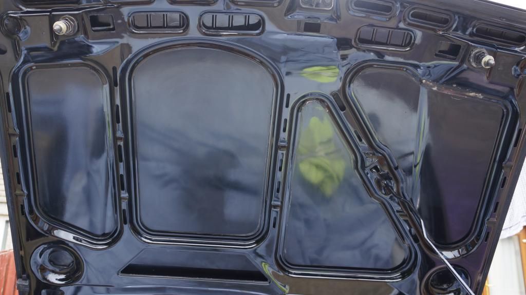

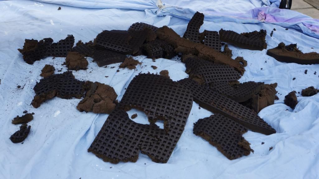

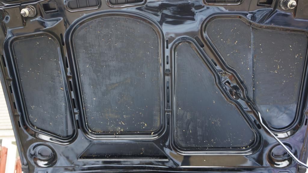

Micky fletch 10 Posted June 16, 2014 Tardis glue remover worked wonders on mine. Tools required 1 x maxed out credit card. Spray on leave to soak for a minute or two. Move on to the next.[ATTACH=CONFIG]78957[/ATTACH] before. [ATTACH=CONFIG]78958[/ATTACH] After [ATTACH=CONFIG]78959[/ATTACH] Available from amazon Quote Share this post Link to post Share on other sites

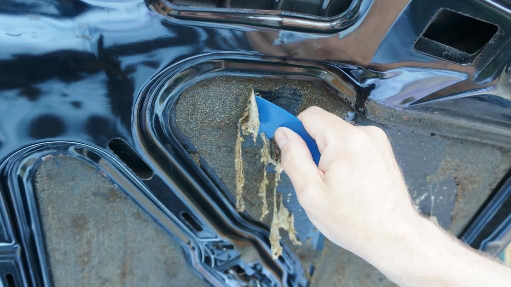

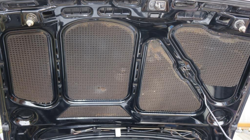

Ray1965 10 Posted June 17, 2014 (edited) I finally got round to doing mine this afternoon. used white sprit and a body filler plastic tool. came off quite well soaked it and it came off ok. Edited June 17, 2014 by Ray1965 Quote Share this post Link to post Share on other sites
Ray1965 10 Posted June 17, 2014 (edited) Took some pics during the job this afternoon. Some more pics here... http://s29.photobucket.com/user/raycb900/media/Corrado/Egine%20bay%20painting/DSC00752.jpg.html Edited June 17, 2014 by Ray1965 Quote Share this post Link to post Share on other sites
