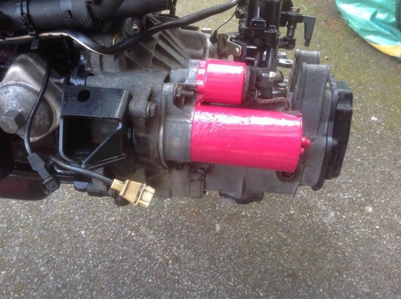

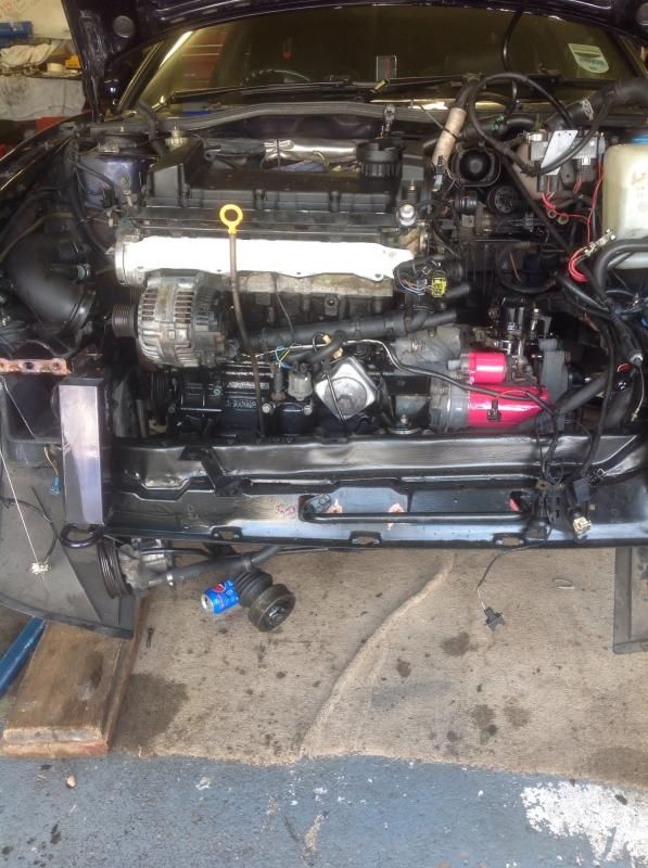

Roger Chatfield 0 Posted September 20, 2014 So, one of my work buddies kindly offered to paint my rusty starter motor whilst on nights.... This is the result...lol Managed to get the engine in, not too difficult, got it fitted in under 15 mins. Spent the rest of the day connecting everything up. I've put oil in it and turned it over on the starter with the plugs out, oil pressure got to two bar so I'm happy it's all good, just to refit the coil pack, leads and plugs and we are good to go, hopefully have it running tomorrow. Btw, for info GSF now stock G13, and are open til 4pm on a Saturday. Rog. Quote Share this post Link to post Share on other sites
