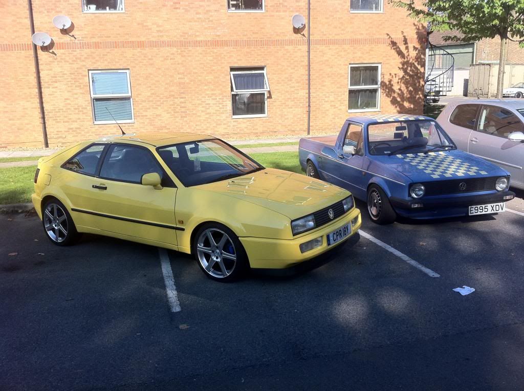

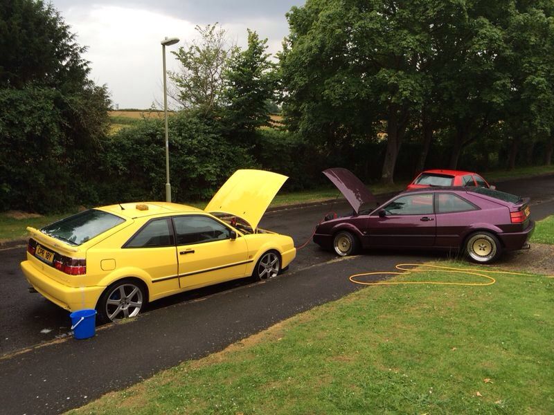

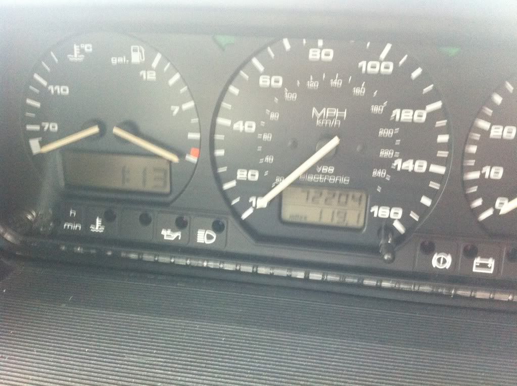

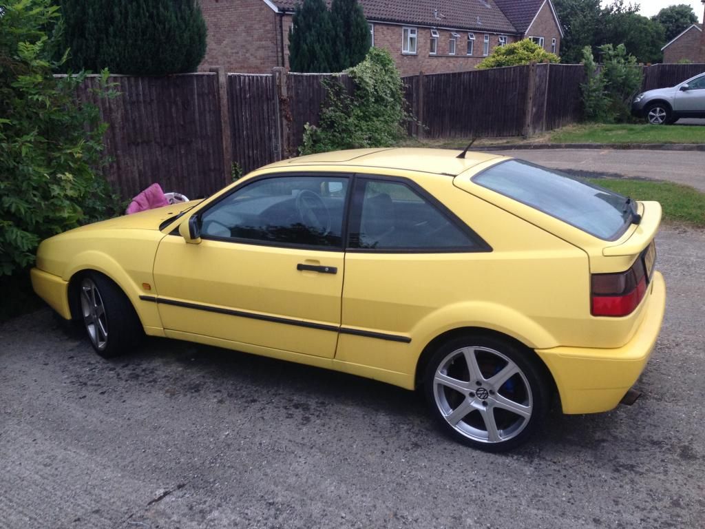

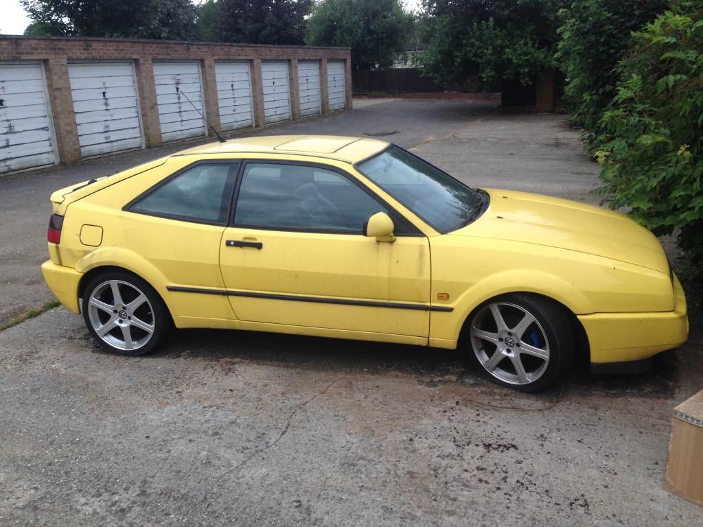

spanneredmonkey 0 Posted June 26, 2014 Before Sep 2011 Yesterday june 2014 Today A Quick was and an attempt to start....... no joy but the spoiler and sunroof work and its still kinda ok inside, just needs a seats out valet its only done 8k since I sold it I have a breakdown report stating that there is no fuel deliver suspect pump where is the best place to start trouble shooting? when i did manage to get it to turn over the oil light and temp lights were flashing? what does that point to? i dont have a vagcom port as its a conversion Quote Share this post Link to post Share on other sites
seanl82 23 Posted June 26, 2014 Flashing lights are probably just battery. Swap out the fuel pump relay first, dead easy and the most common problem. Quote Share this post Link to post Share on other sites
