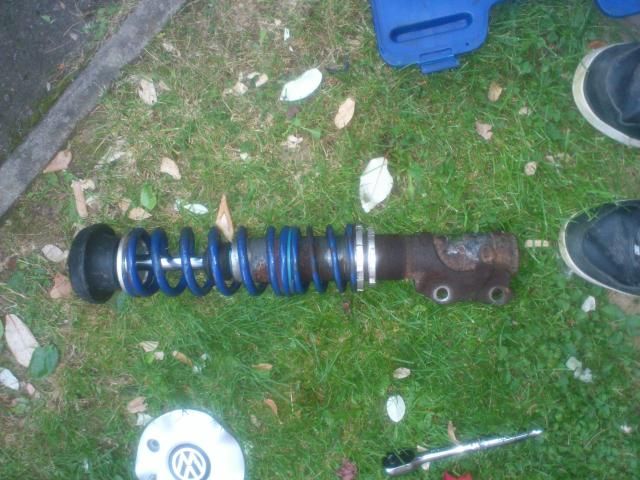

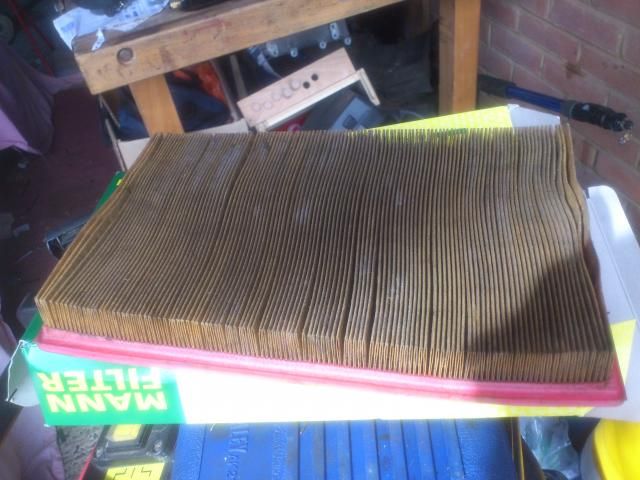

ross k 10 Posted September 14, 2014 right update gave the car a good clean and she cleaned up pretty well the handling is so much better after doing the top mounts only issue is the car doesnt start that well it turns over fine but wont fire unless you give it a little throttle and then it will start fine anyone got any ideas here some pics the coilovers from when i did the top mounts pretty sure these are joms? not the aps as advertised the air filter think it needed changing ? now got to sort the sump as it leaks very badly when the cars warm Quote Share this post Link to post Share on other sites

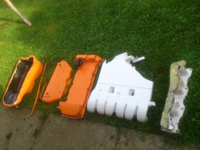

ross k 10 Posted October 2, 2014 update got to love an ebay bargain brought this little lot for a whole 10 pound its a shame its all been powder coated well orange and white but im going to repaint it pretty sure the orange wouldnt go with the colour of my car at all Quote Share this post Link to post Share on other sites
loepan 11 Posted October 2, 2014 quite like the white manifold, not sure on the orange tho' there was a chap who had a corrado with orange interior, could be from that Quote Share this post Link to post Share on other sites
ross k 10 Posted October 2, 2014 Yeh think it would clash gonna paint it crackle black i think to tidy the bay up Quote Share this post Link to post Share on other sites

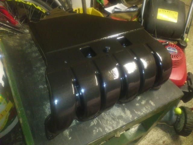

ross k 10 Posted October 2, 2014 well painted the inlet all ready to install its crackle black but i was expecting matt but it came out gloss so not sure about it really Quote Share this post Link to post Share on other sites
swiftkid 1 Posted October 2, 2014 Have you painted crackle before? It's a real git to get right, it needs painting on quite thick and heating up quite a lot to get it to wrinkle. I know when I did mine it took me a few times! Quote Share this post Link to post Share on other sites
