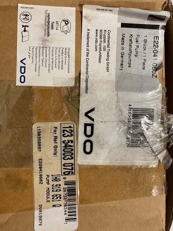

fendervg 33 Posted December 15, 2022 Here’s some photos of the VDO set up: Quote Share this post Link to post Share on other sites

ABV-VR6 12 Posted December 15, 2022 Thanks guys for the pictures and the link. I guess I better shop around! It's "funny" how in the US, they are advertised as VR6 2.8, I thought the pump would be different since those are not a 4 BAR like the ABV? Quote Share this post Link to post Share on other sites
fendervg 33 Posted December 15, 2022 2.8 pump would be 3 bar - but runnning a higher pressure pump would work fine as the fuel pressure regulatero would take care of the difference - not so convinced it would work the other way around though. Quote Share this post Link to post Share on other sites
