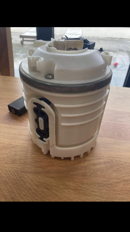

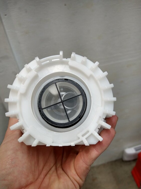

ABV-VR6 12 Posted January 25, 2023 So today I received the VDO pump I ordered on eBay. The box is a VDO box but it was also not factory sealed and the plastic bag is looking too small. But what worries me the most is that the pump has ZERO markings on it, not a VDO engraved or part number or anything else. I find this weird and suspicious. I hope I'm wrong! Any of you has one on hand and can confirm this is correct or not? Quote Share this post Link to post Share on other sites

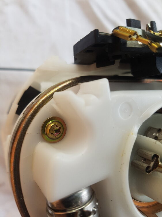

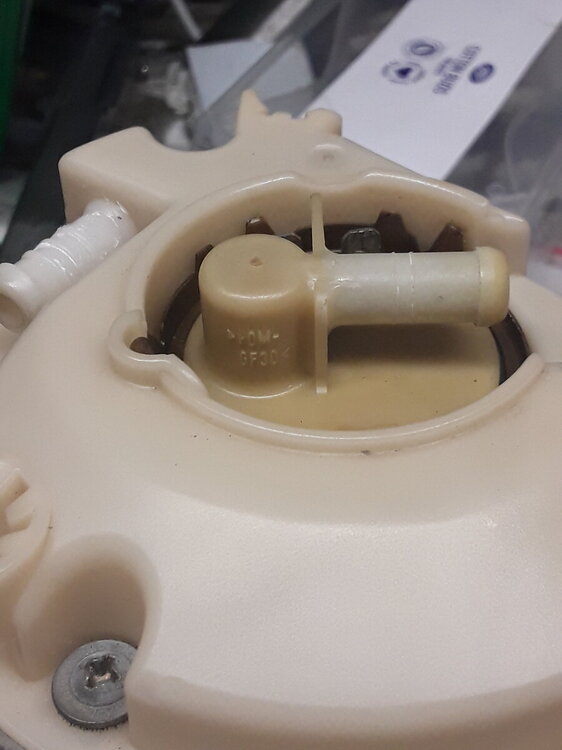

daves16v 1 Posted January 25, 2023 (edited) I've got my VDO pump off, I'll go check the body for any markings. I bought a new VDO pump a few months back and it had cracks where the screws are, see photo. I sent it back but wish I'd kept it now. Edited January 25, 2023 by daves16v Quote Share this post Link to post Share on other sites
ABV-VR6 12 Posted January 25, 2023 1 minute ago, daves16v said: I've got my VDO pump off, I'll go check the body for any markings. I bought a new VDO pump a few months back and it had cracks where the screws are, see photo. I sent it back but wish I'd kept it now. Thank you SO MUCH! It was very expensive and I want to be sure... Quote Share this post Link to post Share on other sites
daves16v 1 Posted January 25, 2023 Just checked, no markings on the body but I've no idea if it is the original, car has 133k miles. 1 Quote Share this post Link to post Share on other sites
ABV-VR6 12 Posted January 25, 2023 Well while not definite it's encouraging that yours have no markings as well... Maybe someone else will confirm this 100%. Thank you very much for checking this out, really appreciate it. Quote Share this post Link to post Share on other sites

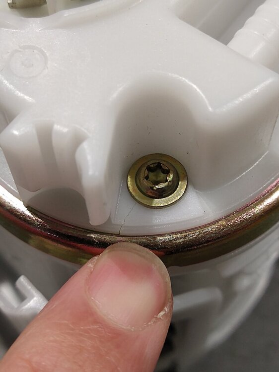

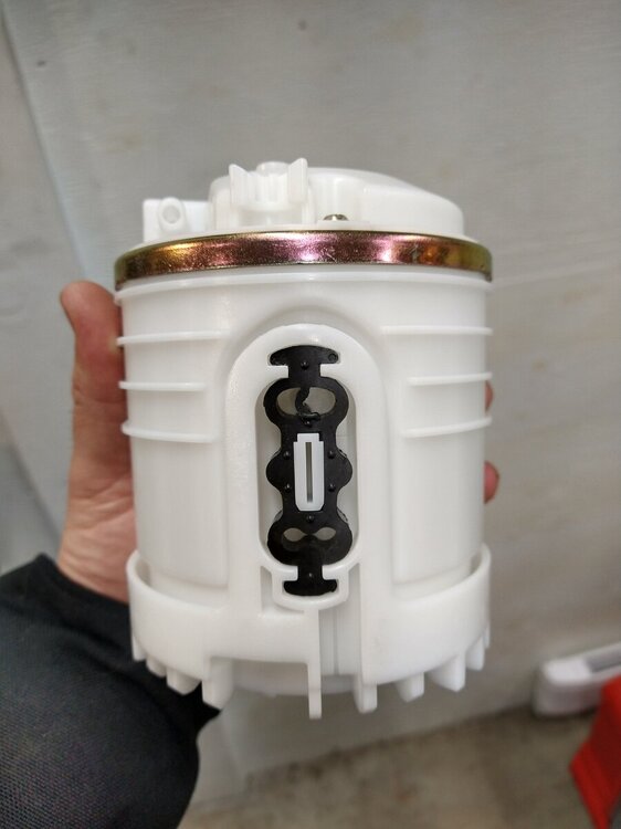

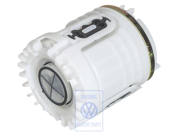

Keyo 49 Posted January 25, 2023 (edited) 1 hour ago, daves16v said: I've got my VDO pump off, I'll go check the body for any markings. I bought a new VDO pump a few months back and it had cracks where the screws are, see photo. I sent it back but wish I'd kept it now. This is off vw classics website- is your casing a different pattern if so fake. Also off autodoc Edited January 25, 2023 by Keyo Quote Share this post Link to post Share on other sites
ABV-VR6 12 Posted January 25, 2023 The pattern on the swirl pot (the horizontal grooves) seems to be the same. The black rubber part though on the VW one, the right side looks straight, the left is wavy. On mine, both sides are wavy. Maybe it's shadows though? I would like to be 100%, this was pricey! It would be easy for someone to buy it, return it with cheap aftermarket replacement instead, especially if there's no writing on it. If the box was not opened, I would not think this way but it was so... Just weird for a company to make a product without any stamps no? I get that they can't slap a sticker on a swirl pot but nothing engraved tough... Quote Share this post Link to post Share on other sites
Keyo 49 Posted January 25, 2023 57 minutes ago, ABV-VR6 said: The pattern on the swirl pot (the horizontal grooves) seems to be the same. The black rubber part though on the VW one, the right side looks straight, the left is wavy. On mine, both sides are wavy. Maybe it's shadows though? I would like to be 100%, this was pricey! It would be easy for someone to buy it, return it with cheap aftermarket replacement instead, especially if there's no writing on it. If the box was not opened, I would not think this way but it was so... Just weird for a company to make a product without any stamps no? I get that they can't slap a sticker on a swirl pot but nothing engraved tough... I got mine from auto doc but now in my old car sold and the used one I sold . Might see if I can find pictures of the used one . Quote Share this post Link to post Share on other sites

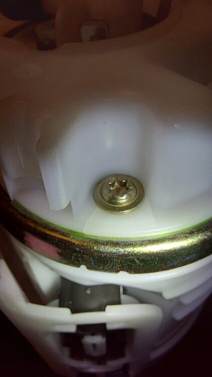

ABV-VR6 12 Posted January 26, 2023 Thank you very much for the pictures, really appreciate it. This morning I was comparing and upon close look and with my glasses... I found cracks in it! So legit or not, I'm returning it! One crack is exactly like in the above picture, right by the screw. The other one is worse, the 90 where the hose connects is fissures 3/4 down. Quote Share this post Link to post Share on other sites
Keyo 49 Posted January 26, 2023 1 hour ago, ABV-VR6 said: Thank you very much for the pictures, really appreciate it. This morning I was comparing and upon close look and with my glasses... I found cracks in it! So legit or not, I'm returning it! One crack is exactly like in the above picture, right by the screw. The other one is worse, the 90 where the hose connects is fissures 3/4 down. Shocking. Quote Share this post Link to post Share on other sites

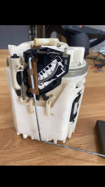

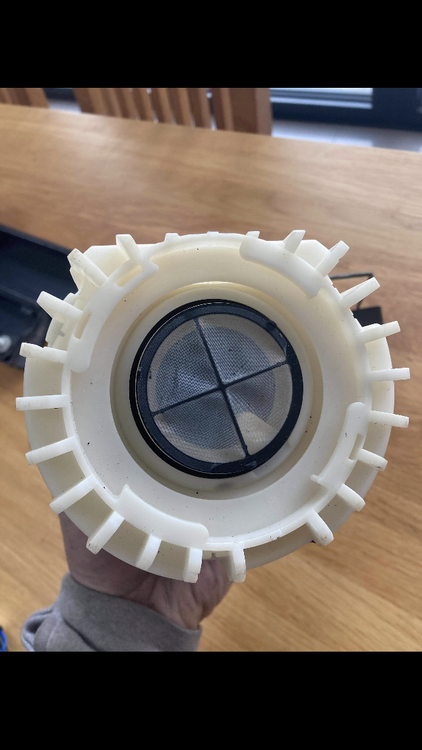

Cressa 46 Posted January 26, 2023 That is terrible. Are you fitting a one way valve on the line as well as the new pump? Here are pics of my old pump that I changed last year. Which I assume was the original but not really any markings 1 Quote Share this post Link to post Share on other sites
twinbeltg60 3 Posted January 26, 2023 Hi, My G60 pump is the same 4 bar VDO unit, , it was bought from a e-bay trader more than 10 yrs ago who sold dealers old stock etc, it was a Genuine VDO Unit, I didn't fit it for 10 years (!), and it had acquired a couple of tiny cracks, they had not been there when I looked at it a few years ago, so must be an plastic aging issue ( probably the same rubbish plastic used for the headlamp adjusting screws holder), no cracks around the fuel pipe junctions though, I will be taking it out again to redo the fuel hoses in tank, so will check again, may have to think about replacing it again! Attached a couple of pics. 1 Quote Share this post Link to post Share on other sites
ABV-VR6 12 Posted January 27, 2023 21 hours ago, Cressa said: That is terrible. Are you fitting a one way valve on the line as well as the new pump? Here are pics of my old pump that I changed last year. Which I assume was the original but not really any markings Thanks Cressa, yes terrible... I don't think the seller was aware of that, the more I read into it the more I'm starting to think that it's an aging issue. I'm trying to get my money back at this point... It also looks like no markings is just the way it is. It's a strange thing but it is what it is I guess, now I know. Thanks for looking at it and your time Quote Share this post Link to post Share on other sites
ABV-VR6 12 Posted January 27, 2023 19 hours ago, twinbeltg60 said: Hi, My G60 pump is the same 4 bar VDO unit, , it was bought from a e-bay trader more than 10 yrs ago who sold dealers old stock etc, it was a Genuine VDO Unit, I didn't fit it for 10 years (!), and it had acquired a couple of tiny cracks, they had not been there when I looked at it a few years ago, so must be an plastic aging issue ( probably the same rubbish plastic used for the headlamp adjusting screws holder), no cracks around the fuel pipe junctions though, I will be taking it out again to redo the fuel hoses in tank, so will check again, may have to think about replacing it again! Attached a couple of pics. Thank you for taking the time to look at it, much appreciated. You confirmed my thoughts, seems like an aging issue of the plastic and over time it develops cracks. I bet these are old, new but old... I wonder if the cracks around the screws which is a common place for cracks it looks like do really affect the pump? Cheers Quote Share this post Link to post Share on other sites
twinbeltg60 3 Posted January 27, 2023 6 minutes ago, ABV-VR6 said: Thank you for taking the time to look at it, much appreciated. You confirmed my thoughts, seems like an aging issue of the plastic and over time it develops cracks. I bet these are old, new but old... I wonder if the cracks around the screws which is a common place for cracks it looks like do really affect the pump? Cheers Hi, The worry would be cracks around the Pump flange / spout, as you seem to have, if they are all the way through you will lose pressure, | suspect if they had been in the tank environment the cracks wouldn't have appeared, but that's a big maybe. I guess the pump supplied to you is NOS, not new production, I personally would return it and request a new unit, or money back and buy another manufacturer unit as suggested in this thread. I was going to have look at VDO Aftermarket parts to confirm they still manufacture these, but you have to be a Dealer / Workshop with an account to access this info, cannot register as a private individual it seems. Good luck, I will follow this , as I may have to replace my cracked VDO unit also.! Cheeers. Quote Share this post Link to post Share on other sites
ABV-VR6 12 Posted January 27, 2023 I'm in the process of being refunded, hopefully there's no hick ups. I think at this point knowing the issue with NOS pump, I would like to lay my eyes on the next one before buying. I always aim for OEM replacement but if VDO stopped making them a decade ago and it they all developed that issue, I may look at a different manufacturer. It's a maybe like you said but I kind of agree with that maybe. They are probably meant to be soaked / lubricated with gasoline. Air may deteriorate the kind of plastic they used. It's a maybe but it makes sense. Seems like a common issue to see cracks around the screws. The flange crack that mine has may have been by a drop too, that box was opened so... Anyways we'll never know and at this point I just want my money back. Cheers! Quote Share this post Link to post Share on other sites
twinbeltg60 3 Posted January 27, 2023 On 2nd thoughts looking again at your pics, the fuel spout cracks are too wide to just be plastic deterioration, as you mentioned previously it looks like this has been dropped at some point, ie leverage has been applied. Quote Share this post Link to post Share on other sites
ABV-VR6 12 Posted January 27, 2023 1 hour ago, twinbeltg60 said: On 2nd thoughts looking again at your pics, the fuel spout cracks are too wide to just be plastic deterioration, as you mentioned previously it looks like this has been dropped at some point, ie leverage has been applied. For showing purposes, I did apply a little pressure on the spout when I snapped the picture. I need the seller to see what's going on... Without my glasses, I didn't see anything originally! Anyway, we'll never know what happened I guess. Quote Share this post Link to post Share on other sites
