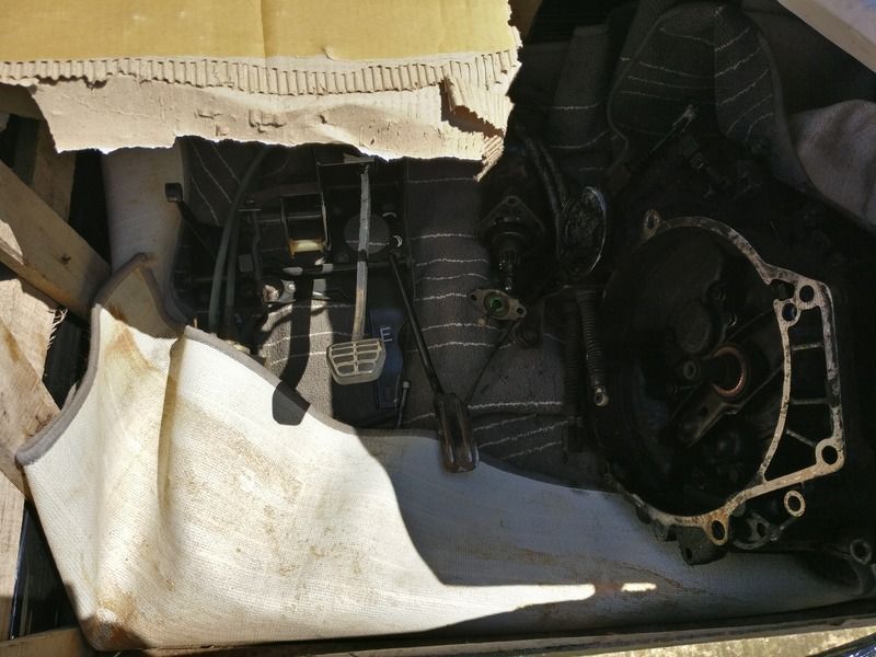

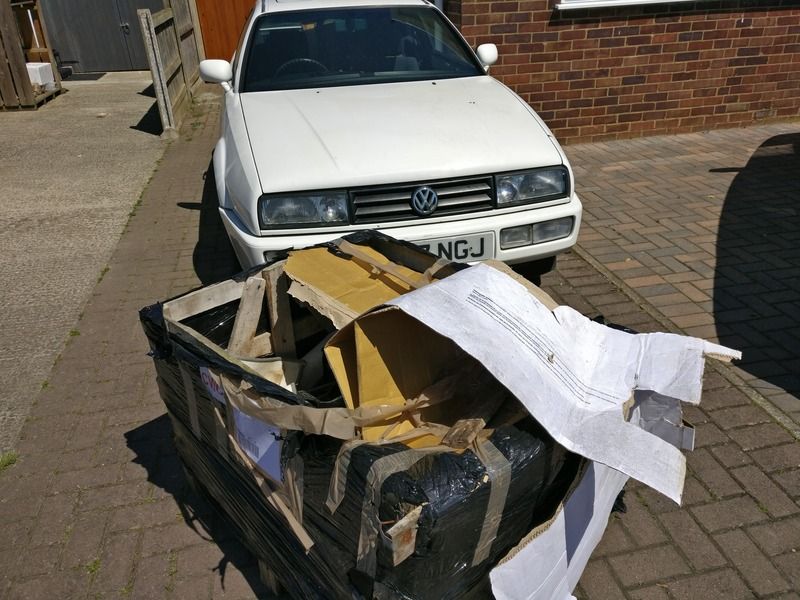

Geeba 0 Posted May 26, 2017 Well I was just about to cut the lawn in my lunch break and a pallet from Lilfuzzer turned up! :D As always suitable packaging to get me in the mood for the weekend and the job in hand! ;) A pallet full of fun! - gesssss need to address those weeds all over the driveway as soon as the Corrado is in its new home tomorrow. Looking forward to getting started now ;) Need a few more bits, a short shift from Dave if he's still around, a flywheel, a diff maybe, think about balancing and lightning the bottom end and maybe a ported head... oh and a cold can of FOSTERS! decision :) Thanks again Chris! you're a legend! Quote Share this post Link to post Share on other sites

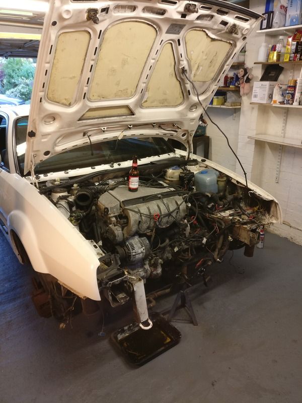

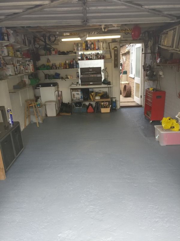

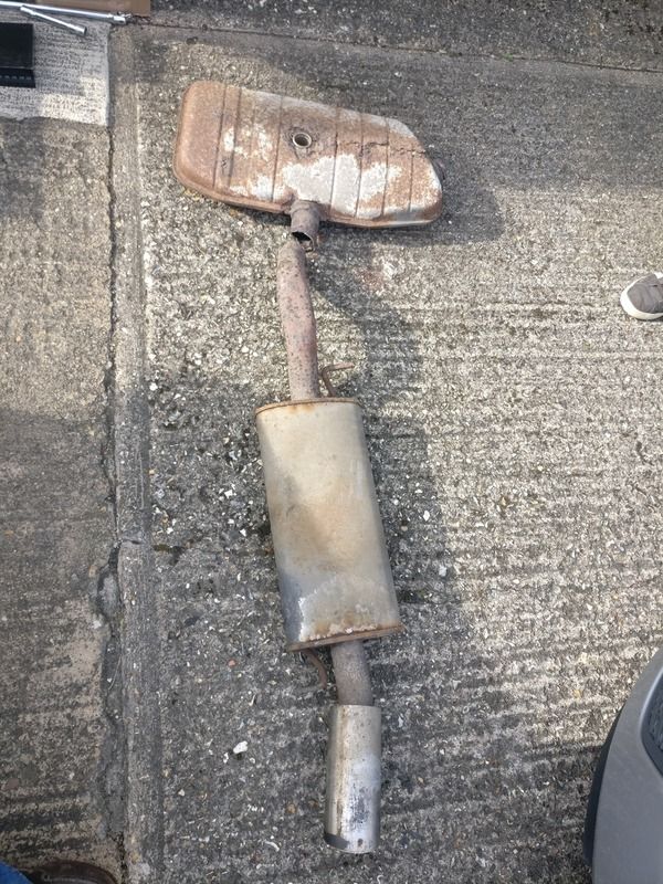

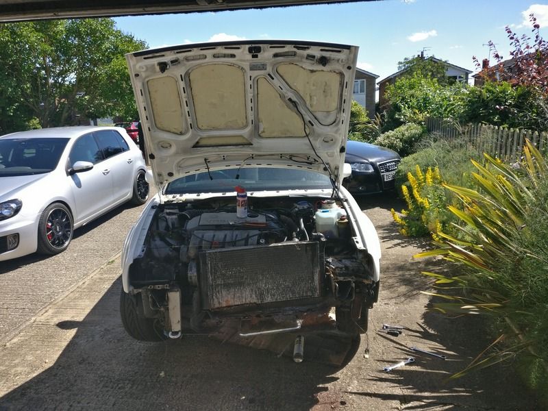

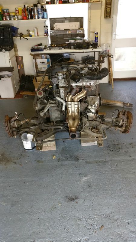

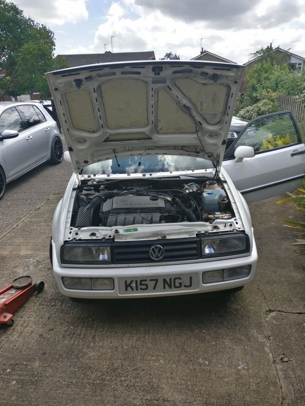

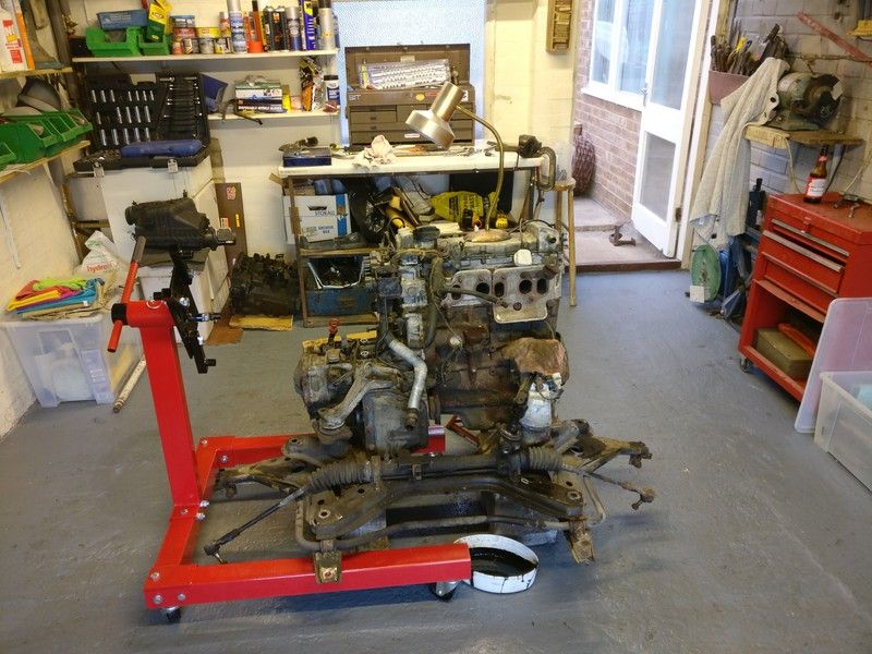

Geeba 0 Posted June 19, 2017 (edited) Finally got round to making a start! been rounding up parts and thinking about what I'm going to do - made a deal with my Mum that if I cleaned the garage out I could work on the car there! So a litre of floor paint and a few trips to the local tip we were ready... I'd already moved the car round a couple of weeks earlier so we made a start.. I had a mate helping me... his rather nice GTI in the background, the radiator and support bracket had disintegrated, both of which I've got... brand new Hella rad and a powdercoated rad support waiting to go on.. It still had the factory fit exhaust, but unfortunately it had also made a huge attempt to return to mother earth... so out came the grinder :( By the end of the afternoon the car was in the garage and suitably chocked out ready to drop the entire front end. Beers were also on the agenda! ;) Next morning we undid the rest of the sub-frame bolts and dropped the whole lot out in one go... pretty much identical to the way I used to do MK2 GTI's ;) - just a bit bigger. and here it is! Continued to strip it down, it came apart really well considering the age and how long it had been stood, it was all as it had left the factory as far as we could tell it had never been pulled about. Plan is to get all the metal work blasted and powder-coated so it will look like new, everything else will get a dam good clean and refurbed as needed. A good friend of mine owns a Porsche tuning company and we're going to have a chat once the motor is stripped down - I'm going to do shells, seals and chains of course, but I'm also thinking along the lines of a mild port'n'polish and big valve head so I can bring her into the 200hp club whilst still looking OEM. Unfortunately there was one casualty :( - just as we pushed the body over the last bit of the engine it clipped the engine loom multi plug :( Gutted! it's bent the pins so I'll have to source a new one. to be fair it was in pretty bad condition with most of its wrapping missing and what was there was very brittle .. if anyone has one let me know. Then it was off to Guns'n'Roses on the Saturday! all in all a good weekend! Edited June 19, 2017 by Geeba Quote Share this post Link to post Share on other sites
