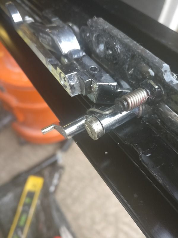

The fella on ebay has said he will post.... what sort of job is it to replace the chrome trim lifters? am I risking a nervous breakdown? LOL :)
A lot of it is made up of parts with pegs and circlips. Very small ones. Just do it a side at a time laying them side by side and you will sort it. Not forgetting a clean and the sunroof grease.
Be aware. ...the parts are even more fiddly and fragile when out of the frame.

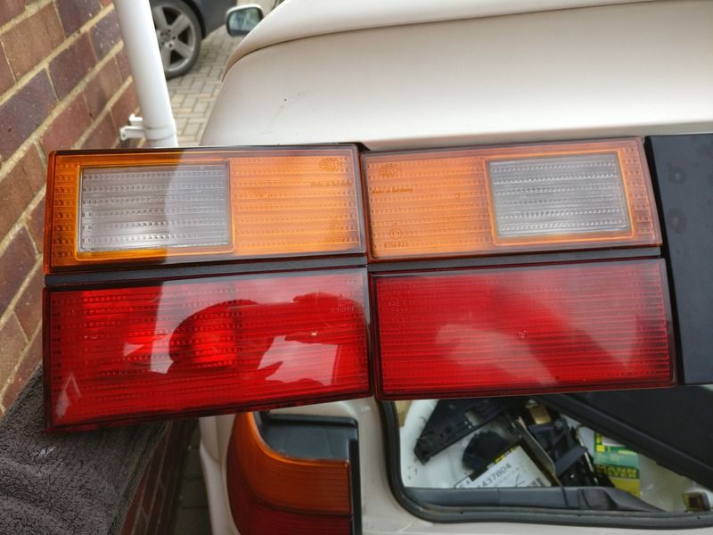

So I set about a few jobs - polished out any scratches with compound on all the tail lights... they all look like new now, all fitted back along with new fast reacting Philips bulbs - I'm going to keep all the old bulbs as they all said "Made In Germany" on them which makes me think they are the original factory fit items ;) nerdy I know but I'm an OE man.

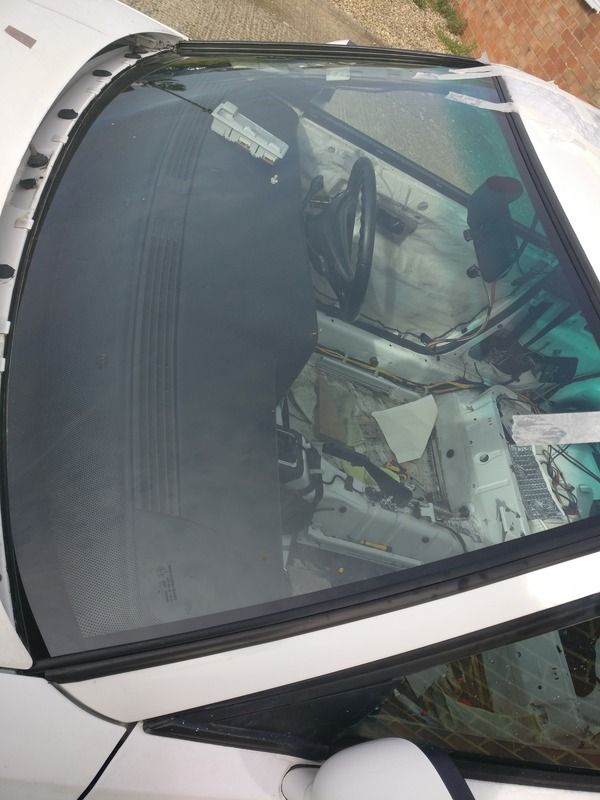

In went a brand new windscreen! so the car is now completely water tight and the damp smell has gone.
Wasn't overly sure on the retro green top tint.. but the rest of it matched in well and there was no choice as its all they had. hardly any rust under the screen to which was a relief - I did clean and treat what I did find thou.

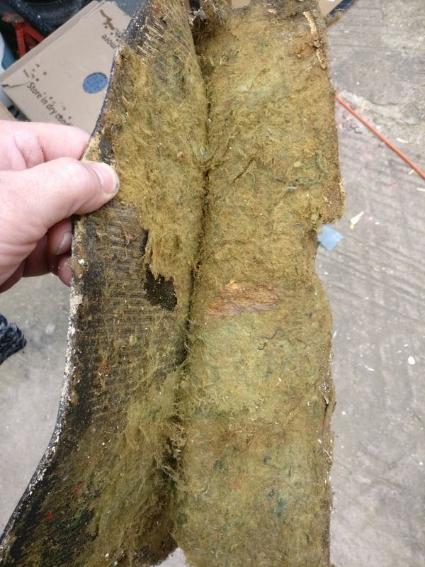

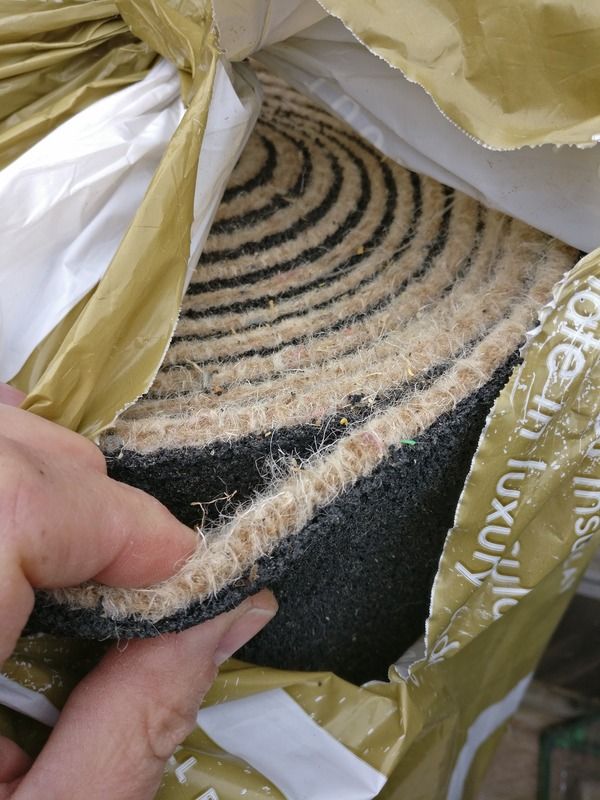

So now its dry, time to get the interior back in... the bitumen topped sound proofing was very mouldy and smelly on the passenger side and dusty and smelly on the drivers side, so I set about fixing that.

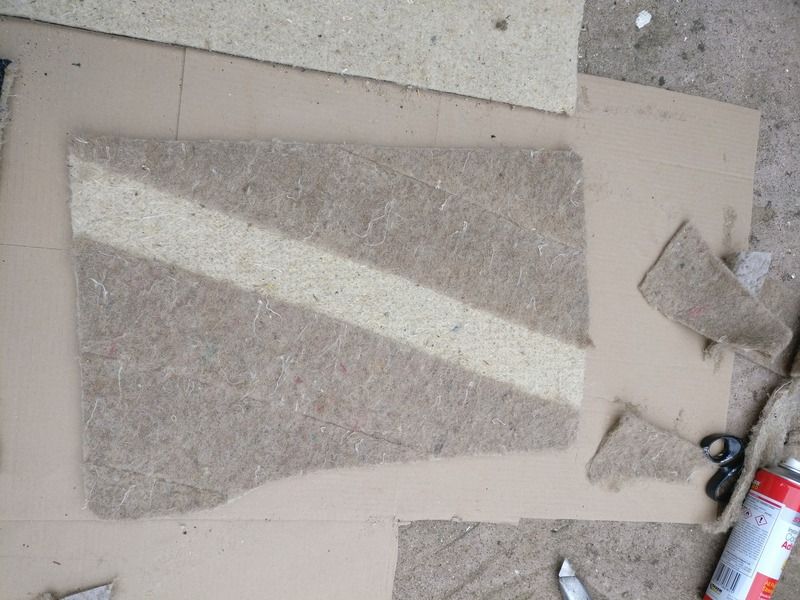

I cleaned off the old stuff and used them as a template to cut new from underlay - I've used this before in previous projects.. half felt and half crumb rubber... feels nice compared to the old flat felt and the crumb rubber adds a good layer of sound deadening, I re-used all the factory bitumen after I had cleaned it and glued it to the crumb side of the underlay, again for the factory look..;) lol
The rears I added some extra felt to recreate the cut-out for the floor-pan

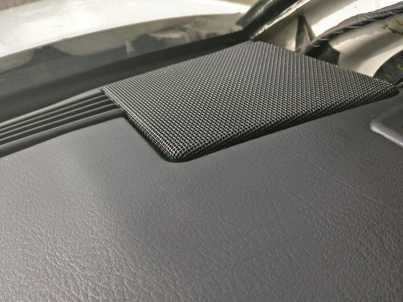

Speaker grills had gone a bit sun-faded and rusty, so I carefully stripped them down cleaned, de-greased and re-painted them satin black - they look really good and you would never know that they weren't factory... all the clocks and storks are also back in..

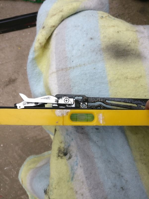

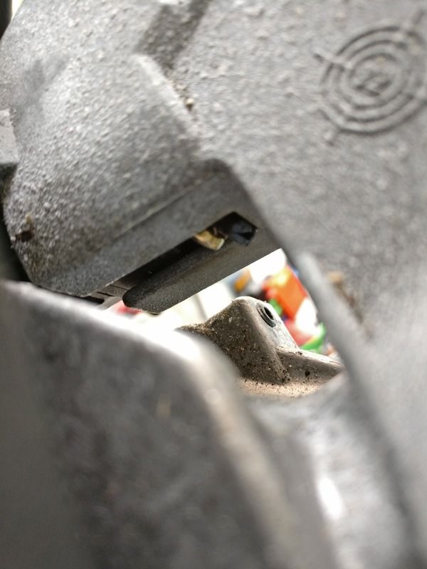

I'd been putting the sunroof off for ages... boy was I dreading it, thankfully MZpog came to the rescue and we did a quick deal on an old one he had, unfortunately once I had stripped it down one side had failed, so I whipped out the good side and transferred it to mine.. then had a think about how to repair the other side. did a quick test with a drill and a tap on the old one and happy days!
So moved on to the good one... levelled it so I don't get a drunken tread..
And BINGO! a working sunroof! - I absolutely slavered it in grease so hopefully it will be ok for a while, I've still got to cut the head of the machine screw off so it matches the other side, but as it stands the sunroof adventure is over and its hopefully going back in the car today!
