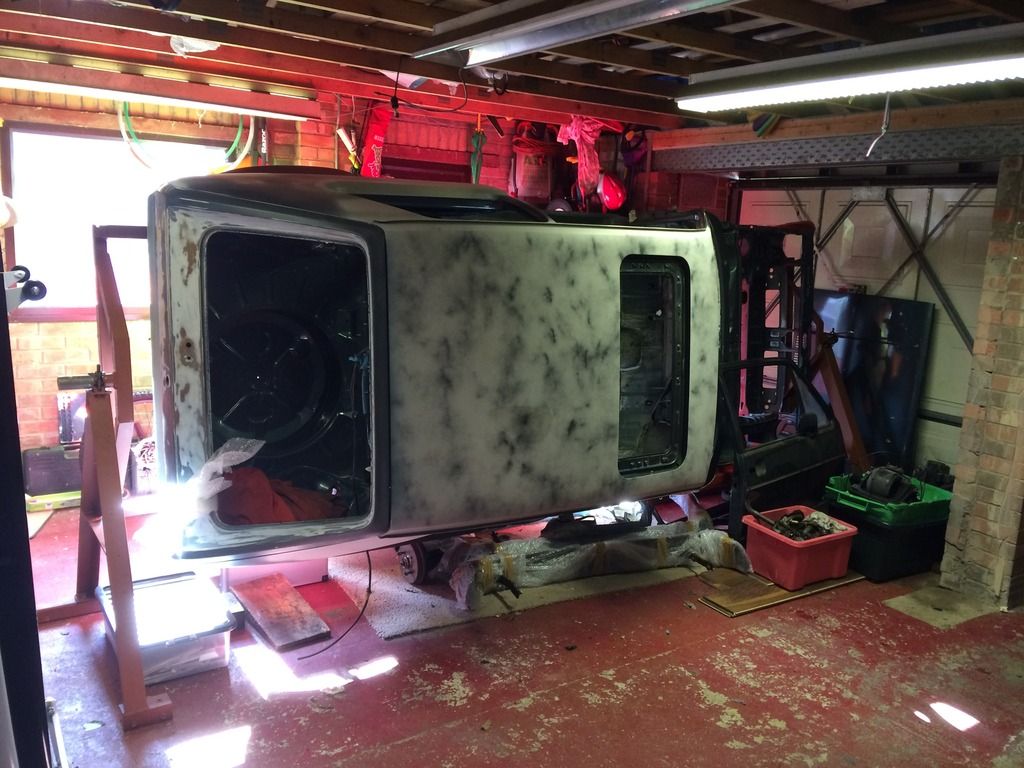

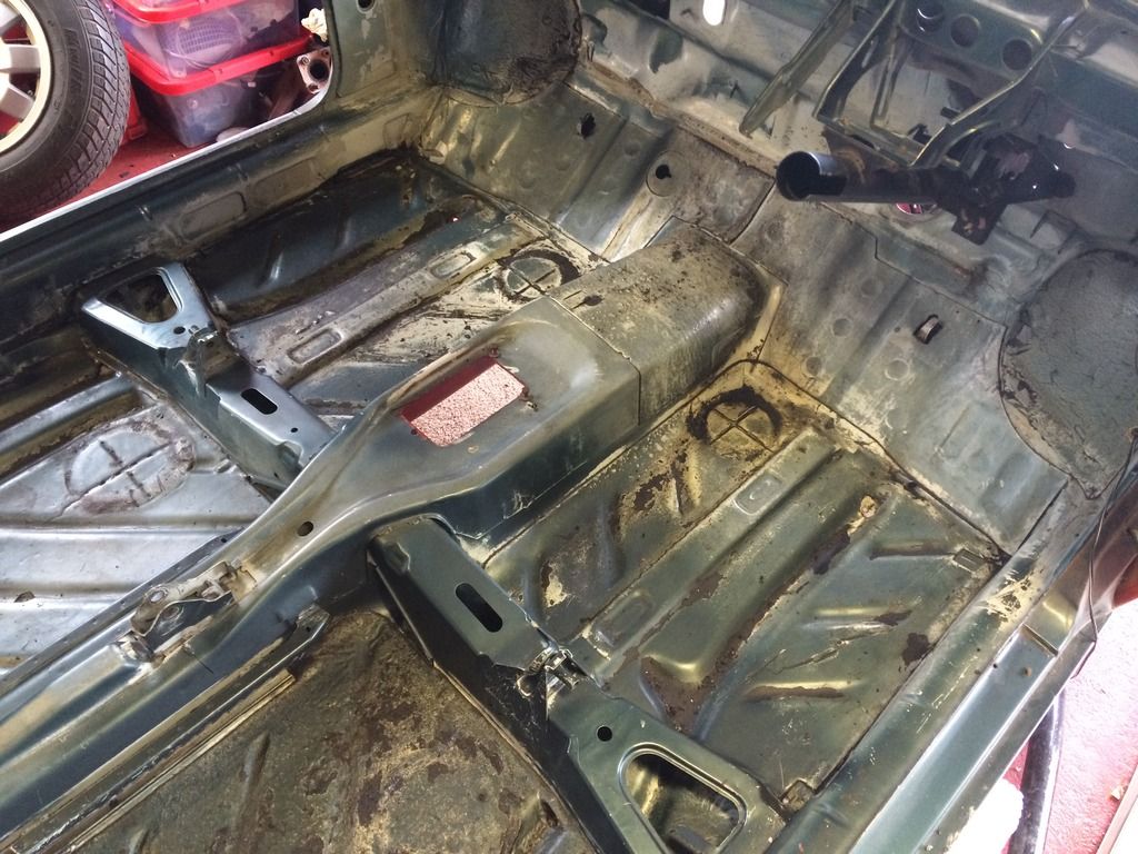

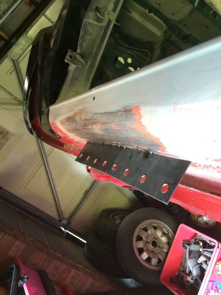

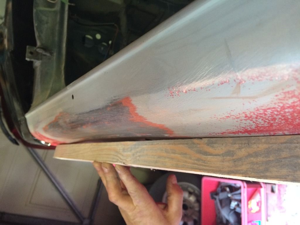

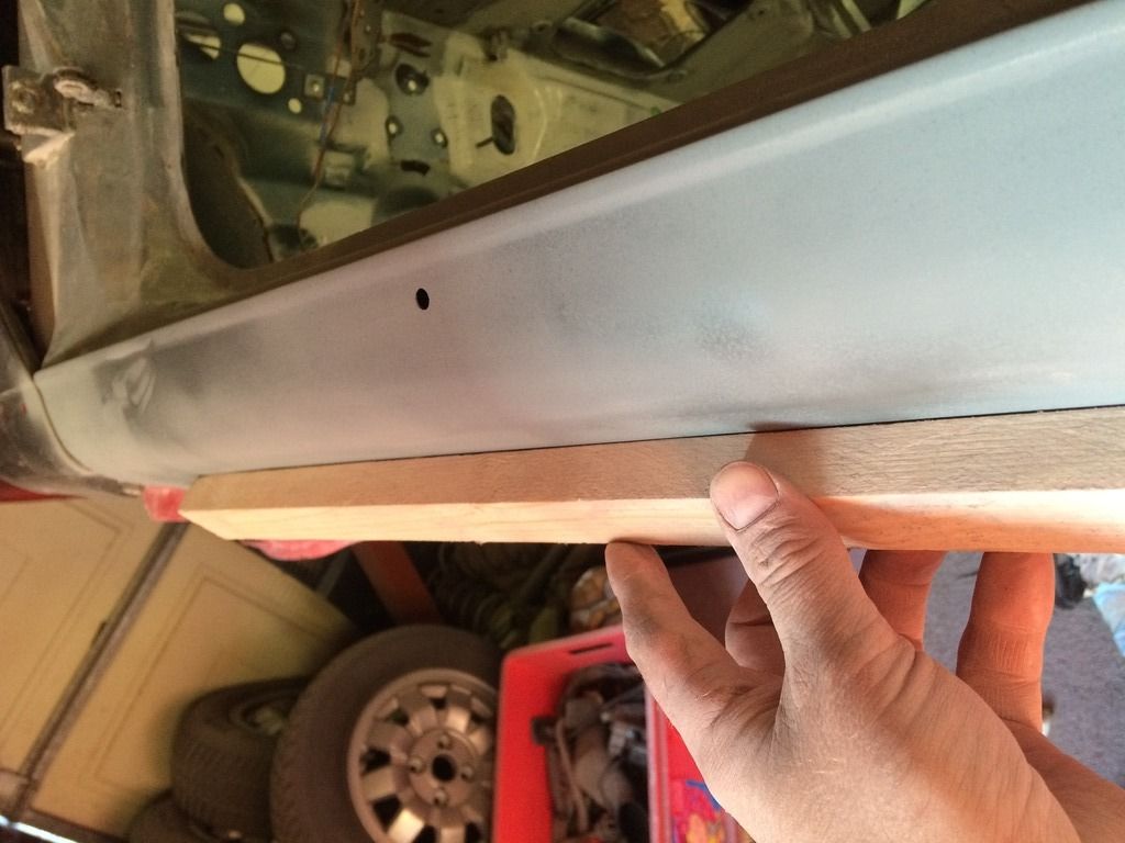

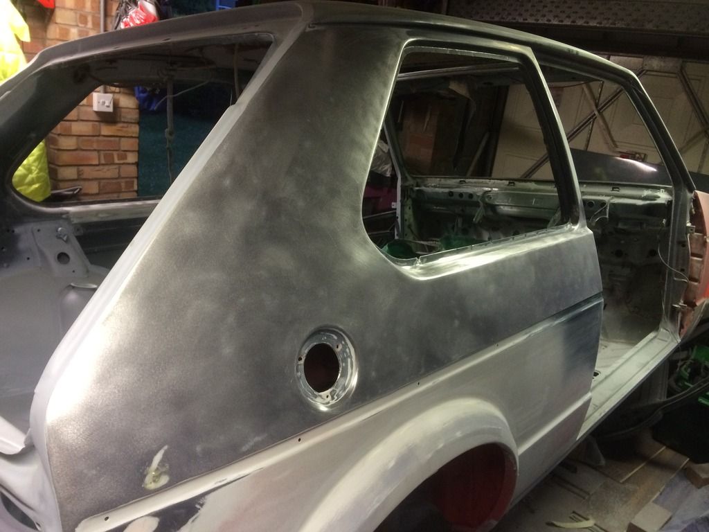

ChrisL 20 Posted January 24, 2017 (edited) After selling the Corrado I lasted until about January before needing something to do in the garage that wouldn't cost the earth. I ended up buying this back in February after a short search for a MK1 GTI. The car had been stripped by the previous owner and any welding work already completed, this looks to be only minor areas such as the rear panel, rear outer arches and the front panel. Other then that, the shell is in amazing condition. I have all the parts stored in boxes to be cleaned and fitted once the paint work is finished. I've always wanted to have a go at bodywork preparation and painting and intend to do it all myself including the final top-coat. So this is when I got it home: This is the interior, not bad for 170K miles. Totally mint except for a small fag burn, this wont matter as I intend to have the centres re-trimmed with the black and grey stripe: First job after sorting all the parts out of the shell was a quick clean of the interior, floors look perfect: Then I got a jig made at work to make the days of sanding a little easier: Noticed one of the sills had been dented up, probably from someone jacking the car incorrectly: was going to live with it as its not intended to be a show car but decided it would drive me mad if I didnt sort it, so got some plates welded on to try and pull it straight Came out pretty well really More to follow…. Edited January 15, 2018 by ChrisL Quote Share this post Link to post Share on other sites

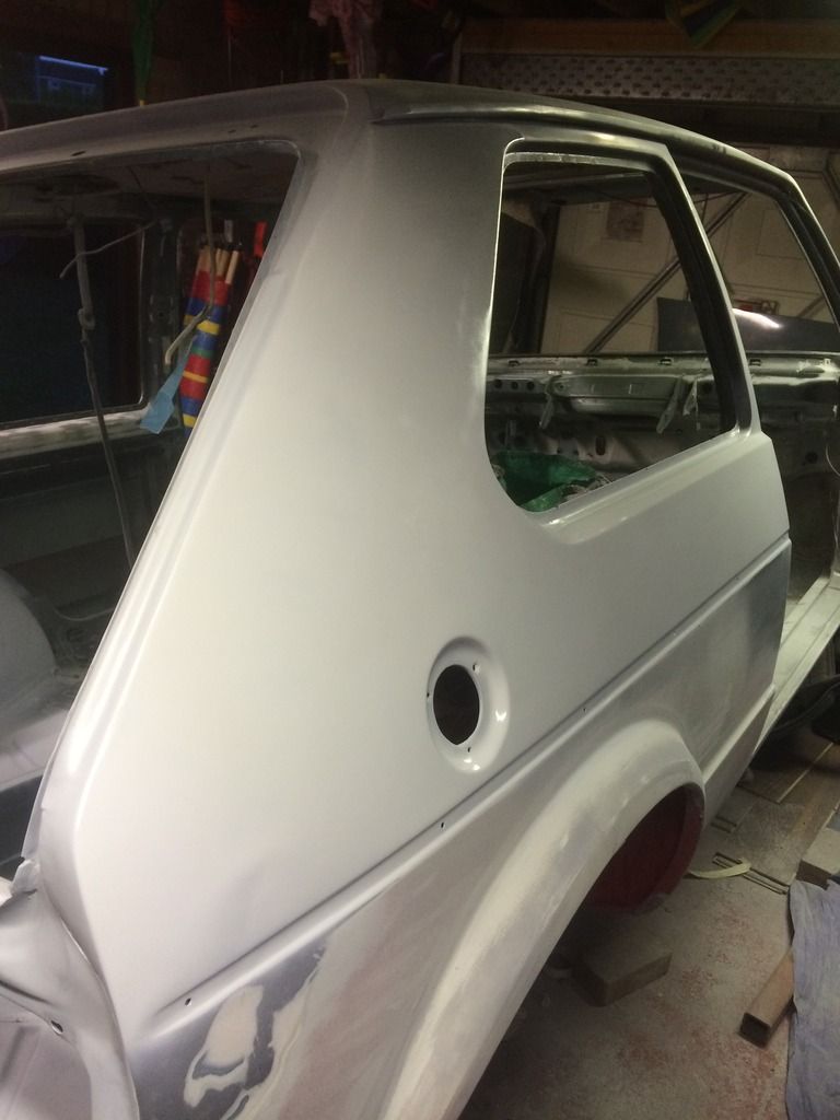

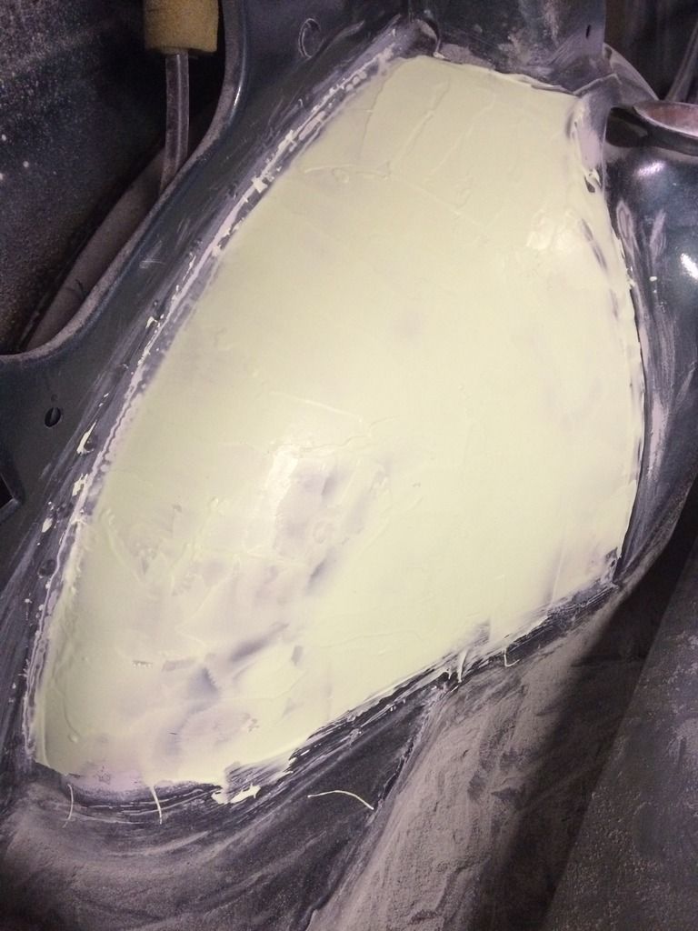

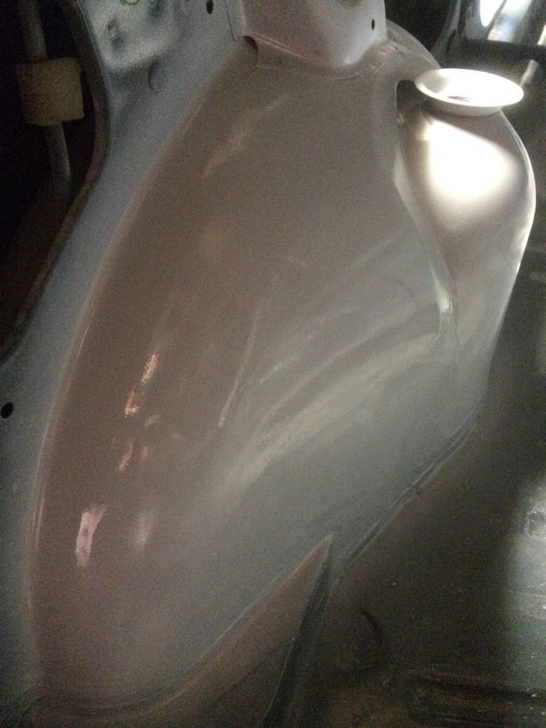

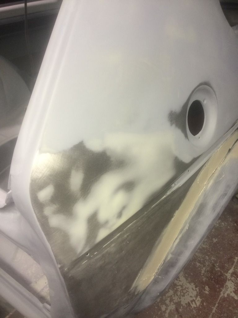

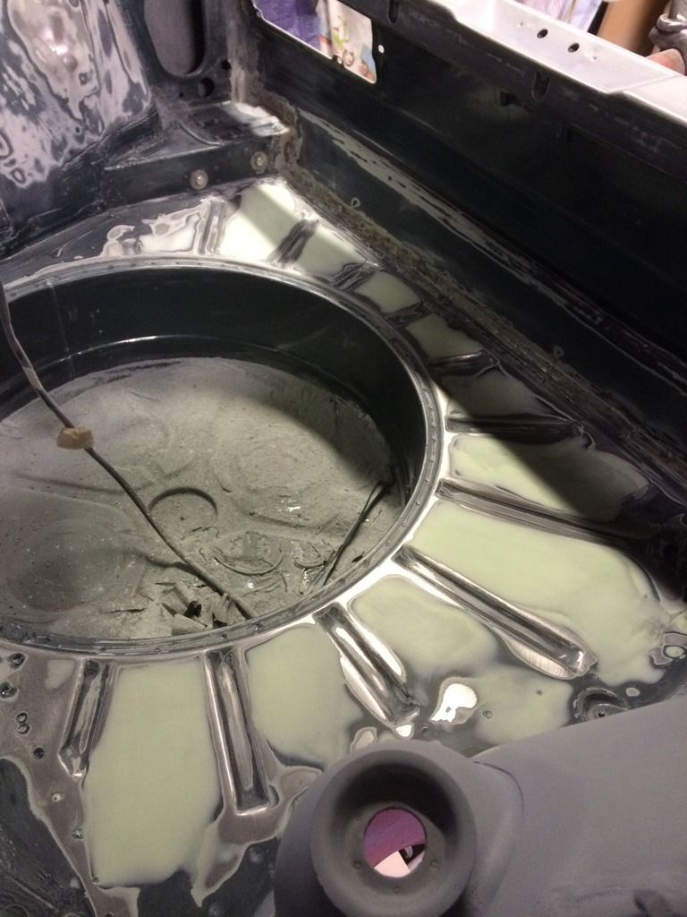

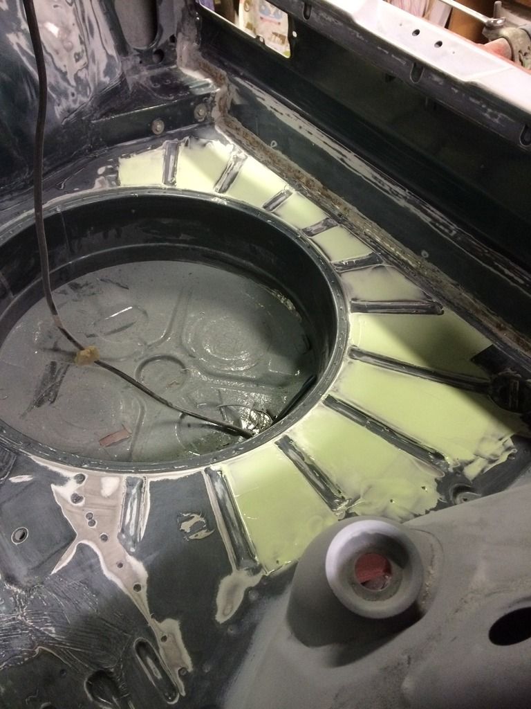

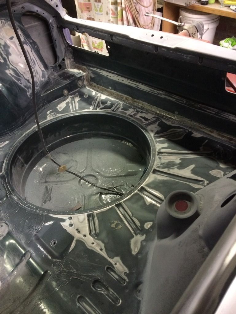

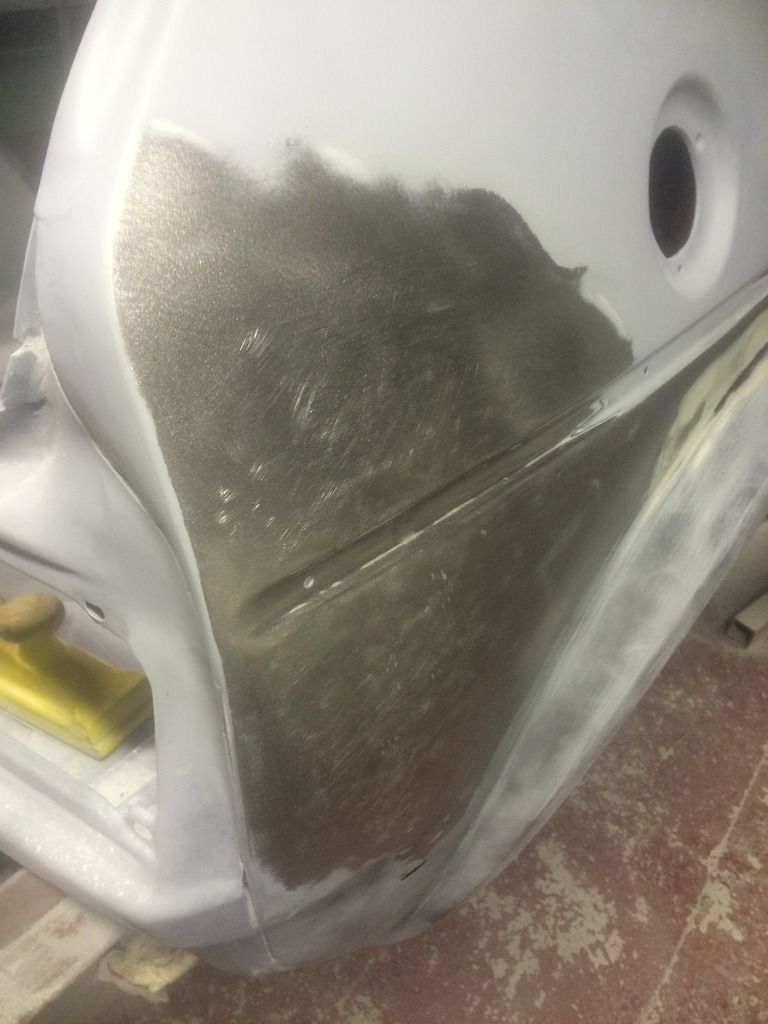

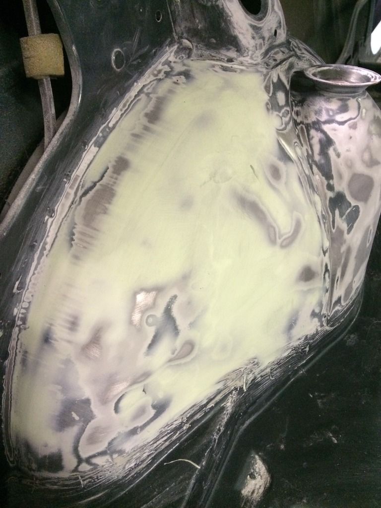

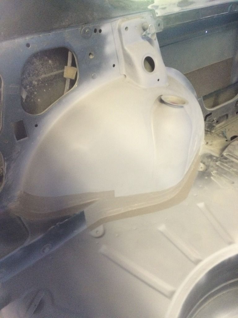

ChrisL 20 Posted January 24, 2017 thanks all, a mk1 golf gti was supposed to be my first car back in 1992 but it was just as insurances went through the roof because of cars like the XR2 being stolen all the time. The garage is great and I do have loads of space to work and can still get the wife's car in there too. The jig is also a godsend when it comes to sanding as it will rotate to exactly the right position. I said this wasn't going to be a show car but more of something I could use when I wanted, but the boot floor needed prepping for paint and got a bit carried away Bit of dolphin glaze filler just to get it a bit flatter and sanded Inner arches had a few ripples and small dents so on with a little filler all primed and some seam sealer applied to finish off On to the drivers rear quarter, decided to take it back to bare metal and found a nice ding full of filler can be seen better after priming I didn't fancy loading it with filler again incase it shrank over time so got a dent remover round Now just needed a light skim to get it dead flat More to follow Quote Share this post Link to post Share on other sites

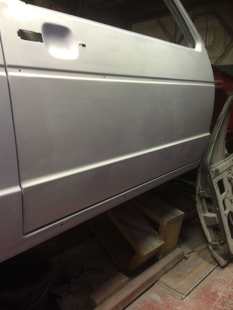

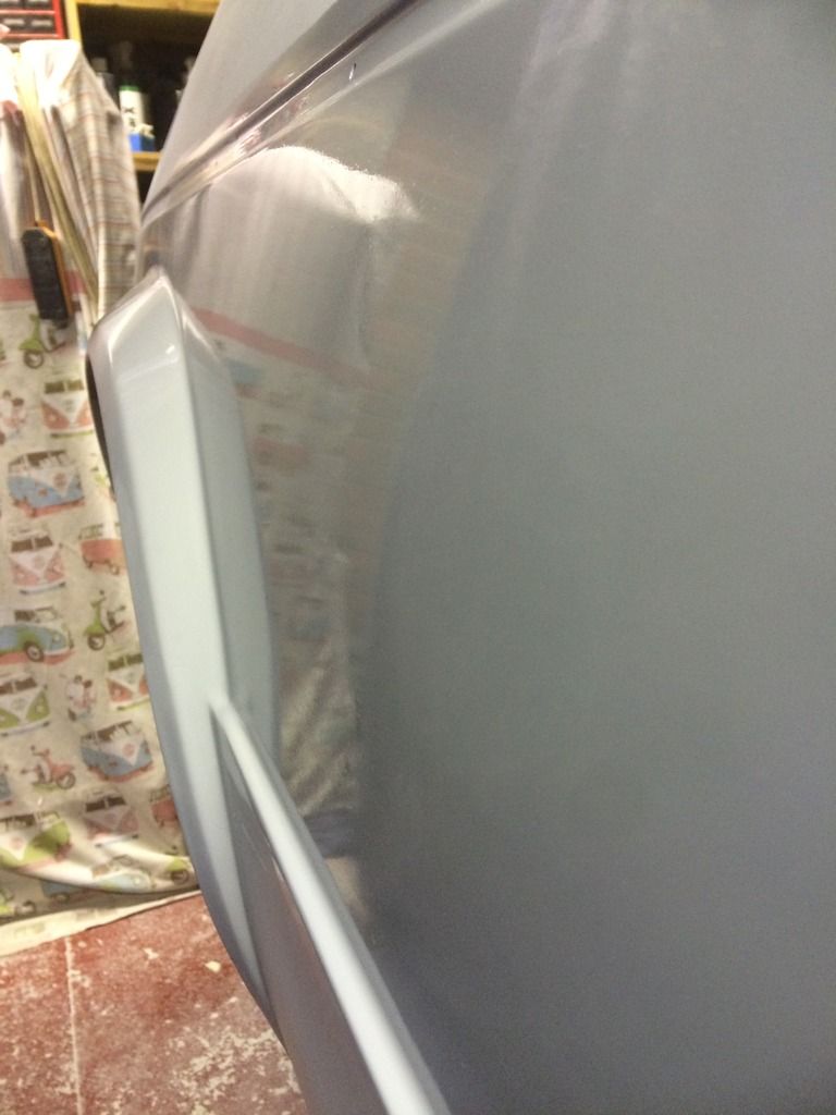

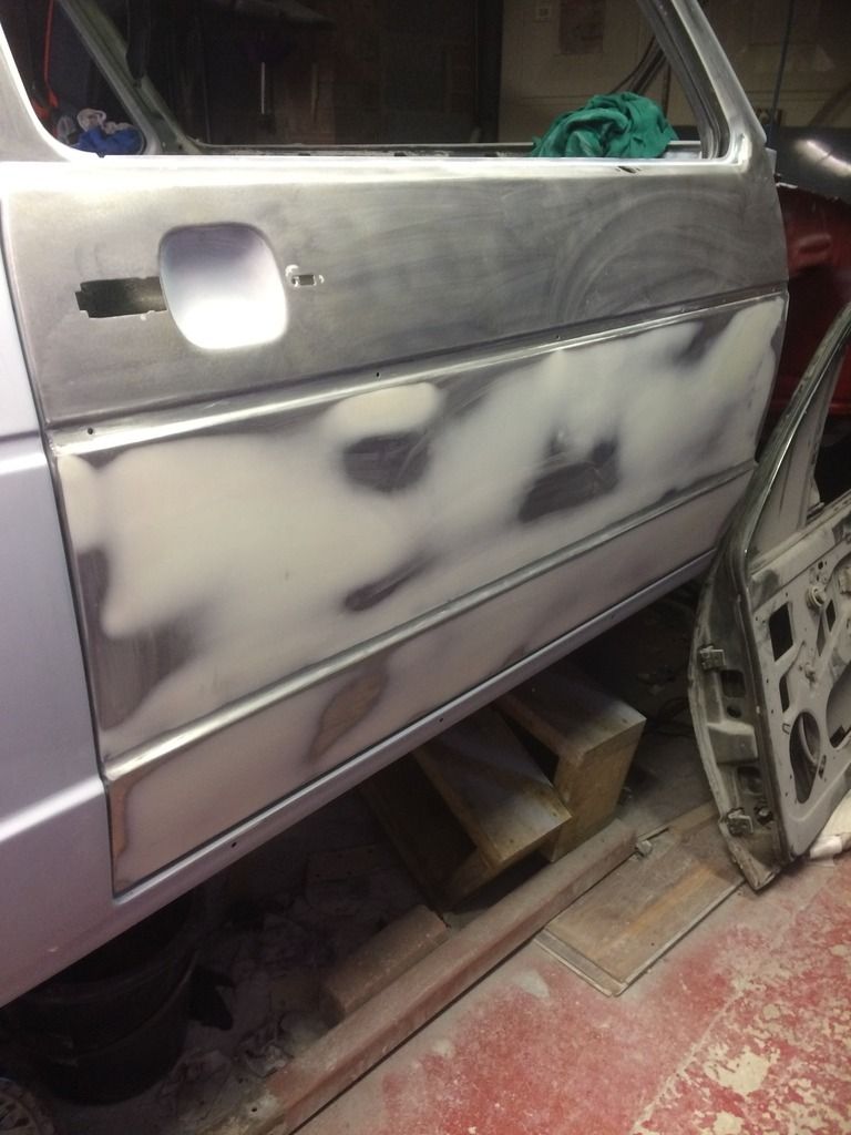

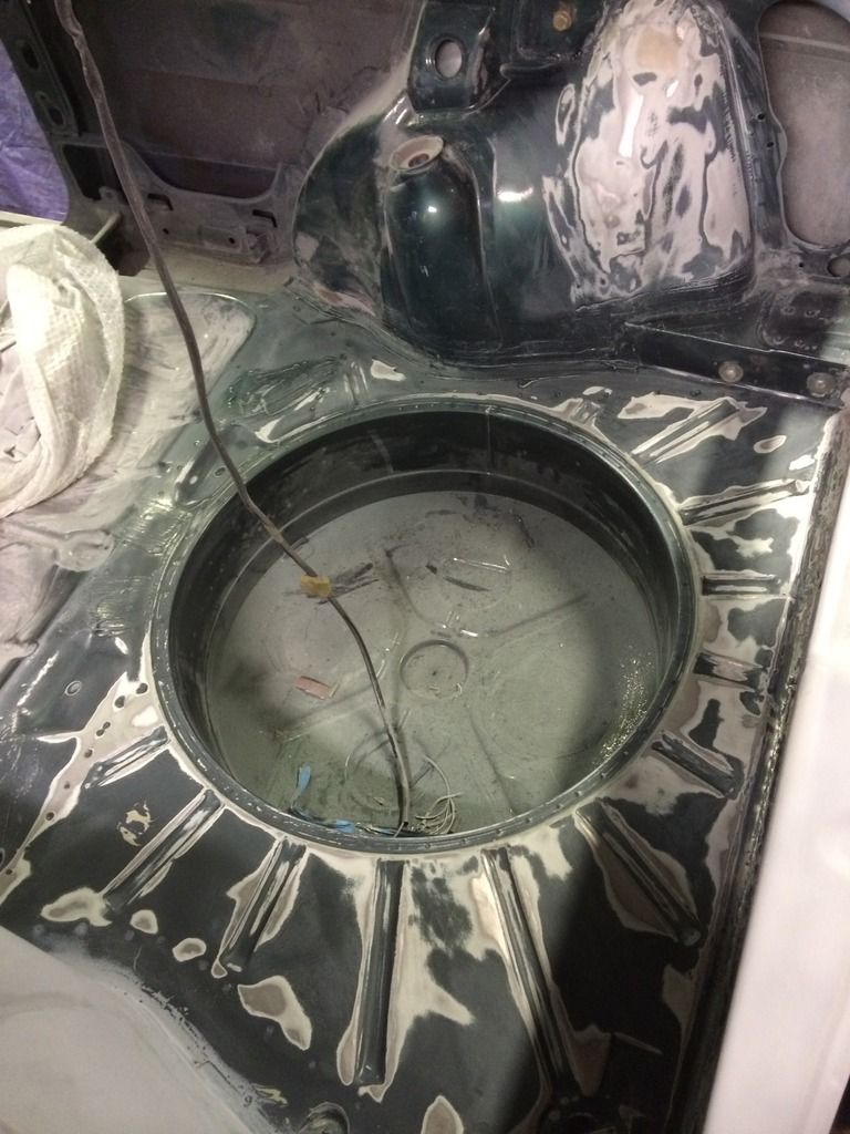

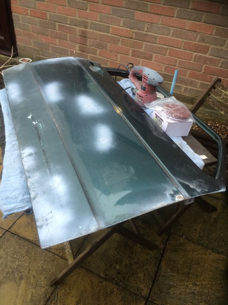

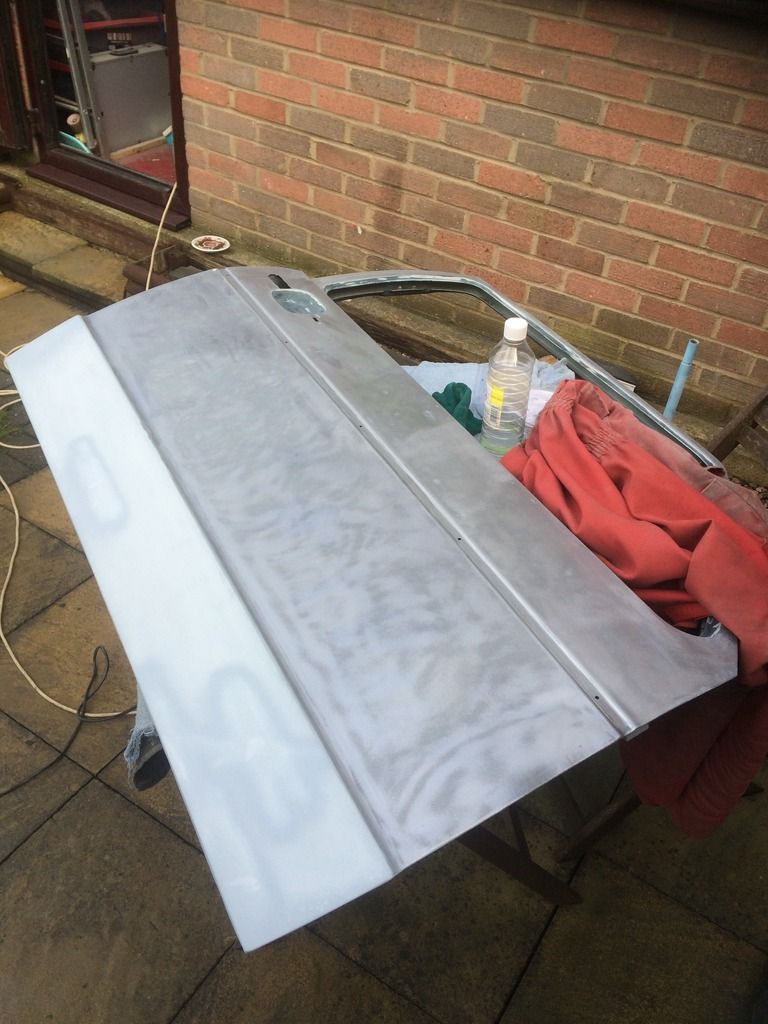

ChrisL 20 Posted February 22, 2017 Got the rear panel finished and looks nice and flat from the reflection in the wet primer Onto the doors, drivers door was the worst with a large crease at the front, plan is to go back to bare metal then have a dent remover come and get as much out as possible crease can be seen here back to bare metal dent remover managed to get it all pretty much out leaving just a light skim of filler and primed, seems pretty flat Bonnet now to take back to bare metal then I should be ready for high build primer. I'm going to try a polyester primer which is supposed to be really thick (like spraying filler apparently). Then its more blocking work......... and dust........... Quote Share this post Link to post Share on other sites
