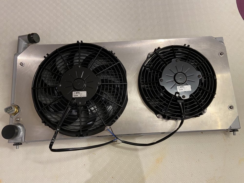

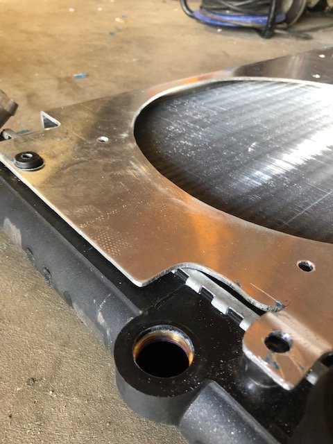

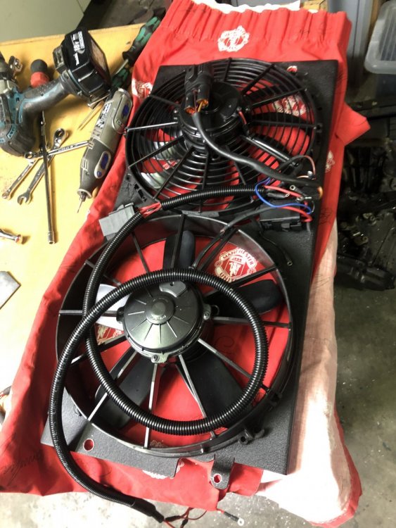

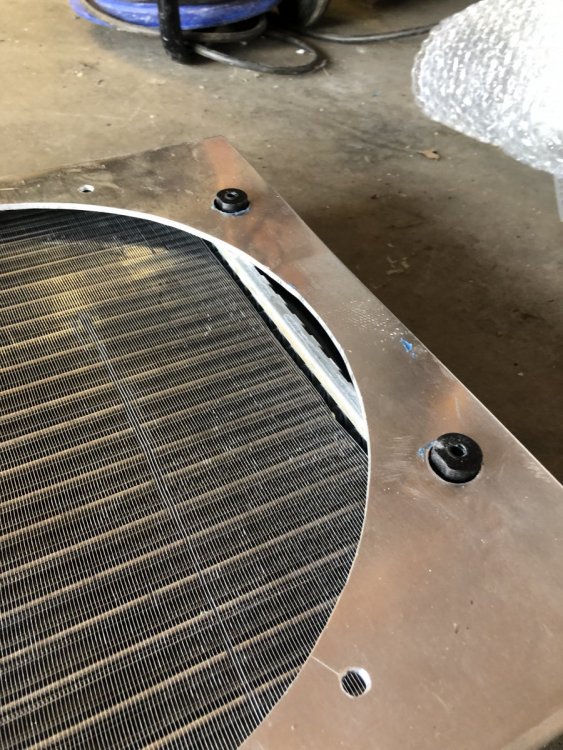

blue95 0 Posted November 15, 2020 On 11/15/2020 at 12:55 PM, 1xshaunx1 said: Good work I sat my shroud against the radiator for maximum air draw when on, you don’t really want air being sucked in from the sides as obviously you are trying to draw air through the radiator. and eventually went for these 12” fans which fit in nicely with a similar aluminium radiator to yourself Design wise I went for the easy option :), edges are sealed using a high temp seal, figured this would help with any vibration as well. Fams are also mounted on rubber washers. left some gaps at the bottom of the fans though for drainage and debris etc. Quote Share this post Link to post Share on other sites
1xshaunx1 27 Posted November 15, 2020 On 11/15/2020 at 3:09 PM, blue95 said: Design wise I went for the easy option :), edges are sealed using a high temp seal, figured this would help with any vibration as well. Fams are also mounted on rubber washers. left some gaps at the bottom of the fans though for drainage and debris etc. Good stuff 👍 Quote Share this post Link to post Share on other sites
