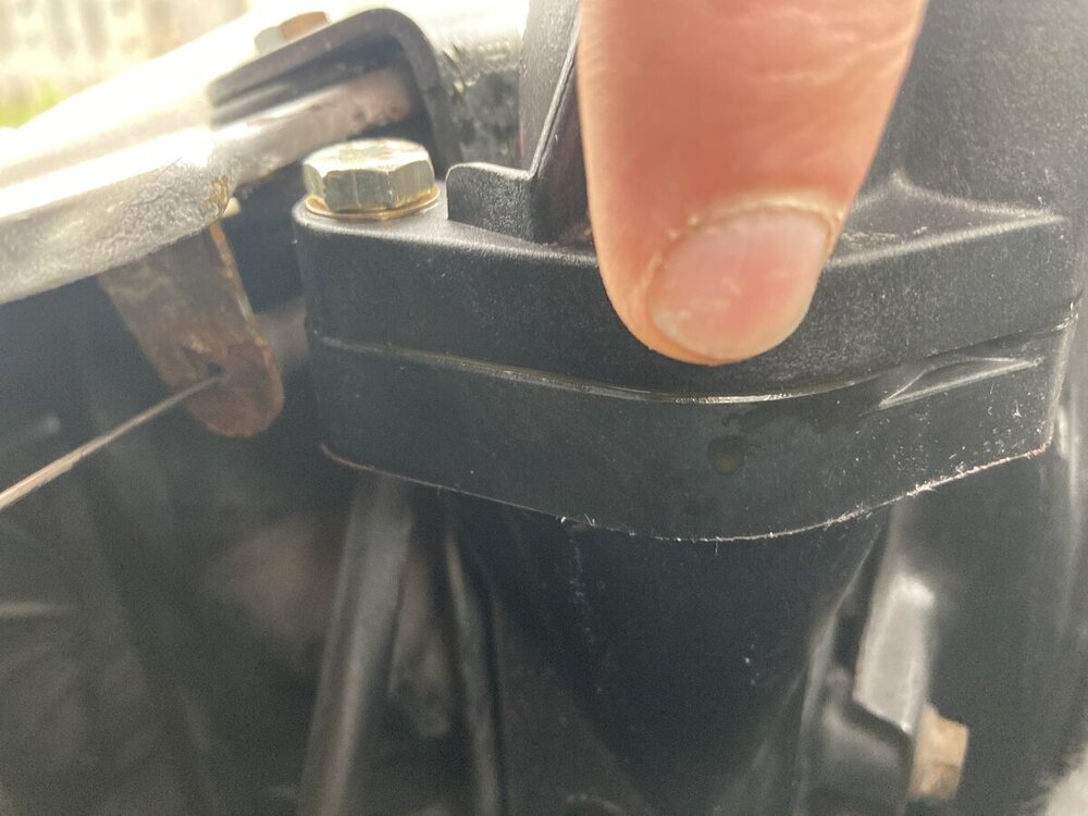

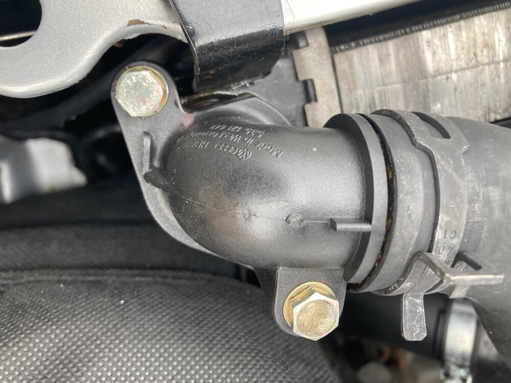

Keyo 49 Posted June 27, 2022 (edited) Hi keep getting the odd spurt of coolant leaking out of this flange can see it on bonnet - first fitted aftermarket- now got an original not sure if the seal is genuine so have ordered one - what torque should these bolts be please maybe I have them to tight ? I take it I’m putting the o ring in the correct place ? Thanks red circle shows where I’m putting o ring . Edited June 27, 2022 by Keyo Quote Share this post Link to post Share on other sites
oneohtwo 8 Posted June 27, 2022 I think you've got the o-ring in the right place. I always thought it was an odd place to seal as it doesn't get really clamped by the bolts. What Rad have you got? If I recall you got one of the last available aftermarket brand ones? I had a GSF radiator at one point and it was a very poor seal... The plastic housing was slightly too big so the elbow wasn't a tight fit. When I replaced with a Hella version a couple of years ago the difference was instantly noticeable, so it could be the rad rather than the seal. In the end all I could do was smear gasket sealant around where the two faces met. Quote Share this post Link to post Share on other sites
Keyo 49 Posted June 27, 2022 (edited) On 6/27/2022 at 7:18 AM, oneohtwo said: I think you've got the o-ring in the right place. I always thought it was an odd place to seal as it doesn't get really clamped by the bolts. What Rad have you got? If I recall you got one of the last available aftermarket brand ones? I had a GSF radiator at one point and it was a very poor seal... The plastic housing was slightly too big so the elbow wasn't a tight fit. When I replaced with a Hella version a couple of years ago the difference was instantly noticeable, so it could be the rad rather than the seal. In the end all I could do was smear gasket sealant around where the two faces met. Thanks mate it’s actually for the g60 which the devils use the same flange as a vr6 - radiator Is obsolete like that of a vr6 - rad is 5 years old and a Hella - could anyone recommend a good gasket seal if new genuine o ring fails - maybe I have the bolts too tight would love to know the torque settings - cheers im not sure why they even designed this top rad flange - Mk2 rads are so much stronger . Edited June 27, 2022 by Keyo Quote Share this post Link to post Share on other sites
Cressa 45 Posted June 27, 2022 That is in the right place. Unless it is lubed, the dry seal tight fit can distort. Definitely worth the new genuine parts. The torque value is really low, but I am trying to survive prague 🍻 at the moment. Happy to check the Bentley when back, but I am sure someone will post up 1st Quote Share this post Link to post Share on other sites
