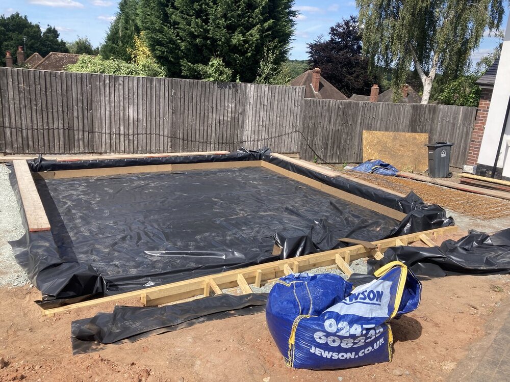

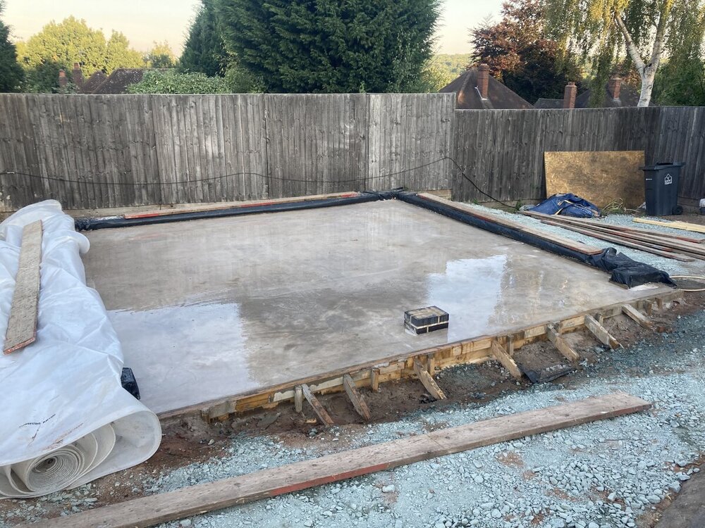

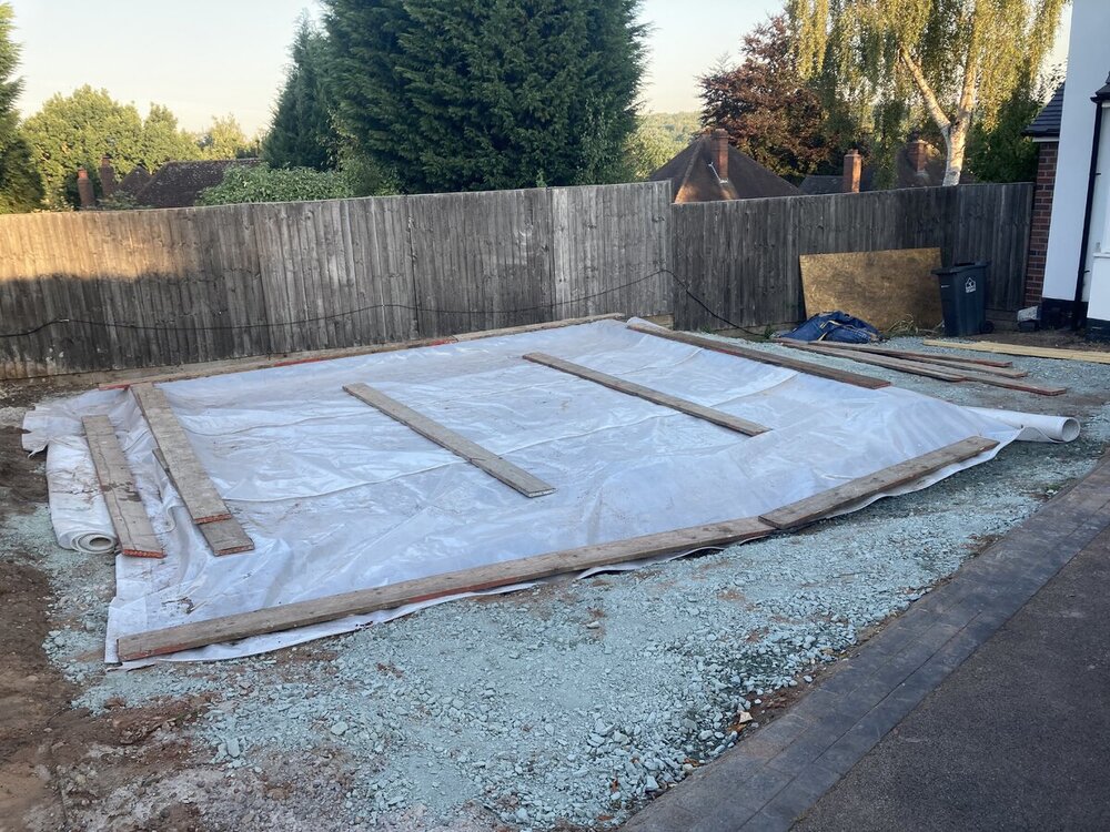

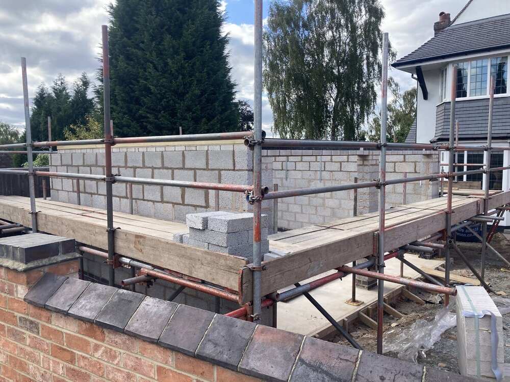

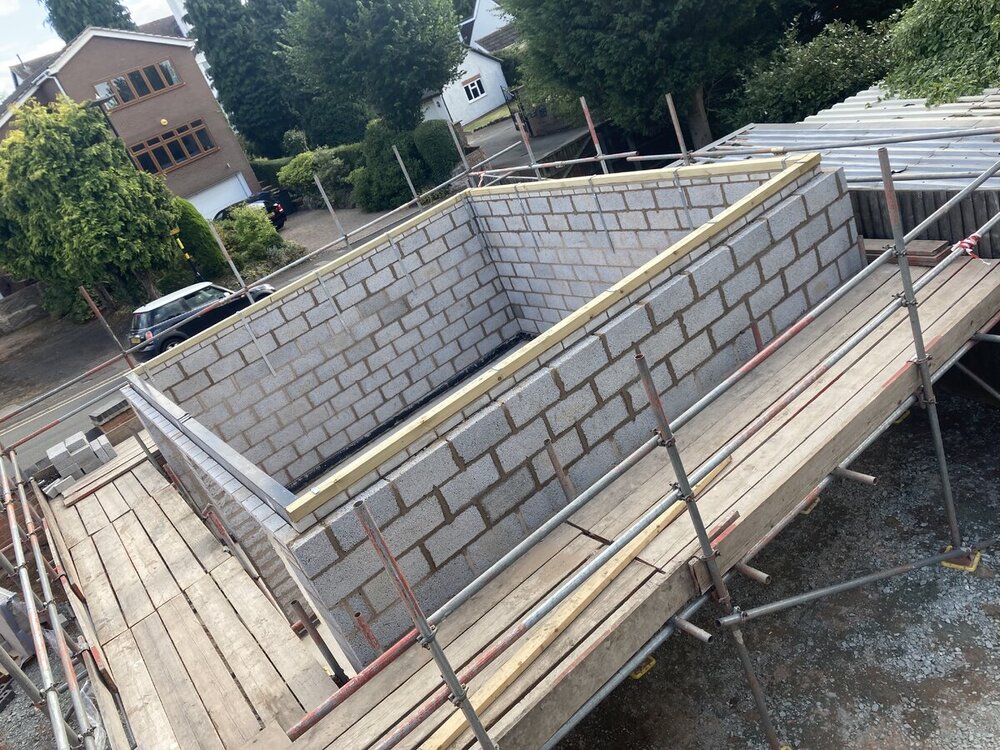

Keyo 49 Posted August 13, 2022 (edited) Its has been a slow process on the garage build but things have been moving on now - my builders went on holiday so decided to do the slab after doing some research . Did the shuttering at the front then carried on to reinforce the concrete with lattice chairs at the base then mesh on top which gives a double layer tie- also squidgy 15 mm boards used around perimeter to allow for expansion . The concrete poor started at 5 pm 40 newton meter mix- then was was finished buffed off at 10 pm - it has been very challenging with the weather in the 30s- so opted for a pooling cure - wet slab and let the concrete sweat under the white reflective sheeting basically promoting a slow cure time with slow hydration (water escape) curing is what gives the concrete strength and if it dries out to quick you get plenty of cracking and a very powdery surface- only achieve 50 percent of strength as hydration is what causes the chemical reaction. Slab will be left to be pooled for 1 week- with sheets taken off every night- let the slab breath for a couple of hours then hose down and sheets back on. Walls and wall plate will by the on including cantic beams end of next week - then roof trusses delivered Monday and roof completed end of that week. Roof will be constructed with ready made trusses- tiles are Staffordshire clay Dreanoughts manufactured from local the clay pit and fired in the Black country - Arris Hips will be used to match the main roof which give a sharp roof line and low maintenance as you do not need to use mortar to point like a half round just a nail at the top and a dab on the bottom of grabber . Under sheeting I'm using the dreadnought extra thick. Im really in two minds just to paint the concrete blocks white internal instead of plaster boards and plastering. Same for the roof - really cant see no point plastering it - happy for the roof space to be seen and can stack the odd thing or two on the wooden trusses. Popped down the local quarry and they made me up some saddle stones from Granite to put under the base of the oak columns which will be placed on the façade of the front elevation . Edited August 13, 2022 by Keyo Quote Share this post Link to post Share on other sites

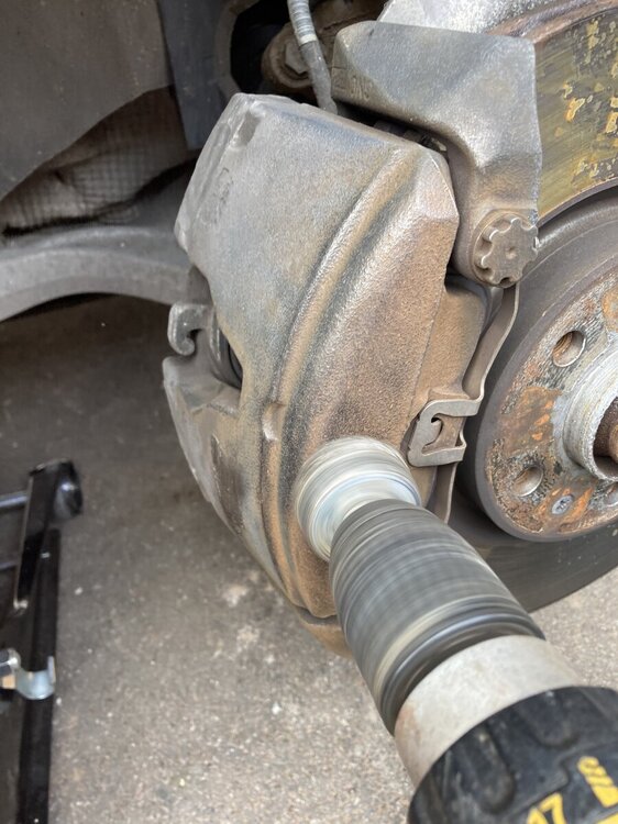

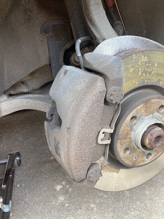

Keyo 49 Posted August 21, 2022 (edited) Did a couple of jobs on the Audi today - de baged rear panel fir a clean look - painted callipers and fitted some decal and some new wheel caps . 320 mm I think they are. Garage truss roof arriving tomorrow so full doors sharada on that . Edited August 21, 2022 by Keyo Quote Share this post Link to post Share on other sites

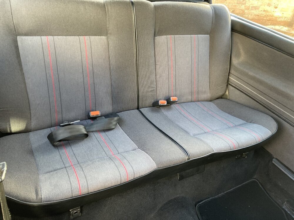

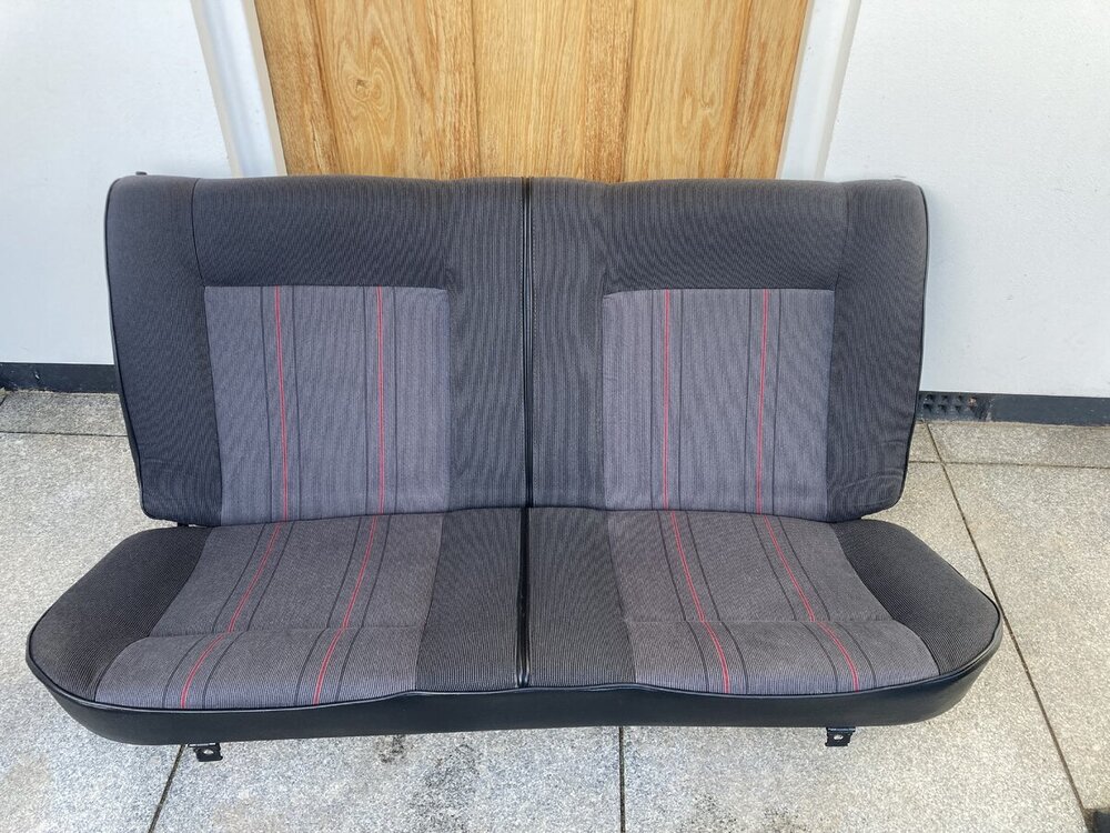

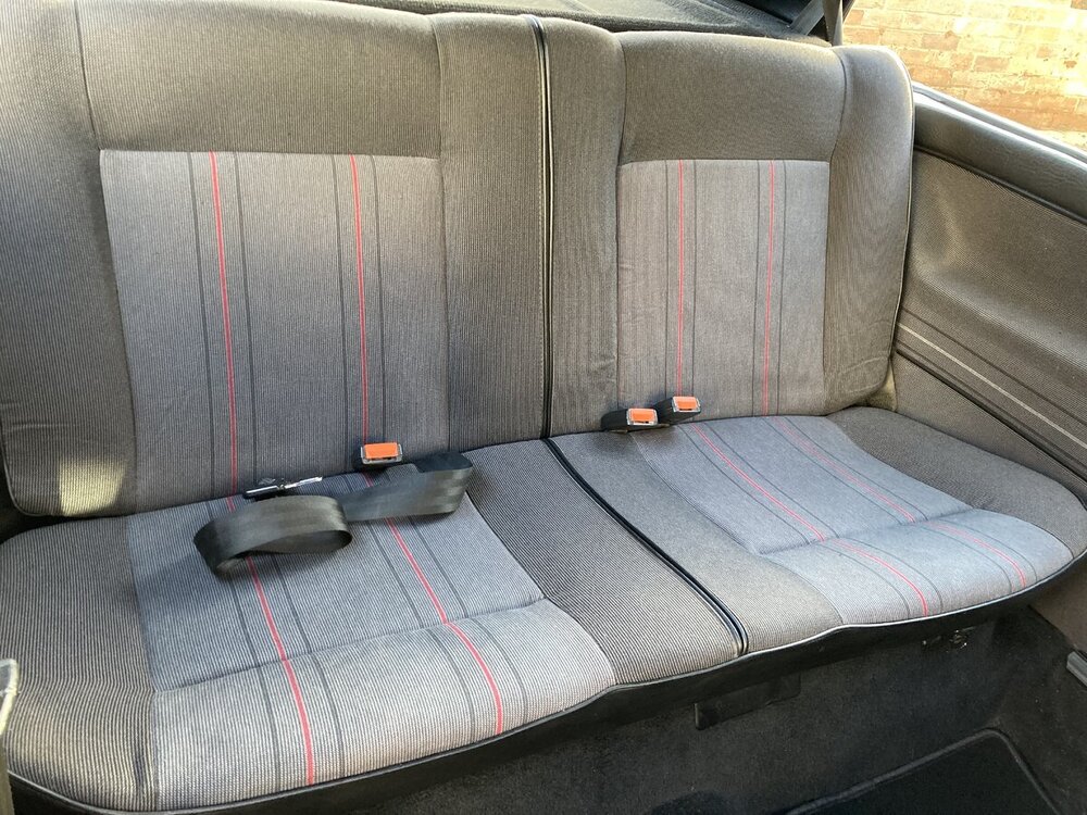

Keyo 49 Posted December 20, 2022 (edited) Can’t recommend this trimmer enough based in Walsall - I gave him a rainbow bench and some recaro cloth - picked this up earlier - charged me £200 labour - not sure how these scene trimmers are charging people thousands ?when a 60 year old knocks this out the bag in a large shed - love the old skool traders ! Edited December 20, 2022 by Keyo Quote Share this post Link to post Share on other sites
