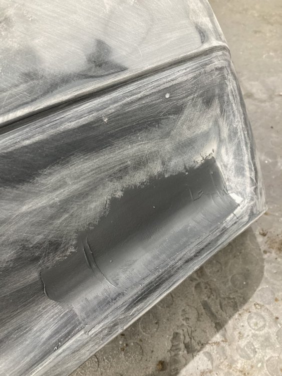

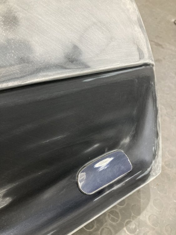

ChrisL 20 Posted November 3, 2021 So not having a lot of spare time to work on the corrado but decided to have the rear bumper painted as the lacquer was peeling and there were a couple of rough areas. also ended up filling in the towing eye. Quote Share this post Link to post Share on other sites

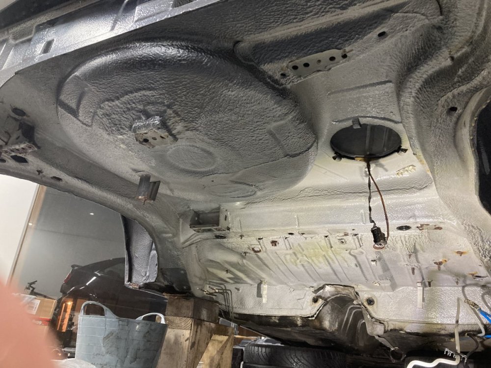

ChrisL 20 Posted November 16, 2021 Boot floor cleaned. Few touch ups on the stone chip and treat some of the studs then ready for re-assembly Quote Share this post Link to post Share on other sites

Cressa 44 Posted November 16, 2021 Ooo that is a good looking underside 🤩 Atleast you know it is in a great condition, well done 👍 Quote Share this post Link to post Share on other sites
ChrisL 20 Posted November 16, 2021 2 hours ago, fla said: Agreed. As an aside Chris any news on your previous cars? Hasan Cheers, they both sold at auction and fetched strong money. Think the storm went for around £27k not sure where they both are now. need to get this to the same standard. Quote Share this post Link to post Share on other sites
ChrisL 20 Posted November 16, 2021 5 minutes ago, Cressa said: Ooo that is a good looking underside 🤩 Atleast you know it is in a great condition, well done 👍 Pleased with how clean it is really. Couple of bits to sort though. Quote Share this post Link to post Share on other sites
seanl82 23 Posted November 16, 2021 7 minutes ago, ChrisL said: Cheers, they both sold at auction and fetched strong money. Think the storm went for around £27k not sure where they both are now. need to get this to the same standard. I'm sure you will mate. Matching the colour of the underseal may be a bit of a challenge. I just painted it all instead! 😆 Quote Share this post Link to post Share on other sites
ChrisL 20 Posted November 16, 2021 10 minutes ago, seanl82 said: I'm sure you will mate. Matching the colour of the underseal may be a bit of a challenge. I just painted it all instead! 😆 Cheers Sean, did you spray all the underneath? Might be awkward to do in the garage. a lot of the areas are covered by heat shields so might not be too bad. The original vw stuff isn’t available so got some dinitrol stuff that’s supposed to be like OEM 🤞 Quote Share this post Link to post Share on other sites
seanl82 23 Posted November 17, 2021 9 hours ago, ChrisL said: Cheers Sean, did you spray all the underneath? Might be awkward to do in the garage. a lot of the areas are covered by heat shields so might not be too bad. The original vw stuff isn’t available so got some dinitrol stuff that’s supposed to be like OEM 🤞 Yeah I used Dinitrol too. It's easy enough to get the texture the same as the factory stuff, but my underseal had yellowed quite a bit and was heavy with factory overspray. I went for white Dinitrol and it was too bright and obvious, so a heavier covering of overspray just made it look very patchy. As I had literally everything removed anyway, I just painted the lot! Quote Share this post Link to post Share on other sites
ChrisL 20 Posted November 17, 2021 43 minutes ago, seanl82 said: Yeah I used Dinitrol too. It's easy enough to get the texture the same as the factory stuff, but my underseal had yellowed quite a bit and was heavy with factory overspray. I went for white Dinitrol and it was too bright and obvious, so a heavier covering of overspray just made it look very patchy. As I had literally everything removed anyway, I just painted the lot! Did you spray the underneath? If so did you use rattle cans? Did you lacquer it afterwards? I'm thinking of the mess in trying to spray the floor as it is now. Quote Share this post Link to post Share on other sites

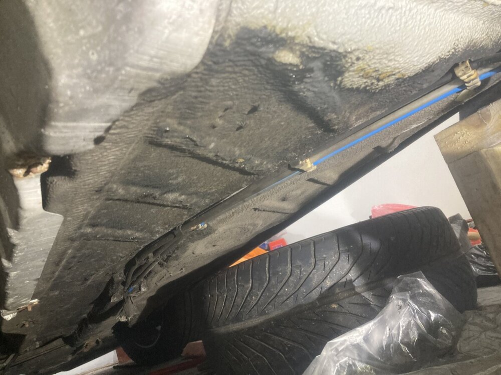

ChrisL 20 Posted November 23, 2021 This is going to take some time 🤦♂️ Quote Share this post Link to post Share on other sites

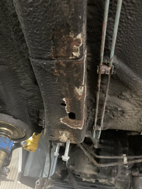

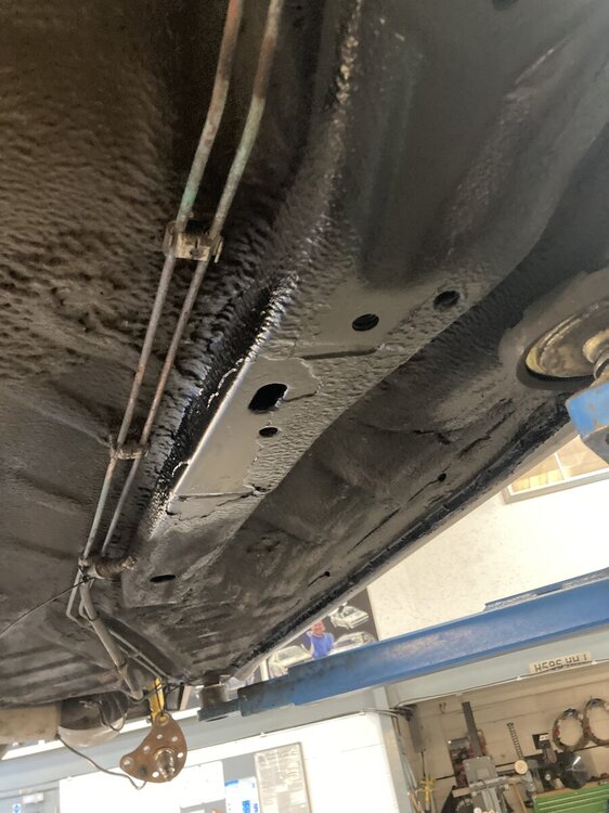

Keyo 47 Posted November 23, 2021 (edited) I nipped into jabba today whilst the frames were off and got to this bit - just surface rust - gave it wire wheel - krust- zink primer- followed by some stone chip - will seal once its all cured. Its had a few bits that ive had to wire wheel and treat . Edited November 23, 2021 by Keyo Quote Share this post Link to post Share on other sites
ChrisL 20 Posted November 23, 2021 20 minutes ago, Keyo said: Mate if its not peeling dont have to kill yourself taking it all off. That would be an horrific job but good luck with the job if you do. Hi mate, I’m not taking the stone chip off, just cleaning all the oil and factory wax oil off. It’s perfect under the filth. Quote Share this post Link to post Share on other sites
