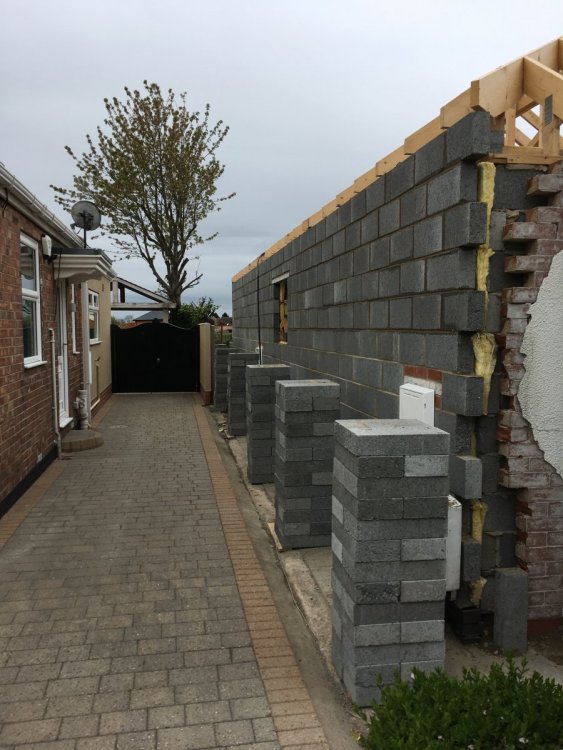

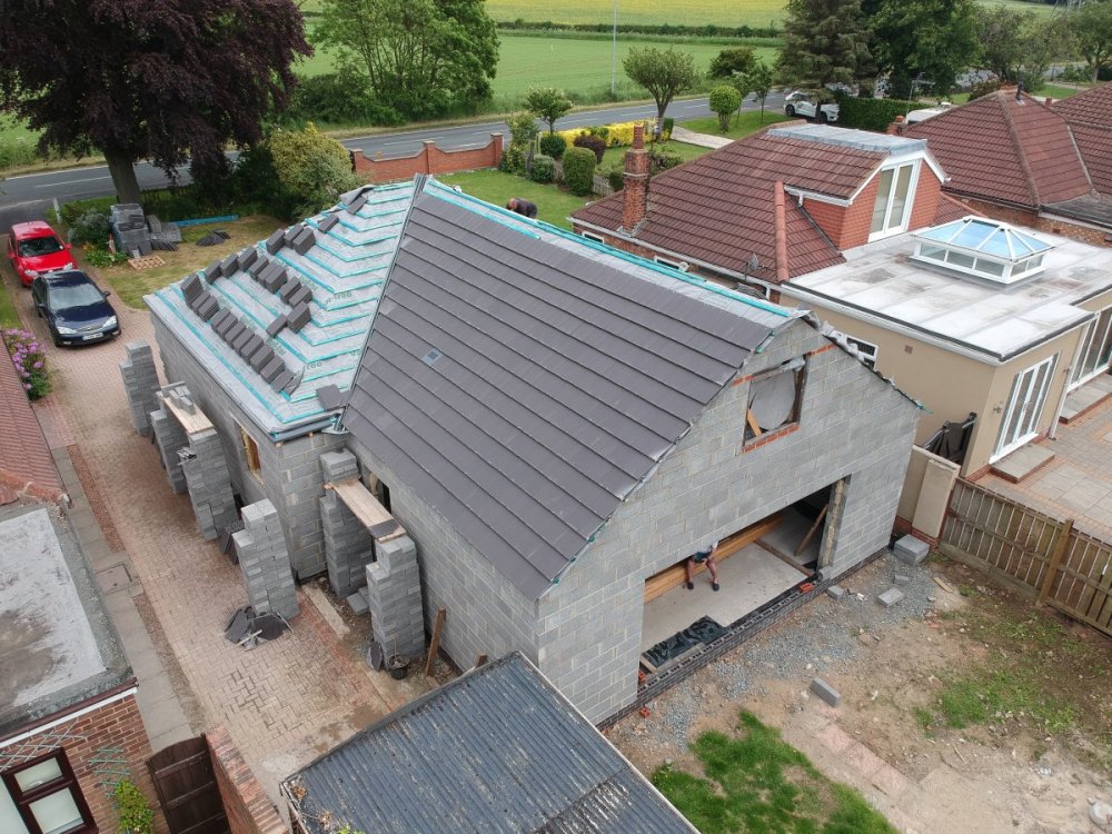

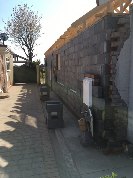

ChrisL 20 Posted February 22, 2020 Struck lucky here really, the neighbours are great. One of them didn’t even bat an eyelid when I told him I’d cracked his wall with the digger 😂 thanks Kippy, if your ever running in Hull feel free to pop round, be good to see you. Share this post Link to post Share on other sites

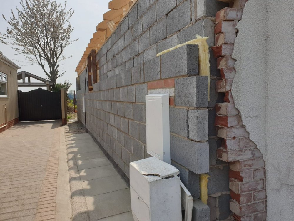

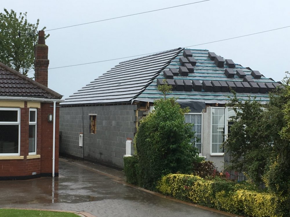

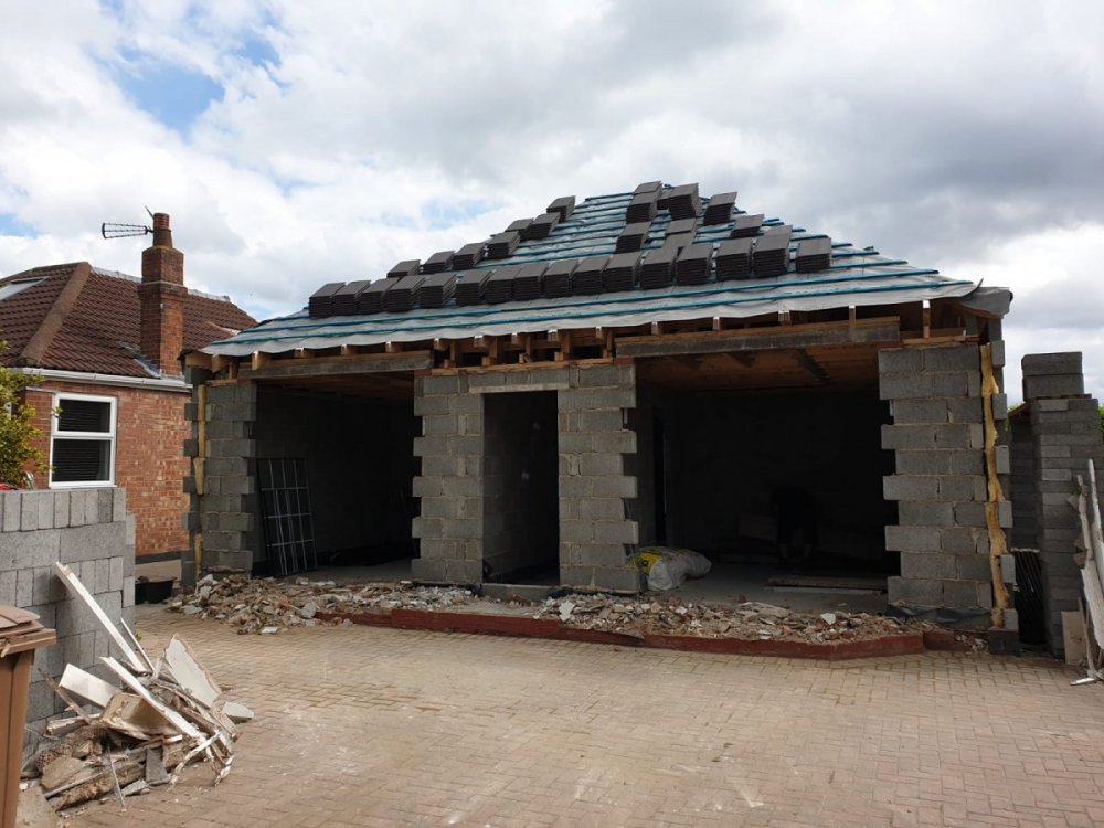

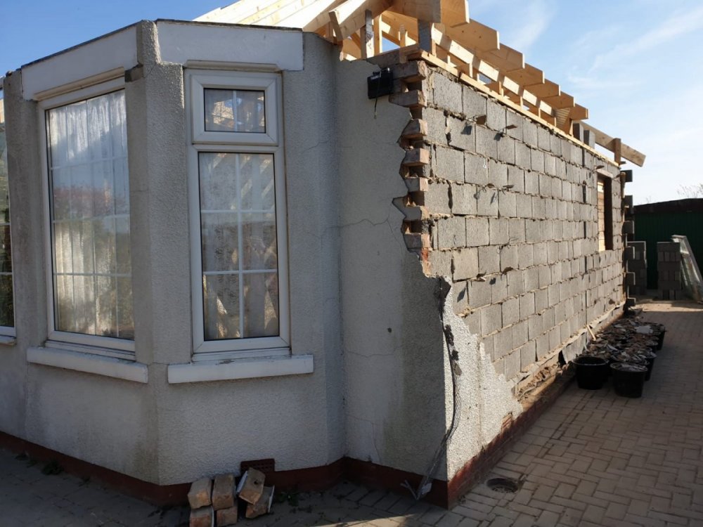

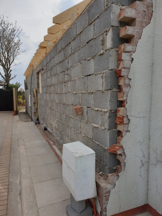

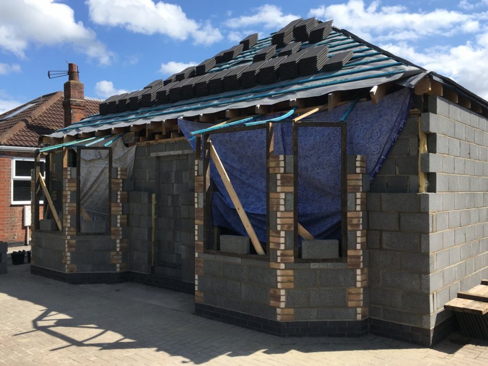

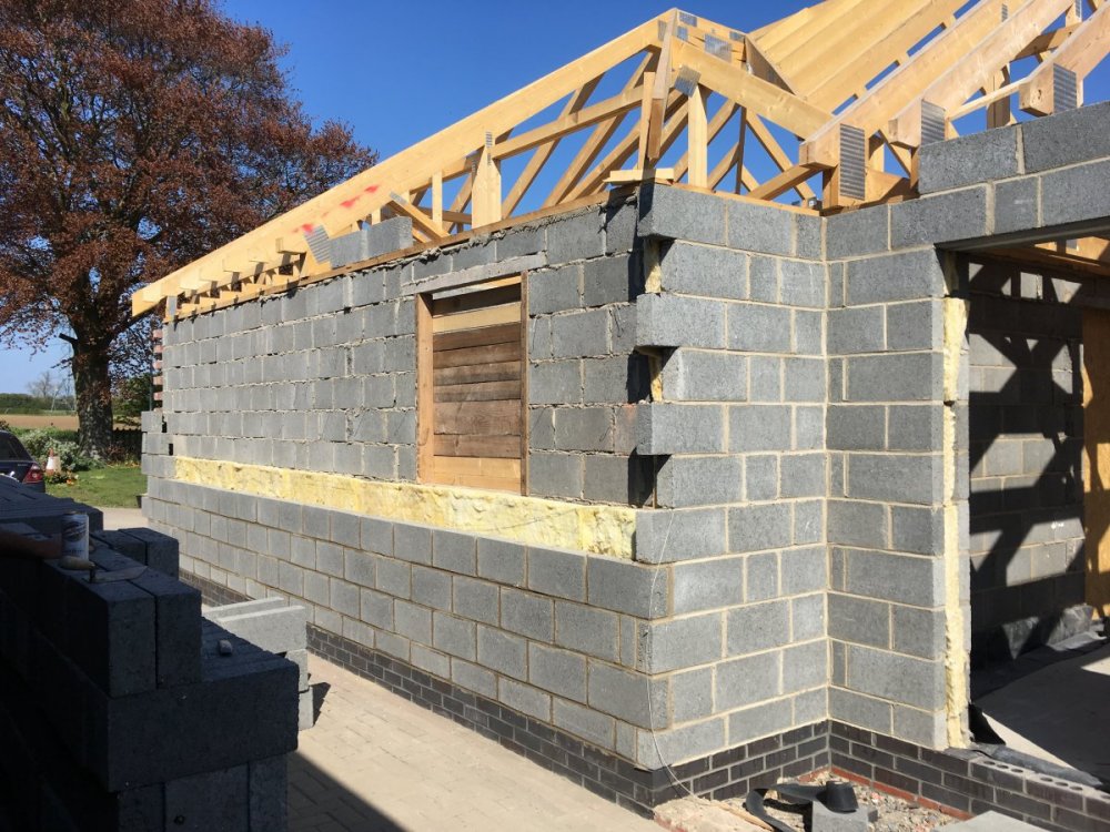

ChrisL 20 Posted February 22, 2020 With the roof on it was time to knock down and rebuild the external walls and put some insulation in the cavities. Share this post Link to post Share on other sites

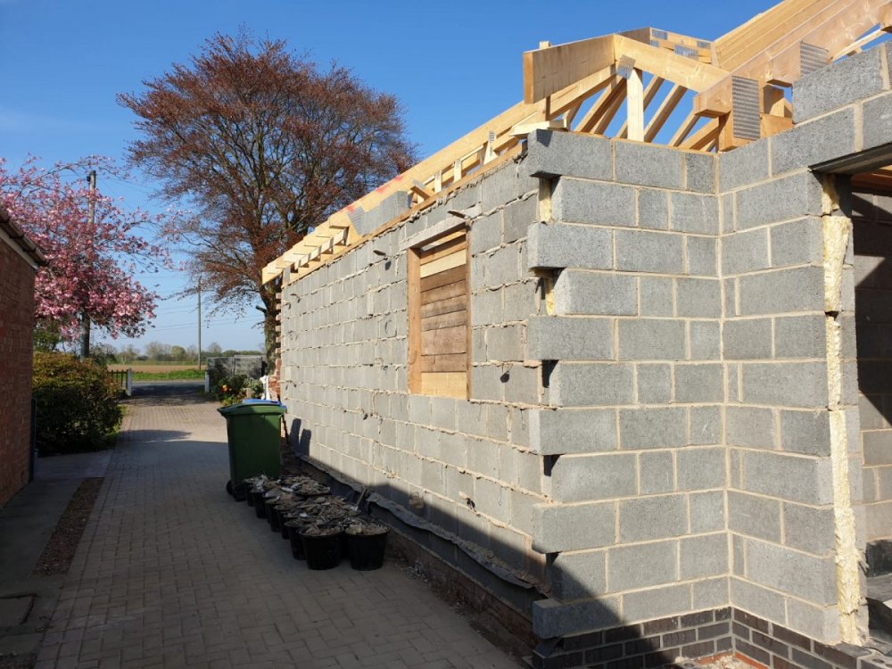

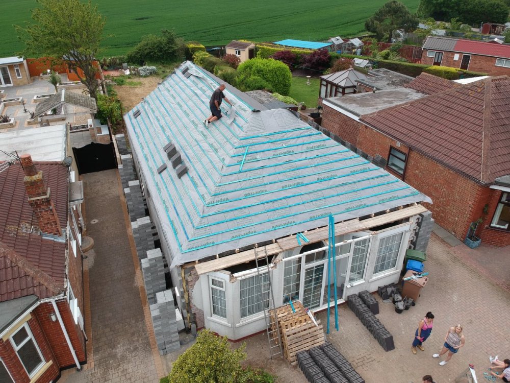

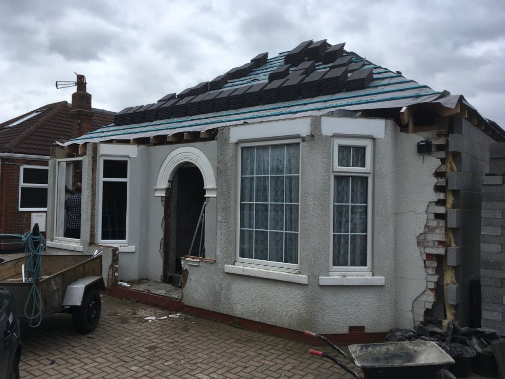

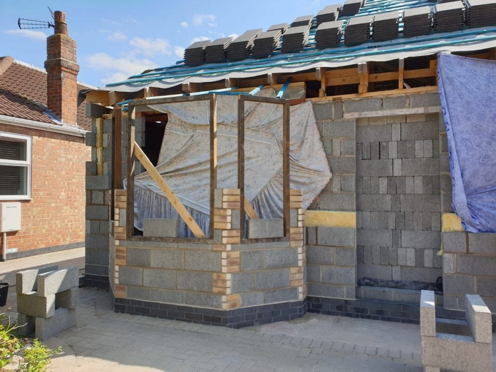

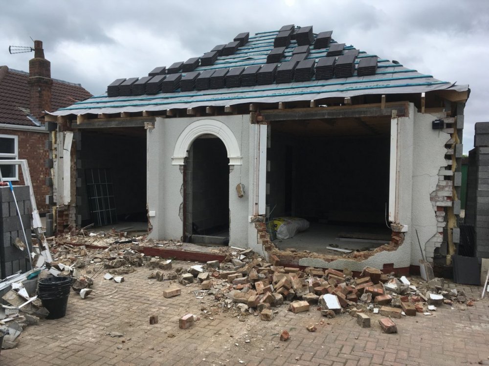

ChrisL 20 Posted February 22, 2020 Can’t see the pics mate? Roof felt on, lats on and partly tiled. Share this post Link to post Share on other sites

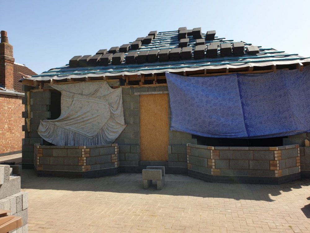

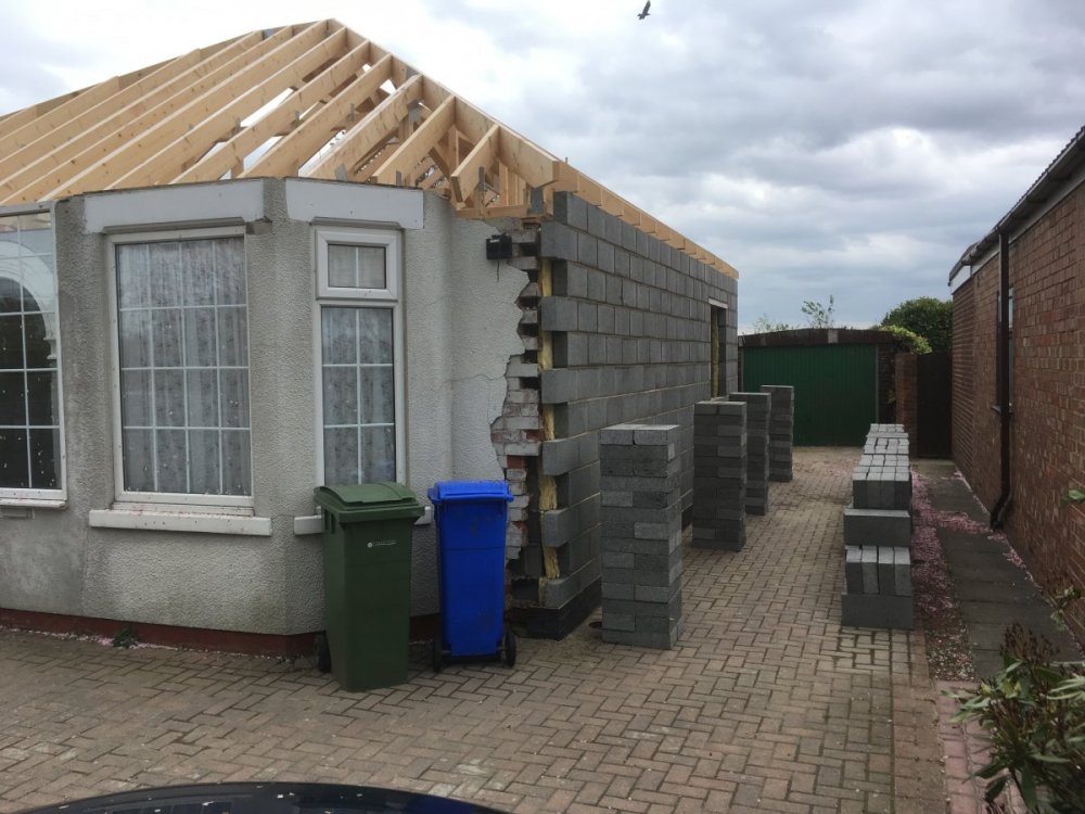

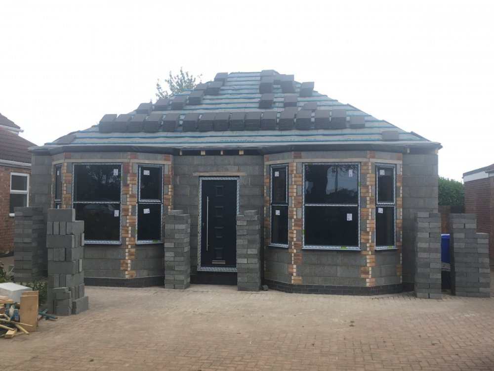

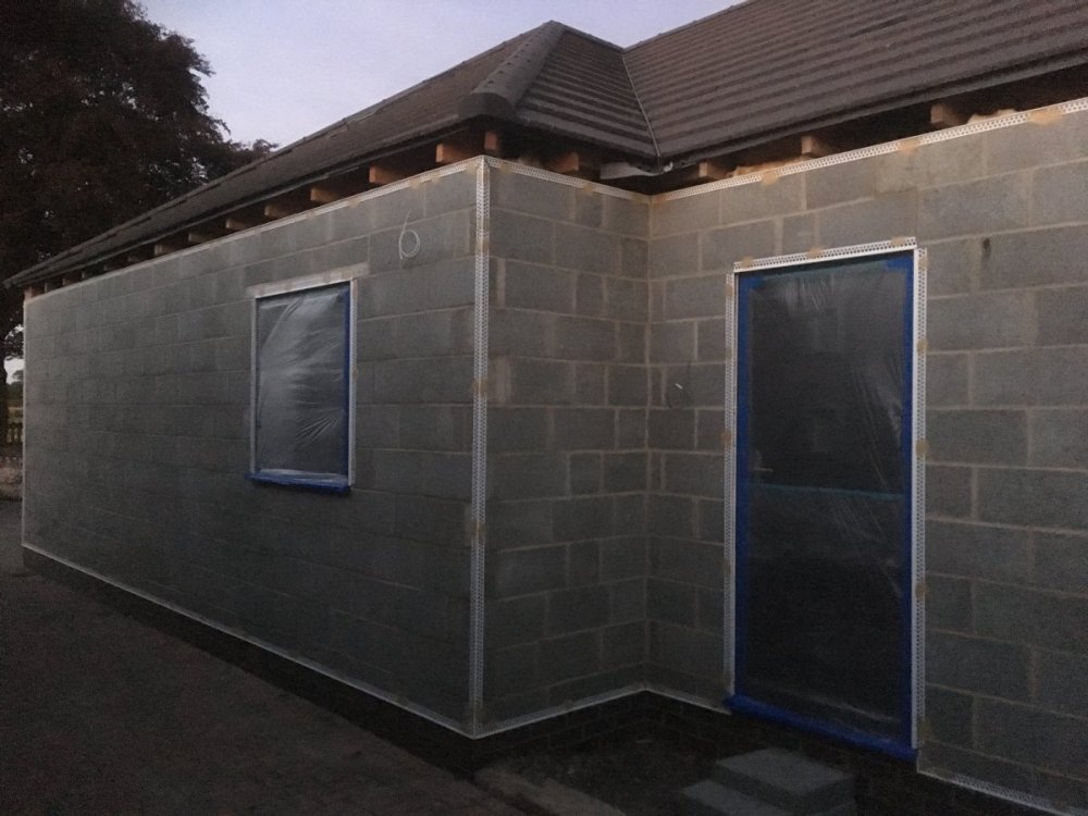

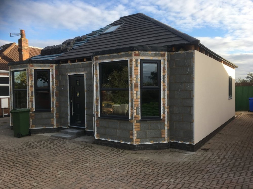

ChrisL 20 Posted February 22, 2020 The last of the walls where done next, the full front to replace Share this post Link to post Share on other sites
seanl82 23 Posted February 22, 2020 Well done mate, looks a huge amount of work! I'm sure you had reason, but it surely would have been easier to level of and start a build from scratch!? Share this post Link to post Share on other sites
ChrisL 20 Posted February 22, 2020 It had major damp problems and this was the way to sort it for good. if we’d have knocked it down fully and started again we would have had to go for complete planning permissions again whereas this way we only needed planning for the extension. Share this post Link to post Share on other sites
seanl82 23 Posted February 22, 2020 Ah makes sense mate. Was it single skin before? There are quite a few 70s built bungalows surrounding our house of non standard construction and single skin, which suffer awfully with damp. Ours isn't the best but with foot thick stone walls and no cavity so poor insulation, no air bricks and the only window/door vents from the French doors we put in, it's understandable. No mains gas to our village either so costs a fortune in heating oil bills in the winter months as we have to open the windows for a couple of hours every day to get some air flow! Share this post Link to post Share on other sites
ChrisL 20 Posted February 22, 2020 It had a 50mm cavity but no insulation, the damp course was slate so no good, all the bricks in the internal walls where damp so replaced by blocks and proper damp proofing. The front however didn’t have any cavity so we put it back with one. in the 50mm cavity walls we packed with insulation and internally used insulated plaster board to give the same properties as a 100mm cavity. the insulated plasterboard might be good for your walls if you have any more decorating to do. im with you on the gas, our old house didn’t have gas. Share this post Link to post Share on other sites

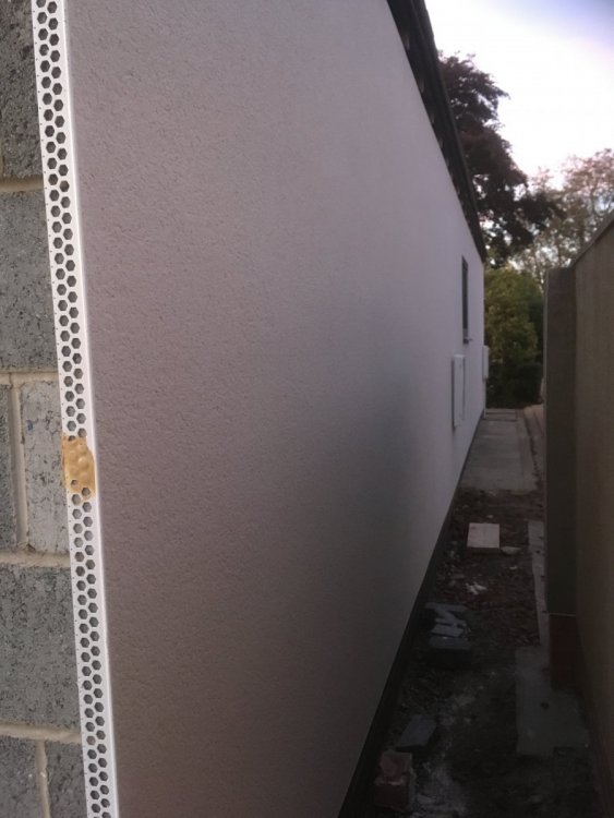

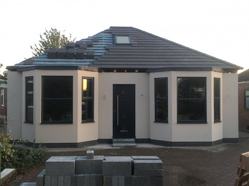

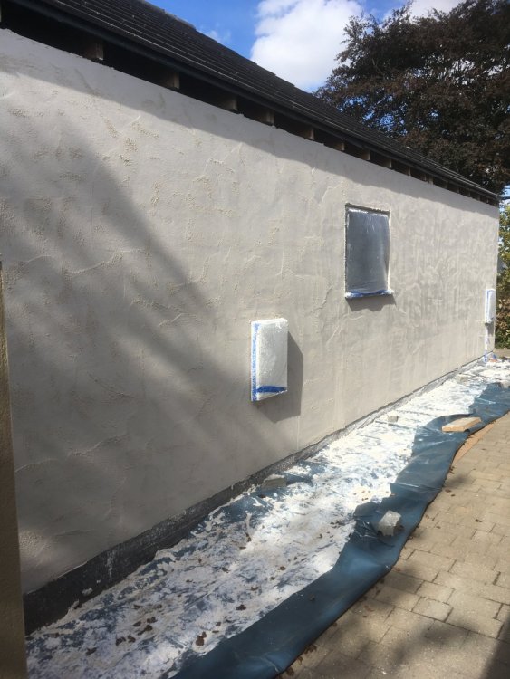

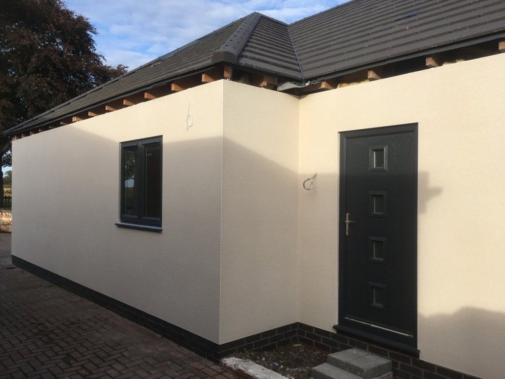

ChrisL 20 Posted February 22, 2020 So with all outer walls done we had it rendered: Share this post Link to post Share on other sites

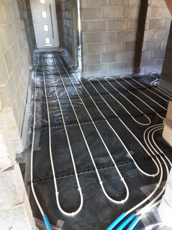

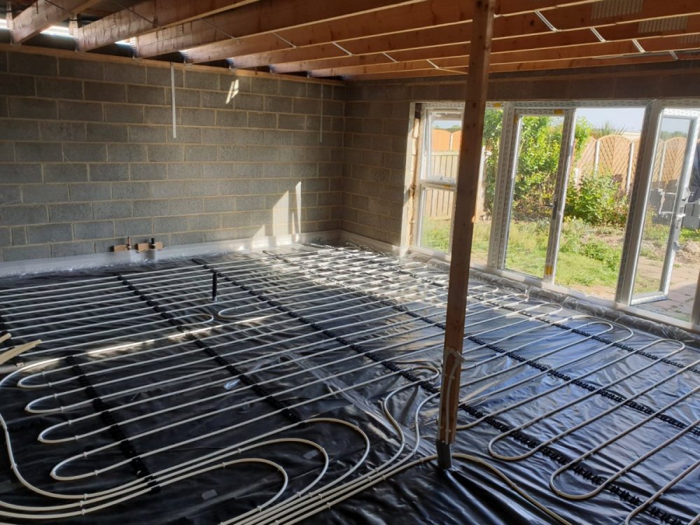

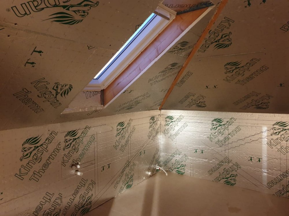

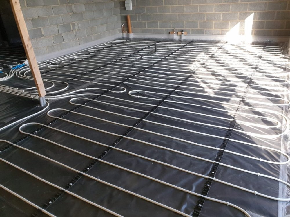

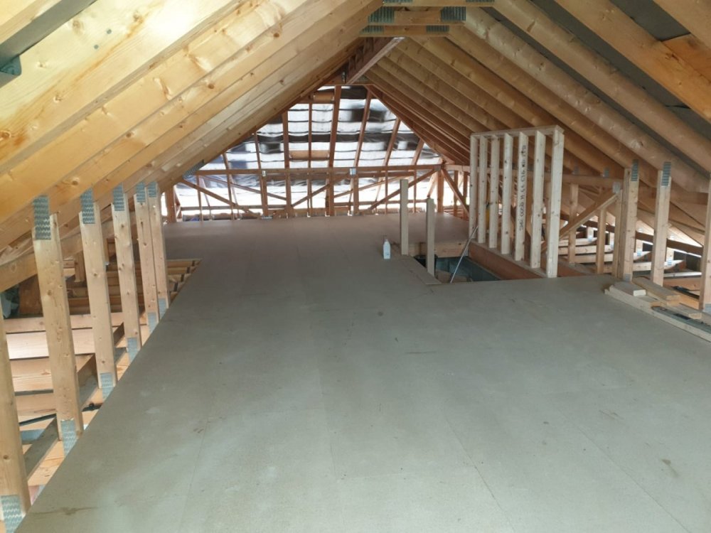

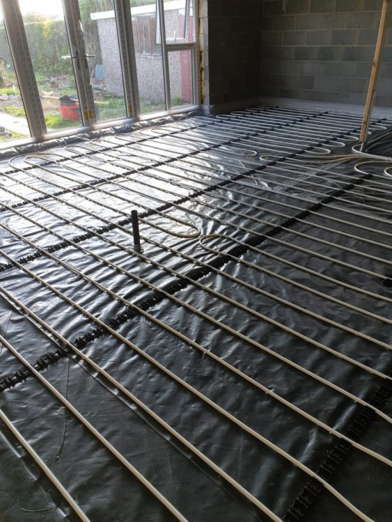

ChrisL 20 Posted February 27, 2020 Then we turned out attention to inside Share this post Link to post Share on other sites
