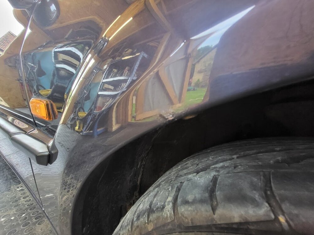

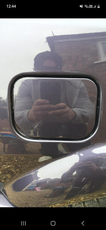

It does have 2 areas of the rust - see pics - little scab on the wing and a scab in side in the fuel door area. I will get these fixed with new metal before they get worse.

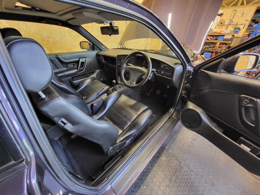

I have a Recaro interior to fit and the oil volt dials to figure out. The MOT man said the rear beam was looking rusty and it's bushes are tired. I have a spare axle to build up off the car so will do that as well this year.

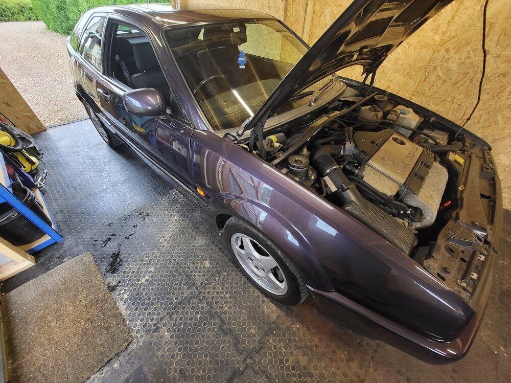

Seeing as people are coming back to view the forum I thought I'd add progress.

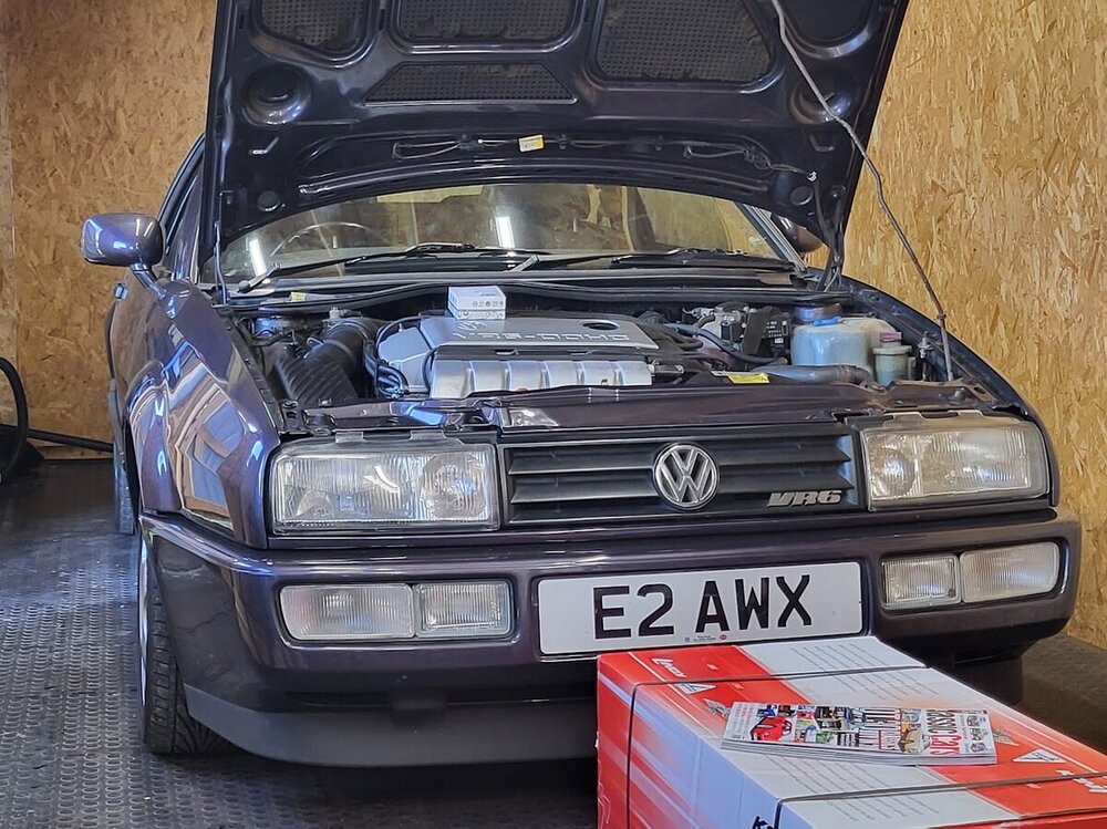

Car has been to stealth for some works - chains, headrefurb, clutch, 263s, some bushes and abs repairs. She made 223hp on the rollers which i was pretty chuffed about
https://www.youtube.com/watch?v=40sexRMjzbo
The koni and H&R suspension turned up last week (waiting since June) so plan to fit over the winter. Couple of pics from today on where I am at and the wheels I plan to put on it.
Prior to taking it to Stealth I installed new discs and pads, bearings, hubs and refurbed the front cast knuckles with new backing plates. I failed to take any photos though.
As well as the Koni fitting over the winter I also hope to take the rear beam off and rebuild it.

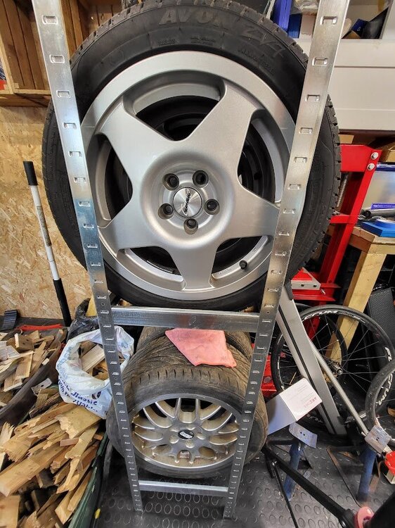

Everyone needs a wheel stand in their garage for all our extra sets 😂😂
Changed the injector seals on the Corrado today. Attempting to solve the too many cranks when it is warm and sat for 5mins.
Didn't solve the issue though of course the injectors may need a service but it was a cheap job to try and see. There was red grease around them so at least I've cleaned that up, I just used a smear of fresh oil on seals to seat them cleanly.
Will try the crank sensor next but out of time for messing around.
Also changed the coil. It starts normally and drives fine just takes longer than you'd expect.

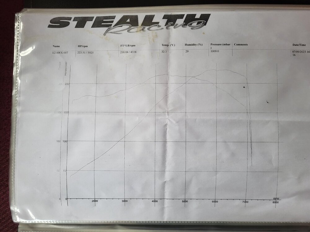

Do you have your power charts you could post?  I have the 263s and a remap as well, so would be interested to see how they compare.
I had the head refurbed as well, and took the time to grind off some of the worst casting flashing in the inlet runners (although I suspect this wasn't worth the effort!)
Let us know if you have any luck with the warm start issue! I had a good chat with Vince @ Stealth and in all his years he's never got to the bottom of it, other than a suspicion it's somehow the ECU.
Power chart - thanks for reminding I had been meaning to post it for a while. Hot day too at 32 degrees..
I really appreciate the torque at lower revs, 200ft pounds by 3500 rpm, if i recall 180ft pounds is the stock peak figure, which with 263s 180ft pounds is being made at around 2400rpm.

Ah thanks, looks nice. Similar curves to mine (as you'd expect), although peaks are a little bit higher. The graph is in my thread if you're interested. Mine was 215 HP and 209 ftlbs peaks - I can't say I am disappointed with the results as like you say it drives so much but I remember hoping it'd hit 220!  Stealth re-bored my block and added new pistons and rings which I thought might provide bit more oomph.
I always wonder what accounts for these little variances - mine was also a hot day, 27C but a bit more humid, so that might make a difference. Just the vagaries of engines I guess!

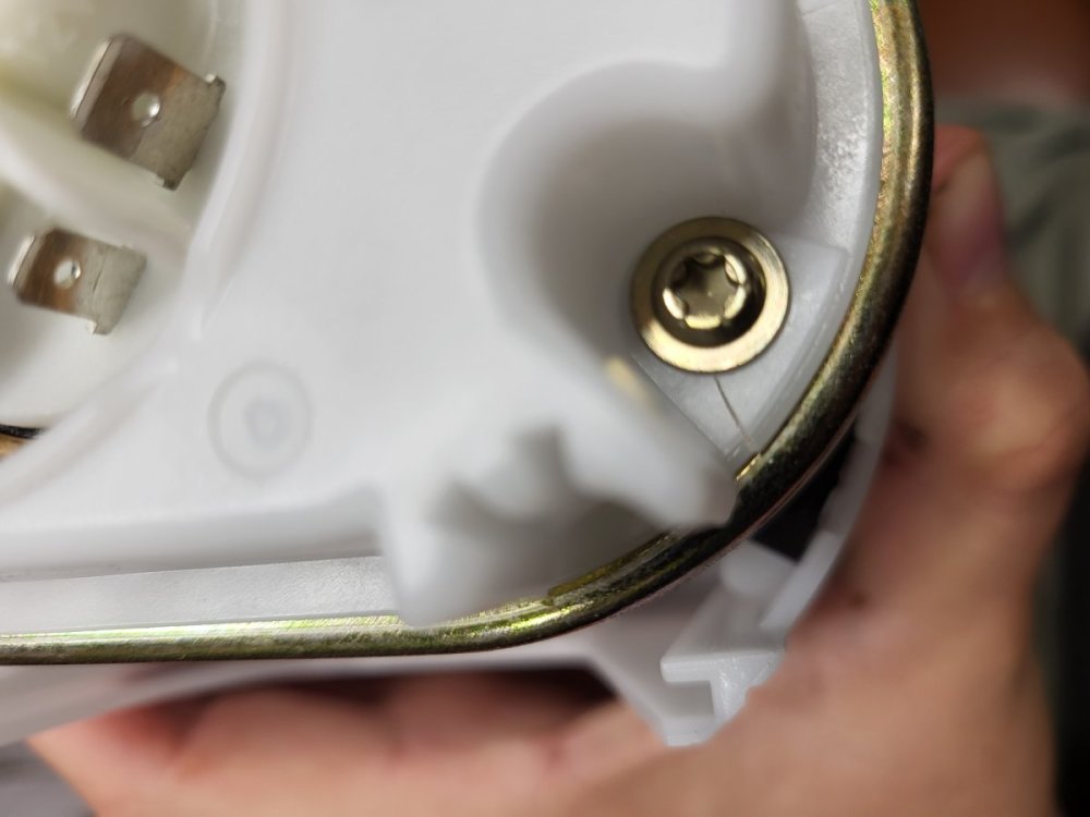

Bought a VDO fuel pump from autodoc but cracked like the others I've seen on this forum around the screws.
They have agreed to a refund but just wondering if it is massive problem? 4bar pumps are hard to find so do I suck it and see.
I wouldn't have thought a crack at the fixing point would effect the actual pump to preform how it should. It is just housing and the pump is sucking from the bottom.
But I also get that something will always be niggling at you for if it is okay. If it came off and blocked the filter.butvit won't.
At the time of the discussion on here last time, VDO was as rare as hens teeth and the price of Gold, about £170.
I opted for a different decent branded pump that was 4 bar ( Lucas i think) and NO issues but readily available.
