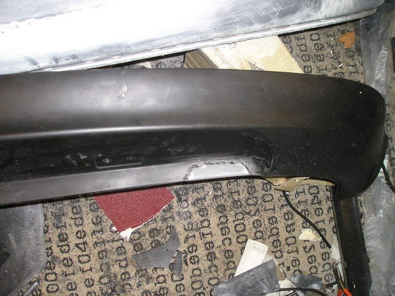

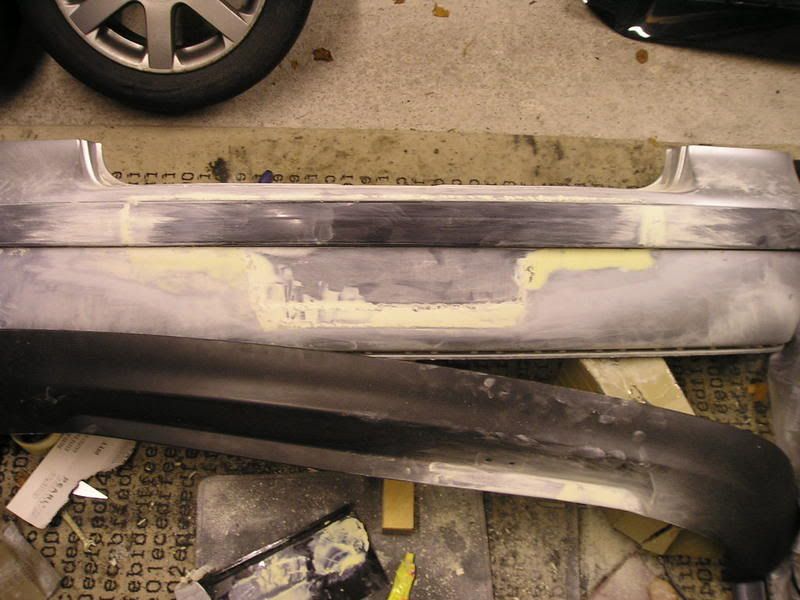

First off I plastic welded the bumper up to lose the numberplate recess...
I also flushed out things like the towing eye recess, just to clean things up a bit.

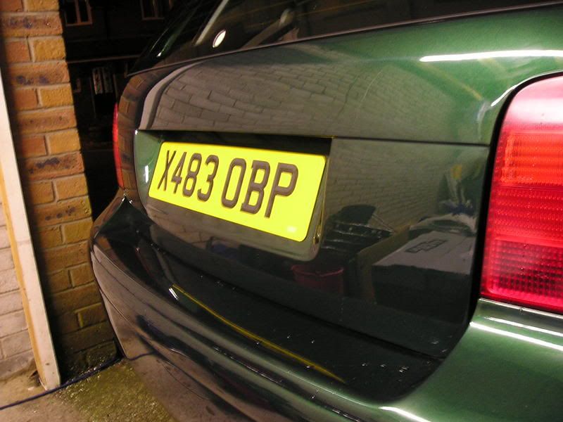

Next came the welding work. We cut out a Bora numberplate recess, being careful not to distort the panel.
This (cutting a very long story short) was welded into the MK4 tailgate, using proper welding principles, joggle tools and careful alignment to basically require almost no filler.
A coat of primer and a bit more rubbing down it was ready for paint, along with the bumper, rubbing strip and rear valance.

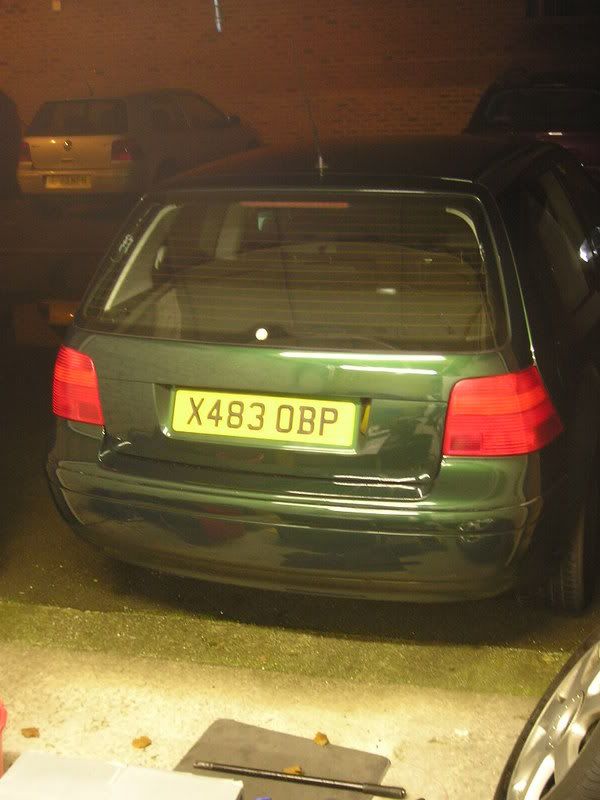

The results are very factory, complete with number plate lights etc..
Will get some daylight pics soon. Also I its not yet lowered and has 16" steels on at the mo :)
