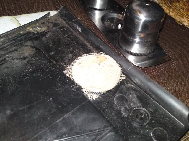

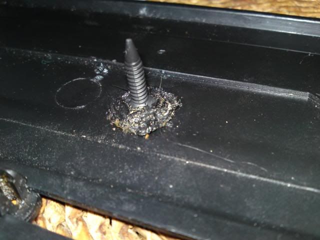

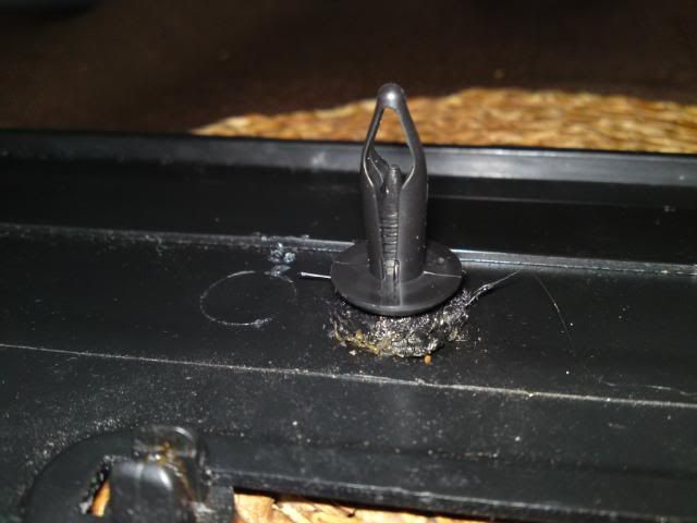

as normal the bits are snapped so I tried a few ideas, the one Im going with is plastic welding these plastic screws I found at halfords

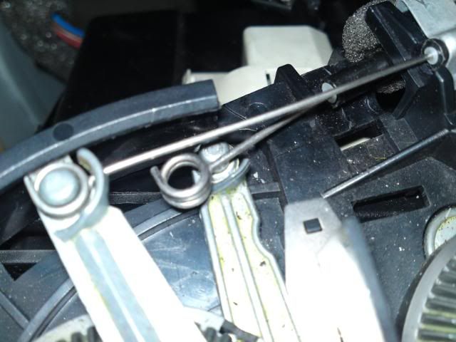

Also I'm investigating my heater controls, still not sure whats going on there, Ive managed to break a bit on them so I have to leave it on the screen position which isnt a bad thing

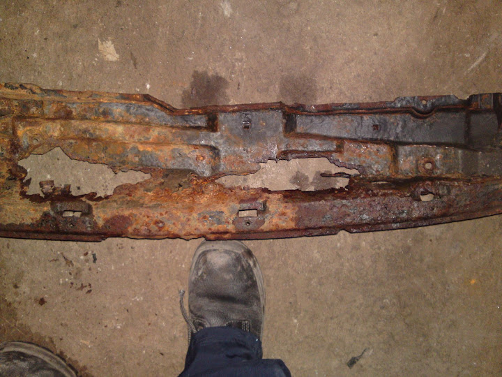

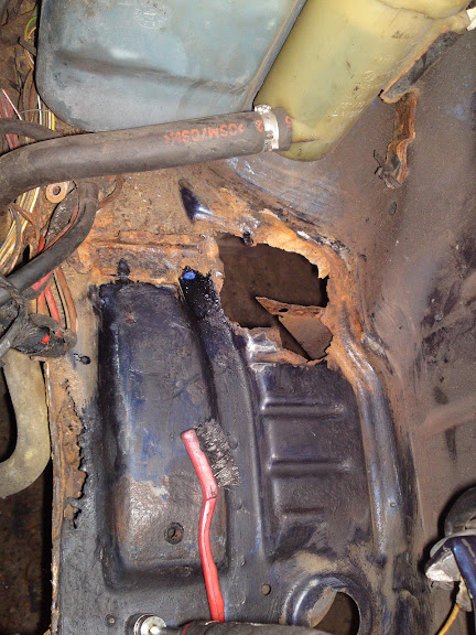

not done much as I wanted on this :( spotted a tone of rust on the crossmember and rad support, they've gone but time ran out last night. I also got a bunch of bad rust under the battery. I was lucky and somebody offered to weld it up for me :D WIth the front end off I'll get the replacement wing on and I'll be happy, In that time I should have all my new wheels polished up.. ftw :lol: And hopefully a fresh MOT
Had the daily off the road this week to sort this :gag: :gag:
This is my ex rad support :shock: :shock: :shock:

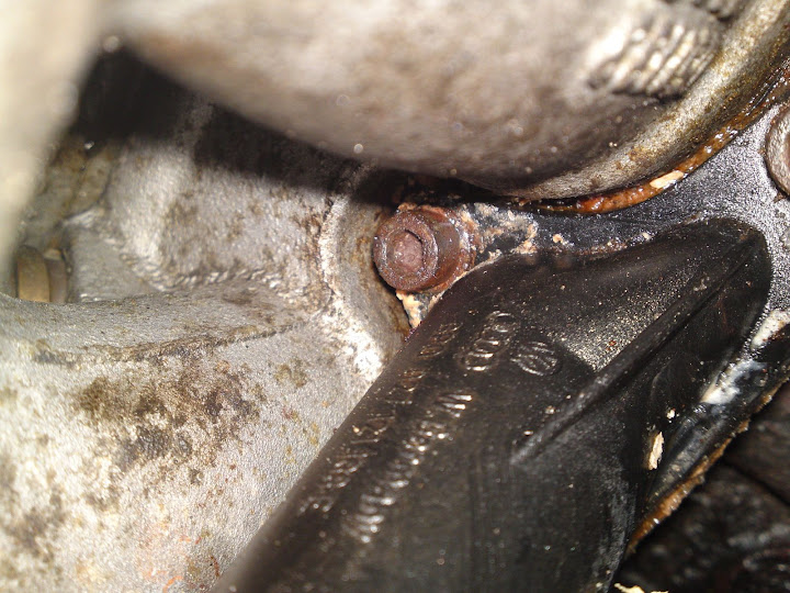

also I noticed a little gunk here, without taking the manifolds off I dont seem to be able to take the top of the 3 allen head bolts.. From looking at the pic below is it something to worry about? Im changing the rad also because I think its leaking
I changed the water flange (black plastic part in your last pic) on my car this week. The top bolt can be accessed by using a ball end allen key without taking the manifold off. I'd change that water flange as it looks worse than mine and it was leaking too - it had an almost invisble crack in it, not surprising since it starts to disintegrate from the inside. I'll get a photo up when I get chance.
My rad support is nearing that :( just havent had the time to sort it yet....or find a suitable replacement part. It is easy to remove....obviously the front end has to come off...
Ive had the front off a few times now its fairly straight forward. I got it down now, gotta make sure you jack the engine up.
I tried to use a ball end on a allen key but Its on very tight and I think it rounded a bit :gag:
I bought a replacement rad support but its off an early car which has no PAS cooling pipe so I will need to modify it a bit
