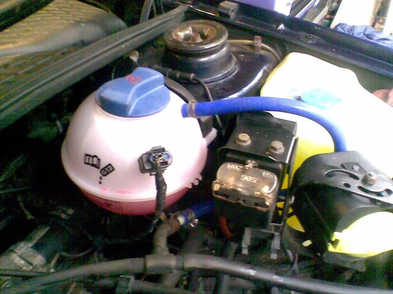

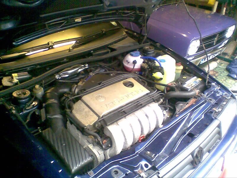

Purple Tom 0 Posted September 20, 2009 Just to add to this, I've had my VR6 on the road for a week now and one of the first thing I did was fit a mk4 tank, along with a general cooling system health check. Its as straightforward as Kev says, and all I used to alter the plumbing was an 8mm I.D inline connector and roughly 14" of 8mm silicone hose, only because I had it lying around after doing the Vauxhall conversion on my Mini. It really brightens up the engine bay and makes it much easier to keep an eye on the coolant level than with the original tank, and fitting the plug is a 5 minute job including removing the pins from the old one... Here's a couple of pictures, the fan control module doesn't get in the way at all: A very very worthwhile modification, and so cheap for a change :lol: Quote Share this post Link to post Share on other sites
