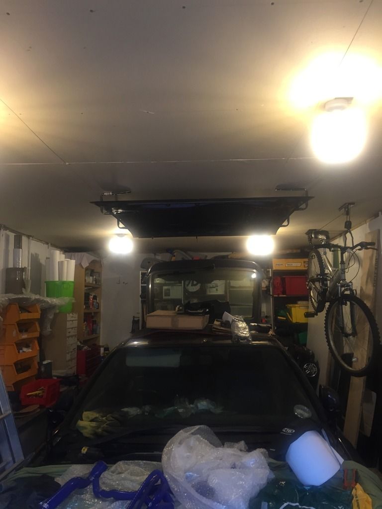

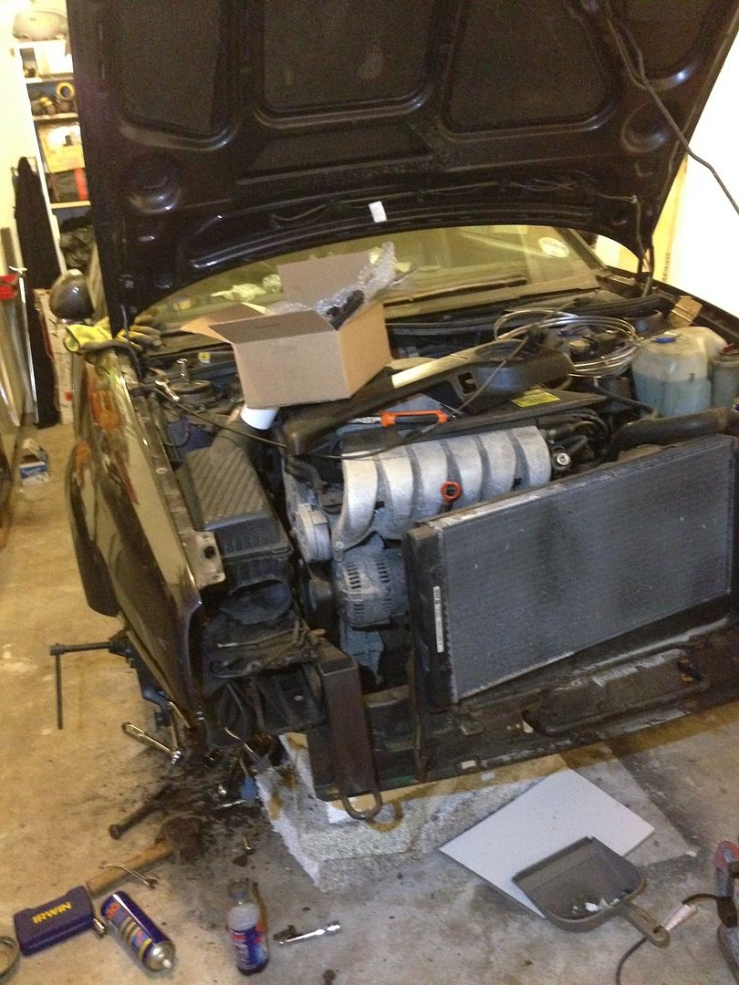

Got a few wee bits done, drained the coolant and power steering fluid, removed radiator, best of all, got the bonnet off and out the way :)
That's a stroke of genius with the bonnet.
Looking forward to this coming together.
Love the bonnet idea ! . That's a mammoth task with all the jobs you have to do . I'm sure you will get there though . Looking forward to the updates . I'm always envious of people with a garage lol .

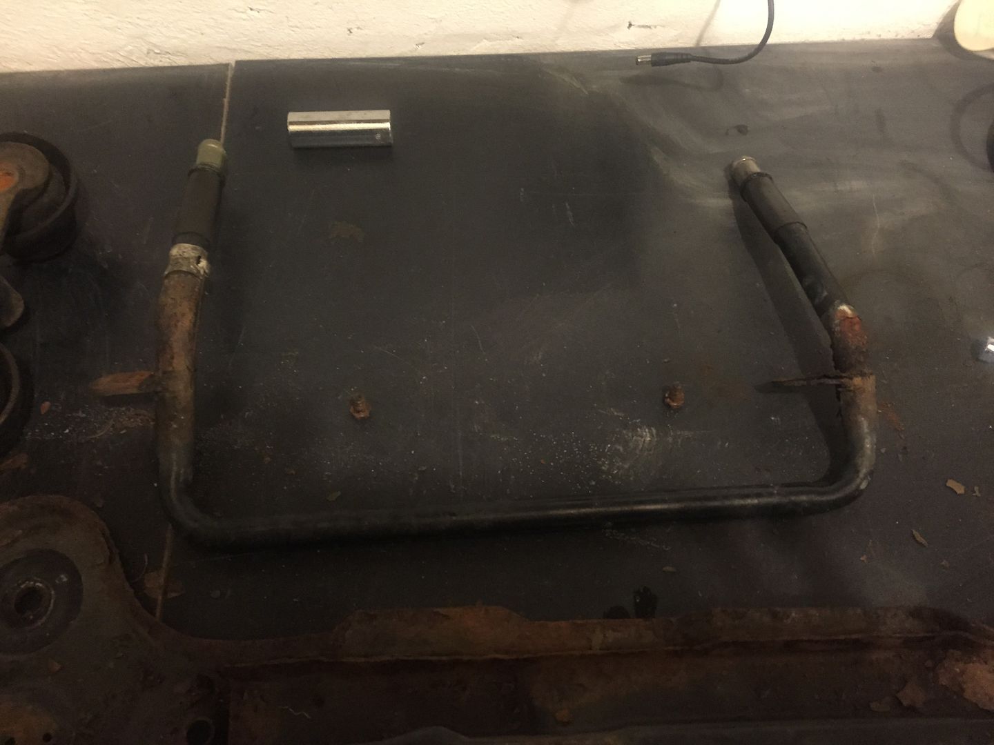

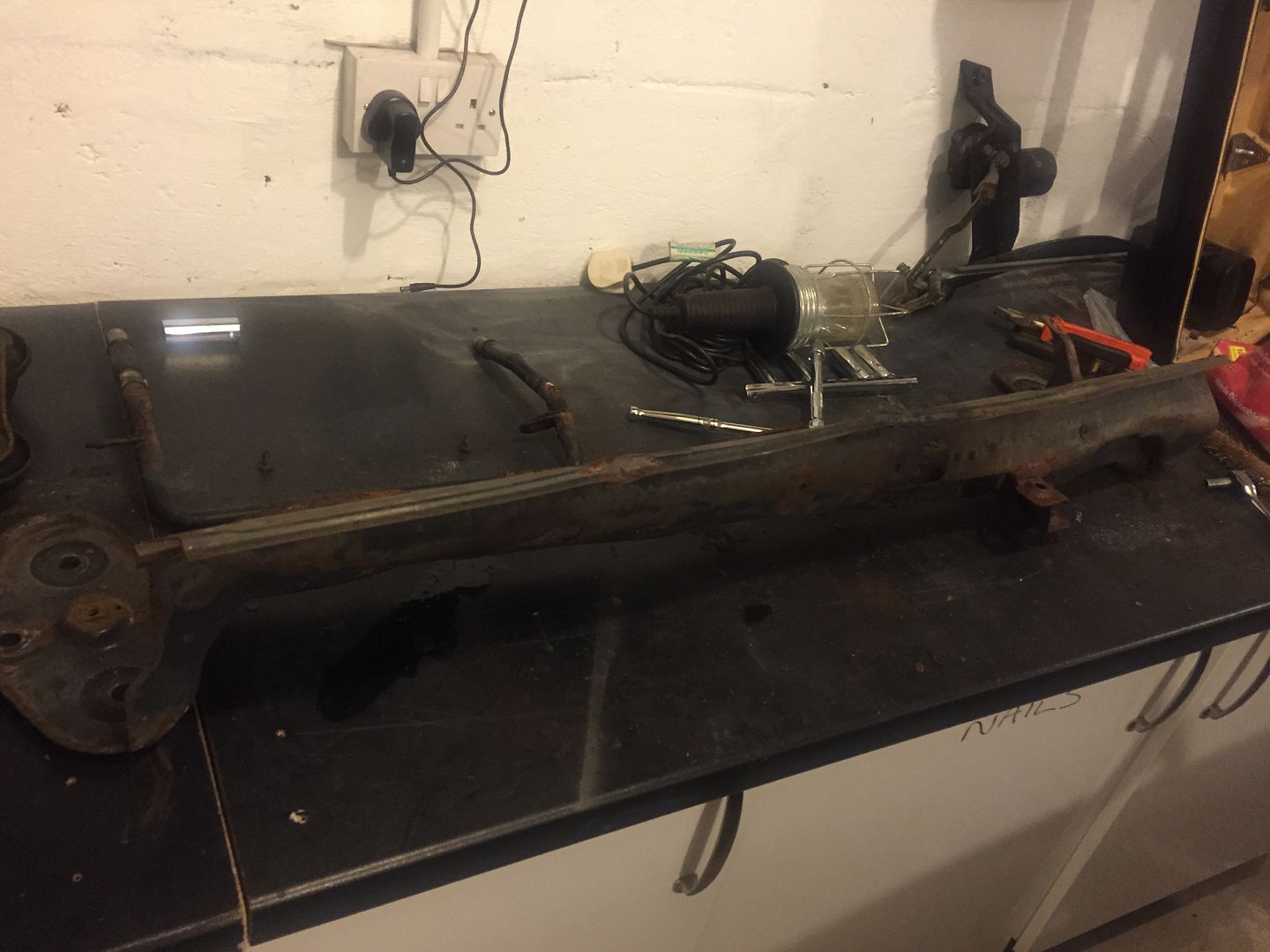

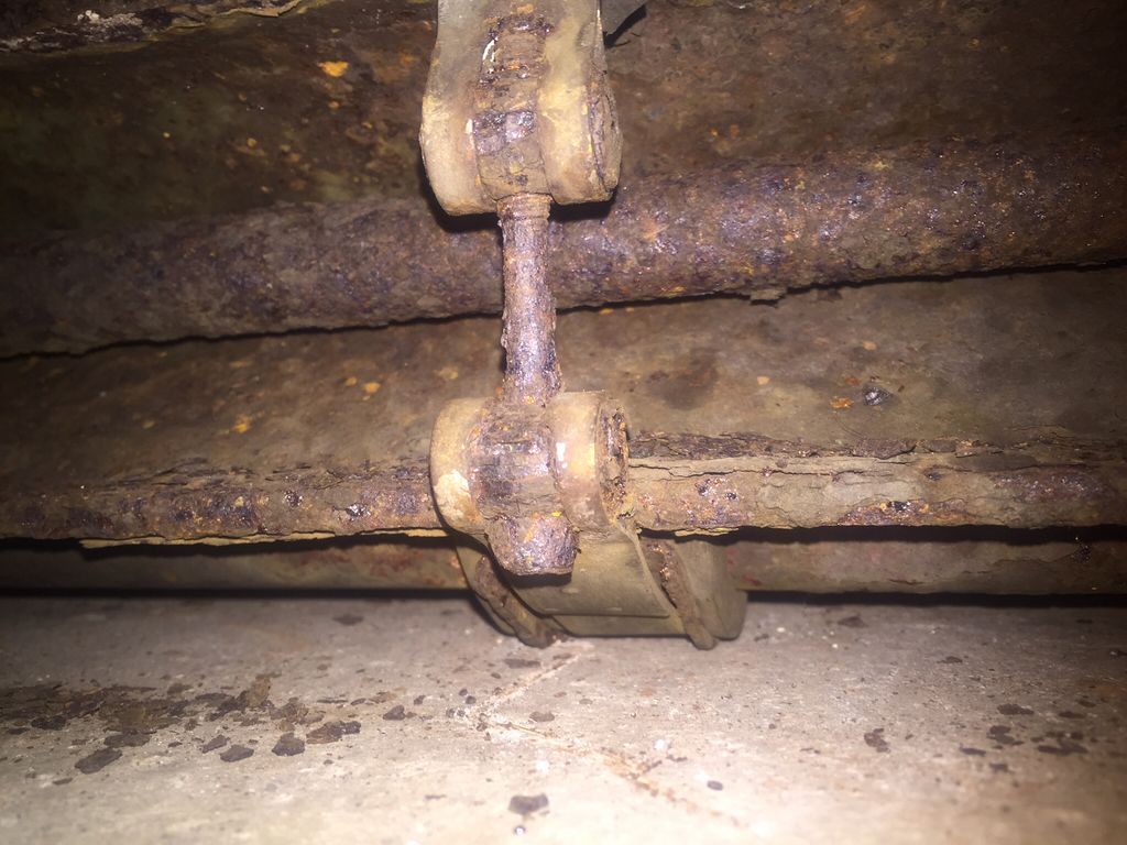

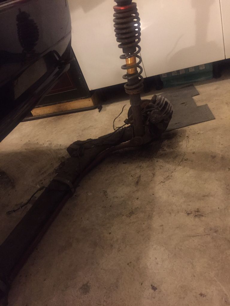

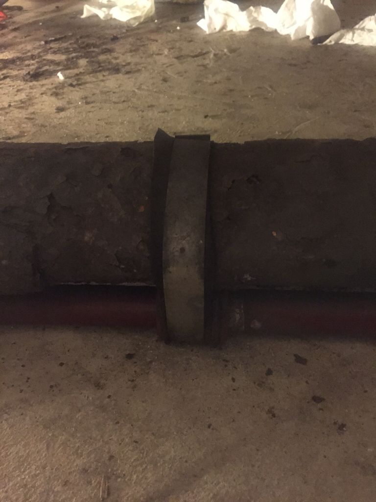

So,I eventually got the rear beam off, had to chop the n/s bolt off in sections as I couldn't get to it correctly. No matter anyway as its all going in the bin. The beam itself is shockingly rusty, which is why I'm getting rid of it. I'm gonna save the eibach ARB , just need to find out where to get the fitting kit from, the pictures will tell you why I need new ones :)
Look forward to cutting the shocker bolt and trying to get the mk4 callipers off....not :lol:
The shocker is going in the bin, just need it off the release the ARB, the bolt is just spinning

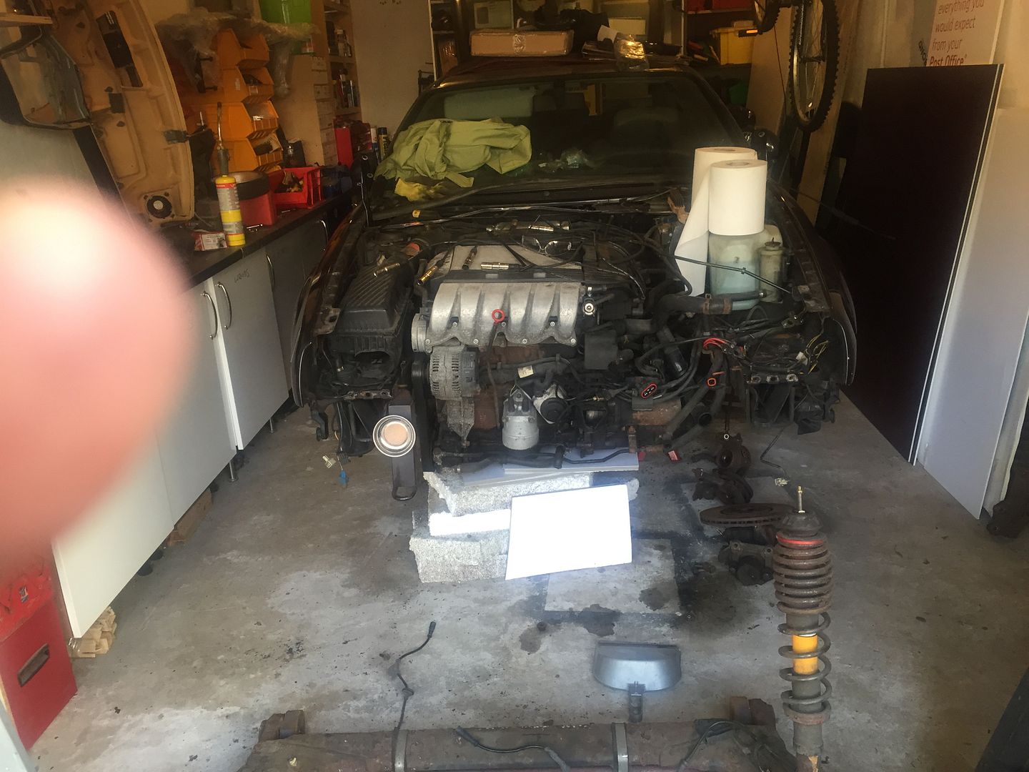

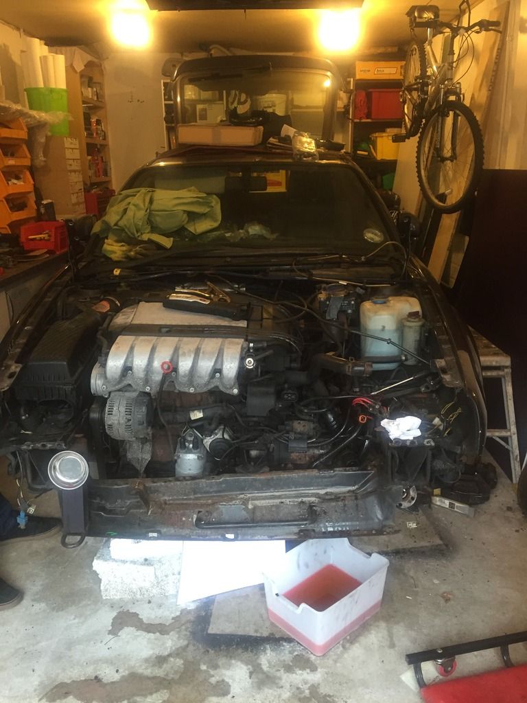

Got a little more done today, removed the front crossmember and radiator support, then managed to get the power steering pipe removed thanks to my new best friend:)

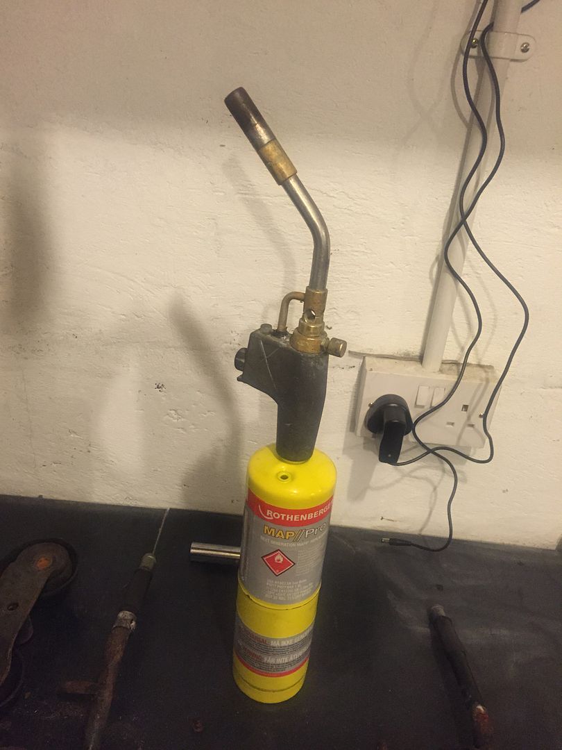

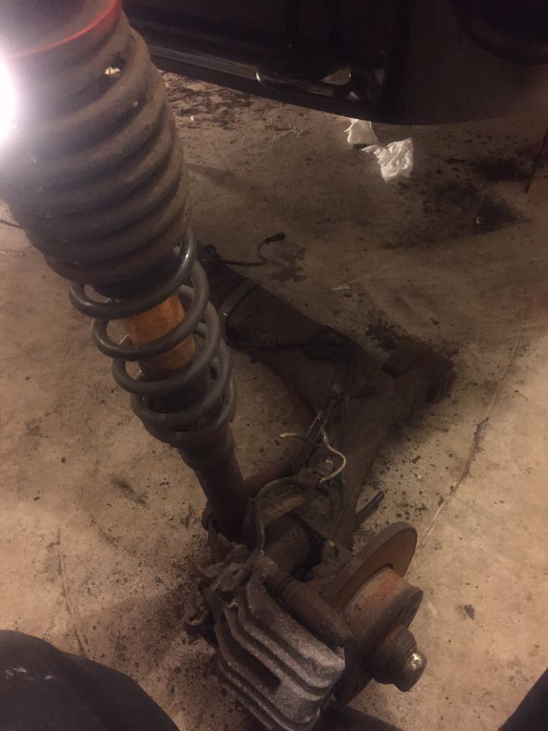

Got another few wee bits done tonight, got the mk4 callipers off the crusty beam, with no little help from the blowtorch and the Irwins.
Also looking to find the name of the clamps used to hold the eibach ARB onto the beam as I can't seem to find them, and I'm sure you'll agree they need replaced :)
