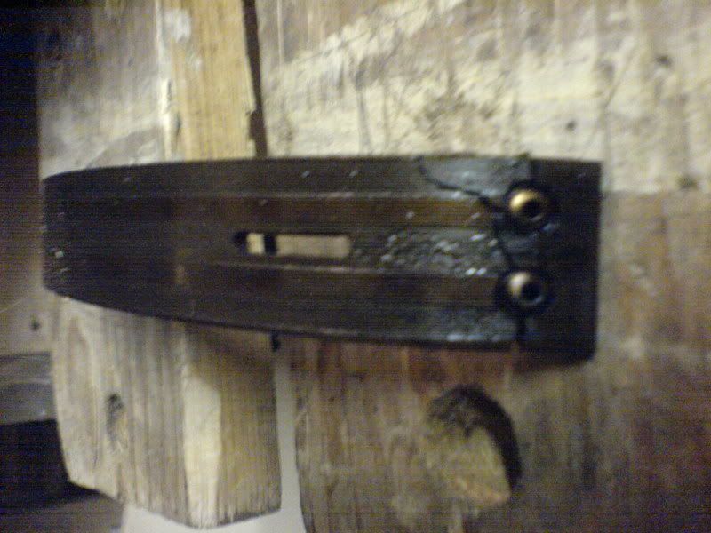

jamminvr6storm 0 Posted November 25, 2010 Crap pic but this was the state of my chain guides after 90k... no ratles... full vw service history at that time so cannot put this down to infrequent oil changes etc Quote Share this post Link to post Share on other sites
