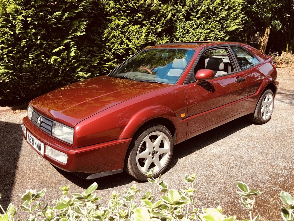

Back over to MAP body shop in Wigan. The lads down there were great. The bonnet had settled on some of the filler spots, and on the rear, so they repainted both panels. Gave it time to go off again, wet sanded and polished the entire car.
I thought it looked good before. Now it looks immense. The amount of positive comments I’ve had from people the last few weeks have been incredible. One guy wouldn’t have it that it had done 182k.

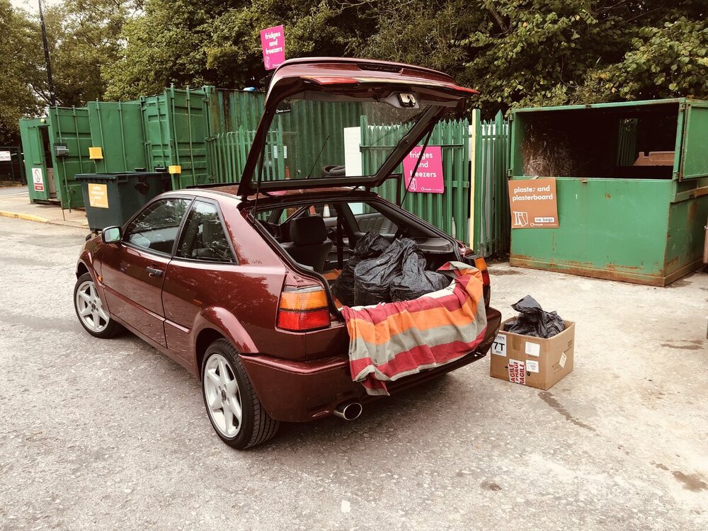

That was about six weeks ago. Since then it’s been solid as a rock. Making many tip runs, building supply collections, work related tasks and back yesterday from a few days in the Lake district, returning MPG in the early 40s and many admiring glances 😎. It’s been a couple of years since I’ve driven it on spirited country roads. But what a difference changing the dizzy (for the right one) has made. It’s truly a different car in every respect now. And I aint complaining !
Spotted in it’s natural environment. The tip!
