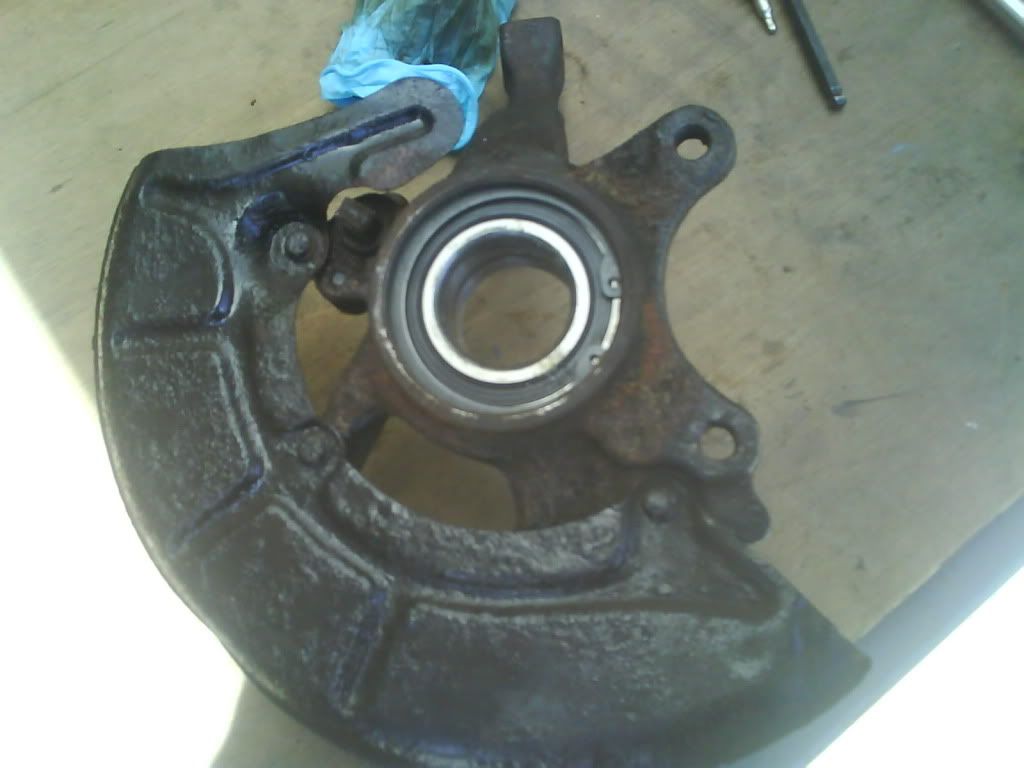

VW_OwneR_85 2 Posted April 27, 2012 damn seems like this is a common problem, my first initial thought was the subframe so i checked those ages ago and there very tight {they didnt budge },so i dont think thats the problem, i replaced both wheel bearings awhile back, as far as i know i did it the correct way, and as i cant get any free play in the wheels thats a good indication, im also prety sure this noise was around before i did the wheel bearings anyway, if it was anything to do with the rack wouldnt you be able to feel it through the steering wheel?, Quote Share this post Link to post Share on other sites

dr_mat 0 Posted April 28, 2012 I had a similar noise years back and we were 50/50 on whether it was the CV or the wheel bearings. Turned out it was the wheel bearings. (This was an old Jetta.) The front wheel bearings have to be a VERY long way gone before you notice any play, they'll click and clunk under tight cornering load for ages before this happens. I also currently have the standard Corrado "heavy clunk" from the front suspension once per journey. It's a different issue I think, but as you've seen above no-one's figured out what.. Quote Share this post Link to post Share on other sites
VW_OwneR_85 2 Posted April 28, 2012 i highly dought its my wheel bearings, i did those less then 800miles ago, and my car rolls smooth as is it should, also the wheel bearings arent under any more pressure on full lock then they are normaly, my bet is cv as thats realy the only think getting put to its limit on full lock, Quote Share this post Link to post Share on other sites
