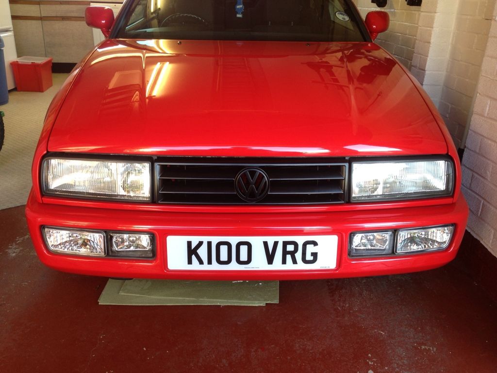

more of the storm red VR6

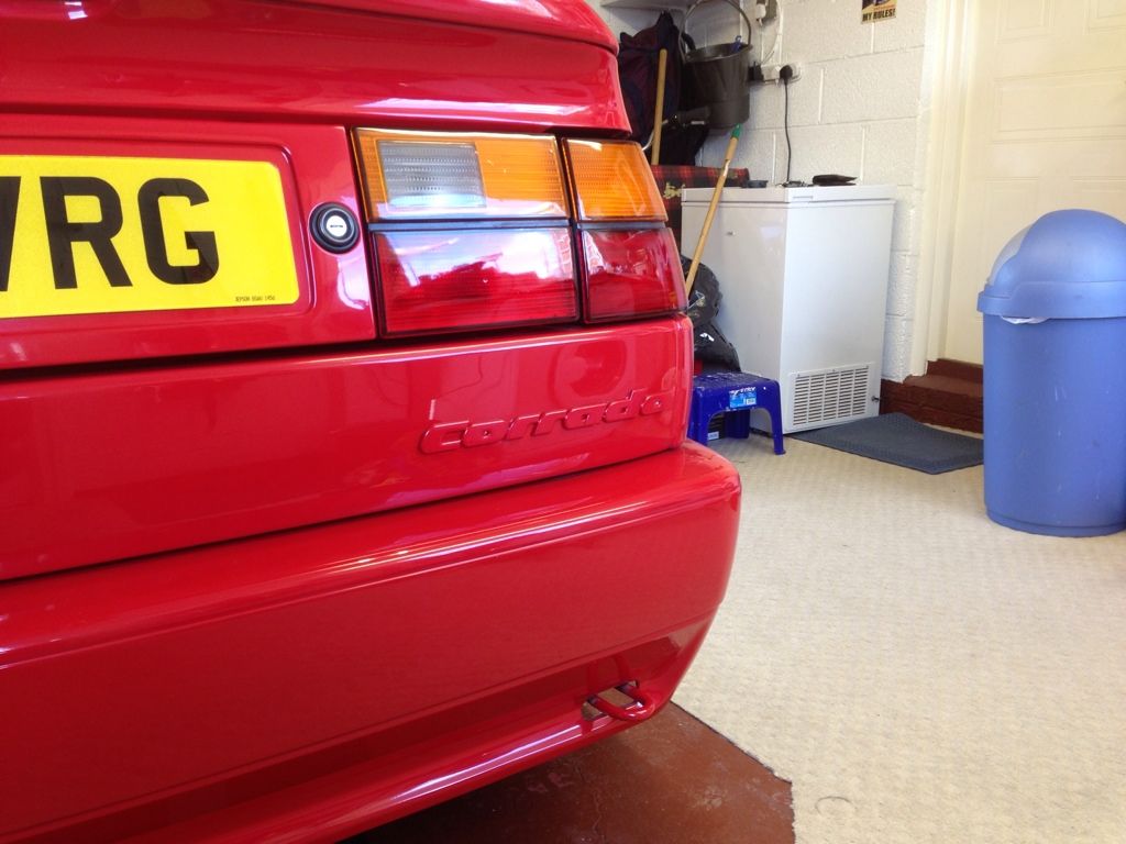

All red rear lights might compliment the painted number plate surround? Good work on the correction, you can't beat that mirror finish

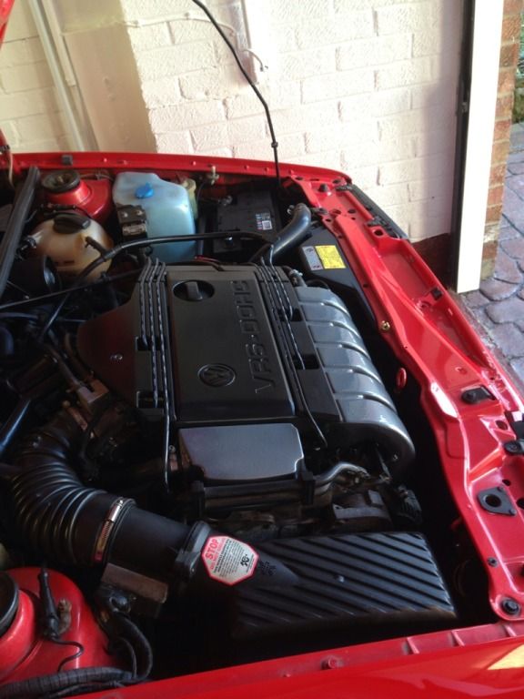

So with that progress in mind I got the engine plastics stuck back on the car so I could close the bonnet and forget about the last few months, I hope you agree the bay is now looking good......

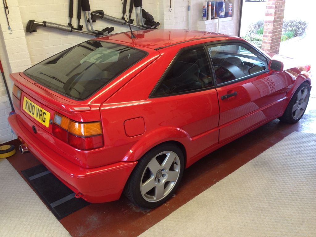

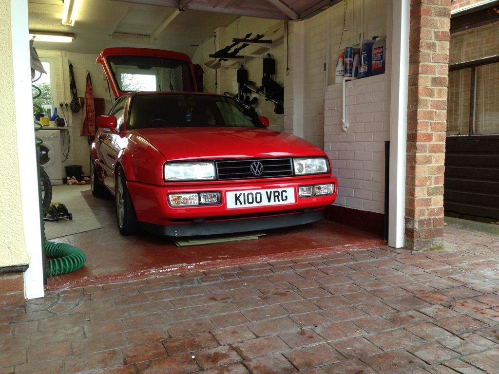

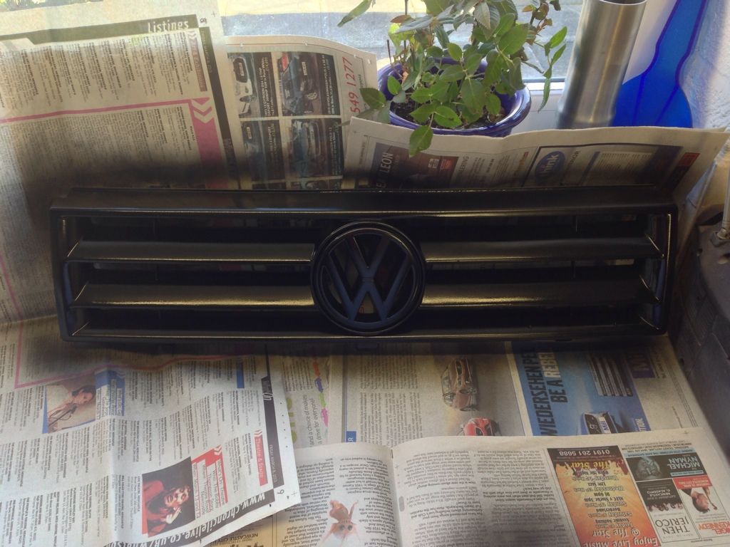

Last of all a couple of current pics of the car, I painted the grill today as I wasn't happy with the finish so it's not back on, the point of these pics though is that the car is pointing the other way (proof I had it out lol)

Finished the grill off and got it fitted, the fit isn't great as I had to repair the clips but it's on and better than nothing.

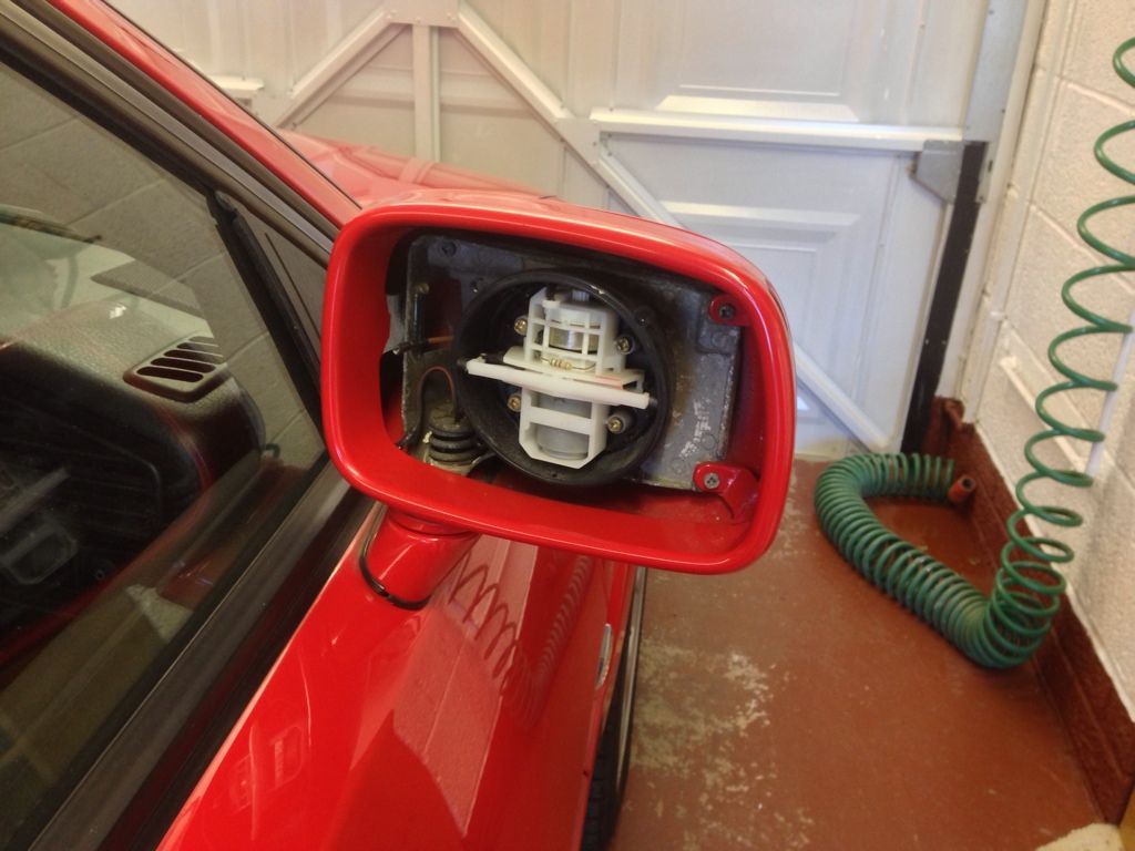

Another little niggle was the cracked mirror glass so that has been removed and separated from the frame ready for a new glass to be ordered and fitted.

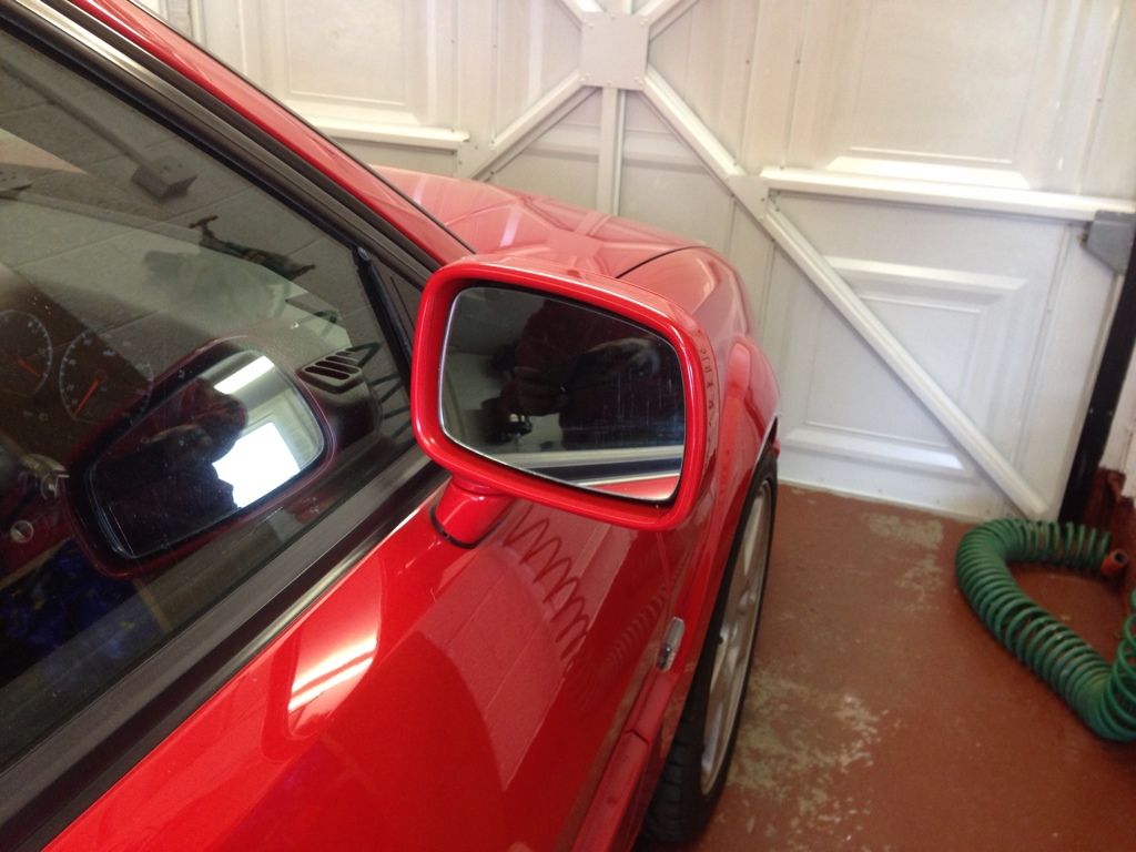

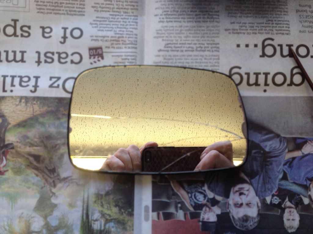

First up was fit the new mirror glass, massive improvement it has to be said.

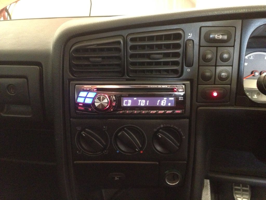

After much battling with the wires I got the head unit fitted (it was never fitted properly in the past) I'm not sure that I like the look of it so it may have to come back out.

eBay bud, perfect fit and it's heated yes, just put corrado mirror glass into an eBay search, there are plenty heated ones on there, you have to cut the backing plate a bit as the terminals are spaced differently but other than that it's a perfect fit.

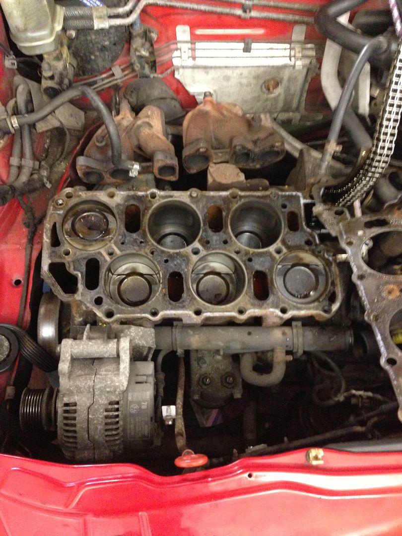

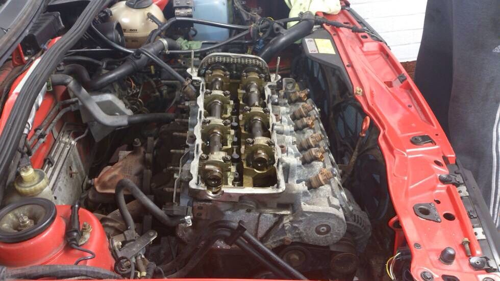

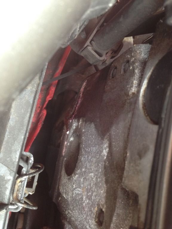

Today wielded very bad news, I started the car up and ran it to temp and I could hear a hissing noise, I had a look under the bonnet and found this......
I'm sure you will agree my head gasket has given up on life.....I have to admit I was a bit annoyed about this at first but then decided it was a nice way to learn a bit more about the engine so I decided to strip the thing and change it, I made a start today and I have got as far as removing everything but the timing chain ready to lift the head off and I have the engine set to TDC, I'm now waiting for the cam locking tool to arrive before I can go any further however I have a baby due on Friday so progress is going to slow down big style!!
pic of how far I got today.

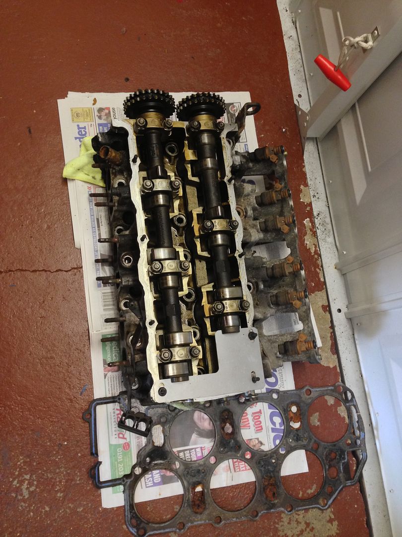

Ok so work froze for a bit on the VR as I now have a little baby boy to look after so I have been stealing the odd hour when I can to get this car sorted......

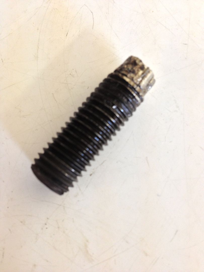

Anyway here is how I now stand. Managed to get all of the head bolts out of the head bar one that decided to shear so that filled me with a world of joy! No problem I thought, just life the head straight up and it will slide right off there.....how wrong I was, after two hours of graft it wasn't budging, I used tones of WD40 and still got nowhere as the bolt had sheared right at the head, eventually after loosing my rag I juts pulled on the inlet until the lower part of the bolt snapped off....I still have the bolt stick in the head but I will press that out no problem so this is what I was left with.
The stud as I'm sure you can tell from what little was left of it proved to be a nightmare, nothing could shift it, I left it soaking in plus gas over night and went back with mole grips etc and still nothing.....eventually I gave up and called my mate to bring a welder down so I could weld a nut to it and get it out that way....whilst waiting I filed some flats onto the stud and got a big set of stilsons on there and eventually it craved and came off just as my mate arrived with the welder!! Here is the offending item.
Head all removed and on the floor ready to go back on.....don't worry it's not resting on the valves i have it supported :-)
Now all that's left is to get hold of new gaskets etc and bolt her all back together again......of course it would be rude not to have the aux belt tensioner and alternator powder coated whilst they are off/easy to get at ;-)
