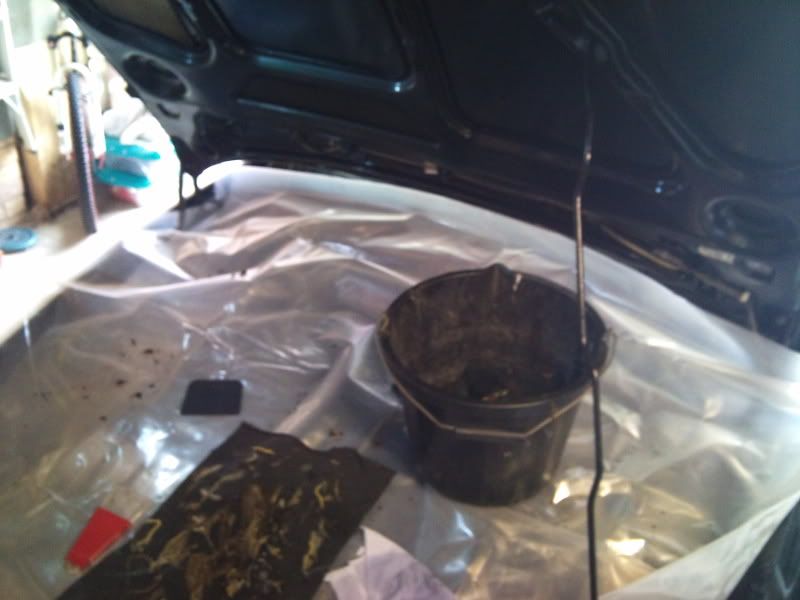

pbradley98 0 Posted March 30, 2019 (edited) Finally got round to doing this, having bought a set of Sprinter's reproduced foam liners several years ago but never getting round to fitting it! Not too bad all in all, took about an hour to quickly scrape of the foam, then used a cloth to rub white spirit into the residual glue / foam residue layer and scrape off with a credit card to get back to pretty much pristine paintwork underneath (if only the same was true of the topside of the bonnet, which is definitely due a respray!). Then it was just 5 mins to actually fit the replacement foams - what a difference not to have crumbling, patchy foam! Edited March 30, 2019 by pbradley98 Adding pics Quote Share this post Link to post Share on other sites
