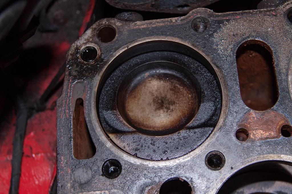

petemcr 10 Posted November 8, 2013 I've just been looking through some pictures I've taken of my bottom end and I just noticed something on piston #1 which I want to ask about, see if anyone has any opinions on this Now, I've not really touched the car in a while, nor put too much money in to it so I'm not exactly deep in to it, but I've just noticed what looks like a chip missing out of the crown of the piston and looking at the carbon on top of it, it looks like something has been rattling around in the cylinder, I'm going to crank the engine and check for bore ware but what I want to know is should I call it quits on the bottom end and try and source a new one Opinions? Quote Share this post Link to post Share on other sites
Dox 23 Posted November 8, 2013 Looks fine to me Result of a blown turbo, head heavily skimmed and piston tidied up and running again Quote Share this post Link to post Share on other sites
petemcr 10 Posted November 8, 2013 Well it's just the chips in the piston crown that I was a little worried about and looks like something has been hitting the top Quote Share this post Link to post Share on other sites
davidwort 0 Posted November 8, 2013 pinking? could that have been caused by pre-detonation? Quote Share this post Link to post Share on other sites
Dox 23 Posted November 8, 2013 pinking? could that have been caused by pre-detonation? Looks like some debris has fallen inside that cylinder on a plug change maybe, if the bore's not scored and if it was mine I'd not worry about it. It looks like its old damage to me Quote Share this post Link to post Share on other sites
petemcr 10 Posted November 8, 2013 Looks like some debris has fallen inside that cylinder on a plug change maybe, if the bore's not scored and if it was mine I'd not worry about it. It looks like its old damage to me That's what I was wondering, it has probably been like this for a while hasn't it, I was just thinking should I just replace the bottom end before I start to put it back together or should it be fine. I may just assemble it and see how it runs when it's back together. Quote Share this post Link to post Share on other sites
petemcr 10 Posted November 9, 2013 Not looking too good, all the other bores are perfect Quote Share this post Link to post Share on other sites
Kevin Bacon 5 Posted November 11, 2013 If you can't catch a finger nail in those scores, I wouldn't worry about it. Quote Share this post Link to post Share on other sites
petemcr 10 Posted November 15, 2013 If you can't catch a finger nail in those scores, I wouldn't worry about it. The side ones aren't too bad, barely catch a nail at all, however the one on the very left is fairly deep and I'd say you'd catch a nail in it. It did burn a little oil when you gave it the beans but it wasn't too bad, I presume if I put it back together I'll just be back to burning off oil again? I've found someone who's selling a 2.8 VR fairly cheap, I'm wondering if it would be possible to get the 2.8 and have it bored out to 2.9 and use my pistons, provided they're not damaged on the side of the piston, just as an option Quote Share this post Link to post Share on other sites
Kevin Bacon 5 Posted November 15, 2013 Yep, it would I'm afraid. Yeah reboring a 2.8 is an option. The pistons will come up like new if left in an automotive acid bath for a day. Try and find machine shop that does the factory correct honing though, or it could end up still being an oil burner! In other words, I wouldn't use a flex-hone or anything like that. Probably a good idea to use new piston rings and replace all the bearings and seals whilst you're there. Quote Share this post Link to post Share on other sites

petemcr 10 Posted November 17, 2013 I need to decide what I'm going to do now, do I just get the head back on and get it running for now till I decide, I didn't really want to have to remove the bottom end but if it's going to start going in to getting it out and having it machined etc.. Do I just bite the bullet and go for the 2.8 24v conversion and loose that lovely vr6 sound. It has never felt down on power while I've had it, so if I put it back together now to use over summer would it really cause that much damage? Quote Share this post Link to post Share on other sites
Jon_vr6 1 Posted November 17, 2013 Is it your daily? If not id put it all back together and worry about it when it goes pop Quote Share this post Link to post Share on other sites
petemcr 10 Posted November 17, 2013 It's not my daily, it was until the head gasket went, I'm assuming with the bore marks then that it will go pop? Quote Share this post Link to post Share on other sites
Byrd 10 Posted November 18, 2013 One of my pistons had the same chips out the top of it and- maybe about 50% worse than that, and I was advised that it was from Pinking/ pre-ignition. Shouldnt cause any problems if you were to re-use those pistons with new rings..............I went ahead and ordered new pistons from MAhle and rebored the cylinders. Not a trace of oil burning now, but had to remove the head after rebuild to replace valves due to worn valve stems. Good Luck! Quote Share this post Link to post Share on other sites
