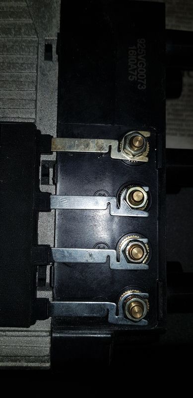

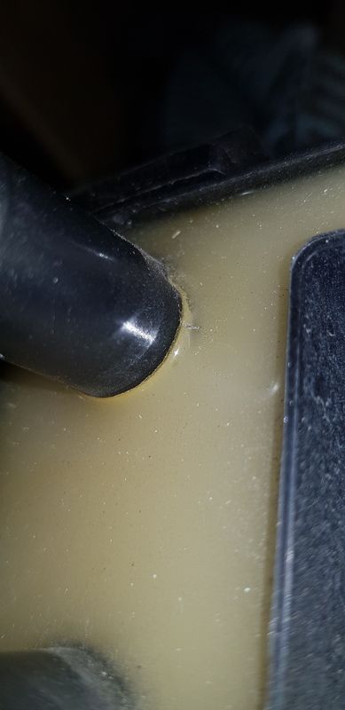

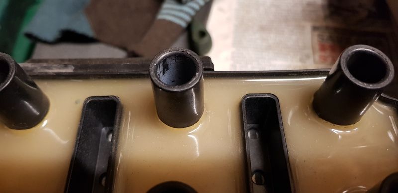

Jim Bowen 1 Posted September 10, 2018 Just been out again and was fine for about 10mins and then started the misfiring and popping. Think i can see some damage on the coilpack, was too hot to pull the lead off so will check that tomorrow. Looks as if one of the lead connections that come off it has melted around the base. Definitely looks different to the other 5. Quote Share this post Link to post Share on other sites
easypops 8 Posted September 10, 2018 I had 2 misfires I can remember. First was when I went through a big puddle, the coil pack was sparking like a firework, no drama up to that point but as soon as it got wet it was comedy. 2nd one was intermittent, turned out the rear centre lead wasn’t seated correctly on the plug Quote Share this post Link to post Share on other sites
Jim Bowen 1 Posted September 10, 2018 Not sure if this is sign of something wrong, one is different color slightly The connector directly below it has a grey white residue in it Seems very slightly deformed where is meets the body of coilpack. Slightly dipped I wonder if its shorting out between those two points Quote Share this post Link to post Share on other sites

easypops 8 Posted September 10, 2018 I’d put it back together, fire it up and give it a light water misting, in the dark you’ll soon see if it’s shorting, probably will hear it as well Quote Share this post Link to post Share on other sites
Jim Bowen 1 Posted October 3, 2018 Tried the water misting and couldn't see any sparks. Have had that in the past and couldn't see it this time. Just changed the spark plugs and the coilpack and it's still doing it. Going to eat dinner and give it a scan with vagcom. Pulled the maf wire out while engine was running and hardly noticed any change in the revs etc. Is that a sign of something Quote Share this post Link to post Share on other sites

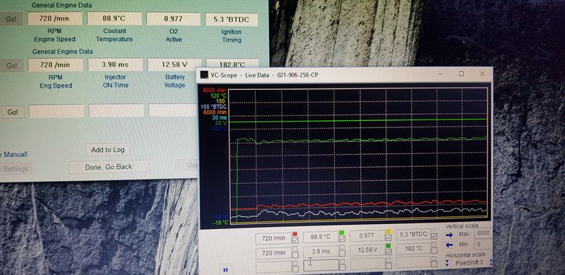

Jim Bowen 1 Posted October 4, 2018 I fitted a new cam pickup wheel, which aren't that easy to find these days. Am hoping the fogs are an unrelated thing, will check the wiring inside the fog lights, i suspect its shorted out and blown a fuse. Got this from vagcom lastnight Where is says battery voltage at 12.58v, should that be higher with engine runing? or does that reading not account for the alternator charging it? Quote Share this post Link to post Share on other sites
vw rule 19 Posted October 4, 2018 I think your battery voltage should show as 14v to 14.2v max on scanner with engine running, unless on VAGCOM it just shows battery voltage at diagnostic plug. Jim double check your charging rate out of alternator with a multimeter, just to be sure. Si Quote Share this post Link to post Share on other sites
vw rule 19 Posted October 4, 2018 Jim I've just connected up my scanner which is (AUTEL MAXIDIAG) to my VW Polo and in live data that shows 14.2v to 14.3v with engine running. On your VAGCOM it should show the same as above in live data, unless like I say it only shows battery voltage at diagnostic plug ? Si Quote Share this post Link to post Share on other sites
Jim Bowen 1 Posted October 4, 2018 Ordered a new battery now, the one i have is around 5yrs old and did sit about for 2yrs while i did work on the car, (i did charge it every few months) I measured the voltage at battery not too long ago and i get Engine running with fans on = 12.85v and slowly falls, without the fans on i got 13.75v. Starting to think its alternator, which is a shame as thats not too old and cost me about £300 (might take it off and take that to the place i bought it from, hoping they can rebuild it) Do you think this could be causing the misfiring etc Quote Share this post Link to post Share on other sites
vw rule 19 Posted October 4, 2018 Jim your alternator you can get overhauled for roughly £60 but depends where you take it to of cause. Regarding your battery if it's low on charge or loosing charge, that can cause some of the electrics to do crazy things including some of the engine sensors to not send correct signals to ECU, or sometimes the diagnostic scanner may not read the ECU correctly due to erratic voltage so to speak. Jim I'd get the alternator / battery sorted first, then do another scan when you've got correct voltage. Si Quote Share this post Link to post Share on other sites
