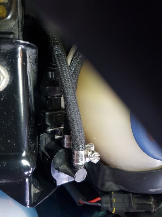

Cressa 46 Posted January 3, 2021 On 1/3/2021 at 12:17 PM, Keyo said: Its a mini ecu that reads the revs off the main ecu - when it detects 4000 revs it triggers a signal to a vacuum bottle that is part of the Schrick kit- the bottle then releases vacuum pressure to a solenoid on top of the schrick which is attached to a flap in the schrick (solenoid has a rod attached to the flap which lifts it to move) which when moves changes the size of the inlet runners therefore achieving best torque throughout the range - you can set the mini ecu to also trigger the flap at any revs but 4000 revs is the recommended setting. That is my understanding of it anyway. Nearly..... at 4k rpm the signal is sent from the ecu to the rpm switch box/ Schrick controller, then to the solenoid valve ( black skinny thing with 2 wires and 2 pipes at). This solenoid is what moves from Normally closed to Open at your setting, normally 4k. This unit allows the vacuum through to the vacuum operated actuator which is on the manifold and connected via a rod. This in turn then opens the flap . The bottle reservoir to me is a piece of magic but has no electrical connections, just vacuum lines in and out. Connects from the vac take off point to the reservoir, to the solenoid valve then to the actuator..... Clear as mud, unless you just fitted it yesterday 😎 and boy have I spent hours researching and thinking of this. Now I feel that I could fit 10 a day after stressing over doing this 🤣🤣 Quote Share this post Link to post Share on other sites
Cressa 46 Posted January 3, 2021 Rubbish picture of the solenoid valve! Quote Share this post Link to post Share on other sites

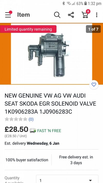

Keyo 49 Posted January 3, 2021 (edited) On 1/3/2021 at 1:02 PM, Cressa said: Rubbish picture of the solenoid valve! I wonder if you can buy this little black solenoid still ? Do you have a part number will be vag or ford i guess. Edited January 3, 2021 by Keyo Quote Share this post Link to post Share on other sites
Cressa 46 Posted January 3, 2021 On 1/3/2021 at 1:27 PM, Keyo said: I wonder if you can buy this little black solenoid still ? Do you have a part number will be vag or ford i guess. They are around and Vag, used on lots and lots of cars. Essentially it is an electrical switch controlling the vacuum from passing through https://www.ebay.co.uk/itm/201826625041 Slightly different but does the job. And would only need the electrical plug changing Quote Share this post Link to post Share on other sites
Cressa 46 Posted January 3, 2021 On 1/3/2021 at 1:13 PM, 1xshaunx1 said: You can borrow my bonnet if you want Cressa, it’s just leaned up in the garage doing nothing at the mo, I have a new one on the car. My car used to have a schrick at some point and has a cut in the bonnet frame structure. I will definitely take you up on that offer, thanks 👍just need to think about what tool to use to cut it with !! Quote Share this post Link to post Share on other sites
Keyo 49 Posted January 3, 2021 On 1/3/2021 at 1:35 PM, Cressa said: They are around and Vag, used on lots and lots of cars. Essentially it is an electrical switch controlling the vacuum from passing through https://www.ebay.co.uk/itm/201826625041 Slightly different but does the job. And would only need the electrical plug changing Nice one. Quote Share this post Link to post Share on other sites

Keyo 49 Posted January 3, 2021 On 1/3/2021 at 2:05 PM, 1xshaunx1 said: So you are sending that a signal to operate at 4K revs via your Jegs to open the flap to get more torque On 1/3/2021 at 1:35 PM, Cressa said: They are around and Vag, used on lots and lots of cars. Essentially it is an electrical switch controlling the vacuum from passing through https://www.ebay.co.uk/itm/201826625041 Slightly different but does the job. And would only need the electrical plug changing Cress does that one work on my one has part number 191806283A (golf 191) Quote Share this post Link to post Share on other sites
