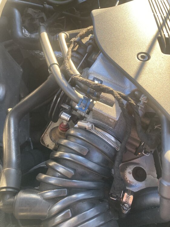

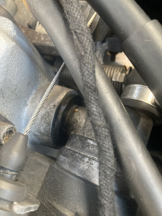

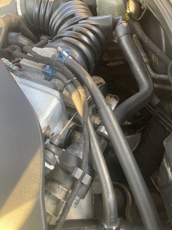

Keyo 47 Posted April 12, 2022 (edited) An essential spare for sure. One good thing about a VSR is you dont need the isv damper which is also a very hard obsolete part to now obtain- whilst on the theme throttle body dash pot is also very hard to source, so all these parts one should keep for spares if a long term owner. Edited April 12, 2022 by Keyo Quote Share this post Link to post Share on other sites

fendervg 32 Posted April 15, 2022 VSR doesn’t need an ISV as they are rarely standing still long enough to idle! In fairness I don’t really know - maybe if you use the motorised OBD2 throttle body from the Golf? Although the VSR was originally designed for OBD1 engines. Quote Share this post Link to post Share on other sites
Keyo 47 Posted April 15, 2022 (edited) It’s an isv dampener They don’t use guys the black box that are known to Grenade . The isv plugs straight into I grommet into the manifold The grommet can be found on a mk3 abf . Edited April 15, 2022 by Keyo Quote Share this post Link to post Share on other sites

ABV-VR6 12 Posted April 16, 2022 Nice pics Keyo as well, good to see close up pictures of how it's rigged up. Still dreaming of owning one, one day... Quote Share this post Link to post Share on other sites

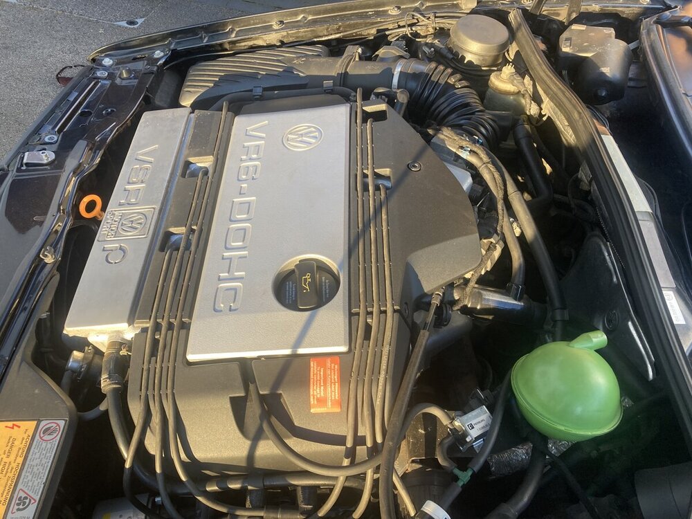

Keyo 47 Posted April 16, 2022 It’s nice you both appreciate a vsr many don’t and not even know what it is and even notice it in bay at a show . Quote Share this post Link to post Share on other sites
ABV-VR6 12 Posted April 16, 2022 4 minutes ago, Keyo said: It’s nice you both appreciate a vsr many don’t and not even know what it is and even notice it in bay at a show . If I see a popped bonnet open and there's a VSR, that's all I see mate 🤣😁. Good for you that you found one! When I posted in the "want to buy" section I got like 3 scam messages lol Quote Share this post Link to post Share on other sites
