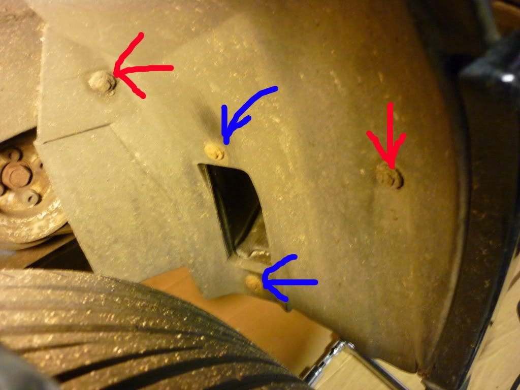

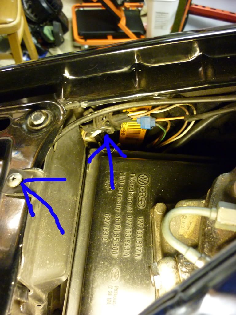

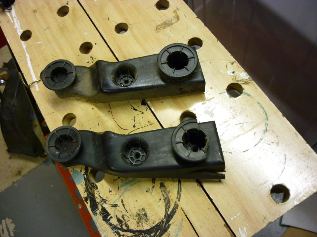

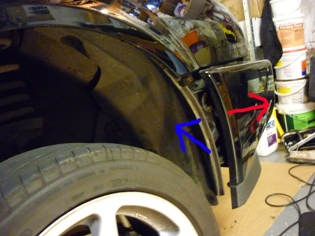

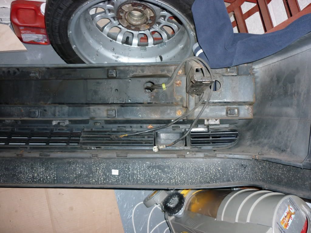

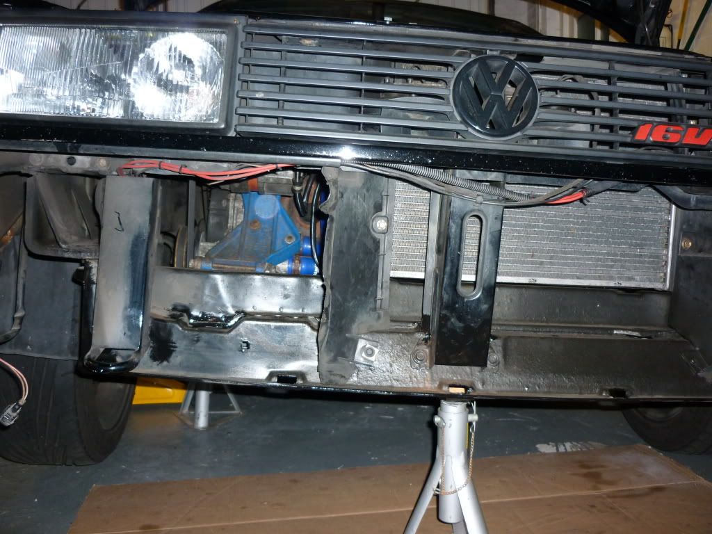

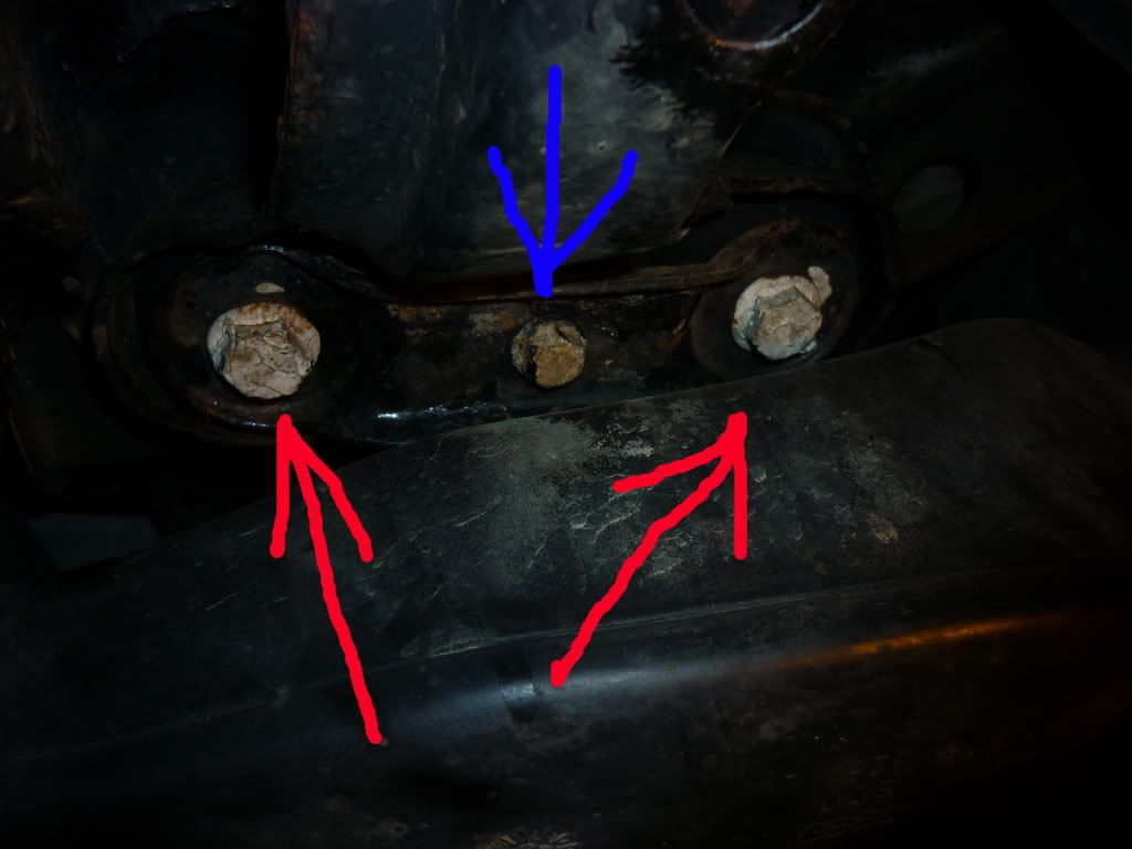

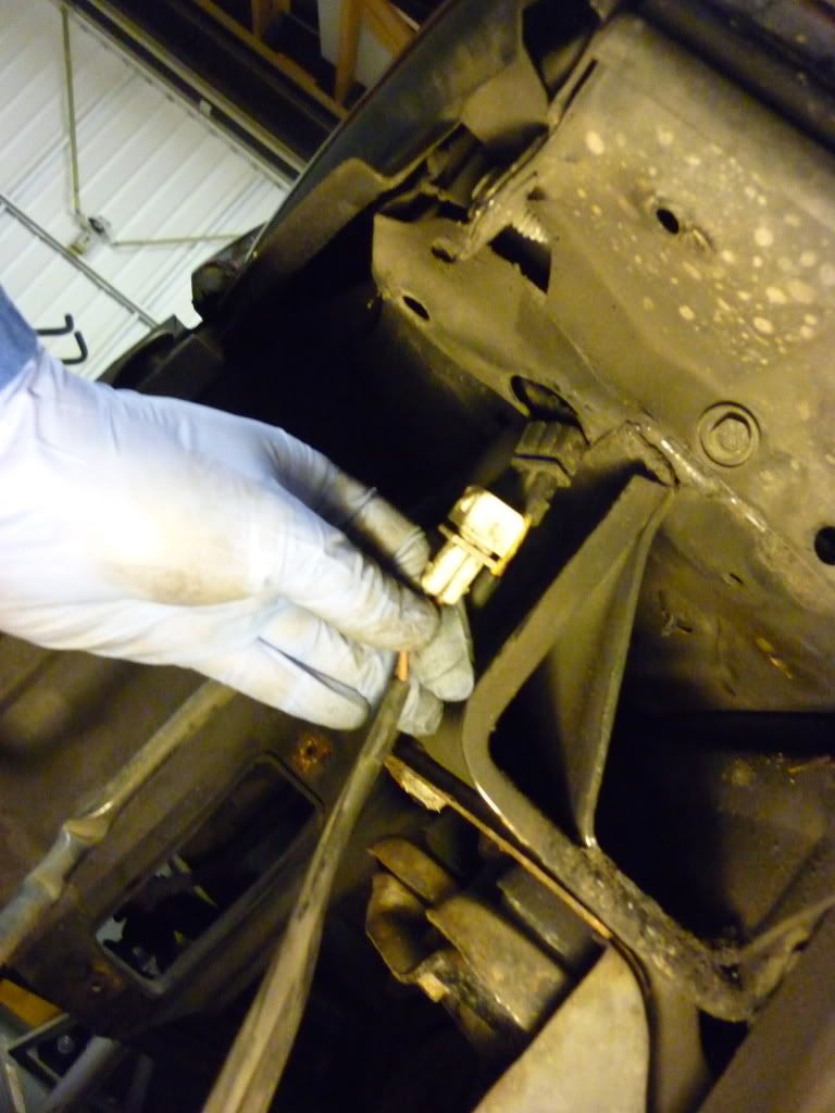

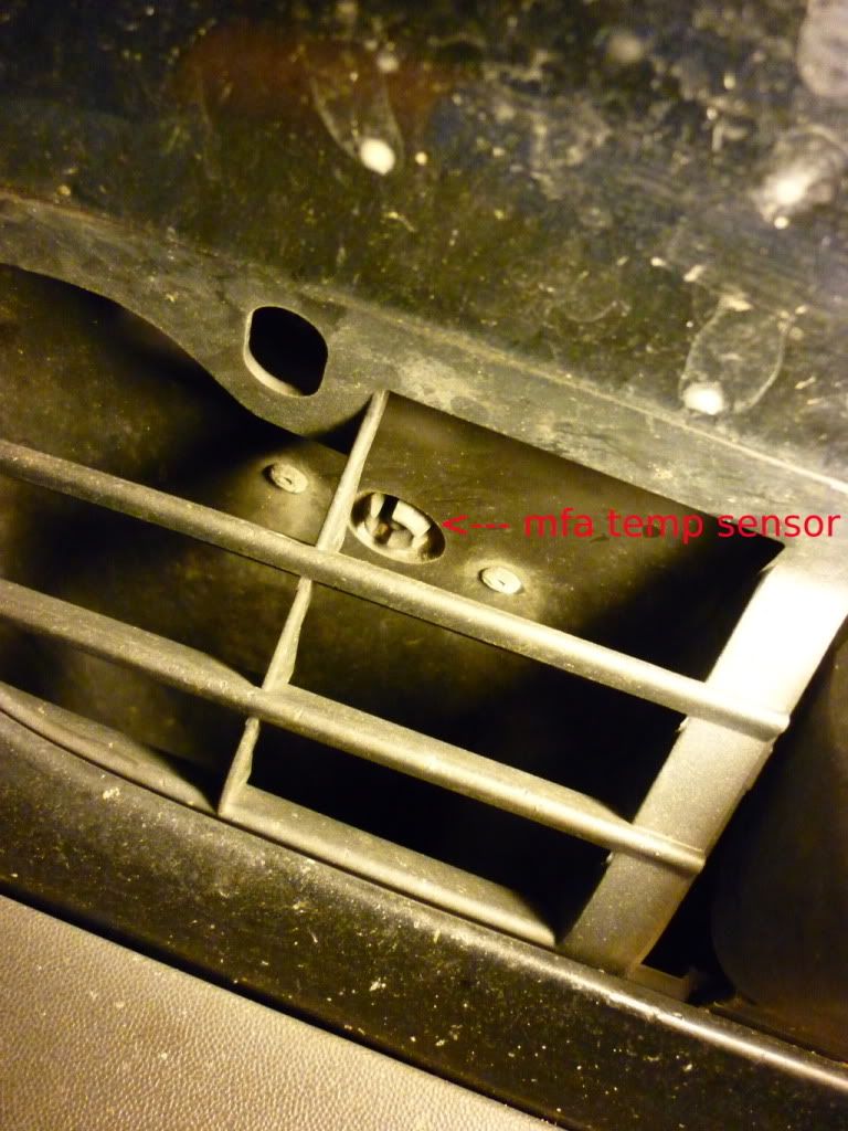

davidwort 0 Posted November 10, 2009 well I've read countless accounts on how to remove the front bumper but never seen any pics of it (I'm sure there are some somewhere), so thought I'd take a few pics as I did the job. Main aim of this mission was to get plenty of underbody wax spray over the radiator support panel as it takes such a bashing from the road spray and dirt. This is all early 16v/G60 specific, as these cars have the brake cooling ducts two main 17mm bolts that need to come out either side of the front cross member, leave the middle small one and help support the engine either from above with an engine support or below with a jack ot stand: outside temp sensor, sits just inside the brake duct on the early cars arch liner bolts to remove, blue ones are for brake duct pulling bumper forward after gently prising the edge lip of the arch liner out of the way cover behind headlight, remove to get access to indicator/fog loom connector dropping down indicator loom from inner wing the front with the bumper off, grubby but not too rusty, it's had plenty of hammerite and wax in the past! one bust bumper side support to be replaced with a 99p e-bay bargain - which has sat in my garage for 5 years :lol: grubby but very solid back of the bumper, it's at least 16 years old, possibly replaced in a bump in the first 2 years of the car's life everything has had a clean, paint and wax spray now, should protect it for at least this winter, need to order a bunch of arch liner screws etc now have some more dull pics of removing the fogs and indicators but this isn't needed as the looms can be detatched in the engine bay and for putting things back together, the 17mm bolts (the front bumper ones) are 85Nm, the 13mm one for the radiator support panel only is 25Nm Quote Share this post Link to post Share on other sites
Toad 0 Posted November 10, 2009 The arch liner bolts now come as screws, and you need a set of penny washers for them. I fitted genuine screws and some galvanised or plated washers we had lying around along with copious amounts of waxoyl. Should make removing the arch liners a lot easier next time. :) Quote Share this post Link to post Share on other sites
davidwort 0 Posted November 10, 2009 ah right, actually I found a torx head screw amongst my random bits and bobs with the same thread and depth and the washer built in, it's a mk4 golf fixing so I might order a bunch of those, not sure they would last the 20 years the original corrado bolts did though, they've done incredibly well considering they sit in the wheel arch! Quote Share this post Link to post Share on other sites
blue95 0 Posted November 10, 2009 Nice write up David! looks like you have been busy :) where does the outside temp sensor wiring come from? is it iff the lighting loom or was it the engine loom? As I can't seem to find mine :scratch: Quote Share this post Link to post Share on other sites
davidwort 0 Posted November 10, 2009 blue95 said: ...where does the outside temp sensor wiring come from? is it iff the lighting loom or was it the engine loom? As I can't seem to find mine :scratch: you see the pic above where the indicator wiring is coming down from the inner wing, well the temp sensor wire is the black sheathed cable to the left of my hand, I think it comes out of a hole a bit further back from the indicator/fog wiring, and presumably it's slightly different on post 92 cars without the brake ducts. Quote Share this post Link to post Share on other sites
blue95 0 Posted November 10, 2009 MMMmmm will take a look Quote Share this post Link to post Share on other sites
dirtytorque 0 Posted November 10, 2009 a bit off topic but i don't spose yu know the torque for the 13mm bolt inbetween the two bumper 17mmb bolts in your first picture do you? Quote Share this post Link to post Share on other sites
davidwort 0 Posted November 11, 2009 dirtytorque said: a bit off topic but i don't spose yu know the torque for the 13mm bolt inbetween the two bumper 17mmb bolts in your first picture do you? from Mr Yandards: Quote The 17mm bolts (the front bumper ones) are 85Nm, the 13mm one for the radiator support panel only is 25Nm. Quote Share this post Link to post Share on other sites
dirtytorque 0 Posted November 11, 2009 great,couldn't find that anywhere. Didn't think it would be too tight.didn't want to over tighten. thnks. Quote Share this post Link to post Share on other sites
