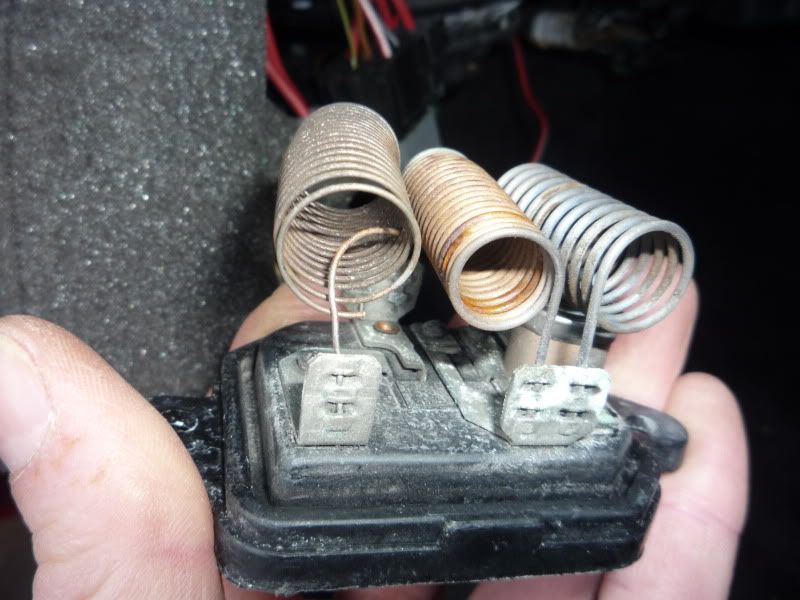

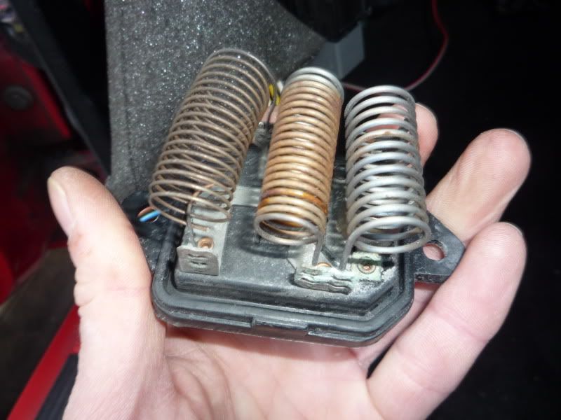

skid 1 Posted March 15, 2012 (edited) skid said: Same thermal fuse as this thread? http://website.lineone.net/~quigger/heater.htm Hasan, i took out the section you mentioned, hoping to find the thermal fuse but i came across this On this pic you can see one of the wires/spring fractured. One of the Resistors is fractured so i will have to try and source a replacement to get the fan going then once that runs check out my Air Con Been up to fiat dealers and the part is Obsolete but is going to source something he thinks might be the right shape/size. If not he says they were fitted to Fiat Coupe`s pre 94 models, so it might be a case of hunting the scrappies for one. Thanks. Edited March 15, 2012 by skid Quote Share this post Link to post Share on other sites
fla 9 Posted March 15, 2012 Hi Steve, If i were you, i would spray the resistor mounting clamps with some wd40 and carefully ease out the broken wire and then uncoil the end of the 'main' coil and refit this in to the slot. Use some thin nosed pliers. This is the lowest resistance wire and holds speed 3. When you put the fan on you will feel them all get hot. Mve to speed 2 and the fat resistor cools, and so on. Dont run it too long out of the fan housing - the impeller moving air helps to maintain the operating temp. The thermal resistor is on the other side of the fans and says Lancia/FIAT on it! Cut this off (its rivetted on) and solder a thermal fuse onto the two open plates. HTH Quote Share this post Link to post Share on other sites
