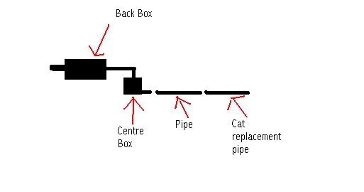

TomD 0 Posted November 21, 2006 Alright all! Had to take off the standard exhaust and refit the milltek as the standard one broke! (Long story! :) ) Am thinking I quite like the car with the milltek back on, goes well, sounds good etc... ...but its just too loud, which is why i took it off on the first place! I've got a cat replacement pipe, which attaches to a bit of pipe, that goes straight to a small centre box, then another that goes to the back box. Like this: (Please dont mock my artistic skills!) So, the question is: 1) Can I get a CAT replacement pipe with a silencer on it, or are they all just 'a bit of pipe' 2) If I can't, can I get a silencer box to replace the bit of pipe? I was thinking I could go to someone like powerflow, and they could either put 1 box in 1 of the locations (pipe/decat) or both, or a long one covering them both. Its toooooooooooo loud! :) Any ideas?? :) Cheers, Tom Quote Share this post Link to post Share on other sites
dr_mat 0 Posted November 21, 2006 Most custom exhaust companies should be able to build you a silencer for that front pipe section. Or maybe you could even get the OE front box to fit. Quote Share this post Link to post Share on other sites
peteTDI 0 Posted November 21, 2006 the milltec cat replacement pipe has a silencer (mine anyway) Quote Share this post Link to post Share on other sites
TomD 0 Posted November 21, 2006 Most custom exhaust companies should be able to build you a silencer for that front pipe section. Or maybe you could even get the OE front box to fit. My standard centre section was the same setup as the milltek (pipe straight from decat to centre box) Are they supposed to have a third box? the milltec cat replacement pipe has a silencer (mine anyway) That sounds promising! from your sig I notice you've got a milltek exhaust from the manifold back...how loud is it, and is it the same set up as mine? Cheers guys! :) Quote Share this post Link to post Share on other sites
