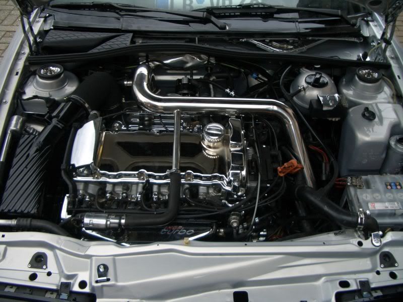

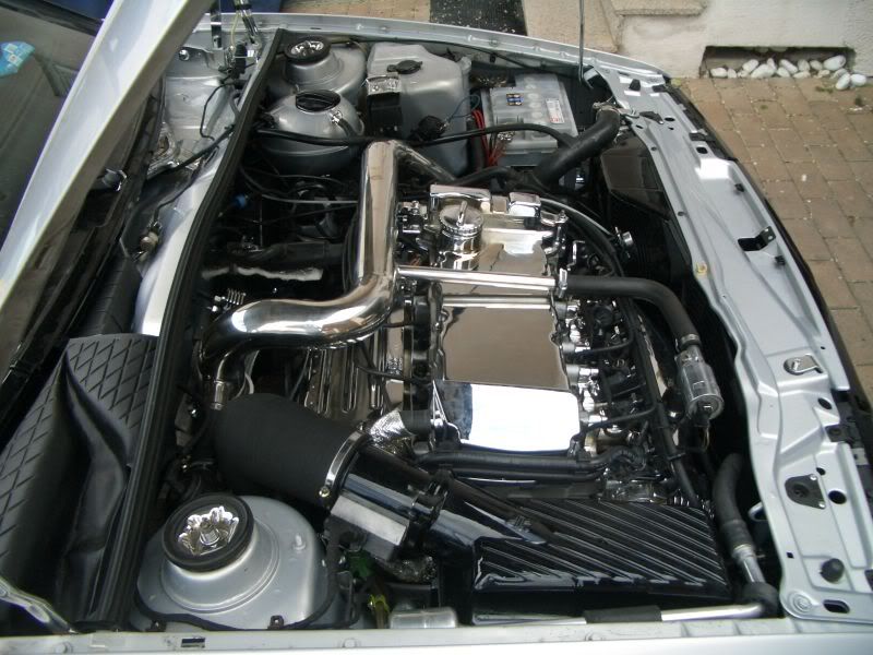

zak 0 Posted February 5, 2009 I once said that i didnt like the way vr6 turbo engines looked because they can look messy, but i like the one below. Not because of the chrome but the layout is so neat. The guys even retained the oem airbox. For anyone interested the guys got a build up of his car here http://corrado-vr6t.magix.net/ Quote Share this post Link to post Share on other sites
Kevin Bacon 5 Posted February 6, 2009 HGP in Germany also use the factory air box - http://www.hgp-turbo.de/vw/vr6g.htm I don't give a rat's arse what it looks like under the bonnet. Cars are for driving, not looking at. Quote Share this post Link to post Share on other sites
zak 0 Posted February 6, 2009 it must be a hgp kit that guys using too as he has a hgp inlet Quote Share this post Link to post Share on other sites
KADVR6 0 Posted February 6, 2009 i understand what your saying Zak,they can look messy when its just all thrown together!! but Shauns engine bay is not what you call messy is it?? and that's loads tidier than a standard g60 engine. Quote Share this post Link to post Share on other sites
StormchargedVR6 0 Posted February 6, 2009 Its not easy making VRT install tidy, have thought about using the OEM air box 8) Quote Share this post Link to post Share on other sites
CrazyDave 0 Posted February 6, 2009 StormchargedVR6 said: Its not easy making VRT install tidy, have thought about using the OEM air box 8) Bet yours flows enough air to suck it flat like a tin can! Had a few people comment on how much 'stuff' is under my bonnet. The other one is 'all that lot for only 290hp', that one makes me smile. I love my mid range torque monster :lol: Not really bothered, it's plenty quick enough for me and not bad for something I knocked up at home on the drive 8) Quote Share this post Link to post Share on other sites
CTWG60 0 Posted February 6, 2009 CrazyDave said: StormchargedVR6 said: Its not easy making VRT install tidy, have thought about using the OEM air box 8) Bet yours flows enough air to suck it flat like a tin can! Had a few people comment on how much 'stuff' is under my bonnet. The other one is 'all that lot for only 290hp', that one makes me smile. I love my mid range torque monster :lol: Not really bothered, it's plenty quick enough for me and not bad for something I knocked up at home on the drive 8) Yes it's funny how people judge an engine on it's looks and hp figures. That guy has sprayed all his fluid bottles silver, err colour coded his fluid bottles! That's just form over function! Quote Share this post Link to post Share on other sites
CorradoVR6-Turbo 0 Posted February 6, 2009 If everything is in its place neat and tidy,no matter how much "stuff" is in the bay then thats a tidy install imop. Quote Share this post Link to post Share on other sites
