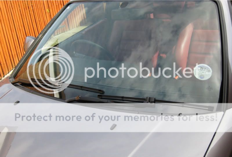

ridlymaca 0 Posted August 23, 2009 Just fitted these onto mine, pics below. I didn't trim anything off so the drivers side wiper slightly overlaps with the passenger side but apart from that no probs at all. Can't wait for it to rain 8) !!!! Cheers Scott Quote Share this post Link to post Share on other sites
