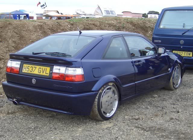

This one is the car a few weeks after I got it. I had swapped the wheels and lights on to it from my old corrado. Other mods at this stage were the rubbing stips removed and a change to a late spec grill.

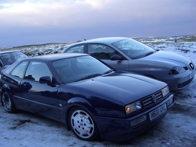

One out in the snow we had in Feb last year
Few other bits done in the pic below, mud flaps are on..... contraversial i know but i kinda like them and i think they make the back of the car look lower. Removed the rear towing eye and smoothed the bumper, painted number plate surround and de-locked and painted door handles.

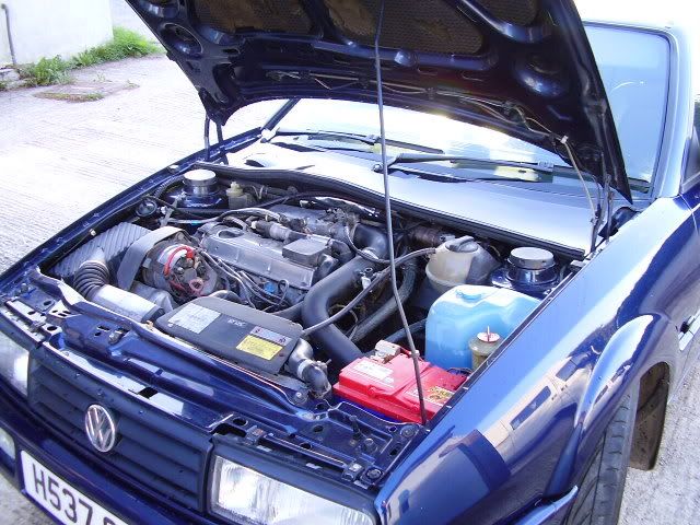

One below is a pretty rubbish shot of my engine bay.... i'm not much of a picture whore really and i don't have many good ones! I think some other people have better pictures of my car. The car is now wearing the very first of the full length scuttle covers. Its also got some aero wipers (ones from a passat that i got from the scrapper for £5 and modded to fit the 'rado)

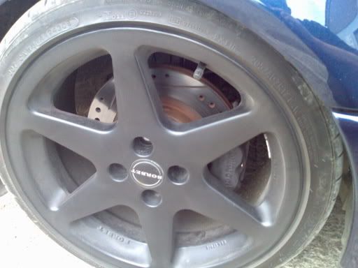

And at the front, some wilwoods came up at a price i couldn't refuse.

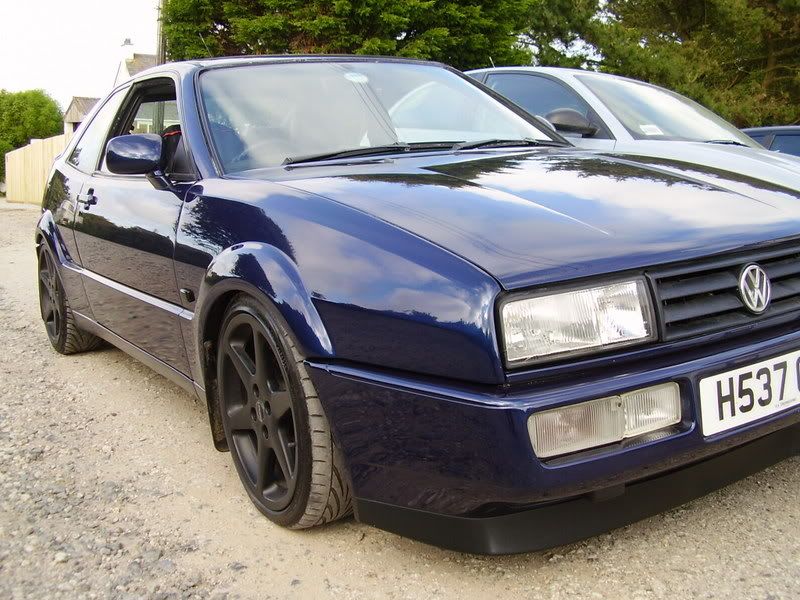

Car is running in winter spec here with the satin black borbet c's

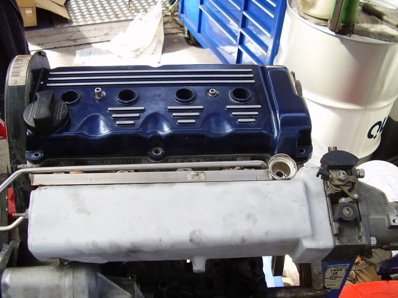

Well.... its 1 month till E38 and i've realised my engine is no closer to being built than it was 2 years ago!

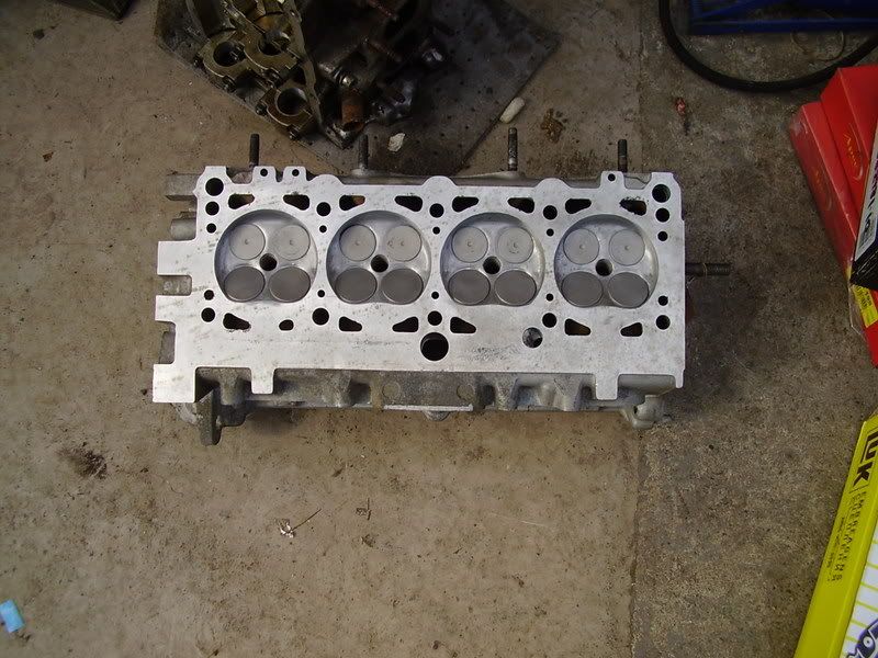

So, last week i finally finished porting my head and sent it back to the machine shop for the finishing touches. A few other bits are starting to come together now so i'm finally making progress!

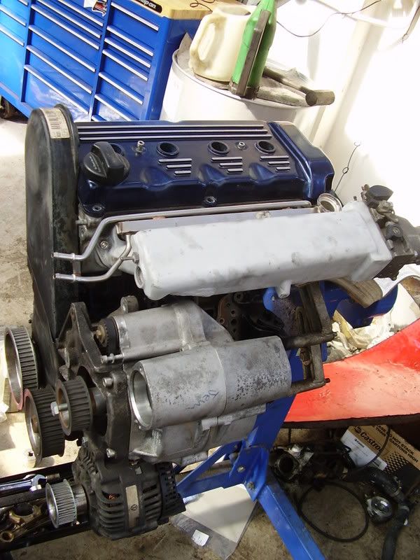

The engine as it stands..... one month to go, well actually less as i'd like it up and running before a local show over the bank holiday!
For those who haven't guessed it yet i'm builiding a 16vG60
2l 16v G60,
Scat H beam Rods,
Fully ported head,
Cut down S2 manifold,
Emerald stand alone management,
Custom front mount I/C,
Standalone charger oil system,
...... and a few other bits n bobs!
Well, quick update for the few who may be interested.

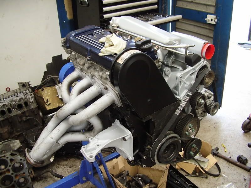

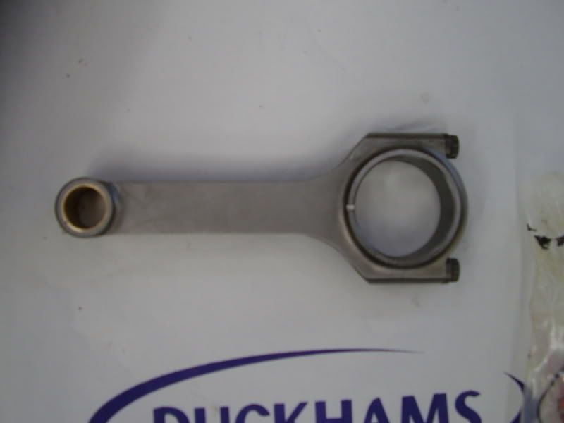

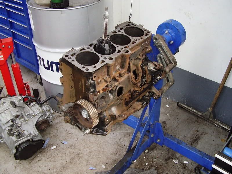

Engine is coming together quite well, got the rods and pistons in, got the head built back up and bolted on. Pretty much finished the S2 manifold and had a quick trial fit of most of the parts to see how things will look!
Nice shiney scat steel rods
Engine with a few bits trial fitted. Don't worry, most of it will get some paint before it goes together. WIll probably have it all apart again after E38 but i just want to get the thing running and get some kind of map sorted for the emerald
Got a G60 auto throttle body from the states which gives me a throttle pot for the standalone management. It also has a pair of throttle switches which may come in handy for some added NOS at some point! :-D
Only got 3 weeks to get it in and running...... soooooo much to do!

Right, time for a quick update.... been pretty busy on the car this week. Finally think i've got the belt routing and alternator mounting sorted. Engine is pretty much together and ready to go in. I've pulled the old engine out now.

Thats the engine pretty much together and ready to go in.

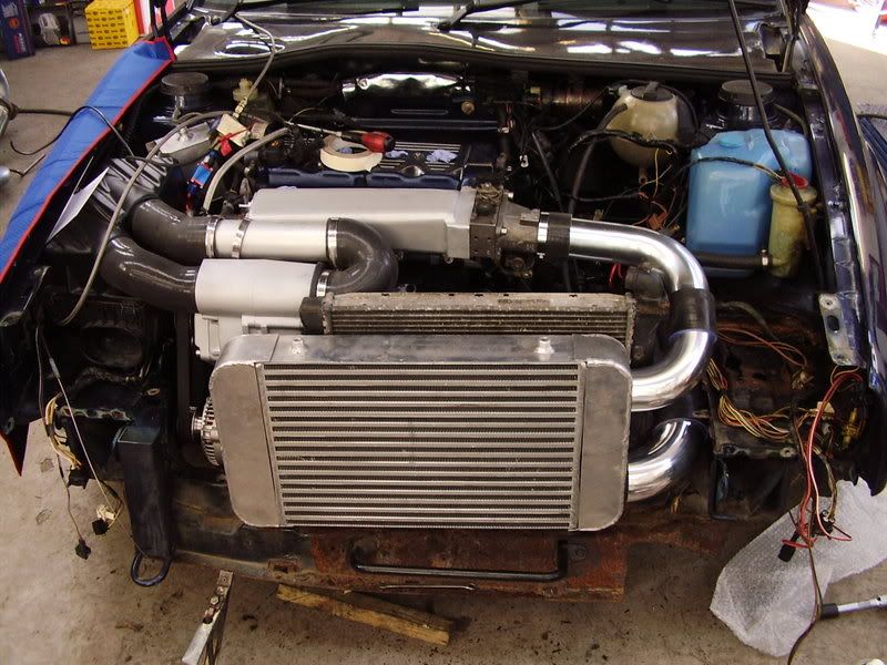

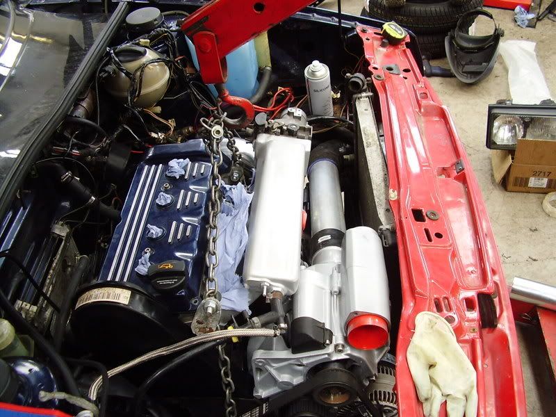

Engine hung in the car for the first time. Happpy to see the alternator clears the front cross member ok.
Quick pick of the fabrication for the intercooler. Had to make it twin pass really to be able to have a sensible pipe routing.

The intercooler is a cheapy ebay jobbie that i've cut the end tanks off and fabricated new ones. Couldn't have got a much bigger one in there tbh!
