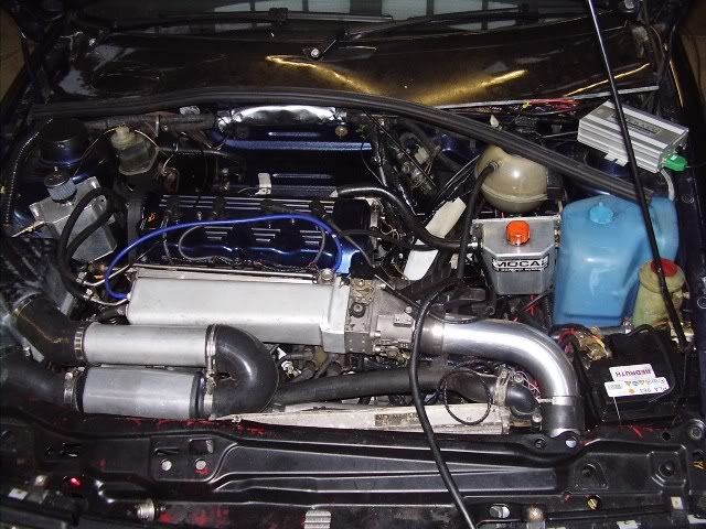

Oh, a few pics of the mess that is:
Flusted has a ported head, and Yan has already mentioned that he will see lower than expected boost pressure because of this, although expected power output would still be the same.
Loving the engine pics! :D
Yes, a ported head will be less of a restriction and hence you will see a lower boost pressure. There comes a point when an engine is flowing well that pressures in the cylinder during induction will begin to match those in the manifold. At that point you need a bigger charger!!!

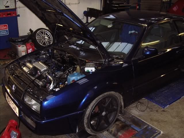

Well, after some more playing around it finally makes over 300bhp.
I've done a few mods but nothing really made a great deal of diffence to the performance.
I fitted water injection, i hoped that when running this with some methanol i'd be able to run some more ignition advance and make some more power. This just wasn't the case unfortuantely. I can advance the timing up a bit more with no det but there is no extra power to be had from it. I guess its given me a bit more of a safety margin (and it will come in useful for some later mods i have planned) but at these boost and compression levels it doesn't give any performance advantage. May have been a different story on a really hot day but as it is the large intercooler i have keeps chage temps around 18 degrees even on the dyno.
I have made a complete new exhaust system from the 4 branch back. I hoped this would pick up a few horses as i couldn't quite believe 2" system would flow enough for 300hp (well more than 300 if you think about it as the chager is probably pulling 20-30 on full chat)
Anyway, i know i need the bigger system for whats coming later but as things stand i didn't gain anything.
Did a couple of other small bits, ported the charger outlet and the throttle body. Actually got round to fitting a cold air feed and cutting away the airbox.
So, at the end of all that, most of the extra power came from playing around with induction kits! (see my reply on induction kits thread)
It seems the charger loves to have a large volume of free air to draw from, if i was playing about further i would be tempted to mod the charger inlet casing as bbm used to and bore the whole inlet side out to a larger volume.
Anyways, thats about that really, 300bhp is achievable from a G60. I'd love to have more time and money to throw at it and try more charger mods, a different 4 branch, a CNC head and maybe a higher compression ratio..... but that said i think i'd be lucking to see more than 10-20bhp more. It would also be nice to be brave/stupid/rich enough to try reving it a bit higher, but i think i'm in the region of pushing my luck as it is. Maybe i should go the dutch way and rev a 62mmm pulley to 8k! LOL :whistling:
