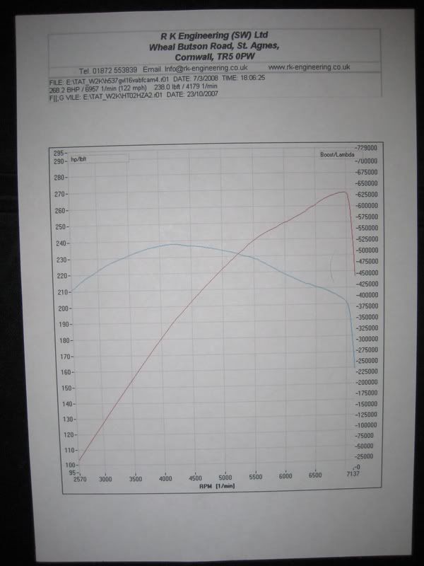

I got 5 mins this afternoon and the car has a few miles on it now so i chucked it on the rollers to see how things were coming along.
After a few little tweeks this is where we are at:
Discovered a few problems:
FIrstly the 385cc injectors are hitting 91% duty cycle with my 3bar pressure reg. So i need to find myself a 4bar and re-scale my fuel map.
Poking about underneath i've had a closer look at my exhaust system, its a supersprint system thats been on there for years and it drops down to 2" towards the end. Going to borrow a bigger system and see if that frees it up at all.
I tried addin a couple of degrees of advance and saw some good gains so i want to get a tank of optimax in there and try upping the advance a fair bit more.
Boost seems to be pegged at 10psi pretty much through the entire rev range.
So..... basically i think there is a fair bit more to come. :D
Wow a power curve for a 16vG60 got to be a first for corrado.net, heard good things about Emerald from speaking to Steve PSD how does it idle? What happens below 2500rpm ? Is the graph at the flywheel or wheels? Are you running an PG ISV, knock sensor or EGT?
Yeah, the emerald is great. We have done several 20vt conversions with it and we also used to run a caddy on itb's with it as well. Does everything you need it to and more really.
Idle is fine, pretty smooth. I'm not running an isv, idle control is purely done by the ecu adjusting ignition timing. If it were a problem i could add an isv but i have no issues with it tbh. Not running a knock sensor and no egt on there. I have got a wideband kit on it and i've got that fed to the ecu. Feature of the newer emeralds is that you can set target afr's or set it to auto-tune to a desired level. It takes a while to do that so most of the mapping i do live, i leave the wideband to sort the light throttles and cruising sites.
Not sure why the plot scaled to start at 2.5k, i'll have to have a look at that when i get 5 mins. All figures are at the flywheel.
