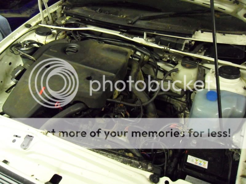

Purple Tom 0 Posted April 1, 2011 Thanks for the responses everyone :) Diesel Junior - hadn't heard of the Corrado database before, it's nice to see there's plenty more! I'd a feeling that there must be some in mainland Europe because of the amount of Corrado's over there but I hadn't seen any. Looks like there's a good variety of engine choice too, I like the PD150 conversion...if only I had the means :lol: Coullstar - I'm not sure either! I really don't know what its going to be like but I'm hoping it will just be a good frugal daily drive. It's going to be widetrack, have all new suspension components, decent brakes and a nice comfy leather interior so it should be generally a pretty nice place to be. I've just ripped all of the soundproofing out of the Passat (which was nice and quiet internally), so I've got an idea of how noisy it'll be. Power wise I know its going to be slow to begin with but it'll easily do 90mph on the motorway which is all I need to begin with. I can begin to chase more power/torque once I've got it reliable. TheDubFather - looks like you're a bit further ahead than me! Get yourself a project thread started! I hope to have a picture very similar by a week on Sunday ;) Mikkijayne - I wondered whether the same car was getting that V8, good luck with the conversion, should be awesome when its done! Reading some of your threads on other forums has really helped me out, so thank you :) I know what you mean about remapping the ECU...I plan on upgrading to VNT and an AFN ECU before much else but then I can have a go at remapping myself....can't be that hard can it? ;) Quote Share this post Link to post Share on other sites
