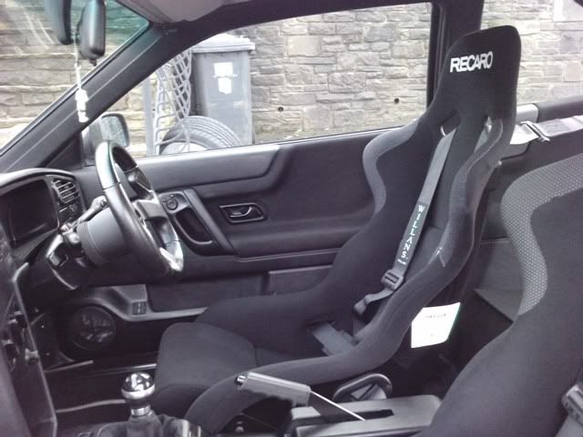

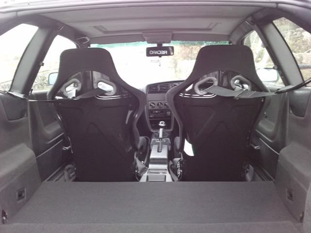

Finally got my new seats in now after buying one 2nd hand from ebay then getting impatient waiting for another one to come up so just buying a new one!! anyway thought i would post up some pics with my stripped out interior, not totally down to the metal race car but retaining some comfort and looks. Picked upsome cheap harnesses from the 'bay which finish it off nicely. A few more tidying up jobs before it's perfect but I am well pleased with the new look 8) . By the way i am now on 90kg weight loss and with my carbon bonnet to fit next week it should take it over 100kg. :clap: will post up piccies and more stats then.
lovin' the fact the recaro writing is reflecting in the rear view mirror, just by chance 8)
looks really minto. I wanna do something similar with my silver valver, lightweight and mean. wheres your 4 branch from?
Great looking seats,I bet really, you were trying for ages to get the logo in the mirror ! :) Looks good without the handbrake gaiter too.
Cheers mate, got the 4 branch from the 'bay, about £80 or so 2nd hand. The heatwrap was about £10 from a guy who had bought too much so i bought the excess, just enough though!
Thanks, I have now removed the entire handbrake tunnel (another 1.1kg) and replaced it with a piece of black carpet. Looks very motorsport, just deciding whether or not to get a suede sparco wheel or not and maybe get one or two bits flocked.

I have actually made a false floor for the boot from some thin hardboard covered in black acoustic carpet. Also I used some bits of carpet to cover where the handbrake tunnel was and cover the uglyness of the underdash wires/electrical gubbins so at least it still looks respectable. These will probably weigh in at a couple of kg's so maybe not quite a hundred kilos.

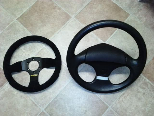

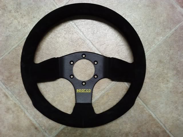

My new steering wheel :clap: could'nt resist with christmas money burning a hole in my pocket (how old am I? :lol: )A nice finishing touch to my motorsport/fastroad theme to my interior. A Sparco suede 300.
A change from my current Momo Jet 320mm.
A pic to compare to the Sparco 300mm to 360mm original.
Am just about to go out and fit it now (in the snow :censored: ) and post up more pics when its in.
How much weight does your new steering wheel save ?
It looks good,but we are going to need a pic with it installed :D
:lol: :p now you ask i think it is about 400g! at least it is not heavier :lol:
