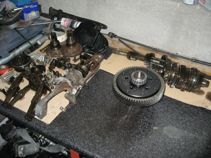

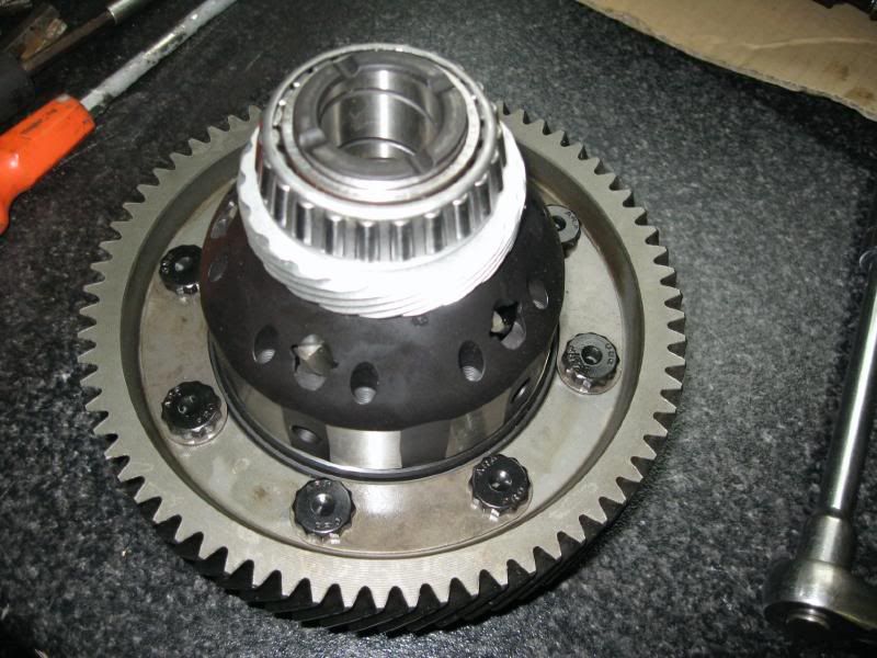

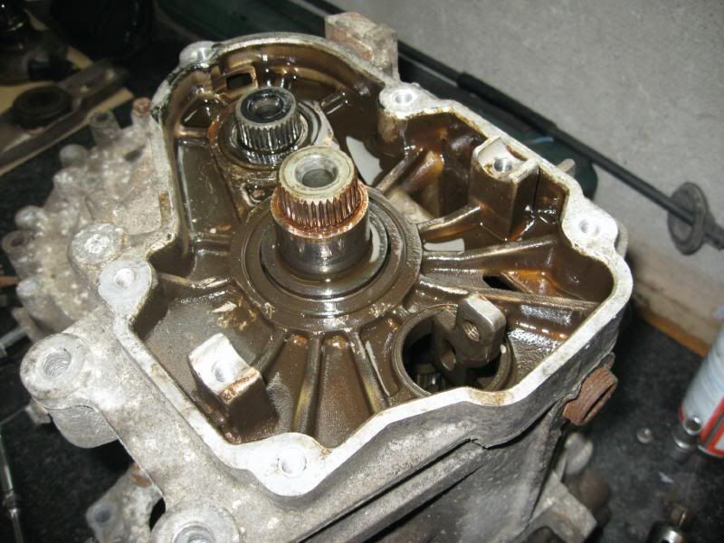

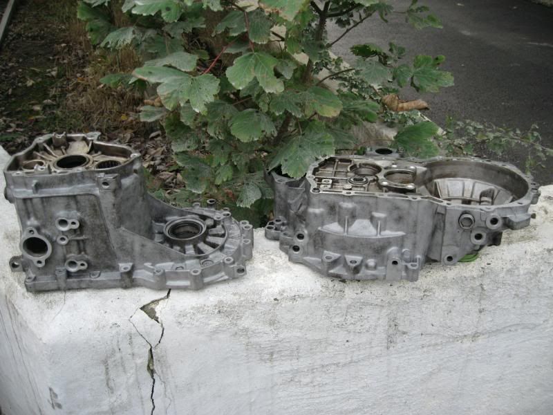

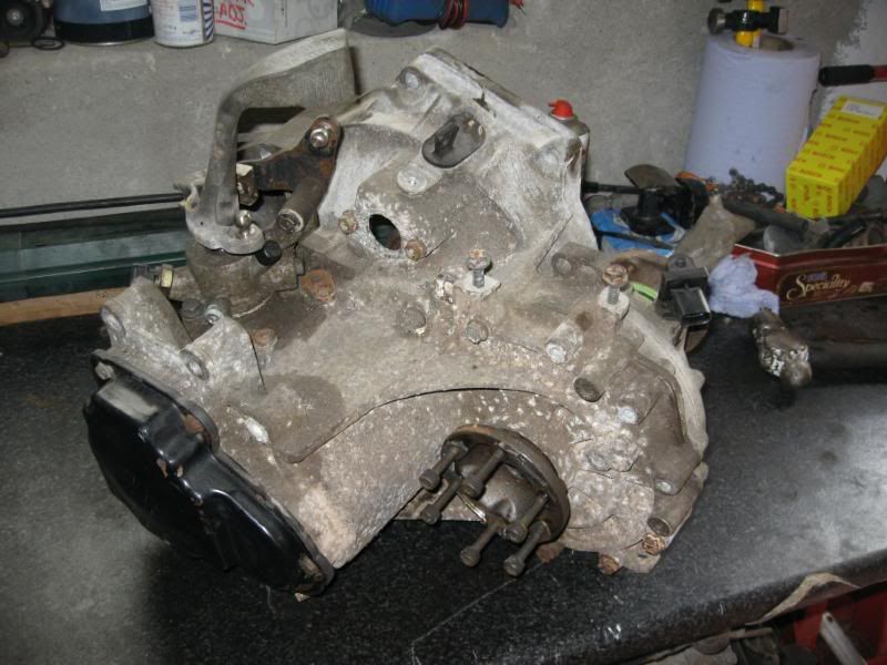

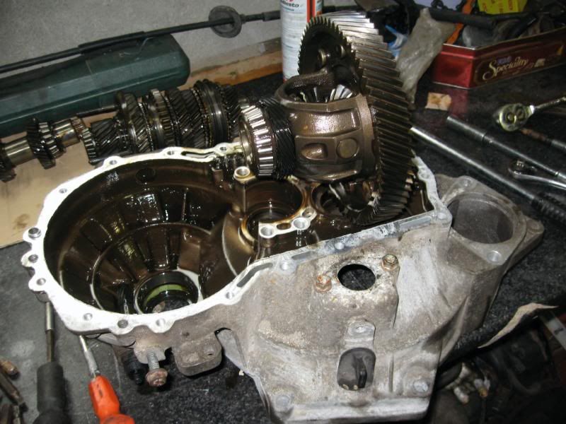

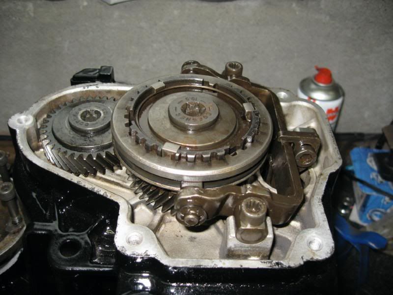

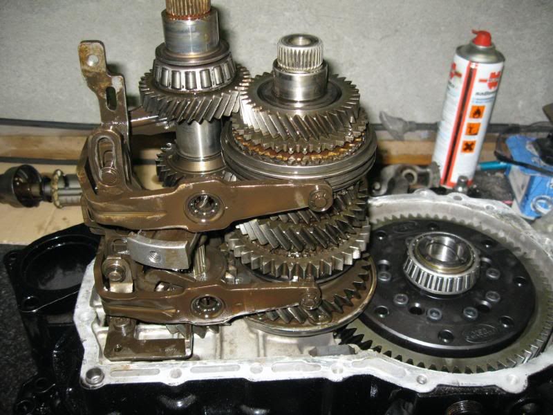

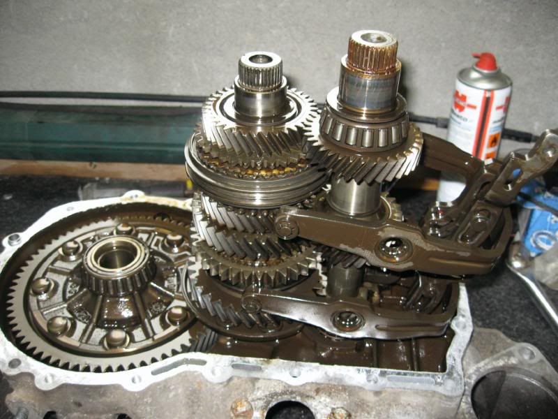

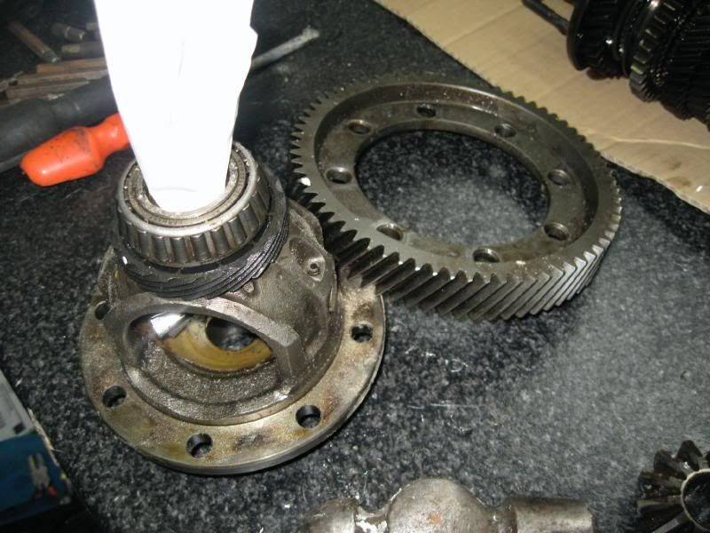

20vturbo 0 Posted August 19, 2009 just finished fitting my lsd. it was so simple a 4 year old could have done it, so heres some pics Quote Share this post Link to post Share on other sites
-=Kris=- 0 Posted August 19, 2009 Holy HELL that look complicated!!! :shock: Quote Share this post Link to post Share on other sites
20vturbo 0 Posted August 19, 2009 its alot less complicated than it seems. it only took a day to clean and paint all the parts and fit the lsd Quote Share this post Link to post Share on other sites
-=Kris=- 0 Posted August 19, 2009 good work so far tho mate... you'll have yourself a brand new corrado when your finished...!! Quote Share this post Link to post Share on other sites

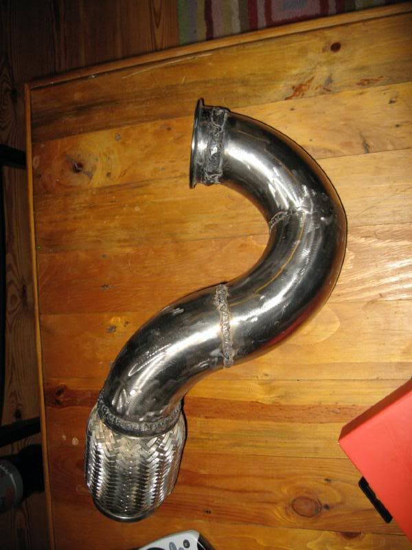

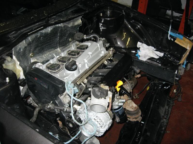

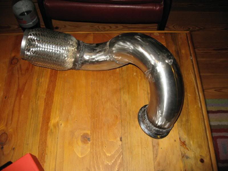

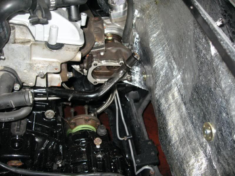

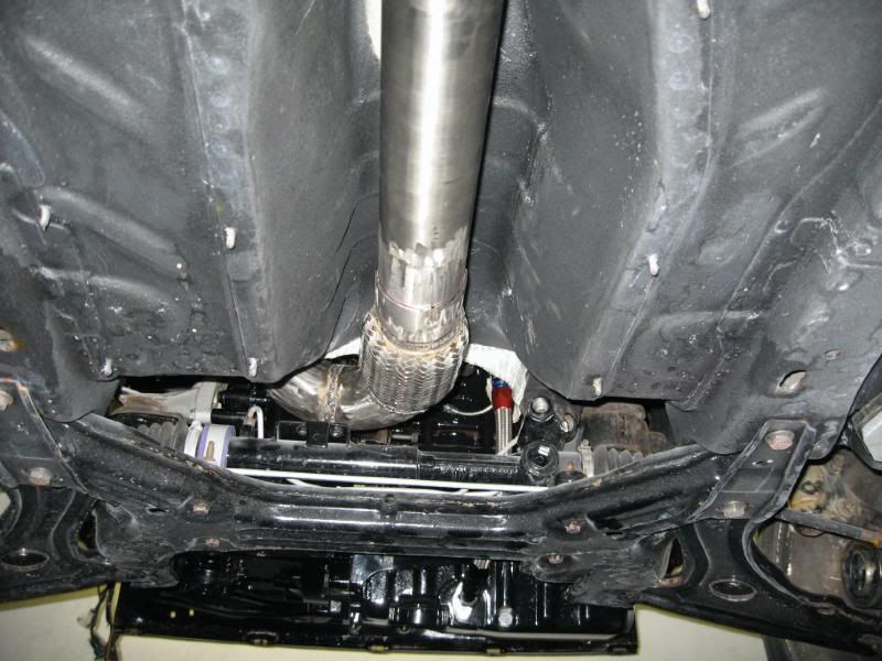

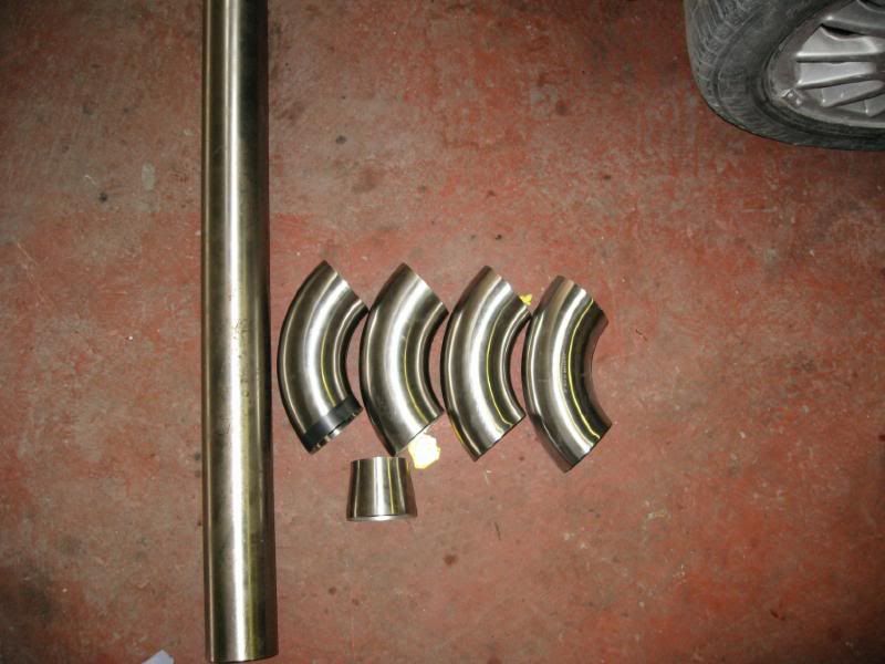

20vturbo 0 Posted August 25, 2009 while i was waiting for my crank seal and water pump i decide to sit the engine in place and make a start on the exhaust. plenty of room for the exhaust from a few peices of 3" stainless pipe to this Quote Share this post Link to post Share on other sites

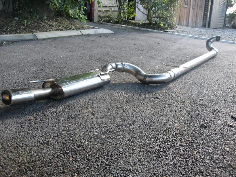

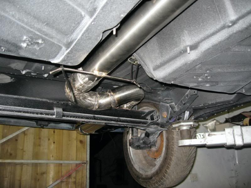

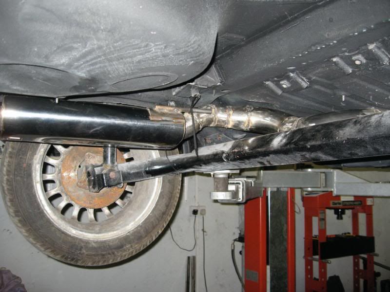

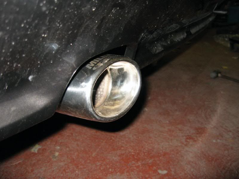

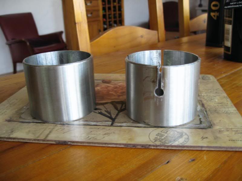

20vturbo 0 Posted August 28, 2009 got some pieces of stainless machined to fit over the 3" pipe so i could make joiners because i couldn't find anyone that does joiners for 3" exhaust when i got them i cut the slots and holes so i could put a clamp on them i got a secondhand miltek box that had only been used for no more than 10 minutes heres some pics of the finished exhaust i made dont worry the cable ties arent permanent Quote Share this post Link to post Share on other sites
20vtvw 0 Posted August 29, 2009 very impresive work going on there ,,cant wait for next update :salute: Quote Share this post Link to post Share on other sites
tyler 0 Posted August 29, 2009 still love this car the work always impressive Quote Share this post Link to post Share on other sites
Dude VR6 0 Posted August 29, 2009 Nice exhaust, she will sound lovely and loud :clap: Quote Share this post Link to post Share on other sites

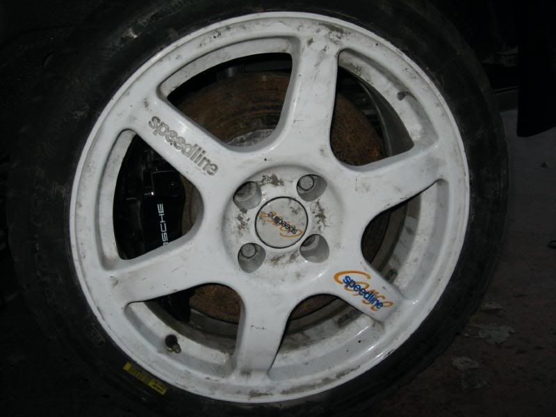

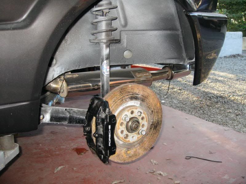

20vturbo 0 Posted August 29, 2009 yes thats the rear yes thats a 312mm disc :D Quote Share this post Link to post Share on other sites
big ben 10 Posted August 29, 2009 312 on the rear :shock: :cuckoo: Quote Share this post Link to post Share on other sites
20vturbo 0 Posted August 29, 2009 if you like that wait till you see the front :nuts: Quote Share this post Link to post Share on other sites
tyler 0 Posted August 29, 2009 everything on this car has been huge so im not suprised the brakes are..... what clour are you doing the wheels? Quote Share this post Link to post Share on other sites
coullstar 0 Posted August 29, 2009 Impressive but do you really need the rears that big? Quote Share this post Link to post Share on other sites
20vturbo 0 Posted August 29, 2009 tyler said: everything on this car has been huge so im not suprised the brakes are..... what clour are you doing the wheels? im not sure yet, ill have to wait untill i get the actual wheels im using before i know what color to paint them. Quote Share this post Link to post Share on other sites
20vturbo 0 Posted August 29, 2009 coullstar said: Impressive but do you really need the rears that big? nope, in fact the standard ones would have been more than enough but i want a challenge to see if i can get it to work properly and they do look unbelievably good. i admit it, im a brake whore :lol: Quote Share this post Link to post Share on other sites
coullstar 0 Posted August 29, 2009 Fair enough. Going to have some sort of brakes bias adjuster I take it? Just seems an awful lot more unsprung weight for no real reason. Quote Share this post Link to post Share on other sites
20vturbo 0 Posted August 29, 2009 coullstar said: Fair enough. Going to have some sort of brakes bias adjuster I take it? Just seems an awful lot more unsprung weight for no real reason. its actually not a heavier setup because the porsche calipers are alot lighter than the original ones so it probably works out roughly the same weight. ill run it first with just the original bias adjuster and if needs be ill put in and adjustable one. Quote Share this post Link to post Share on other sites
pete_griff 0 Posted August 30, 2009 unless you're planning on carrying stuff in the boot and/or people round all the time that's just too much for the rear - the original bias adjuster almost certainly won't dial enough out to have the car braking as it should. they look lovely, but it's going to be too much for a rado considering how light they are on the rear end (no 4wd system, nobody ever sits in the back and hardly any overhang over the rear beam). i'm sure you must know a friendly MOT tester who can get it on his brak rollers and tell you what the bias front to rear is. also before you do that, checkif that will damage the peloquin. afaik, peloquins/quaifes are fine to put on the brake rollers and it won't damage them unlike other types of lsd; but i would check that and get it in writing before you do... that said, people on here have been after a solution to do away with the horrible nasty original rear bearings for a while and get an arrangement to fit a nicer sealed cartridge bearing that you press in. if you could run something like 288's on the rear and 2-pots instead of 4, that would probably be a fair bit more realistic... do tell what hubs etc you're running for that setup. also what does it do for the offset? all the above said i'm not trying to criticise your work at all; the car is looking outstanding thus far and it's a real credit to you seeing the care/attention and time that you're putting in. please do keep us all posted as it progresses :D :clap: (also not tying to capitalise here, but i'm shortly going to be selling a set of evo 6 brembos. they have massive 4-pot fronts (much bigger than the ones you'll find on a leon) and 2-pot rears. they work perfect but have turned pink with age/heat. i'm only looking for circa £150 for all 4 calipers, so drop me a PM if you're interested. if not i'll sell them on the lancer register) Quote Share this post Link to post Share on other sites
20vturbo 0 Posted August 30, 2009 you have made some very good suggestions, i know its over kill but from day one i wanted huge brakes on the front and back, i wouldn't bother with two pots on the rear because it doesn't take any more effort to put four pots on and i really love the way it looks plus it will make the car stand out. as for the front to rear bias im not going to do anything until the brakes are working anyways bias adjusters are cheap Quote Share this post Link to post Share on other sites
