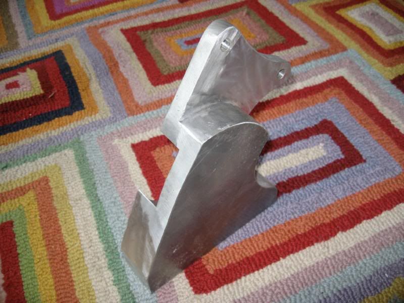

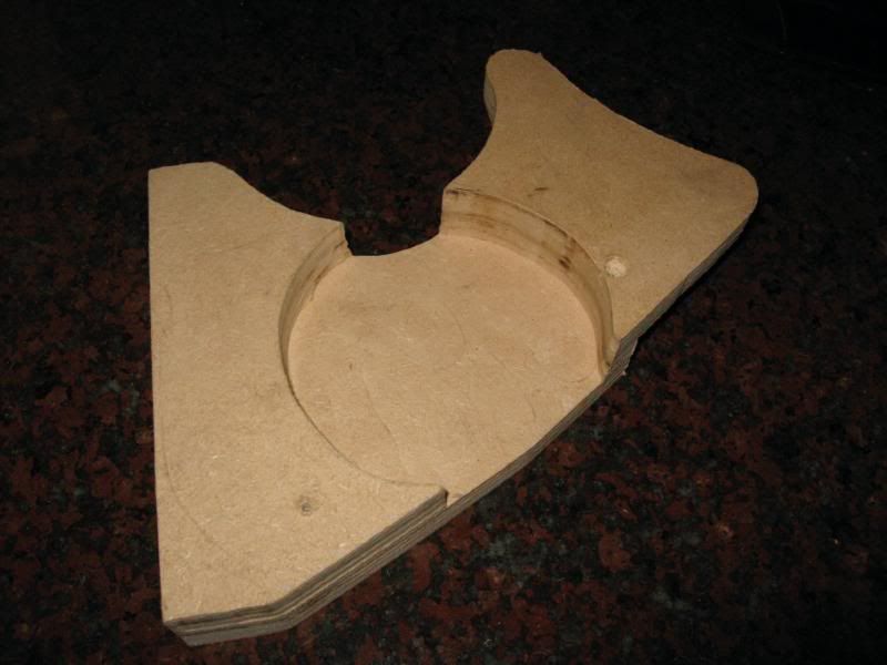

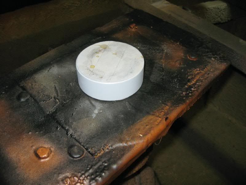

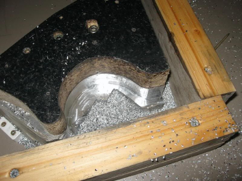

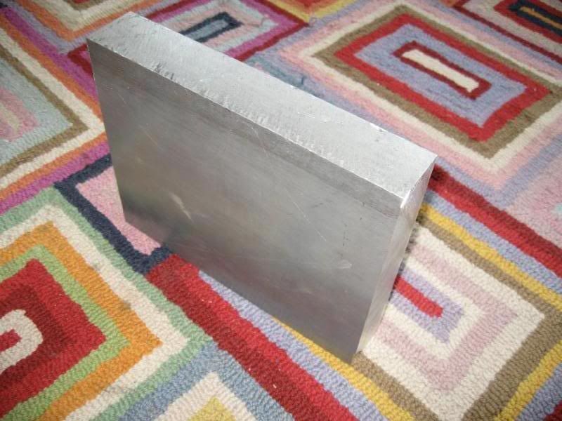

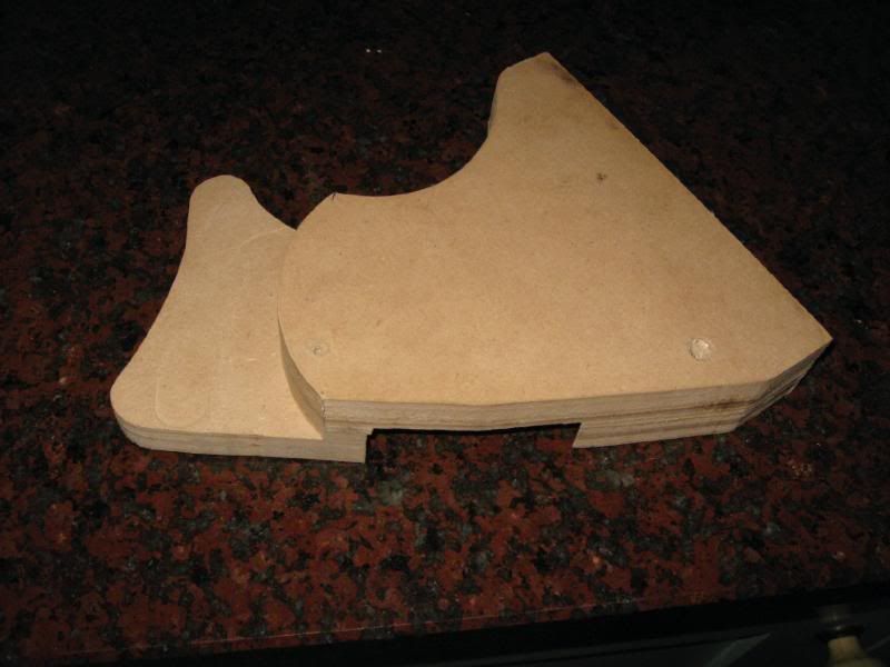

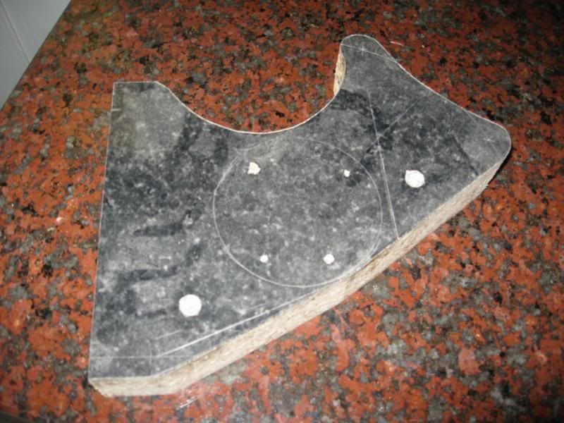

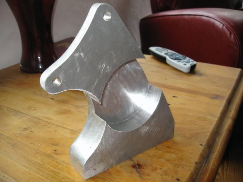

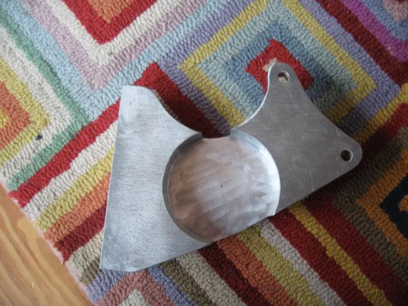

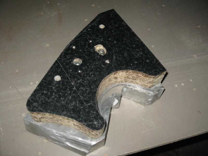

20vturbo 0 Posted June 7, 2010 this is the 4th generation rear caliper bracket and hopefully the last. started with some worktop to make a template which i can work from. then i made it out of mdf to check the design and make sure it will work. a big block of aircraft grade billet aluminum, 200mm x 250mm x 44mm roughly cut to shape and my template attached to it fixed to the bench and started machining it the finished product Quote Share this post Link to post Share on other sites
Philuk 0 Posted June 7, 2010 wow nice work there mate.. serious skills still showing well :D Quote Share this post Link to post Share on other sites
WigsVR6 0 Posted June 10, 2010 Wow is there no limits to your skills? I want to cry everytime I look at this thread. I'm so ashamed of my lack of skills :D Quote Share this post Link to post Share on other sites

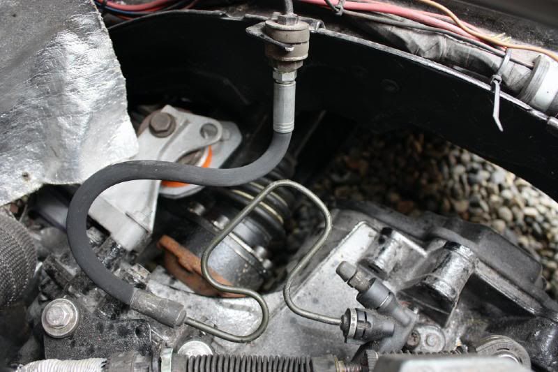

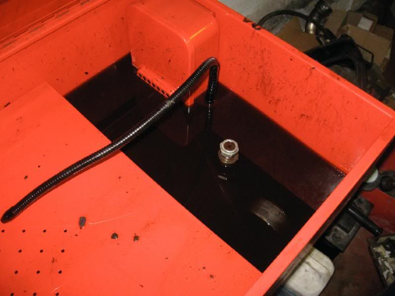

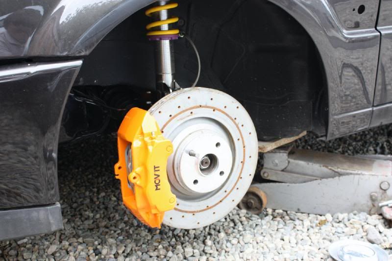

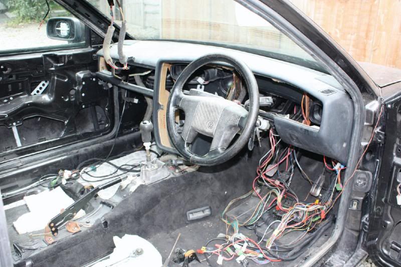

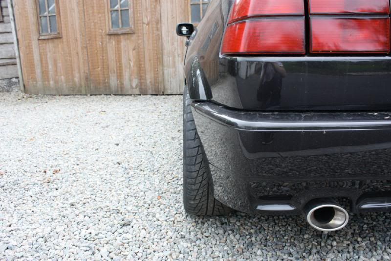

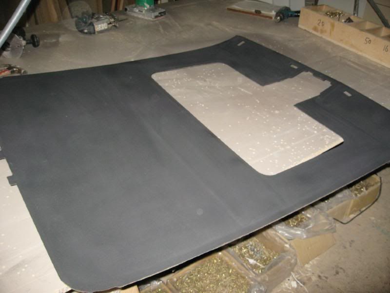

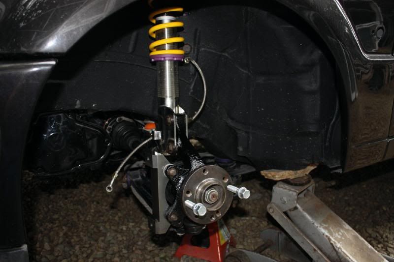

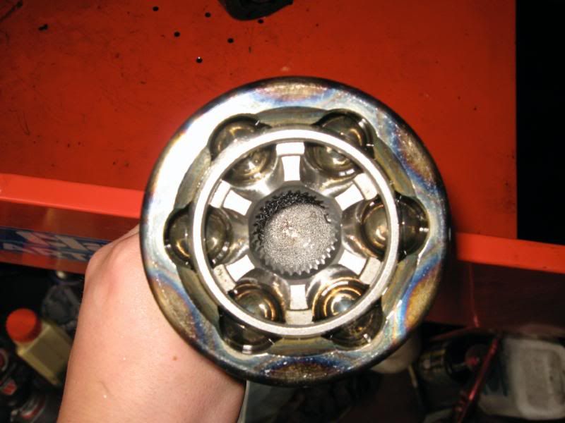

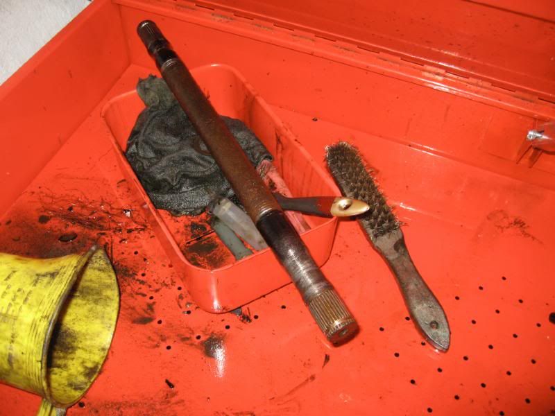

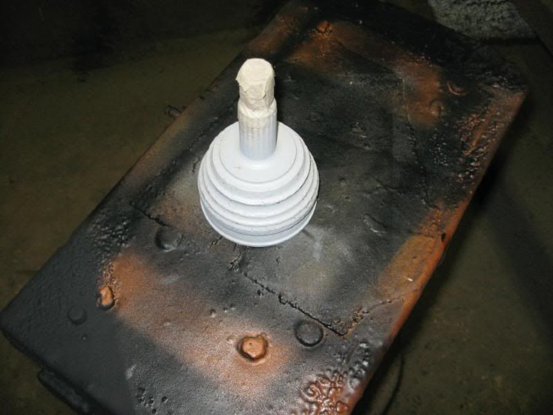

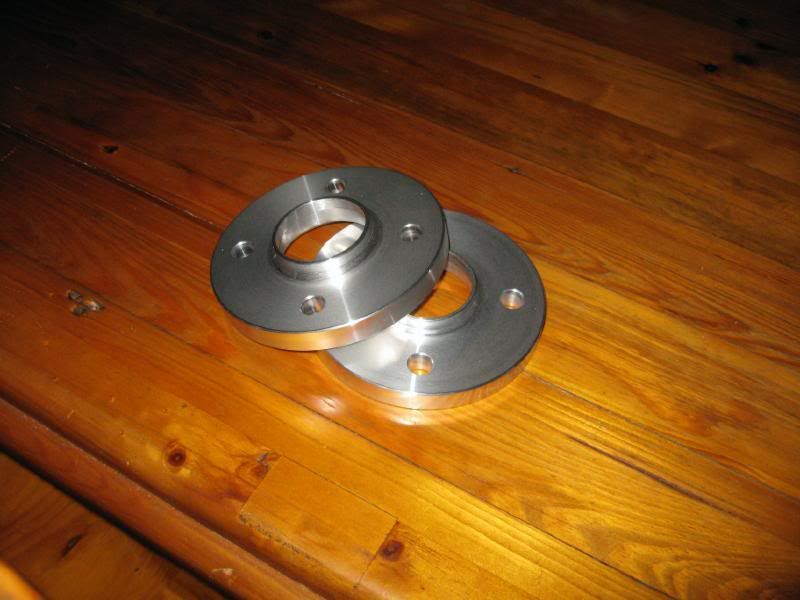

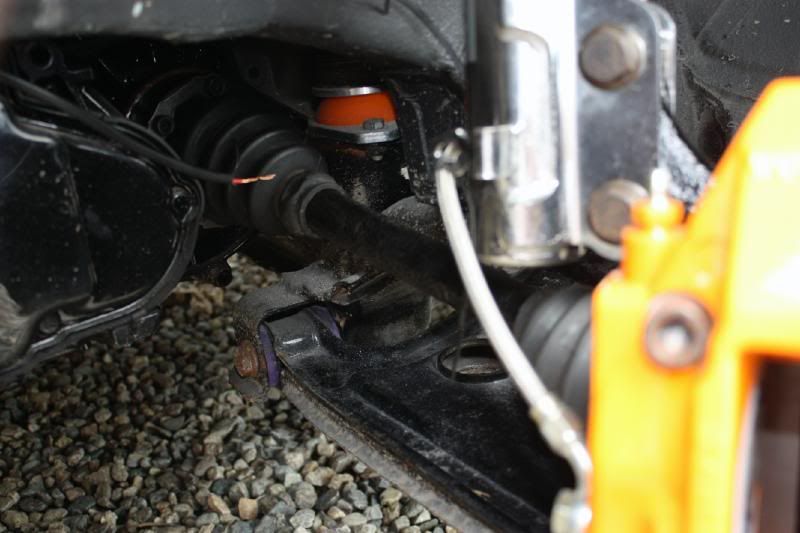

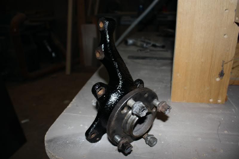

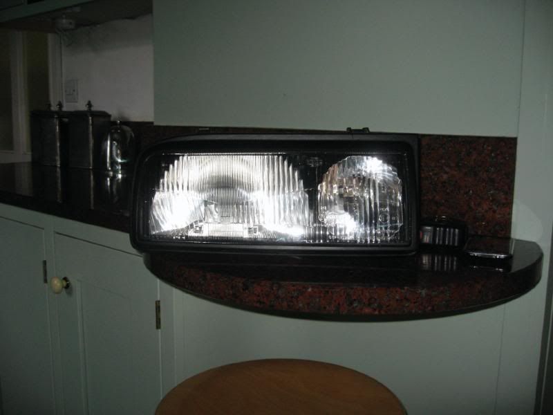

20vturbo 0 Posted July 9, 2010 i redid my headliner in black did some parts of the headlight reflector in black i got 15mm spacers all round to clear the brakes sandblasted the hubs and then gave them a coat of stone chip took the driveshafts apart and let the cv's soak in the parts washer its amazing the amount of dirt that comes out a cv when you clean it a coat of acid 8 the shaft and the cv's got a coat of stone chip and then i fitted them all the wires attached to the dash were re wrapped and then the dash was put in brand new genuine windscreen and brand new genuine trim the front suspension and brakes completed i have the 2 rear calipers fitted, you can just about see the 2 sliver bolts of the handbrake caliper the rear brakes give the back wheels a bit of poke custom clutch pipe made to go from the corrado clutch pipe to the mk4 slave cylinder forge recalculation valve the engine is nearly finished, just waiting for a few final bits Quote Share this post Link to post Share on other sites

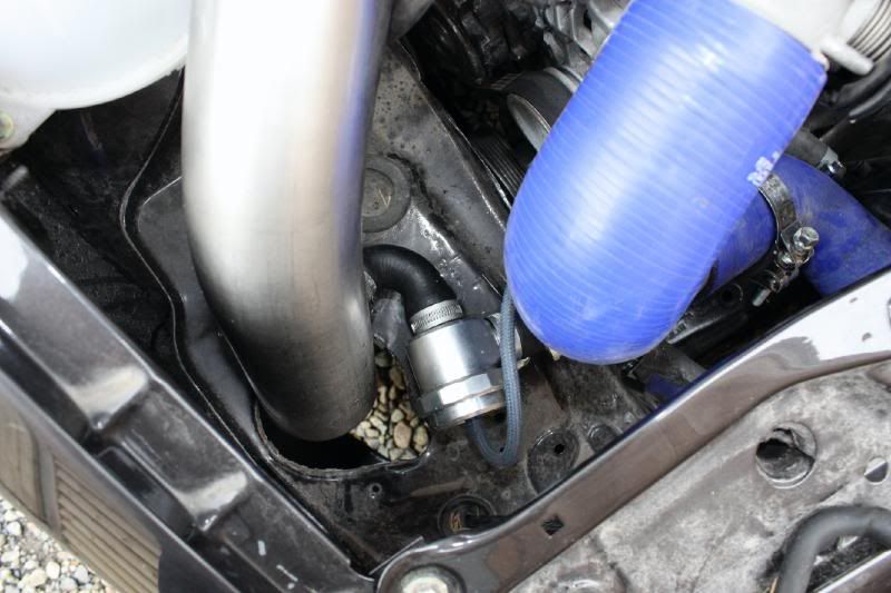

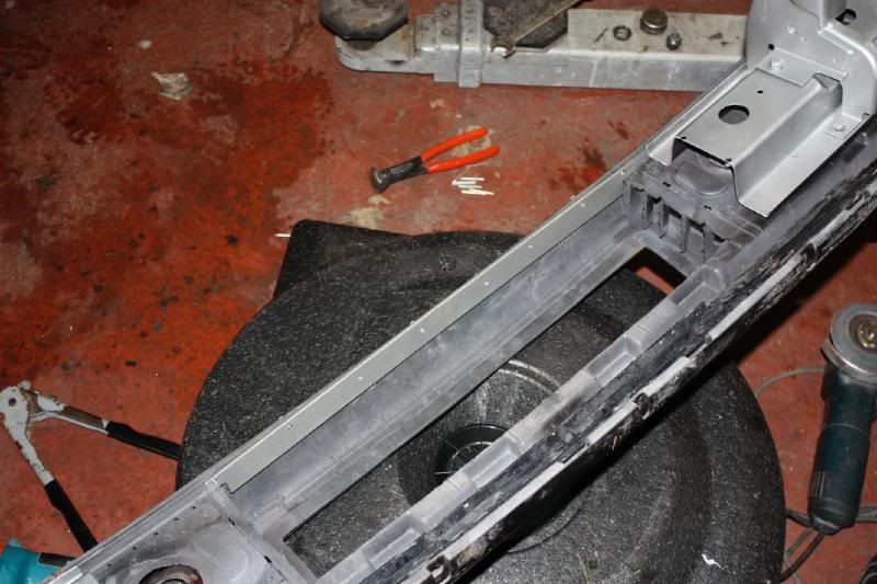

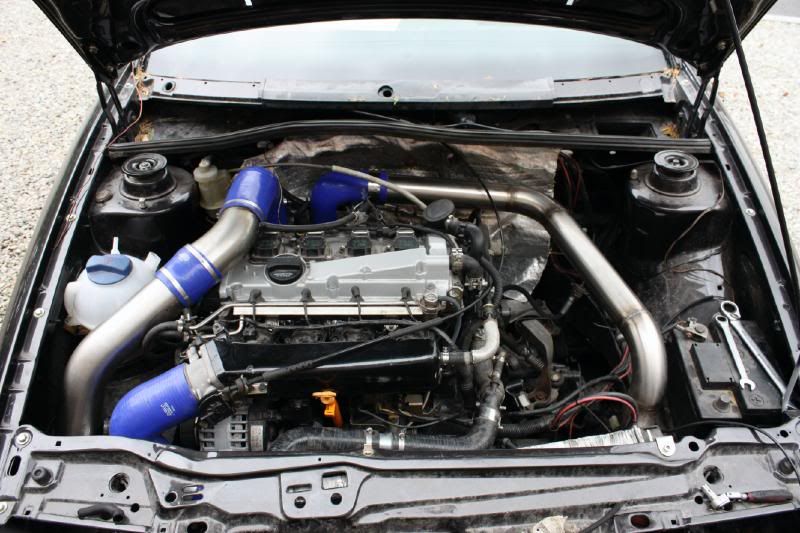

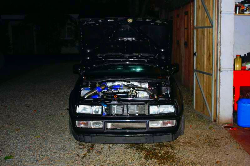

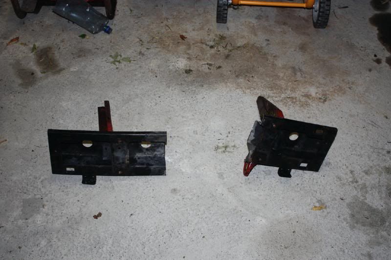

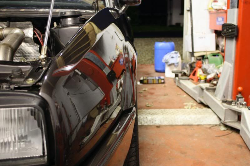

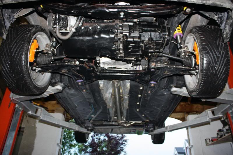

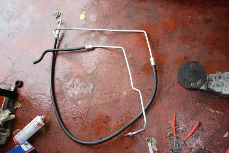

20vturbo 0 Posted July 12, 2010 remodeled bumper bar to fit around the intercooler steel attached to the top inside of the bumper because when i cut out the hole for the intercooler it went a bit wobbly tidied up the power steering pipes the first proper pic of the underside syncro shift goodness now inside the box i took the car for its first spin in two years, just around the yard, gave the engine a clean Quote Share this post Link to post Share on other sites

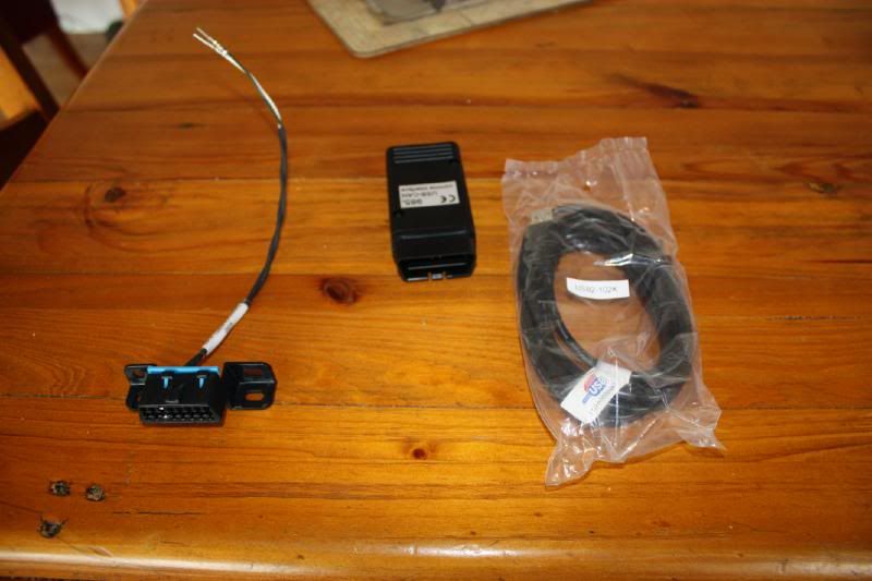

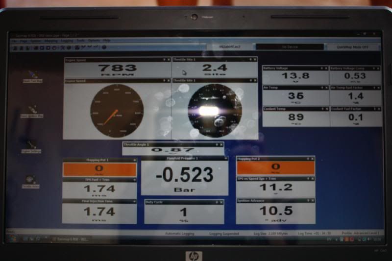

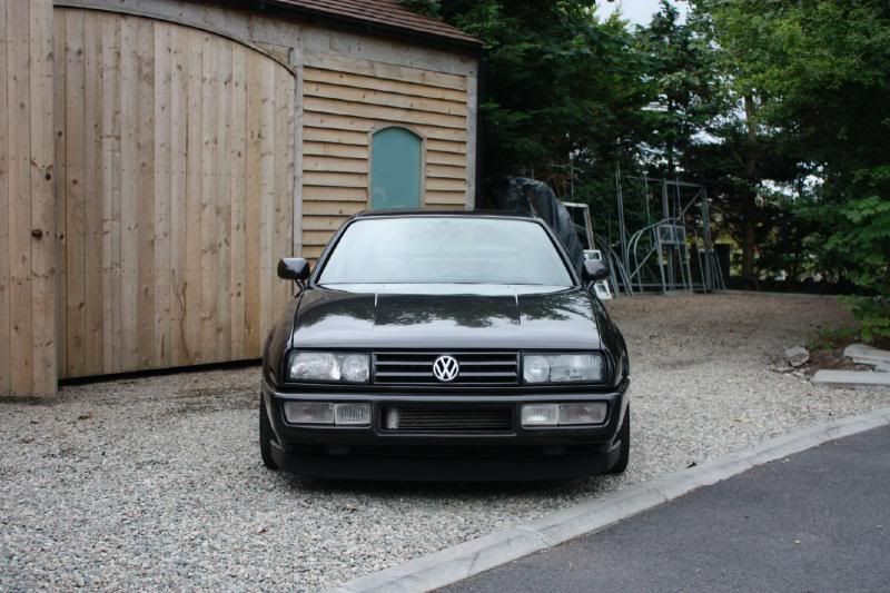

20vturbo 0 Posted July 21, 2010 a few pics from last weekend, just a quick wash for the show my can interface box arrived so i could connect my laptop up to the ecu all looks good, im seeing intake temps between 23 and 28 at the throttle body when driving and around 40 when stopped so it looks like the intercooler works well. Quote Share this post Link to post Share on other sites

pete_griff 0 Posted July 22, 2010 glad to see it's finally coming together for you. those are some decent intake temps - good to see. hows the driving experience for you, not too much lag etc? got many miles under the wheel as yet? tidy build - brakes are a bit too extrovert for me, as is the obvious front mount intercooler, but i guess you can't really get round the intercooler bit too much without compromising temps. you going to get it on the rollers once it's all squared away? Quote Share this post Link to post Share on other sites
swiftkid 1 Posted July 22, 2010 Build is amazing, love the attention to detail. Think the brakes stand out a bit too much for me, think black would look alot more discreet and i reckon some black meshing in front of the intercooler would look alot better and hide it a bit but hats off to the progress! Quote Share this post Link to post Share on other sites
vw domo 0 Posted July 22, 2010 incredible!! :salute: glad to see your finished, so now you have the pleasure of driveing. i always liked the slat insert look infront of the intercooler but i guess it would be more restricting. brakes look awseome! :D Quote Share this post Link to post Share on other sites
20vturbo 0 Posted July 22, 2010 pete_griff said: glad to see it's finally coming together for you. those are some decent intake temps - good to see. hows the driving experience for you, not too much lag etc? got many miles under the wheel as yet? tidy build - brakes are a bit too extrovert for me, as is the obvious front mount intercooler, but i guess you can't really get round the intercooler bit too much without compromising temps. you going to get it on the rollers once it's all squared away? i am putting black mesh infront of the intercooler to hide it, just havent got a chance yet, plenty other jobs to do first. cant comment too much on the driving experience as it hasent been properly mapped yet but so far seeing boost around 2k, suspension is very good and not too harsh, brakes are brilliant, the 4 puck clutch feels just like the standard one and the limo gives loads of traction. the brakes might not be to everyones taste but i love big brakes (you can never have brakes that are too big) and after all the effort of getting them to fit i wasnt going to hide them away with black. at the end of the year its getting mapped so i will finaly see some power figures. Quote Share this post Link to post Share on other sites
blue95 0 Posted July 22, 2010 Have enjoyed reading and watching this build any plans to go to Ed38? would like a closer look at this monster :dorky: lol Like what you have done with front bumper, must make a real diffrence all that extra air!! even more so on a cold day :) Thought about doing this my self, but was concerned about taking away structural integrity buy cutting the metal C section that links the front chassis legs. Have you welded any braces to the metal sections? Also did you buy you can interface box from QPE or from SBD? Well done Sukh Quote Share this post Link to post Share on other sites
20vturbo 0 Posted July 22, 2010 blue95 said: Have enjoyed reading and watching this build any plans to go to Ed38? would like a closer look at this monster :dorky: lol Like what you have done with front bumper, must make a real diffrence all that extra air!! even more so on a cold day :) Thought about doing this my self, but was concerned about taking away structural integrity buy cutting the metal C section that links the front chassis legs. Have you welded any braces to the metal sections? Also did you buy you can interface box from QPE or from SBD? Well done Sukh wont be making the trip, no interior and hasent been mapped yet. the hole in the bumper is the only way to do it, fannying about with ducts just dosent work, the 23 degree intake temp speaks for itself. the intercooler is inside the top half of the bumper so i couldnt put any braces on the bumper bar. the bumper bar does not add any rigidity to the front chassis legs because you have the front engine support already bolted to the exact same place. the bumper bar is just there to protect things in the event of a crash. i got the can interface from sbd, i hate that stupid stereo jack that qpe use. i now have a proper connecter which is the same as the vag diagnostic port that i can mount to the dash. Quote Share this post Link to post Share on other sites
